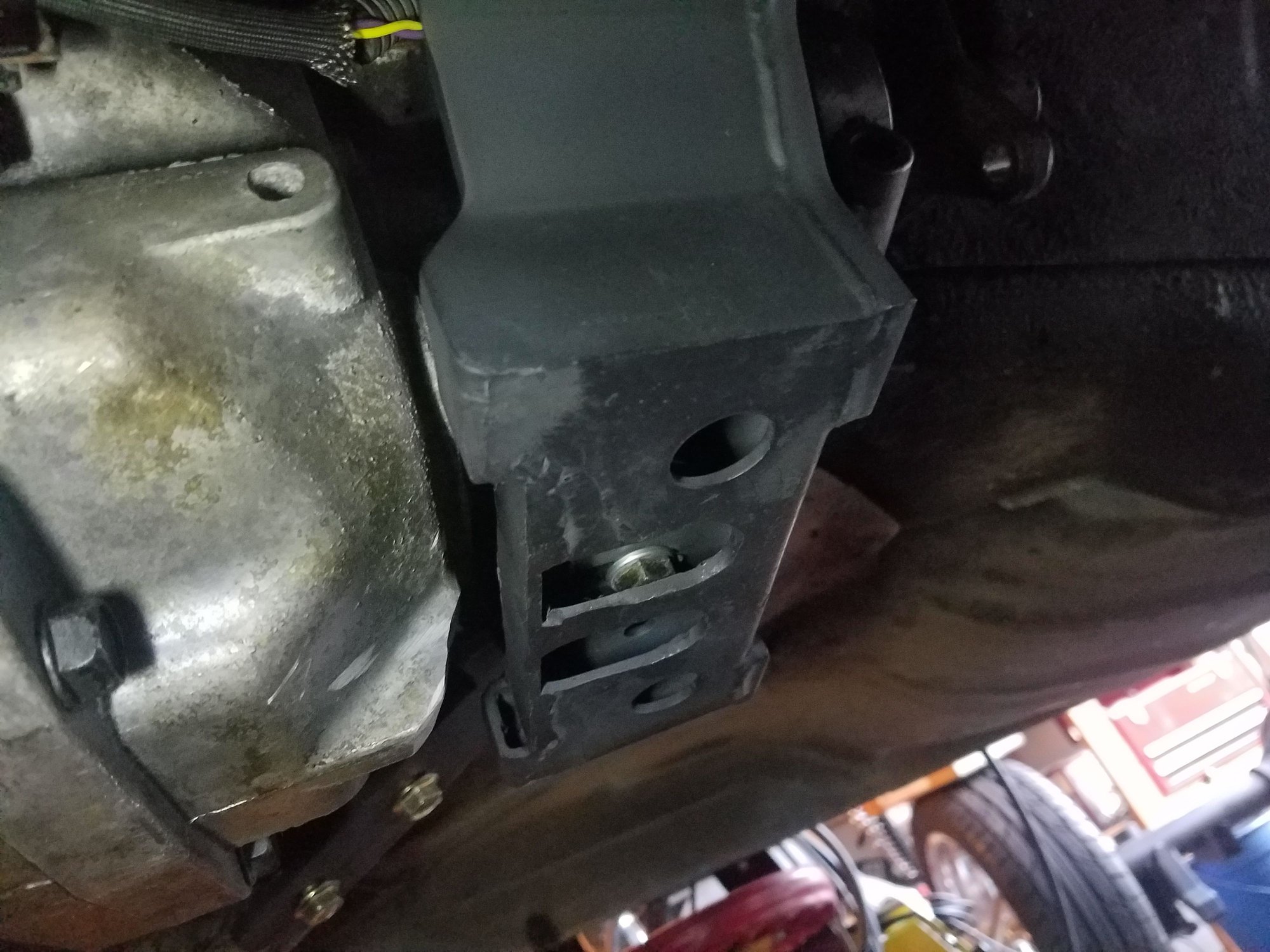

I'm running the Hooker crossmember with UMI K-member and T56 trans. It fit without mods but I didn't have much clearance so I reworked it. The tail housing was really close.
