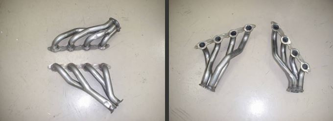

So, I had an idea. I know that using SBC headers as a starting point for LS headers is a lot of work. However, I had purchased a new set of Hedman Headers P/N 68481 for $300 about two years ago. I was planning on using them on my 305, but had ended up deciding to do the engine swap. They're "shorty" headers, although they seem to be actually closer in length to mids. I was thinking that I might be able to save these from going to waste and building my headers out of them, and still being able to use cats like I wanted to. 1-5/8" primaries, and 3" collectors. Here's a picture of these headers:
Obviously the y-pipe isn't going to work, and that's fine. I would just cut the flange off of it after the 90 deg. bend. I would weld some small cats to the 90 deg. bits and I was thinking that the cats should sit about where the collectors of the LS swap long tubes sit? I could get a cheap set of LS flanges off eBay, and then bend and cut the primaries into place. The AIR tubes would be cut off close to the primaries, pinched and then welded. I really love messing around with my welder, so I don't mind doing the work.
What do you guys think? A good option for some LS headers with cats, or a waste of time and money?

Reworked or not, do you want to have 1 5/8 primaries on a 6.0?
Most my driving will be on the street. So maybe 2000-5500 RPM. Might see drag strip once or twice.
Option 2 is the '02 LS manifolds I have, as well.
Which one would flow better on the 6.0?

2000-5500 RPM? Again, this is NOT an SBC, TPI, etc. My G8 has a Texas Speed LS3 NA Stage 1 cam (225/236 .629/.619 114 LSA +4) and easily runs to 6500 RPM.
. 5500 RPM MAX? Leave the stock cam in. Like SERIOUSLY!
Why not get the Speed Engineering headers https://www.speed-engineering.com/ls...2-ls3-ls6.html
I woud run the LS manifolds way before I'd run those 1-5/8" crapola headers. Or you can spend some dough and run the Hooker Blackheart setup...
I like those, but I can't run Cat Converters on LTs with a 4l60e.

What do you think QwkTrip, would the Hedman headers be an upgrade over the manifolds?
I could also search around for some of the BBC headers offered for our cars. Something like these:
I don't know, I'm not well versed on the shorty and mid-length headers. Need to defer to other people.
Maybe cruise the Hawks website as they tend to have a decent variety of choices to view. Kooks and ARH (American Racing Headers) might make some mid-lengths for our cars. ARH is not known for being cheap though.
I kind of doubt the BBC pattern is close enough but you can look into that. Those big block headers shown have kind of a tri-Y which is dependent on firing order. Not sure if LS and BBC have the same firing order. All things that must be considered if you're going to avoid direct bolt-in.

Kooks does make some LS mid tubes for third gens for around $900, and they are fancy. ARH does not.
Thanks for reminding me of the Tri-Y that conventional GM firing orders used. I guess LS motors switched over to a much more "balanced" firing order, so the side with the double y would actually hurt performance, I think.

BPR Hotrods makes a MidLength LS swap header for our cars. Not sure I've seen anyone use it. I am not sure what the benefits would be since you still have to fab up a Y-pipe and gain only a little ground clearance over regular longtubes.
Yeah, and they lack photos of both sides. I saw those, but not worth that. Yeah, I'm not looking for ground clearance over the LT headers, rather was just trying to get some cats put behind some mids. That way the 6.0 can breathe and I can still have relatively clean exhaust.
I've seen alot of different universal types, but i cant try them without buying them. I might be best off just getting one of the tube bend kits and making my own.

Another idea for headers is I could maybe just buy the Speed Engineering or some other cheap headers, and cut back a bit before the collectors, and then merge them a bit sooner than they are in their current state. That might give me the room I would need to put some cats in.

This is my exhaust using 2002 4th gen manifolds. I needed to run cats because no one here will make a custom exhaust without them. Three inch the rest of the way back with a single in and out muffler. Stock LS3 with only about 200 miles on it at the time it was tuned made 368 hp at the wheels

Wow, I appreciate the information and photo! I see that the cats are actually pretty far back in the Y pipe assembly. You know, I think I might actually be able to just use the Speed Engineering headers, after all. Even if I just have to place the cats further back like yours, I think it should still work okay. They may not work at max efficiency, but they should filter out alot of the fuel smell!
