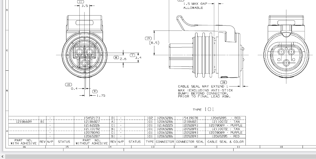

I could use help again with proper connector for 1998 Camaro coolant temp sensor. This is the 3-pin version (12551708 maybe) that's so handy with LS swaps in our cars. I think the answer is in TAXI 12078088 but I can't find a copy anywhere.
I can find connectors that will plug in but the problem is the cable seals are too large for 22 AWG cable. Everything I've found is going to leak. I have a suspicion GM used 12110192 but the seal seems to be sized wrong.
The #12078088 Data-Sheet does include the Part Numbers for the 3-Way Metri-Pack 150.2 (Pull to Seat) Connector, with different sized Cable-Seals.
It also includes the Part Numbers for the actual Cable-Seals without the Connector.
The Cable-Seal with the smallest holes, is #12110072 (TAN).
The Connector with this Cable-Seal, is indeed #12110192.
Nice job!!!
Also, there is Taxi #12078092, that is only for the Cable-Seal Information without the Connector Part Numbers.
Here is an Image of the Part Number Chart from the Data-Sheet:

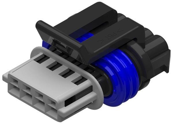

The Slimline GT-150 Connector Part Numbers for the 3-Terminal Sensors (TPS, Coolant, MAP, Oil-Pressure, ETC) are:
Connector Assembly: #13602480 (the same Part Number that you had Posted):
The TPA is #15452678:
The PLR (if you ever need to replace it) is #13602479:
The Terminals for this Connector are the same as the Connector that you are using for the Air Temp.

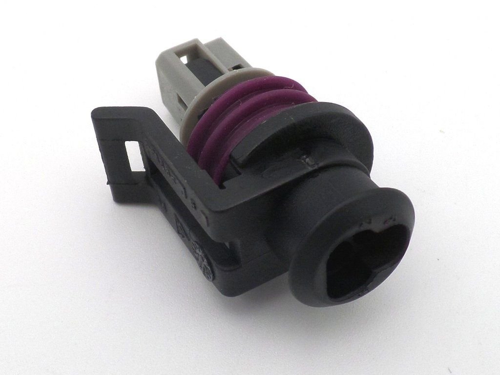

If you ever need to have a Sealed and Booted Connector...
The Part Number is: #15397275:

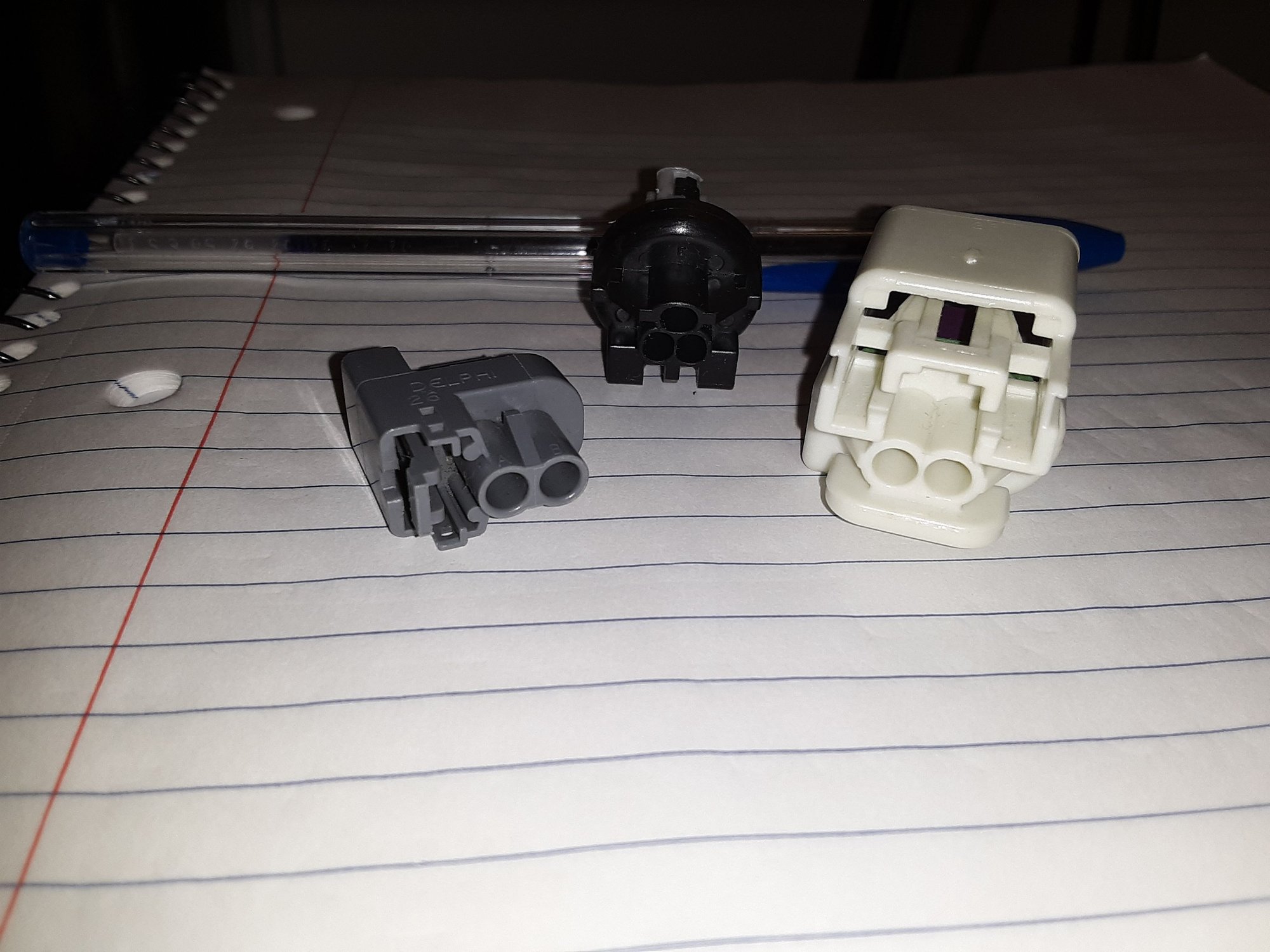

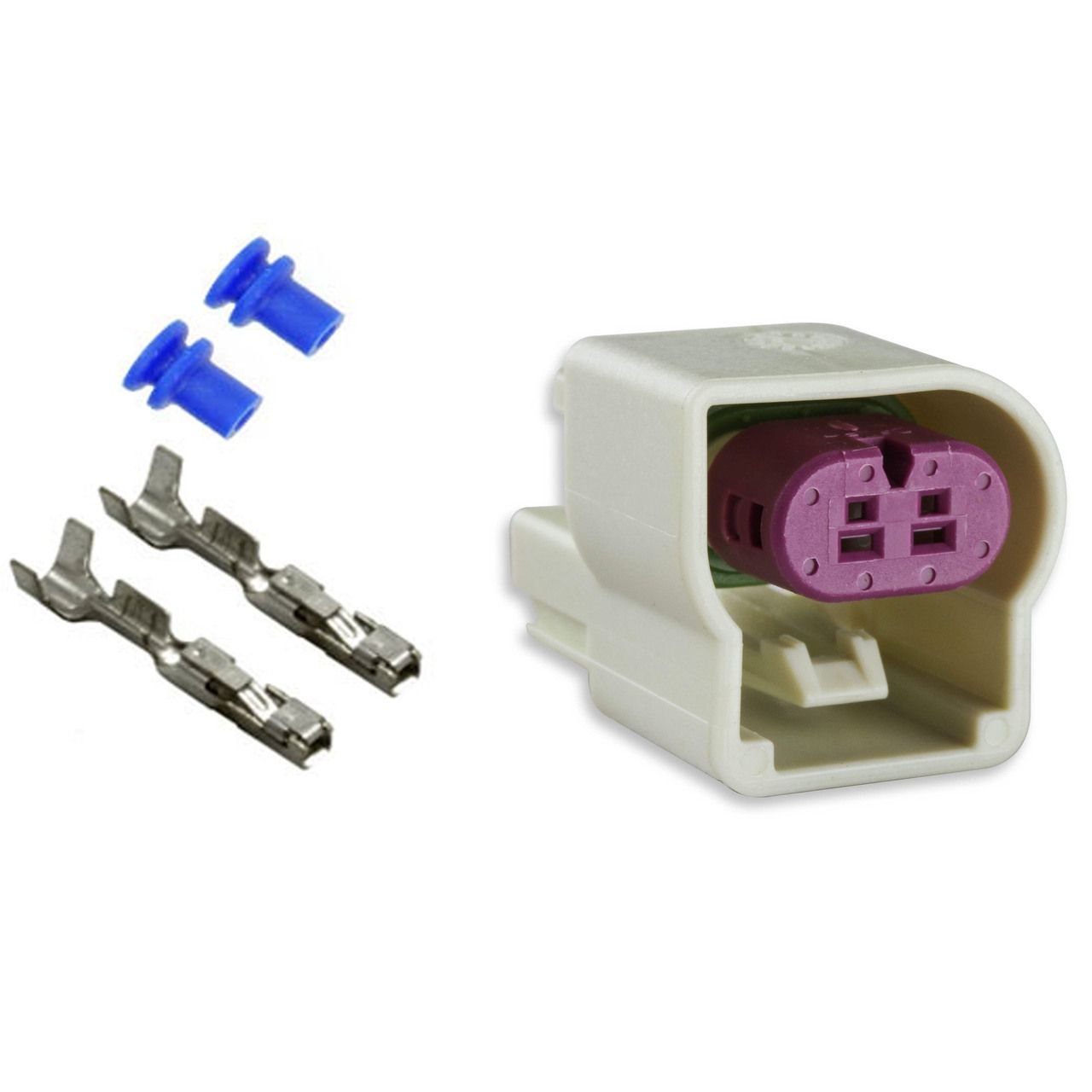

2-wire non-resonant knock sensor (LS3 style) appears to be a GT 150 4.5 mm centerline (15374222). That drawing calls for cable seal 12191226, but I notice that's the same cable seal used in a Micro-Pack 064 connector for Multec fuel injector. Is that really the correct cable seal for the knock sensor?
The terminal called out for the knock sensor is 12191818 which is indeed a GT 150 terminal, but TAXI 12191815 indicates the typical cable seal would be 15366021 (not 12191226). I'm confused which seal is most appropriate in this case.

Yes the Gen-IV Knock-Sensor Connector-Body is Part Number: #15374222:
The current Part Numbers for the GT-150 Cable-Seals are:
-15366060 (Blue) 18AWG to 20AWG.
-15366021 (White) 22AWG to 20AWG.
The Delphi MULTEC-II Fuel Injector Connector does use Micro-Pack 064 Terminals...
However, it uses GT-150 Cable-Seals (NOT Micro-Pack 064 Cable-Seals).
So the Part Numbers for Cable-Seals that you found, are indeed correct.
MULTEC-II Connector-Body on the Left... and GT-150 Knock Sensor Connector-Body on the Right:
In the 2 Images above, the 2 different Connectors can be seen with the Bores for the Cable-Seals being the same inside diameter.
The 3rd Connector-Body in the Images, is a Slimline GT-150 3-Way Connector.
I included it because the Bore size is slightly smaller.
Some of the GT-150 Cable-Seals are also slightly smaller.
The following Cable-Seals have a slightly smaller outside diameter:
-15344324 (RED) 18AWG to 20AWG.
-15366022 (Green) 20AWG to 22AWG.
I recommend the above Cable-Seals for all of the Slimline GT-150 Connectors.

Okay, got another question about M/P 150.2 and GT 150 Mini connectors. I was trying to find a connector for the LS coils and noticed the kits online use a connector with a special key shape on the side of the connector body. It's not the half-round at the bottom of the body like shown in the Delphi catalog.
I think I stumbled on the right connector by accident (15354716) by searching through every 4-way connector at the Mouser website. But I can't find a line drawing anywhere to verify.
Also, in the event I can't find the correct connector assembly, is there a list of PLR's for GT 150 Mini connectors so I could just construct the correct assembly from a bare connector body? I'm guessing the connector body is same and the PLR's are what make the unique keyways.
Old Dec 19, 2021 | 11:58 PM
  #95
vorteciroc's Avatar
Top Answer: 1
Joined: Jul 2006
Posts: 2,924
Likes: 803
From: 212 is up in this Bit@#
Re: Help needed to update LS swap sticky
The Electrical Connectors for the Ignition Coils, are the Slimline GT-150 4-Way (KEY) Connector.
The PLR for this Connector is the "KEY" shape.
I almost never find the PLRs in stock anywhere... but take the Part Number just in case you get lucky.
4-Way "KEY" PLR: #15336003.
The above Connector is: #15439568 (Mouser has plenty in stock).
The same type of Connector, but with the "Mushroom" PLR is: #15410728.
The "Mushroom" PLR is: #15326558 (good luck finding some).
The TPA for both versions of these Connectors is: #15305028.
