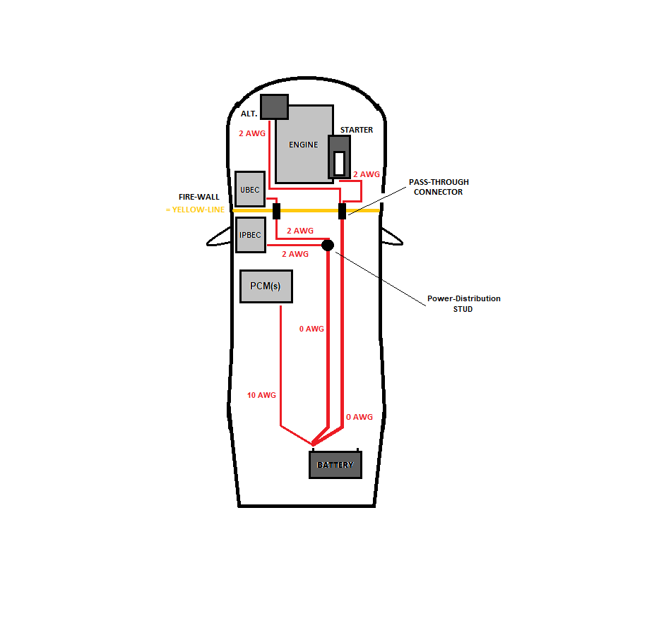

I am going to work on a Diagram for you.

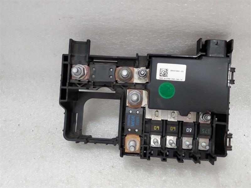

Just to kick off some ideas, here is a device I used to centralize power distribution and get rid of the fusible links in my car.
This is a Littlefuse MTR sealed power distribution module, rated at 60 Amp continuous. It has 4 sockets with a mix of ATO and JCASE fuses (slow blow). I run the whole car off this thing except for the fuel pump and Holley EFI main power (10 AWG wires). That’s how I work around the 60A rating. And alternator cable goes directly to battery and does not touch this device.
The module is fed by a 4 AWG cable directly from Battery B+. These are my circuits,
  • Subsystems 1 and 2: The wires that were originally on Fusible Links A and B (pass thru C100). These are the wires that originally powered 99% of the car. I snipped off the fusible links and gave each wire a fuse slot.
  • Subsystem 3: HVAC high-speed fan. Snipped off the fusible link and gave the wire a fuse slot.
  • Subsystem 4: Underhood power center for engine
  • Again, the fuel pump and Holley ECM get power directly from battery with inline fuses.
The drawback to this thing is the current rating, and the limited number of circuits. I’m out of room and any add-ons to my car have had to be wired to battery with inline fuses.
* MTR fuse block (p/n BPDMA104HXF1)
* Metri Pack 280 series, 10-12 AWG female wire terminals (p/n 12077413). These are for the ATO fuses. You will also need appropriate size wire seals.
* Delphi Ducon 6.3, 10-12 AWG male wire terminals (p/n 15344631). Used with the JCASE fuses.
* Wire seals for use with Ducon connectors (p/n 12052668)
This was the big shocker when I whittled down my harness to the basics.... These are the wires that powered 99% of my car when stock.

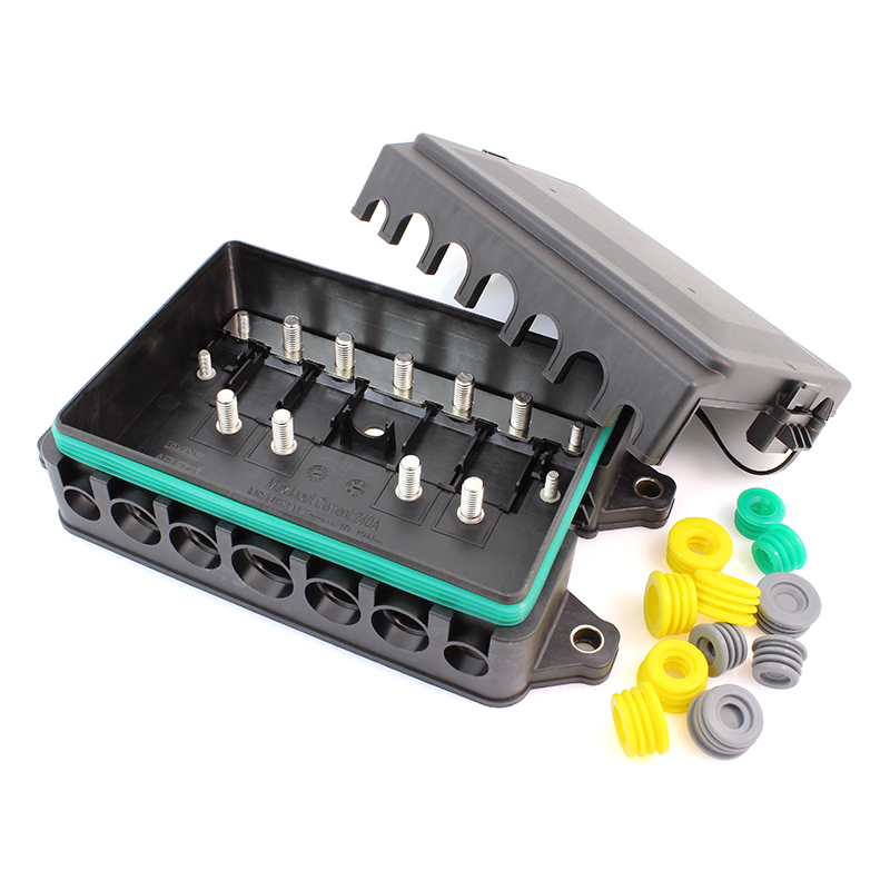

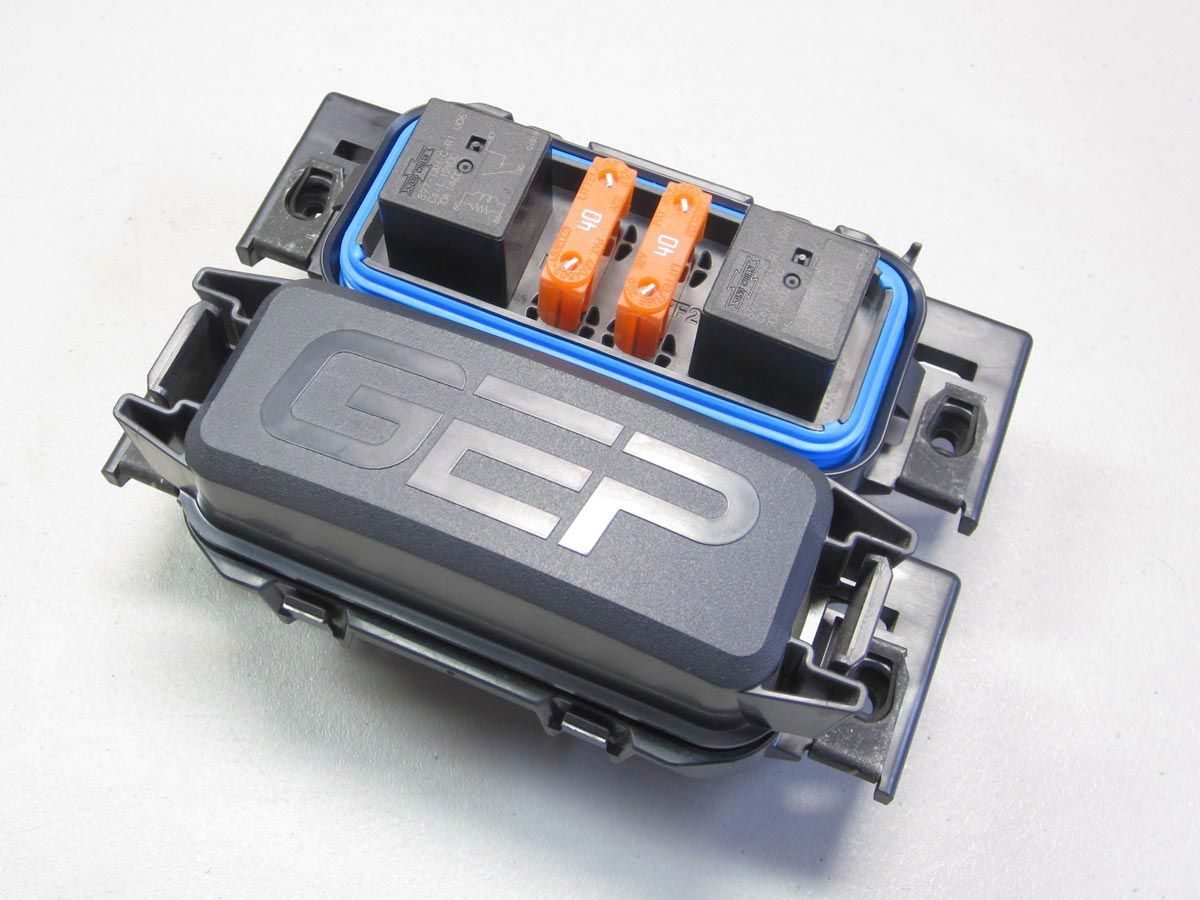

I install a small Sealed UBEC (Under-Hood Bussed Electrical Center) of Maxi-Fuses to replace the Fusible-Links.
Below is an example from "G.E.P." UBEC, that we (Delphi) sold designs to use Delphi Sealed Metri-Pack 280 Series, and 800 Series Terminals and Seals:
For Vehicles that I am doing away with all of the stock Wiring...

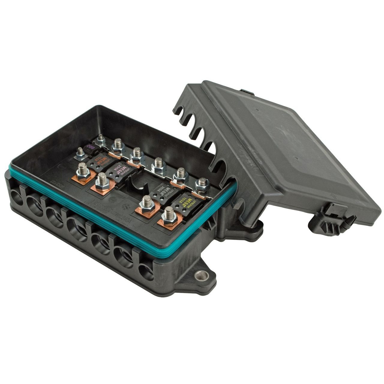

I tend to use a UBEC and/ or IPBEC made of some of the following:
The Sealed Bussed Electrical Centers above are from Cooper-Bussman (as in Bussman Fuses)/ Eaton.
We (Delphi) sold them the designs to use Delphi Metri-Pack 280 Series Terminals and Seals.
These are perfect for all Circuits up to 30A to 40A.
Below are some High Amperage solutions:
Above are sealed PDCs/ BECs for Mega-Fuses...
They range anywhere from 80A to 500A per Fuse.
The Maxi-Fuses range from 20A to 60A (70A to 100A Fuse are made, but unintellegently none of the Terminals that fit these Fuses are intended to pass 60A).
And of course, the Mini-Fuses are good to 30A - 40A.

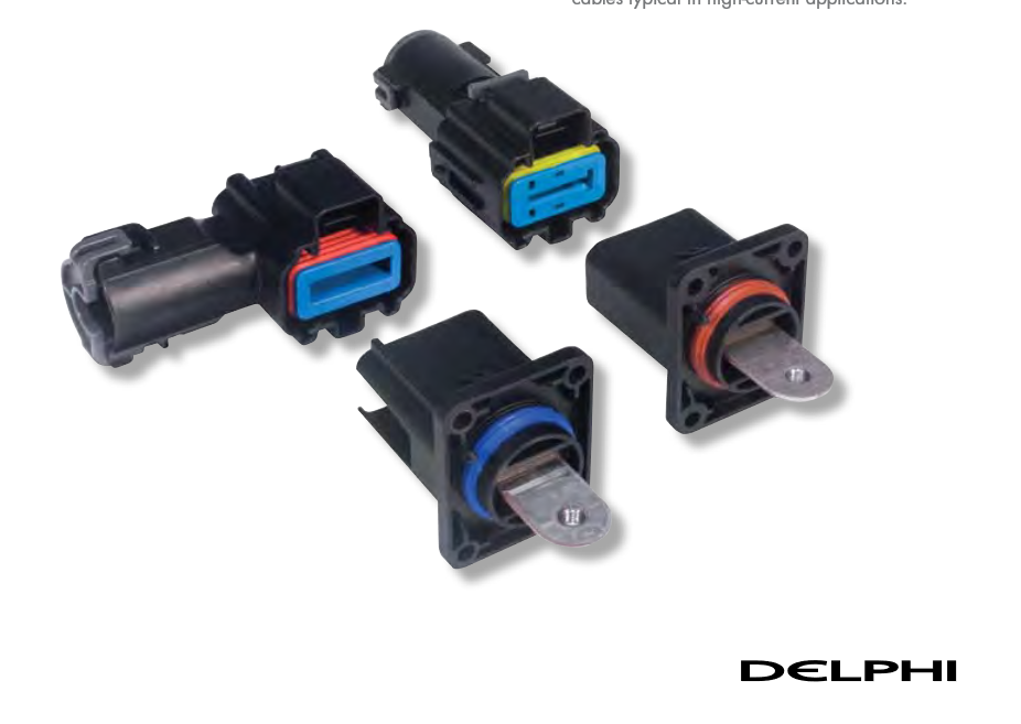

Delphi has Sealed Electrical Connectors from 1A to 250A under a Continuous-Load...
For 28 Gauge to 2/0 (Double Zero) Gauge Wire.
Below are 3 Sets of single-Wire Connectors...
Left to Right are: 250A, 60A, 30A (There is also a 125A Connector Set, however I am out of stock at the moment):
BTW, I am still working on multiple diagrams.

You can have more than one Power Distribution Center...

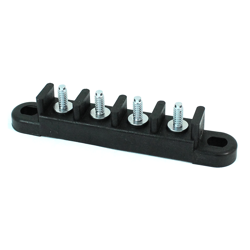

I usually make two.
The UBEC and IPBEC.
The Larger Cooper-Bussmann BEC holds 10 Relays up to 30A each.
The higher amperage relays can be individual or placed on a panel.
Delphi Relays go up to 60A... and then there are Contactors for higher amperage switching (like 200A for an auxiliary Battery isolator).

This is not how Electricity actually works...
However for the purposes of a Diagram, Lets say that Power at the PCM is "Clean".
As soon as the "Clean" power hits the Power Distribution Stud...
It gets mixed with the "Dirty" High-Amperage Power (from the starter etc), down the 0 AWG Wire to the Battery.
So instead, we make a direct connection from the PCM to the Battery instead.
...and yes the Battery acts as a massive "Noise Filter".
Old Sep 16, 2021 | 04:23 PM
vorteciroc's Avatar
Top Answer: 1
Joined: Jul 2006
Posts: 2,924
Likes: 803
From: 212 is up in this Bit@#
Re: Power Distribution
The reason for the Dual-Post Batteries, is just to try and make several Large Gauge Wires look neat at the Battery.
Old Sep 16, 2021 | 06:19 PM
vorteciroc's Avatar
Top Answer: 1
Joined: Jul 2006
Posts: 2,924
Likes: 803
Now in this altered Diagram, Electricity leaves the Negative Post of the battery and travels down the 10 AWG Black Wire to the PCM.
Through the PCM.
Into the 10 AWG Blue Wire, and back to the Battery without having to pass through any Wires that are passing a High-Amperage.
Old Sep 16, 2021 | 06:21 PM
vorteciroc's Avatar
Top Answer: 1
Joined: Jul 2006
Posts: 2,924
Likes: 803
So the Clean Circuit for the PCM now looks like the Yellow Circuit in the Diagram below:

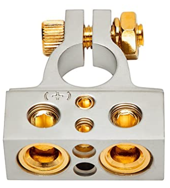

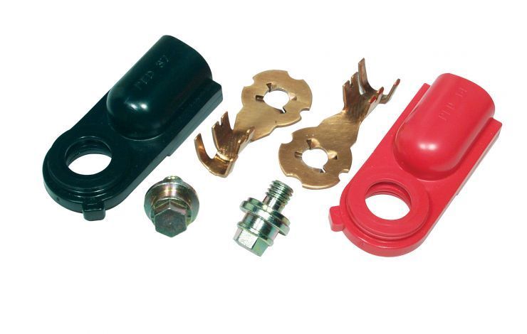

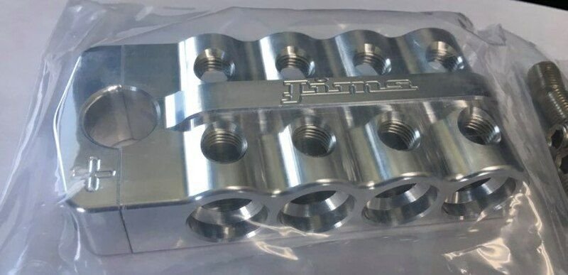

At this point we need to tie at least 2 circuits, maybe more, direct to the battery post. Would something like the “military style” terminal be good for this?
There are better options that maximize contact patch between the terminal and post. With the military style terminal, only a small ring makes contact with the bolt head and terminal body. Other terminal blocks, typically made for adding sound systems, allow a larger contact patch for several cables and are best paired with appropriately sized ferrules to both maximize contact patch and protect individual wires within the cable from being damaged. While a military style terminal is "good enough" to supply the power to low guage cables, it shouldn't be considered best practice for power delivery.
Military Style Battery Terminal
Better Designed Battery Terminal (Quality may actually be bad... buy good parts)

I actually use different "Car Audio" type Terminals (similar to what you posted) when I have multiple large Gauge Wires at the Battery.
There are so many options for Terminals like this to chose from.
I have never had the need for the Terminal in the above image, but it is amazing how many options there are.
Nickle Plated Copper or just Copper, will provide the best Connection.
Aluminum and other Materials are a big step down in terms of Conductance.

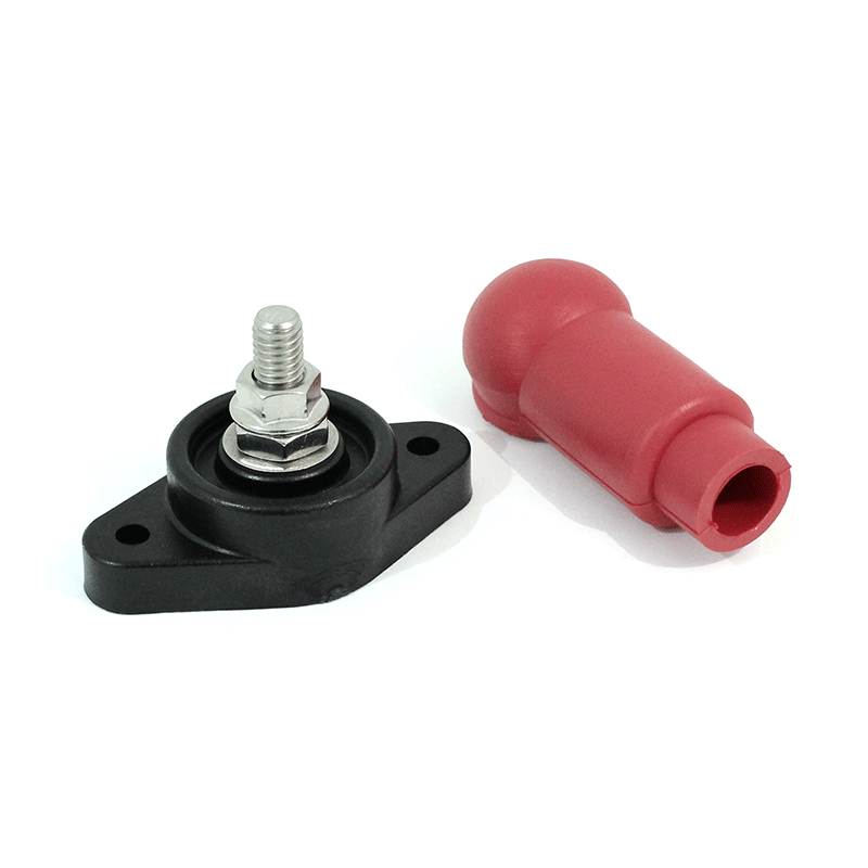

I try to find Terminals that are at least partially covered...
I would like to try and protect people from an accidental Short across the Battery Terminals.
Sometimes I use these Terminals from KnuKonceptz (just with Two Wires):
But even the Military style Terminals, that you Posted have Covers available:
Even something like this is okay, with a Plastic Cover:

Modern GM Vehicles have a Bussed Electrical Center mounted on top of the Battery.
This is done so that the initial Power Distribution can start right at the Positive Post of the Battery:
I personally do not use a BEC at the Battery, for fear of this:
The Third-Gen F-Body Positive Power Cables/ Wires should be layed-out in a similar fashion to the Diagram below:
The Negative Power Diagram will follow soon.
Power-Distribution Studs can be used as shown below:
Or with multiple Studs, like this:
If using one Stud...
Two or Three large Cables can be stacked with Two types of Cable Terminal-Boot.
The Top most would use a Boot like this:
And the others, like this:
Pass-Through Connectors for the Fire-Wall, would be like this:
Similar Boots as in the Post before this Post, can be used here also.
Delphi also offer great (But expensive) Power-Pack 2000 Connectors, and Pass-Through Connectors (Up to 250A Cont.):
Then the more affordable Power-Pack 1000 Series (125A per Terminal).
Make the 0 AWG Cable into Two of the 2 AWG Cable immediately before the Fire-Wall...
and you have a 250A Pass-Through (you can have One of the 0 AWG Cables again, or keep Two of the 2 AWG Cables, at 125A each):
