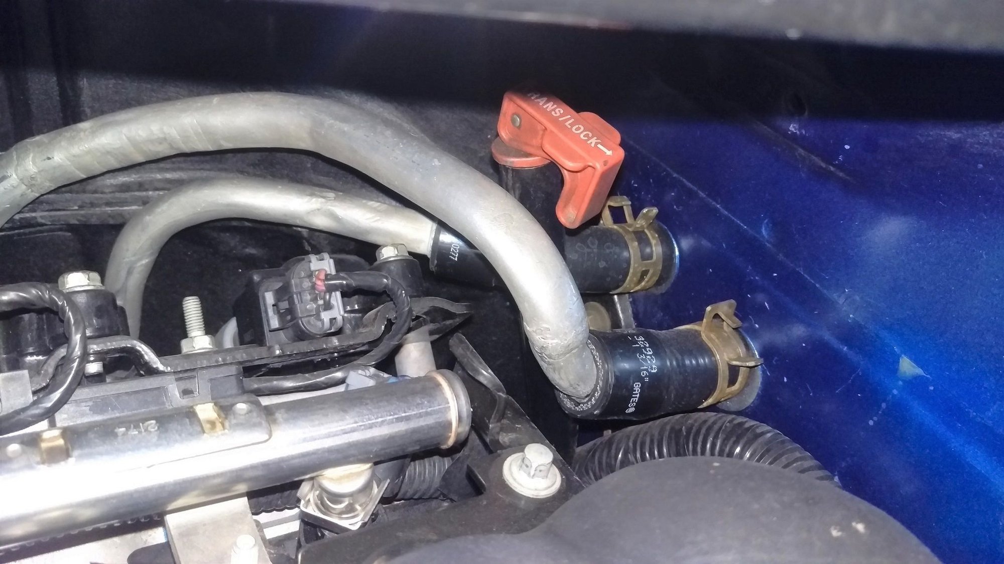

I recently started making new AC lines for my car and wanted to make them look better than the bare rubber hose. After I crimped them, I sleeved them in techflex and then cleaned up the ends with some heat shrink hose clamps. They turned out way better than I hoped for. I will likely go this same route with my cooling hose and ditch the -20AN line.
Will that heat shrink be able to withstand the pressure from the AC system? Ive been using those (gates) on my heater hoses, but am reluctant to use them on the AC lines. Less those are different from the gates shrink fittings im using.

The AC hose and fittings take all the pressure. The heat shrink is just for aesthetics and works great. I only use it to make everything "pretty".

The downside is you need to razor cut them off should you need to remove a hose. Keep a hose clamp on hand just in case.
This is why i only used them on the hard line side of the hose. I bought the big ones for the rad hoses, but couldn't decide which side to use the clamp one. Since i usually remove them entirely when i need to disconnect it for whatever reason.

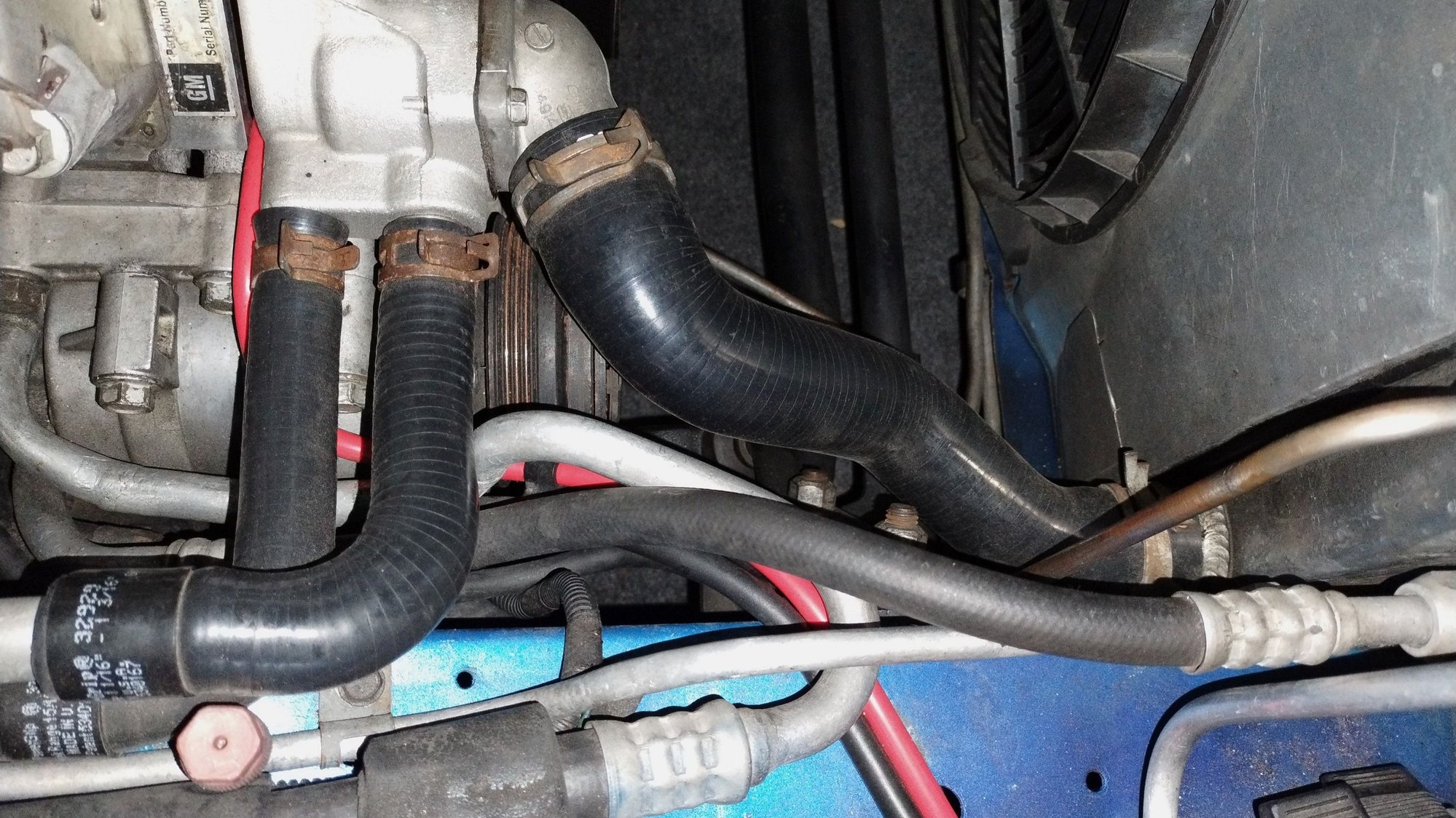

What brand are all those silicone hoses?

All are G-Plus brand from ebay. Lower is cherokee upper rad hose (cut to fit). Heater hose are two 90* elbows w/ 2" cut off for the opposite end
Exception is the upper radiator hose. That is OBX-r for a mid 2k corvette.
