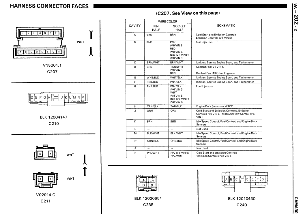

Does anyone have a pic of c207 and the location on the 3rd gen harness? specifically 87 z28? Getting ready to thin my 3rd gen harness to splice with the LT1 and want to make sure I grab the correct connector. Already found C207 pin out online at some Berlinetta website. I already found (on LT1 harness) C100, C105, C210,C220 & C230, as well as their pinouts on shbox.

This is from austinthirdgen.
