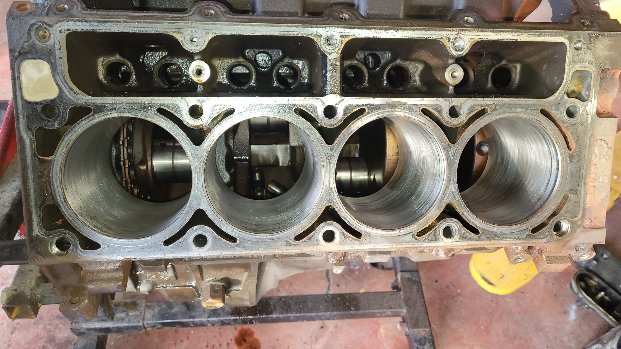

Welp. here comes the bad news. Tore the block down over the weekend and found some pretty heavy rust built up on #3,6 and 8. Left the motor in the shed too long without spinning it over and fogging it. I knocked out the pistons and gave all the cylinders a light hone to see how much the clean up. There are some dark spots but don't really feel any scoring or pitting. Spoke with my builder at the machine shop and he was going to recommend I go oversize pistons after seeing I just got the stock bore replacements. So now I need to exchange the pistons and the rings and go with 30 over pistons and ring kit.
I didn't get to take pics before doing a clean up pass to show how bad they were but here's what they look like currently.
And summit has been really helpful with answering questions and their return/exchange process is very easy. Cause I need these pistons and rings in a hurry lol.
