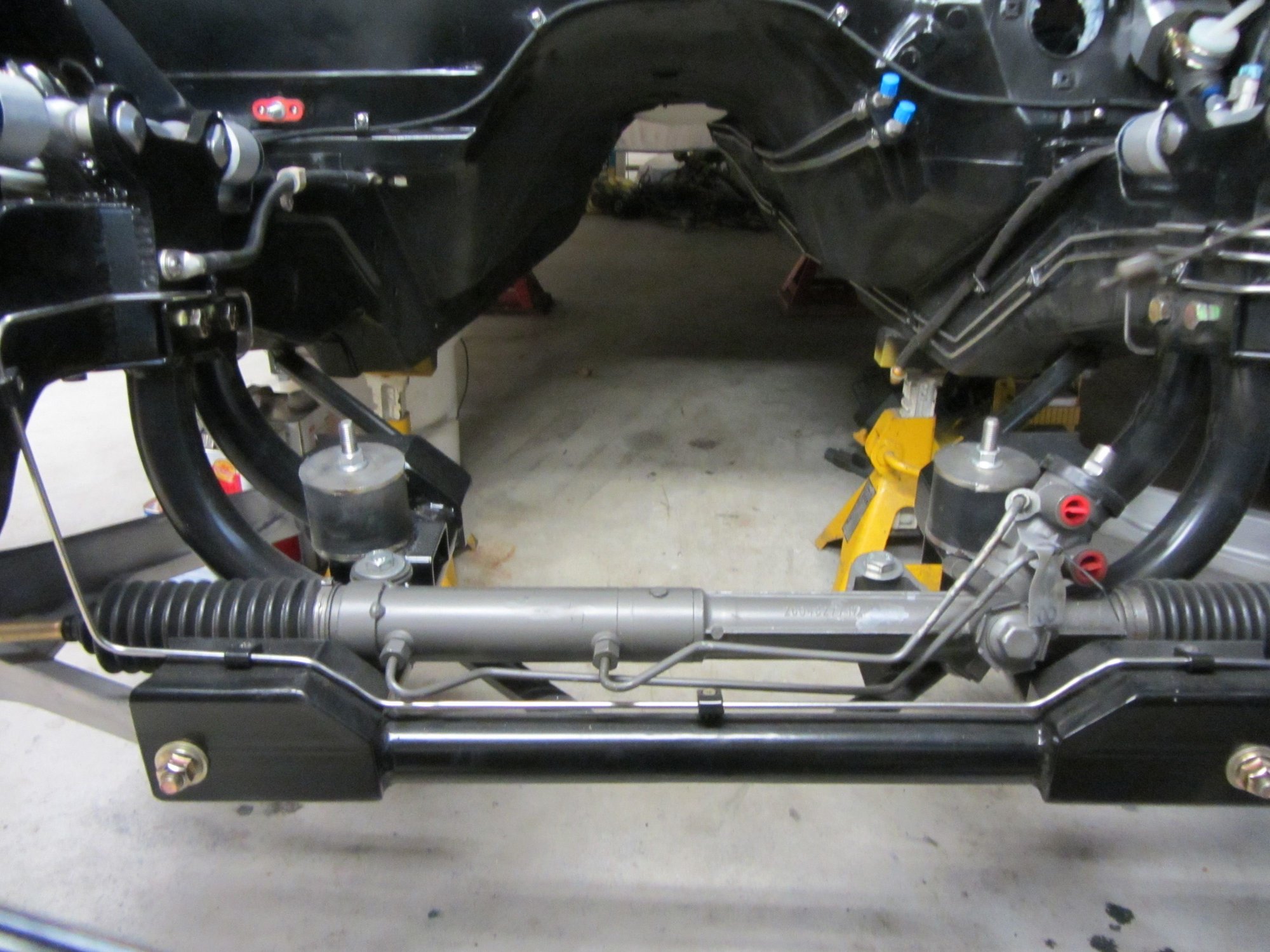

I made a custom K- member for different reasons, you could do the same with a few minor changes.
The lower control arm brackets are 3 X 2 rectangle tube that were welded to table at the proper width and track width for the car. 1 3/4 round tube is used to fill in the gaps and mount the K-member to the frame rails with 3 X 3 angle brackets bolted to the frame rails. The front and rear gussets are 1 inch tube with the rear picking up the original aft k-member bolt location.
The steering rack and motor mounts were added during mockup. My application required new frame rails and upper control arm brackets inset 1 inch on each side. Your application would not require any of these, so you would mount k-member to the original frame rails which would give you an additional 2 inches in the engine bay.
I hope this helps and gets your creative juices flowing.
Yeah that looks amazing!
Way out of my abilities though. Custom is probably the way to go though, seeing as all the aftermarket ones aren't road-legal and still don't seem to manage to be one-stop solution, be it not fitting, hitting on certain accessories etc.
I did notice with the Power steering pump not needed anymore, I might be able to get away with a bolt-on porcharger isntead. Not as fancy as a twin turbo setup, and doesn't look like it'll make quite as much power, but it doesn't take up much room. Bit more pricey though too.
