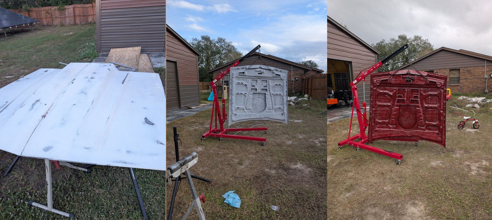

As stated I picked up a GoodMark cowl hood. The lid from a ZL1 sits high enough a cowl hood is needed to clear.
I planned on buying a new one if possible, but ended up getting a good deal on a used one. The car will be completely stripped and repainted after the swap is complete. Probably sometime next year.
In the meantime I painted the hood with color correct paint spray. I won't have access to a paint booth until next year so had to wait for a good cloudy windless day.
It didn't come out too bad all things considered. The needed section of the cowl hood was cut out to make room for the intercooler hose lines.

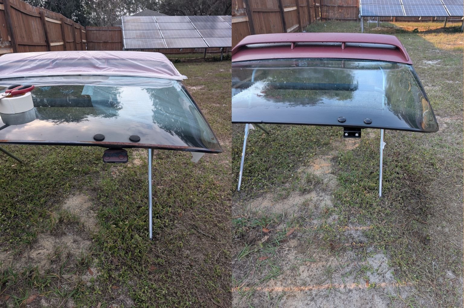

While I was at it, went to billet hinges for the trunk lid and sanded down then repainted the trim pieces back to satin black.

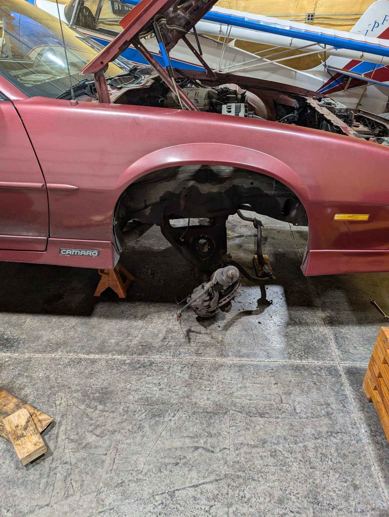

Full disassembly commences.
Anything and everything is being pulled out of the engine bay.
Essentially almost nothing taken out will be put back in.
Dropped the engine from the bottom by removing the k member bolts and transmission crossmember bolts.
Just as she was put in from the factory. A lift would of been nice, but got the job done with a cheery picker/engine hoist.
She's crusty in a couple places but thankfully nothing to major to fix.
Just a side note to others dropping out the bottom. I had to remove the alternator as it wouldn't clear the subframe coming down. Your mileage may vary but it's something I had to do.
I'm just thankful the floor pans are all in one piece. T Tops are nice...until they're not.
And with that we roll the old 2.8 and T5 out and get them out of the way.
A little sneak peek in the background of what's to come.

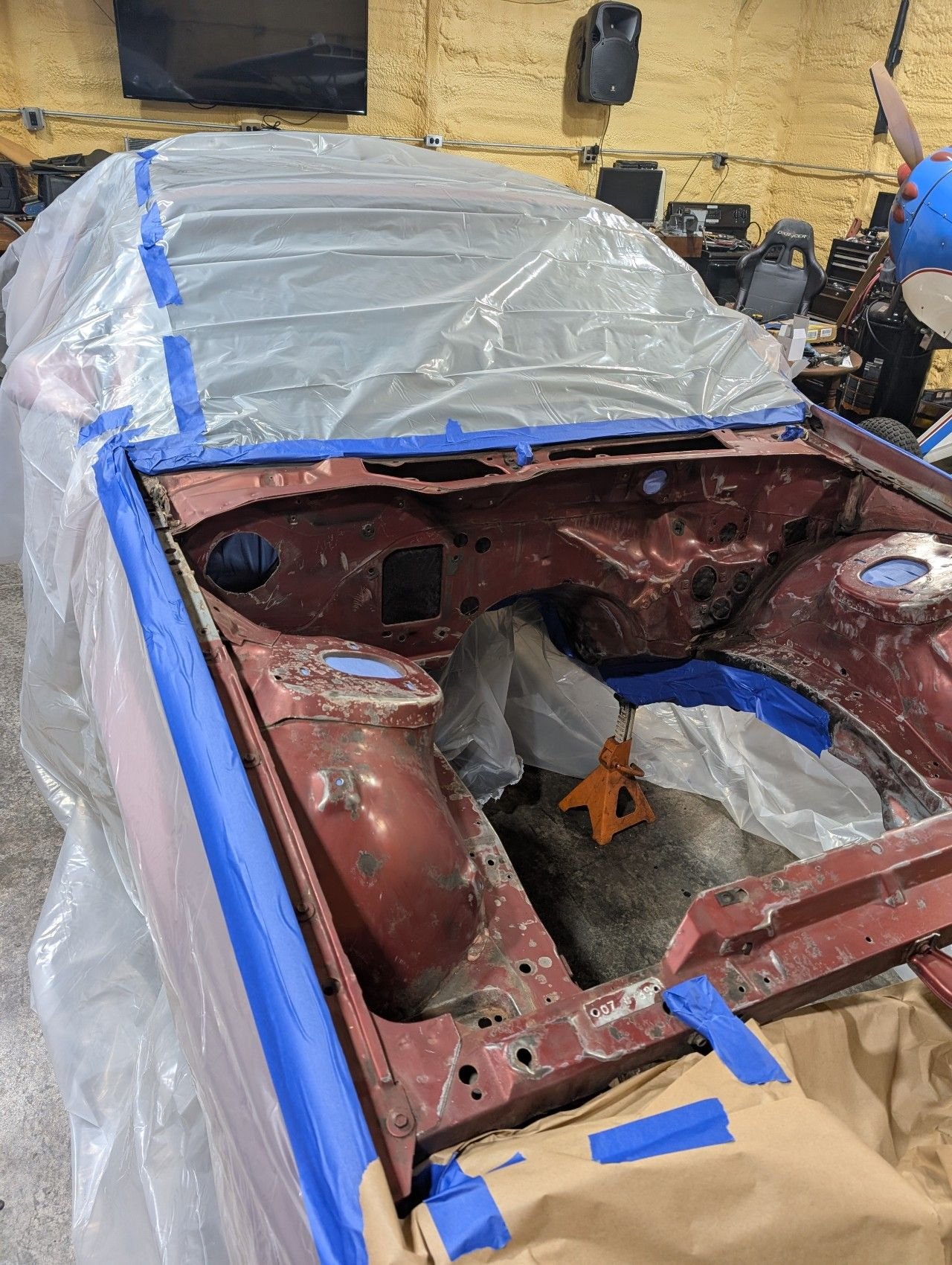

Pulled the wiring harness out from the C100 connector to the ECU. Getting the wires to come out the passenger fender was surprisingly easy enough.
It'll be trimmed and shorten down to just the basics in time.

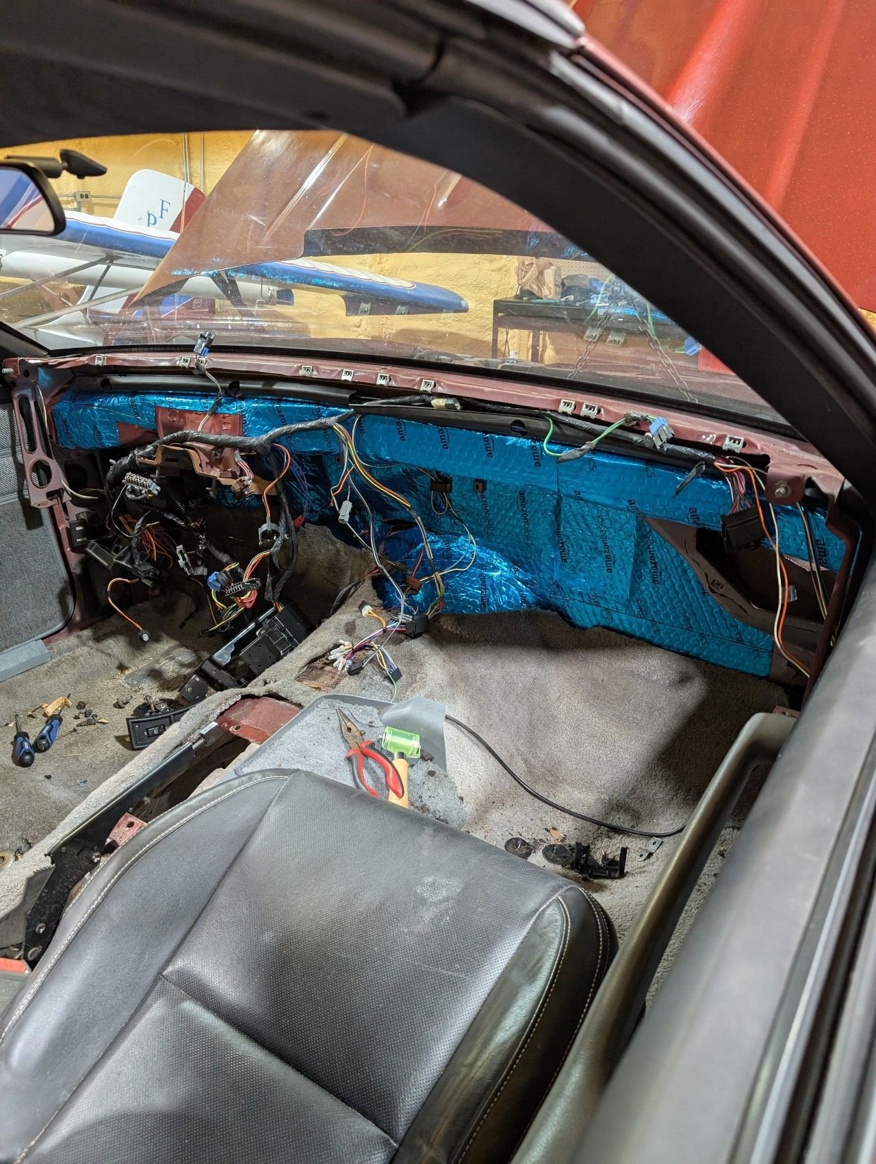

I will be retaining the original dash and gauge cluster. So a few connections will remain.
Engine bay is looking pretty bare now.
The interior starts to come apart now.
I will be putting a Vintage air a/c system in.

Next up I needed to do sound deadening on the firewall.
Per Vintage Air's instructions the old firewall mat can not be reused as space is extremely tight.
After doing some research I settled on the Amazon brand for various reasons. Testing showed it performed just as well and in some cases better then the big name products.
I'm not a fan of the branding marks all over it but thankfully once the dash is back on it will not be seen.

I started by taping off the engine bay.
Many hours of work later I was ready to hit it with primer.
Once the primer had dried I wet sanded it to semi smooth with 600grit.
After I was satisfied with the work I went to town on the paint followed by the clear coat.
While I was at it I primed then painted the cover plate that comes from Vintage air. It covers the old AC access holes on the firewall.
All in all I think it came out really good, especially for rattle can.
