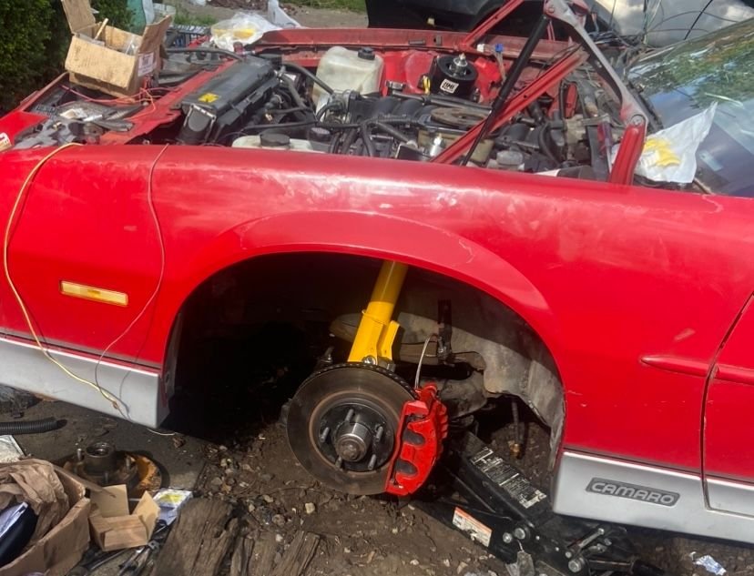

4th gen front and rear disc brakes big brake conversion front ls1

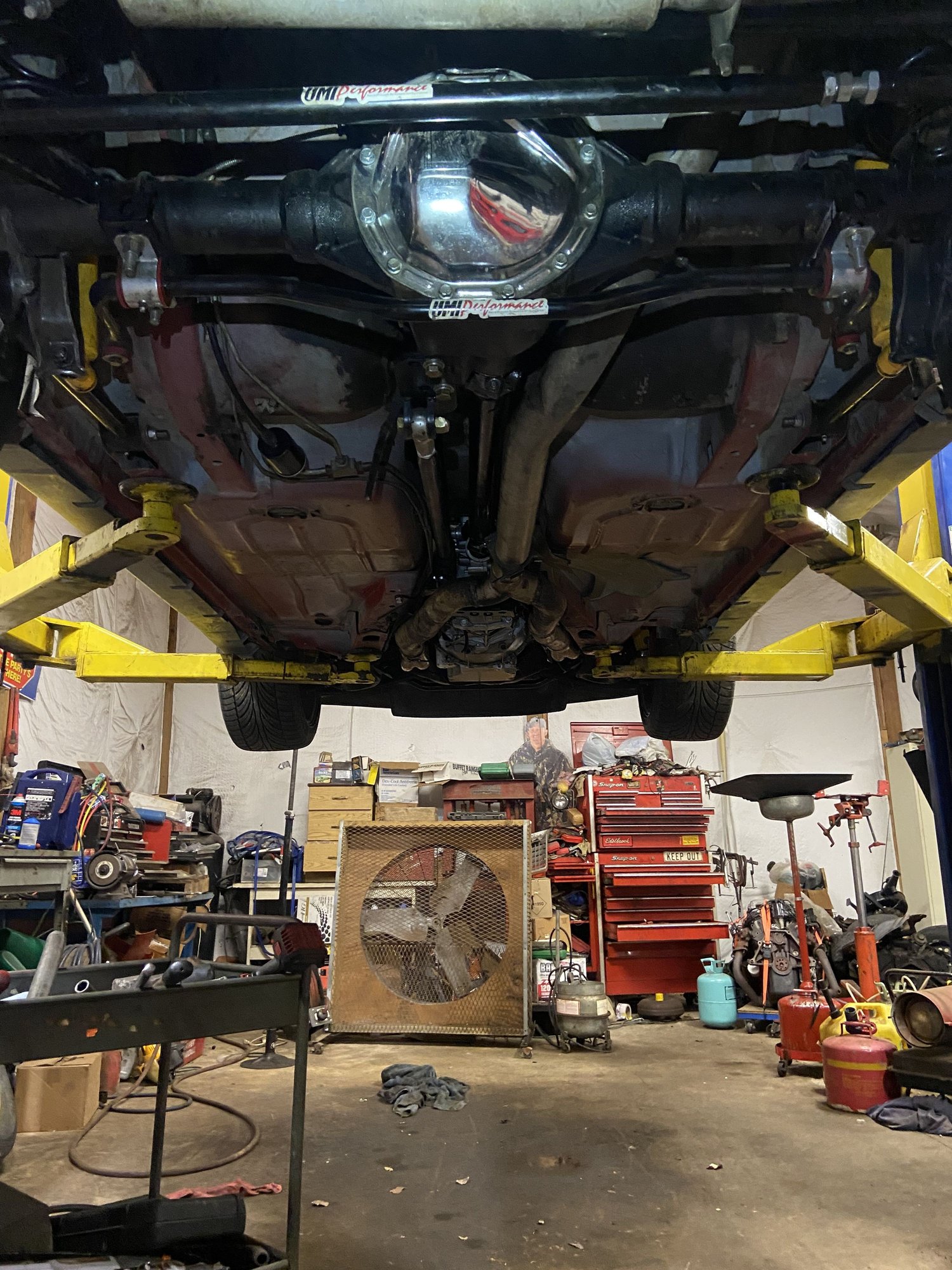

Umi performance stuff - front/rear lowering springs, adjustable panhard bar, adjustable strut tower mounts, adjustable strut tower brace, adjustable panhard bar, panhard relocation bar, subframe connectors. Koni Yellow adjustable struts/shocks

I still need to weld in the sub frame connectors and hook up a tachometer/speedometer, then a bunch of cosmetic stuff. Also have more wiring/cleaning up the wiring to do. It's a bit messy.

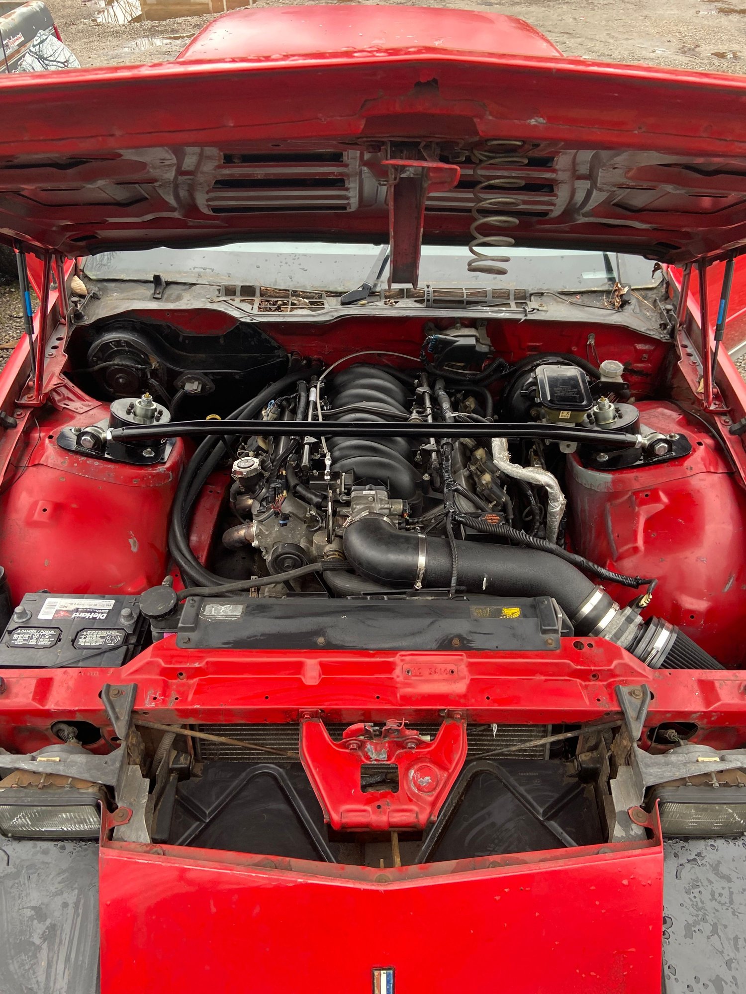

Messy engine bay

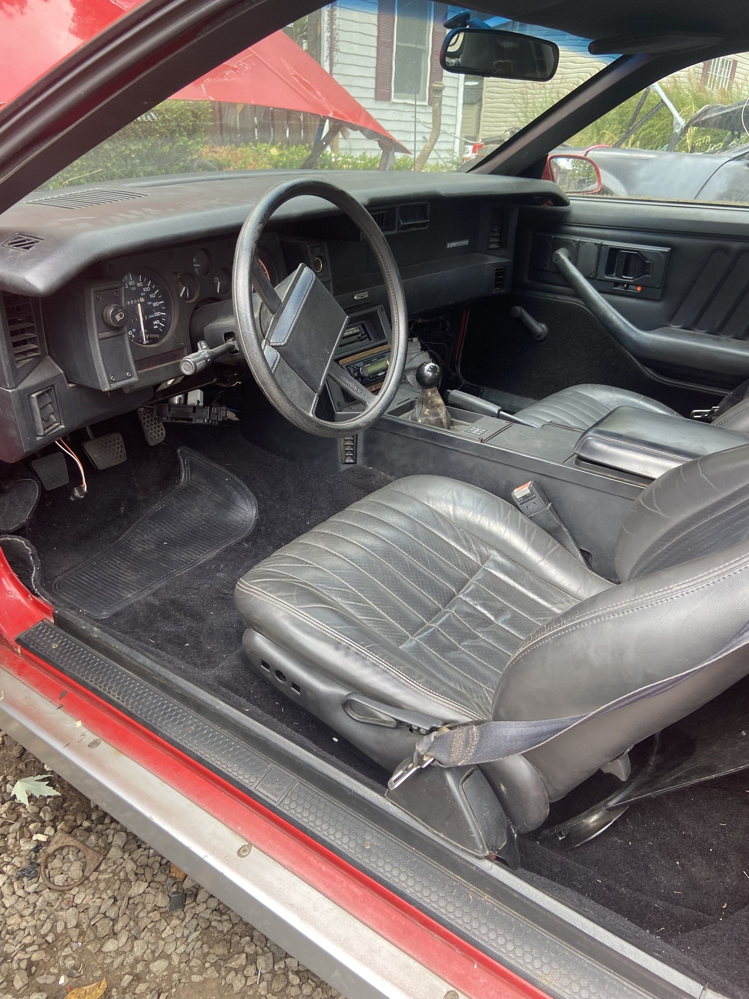

4th gen seats
Cool brakes painted red for more stopping power

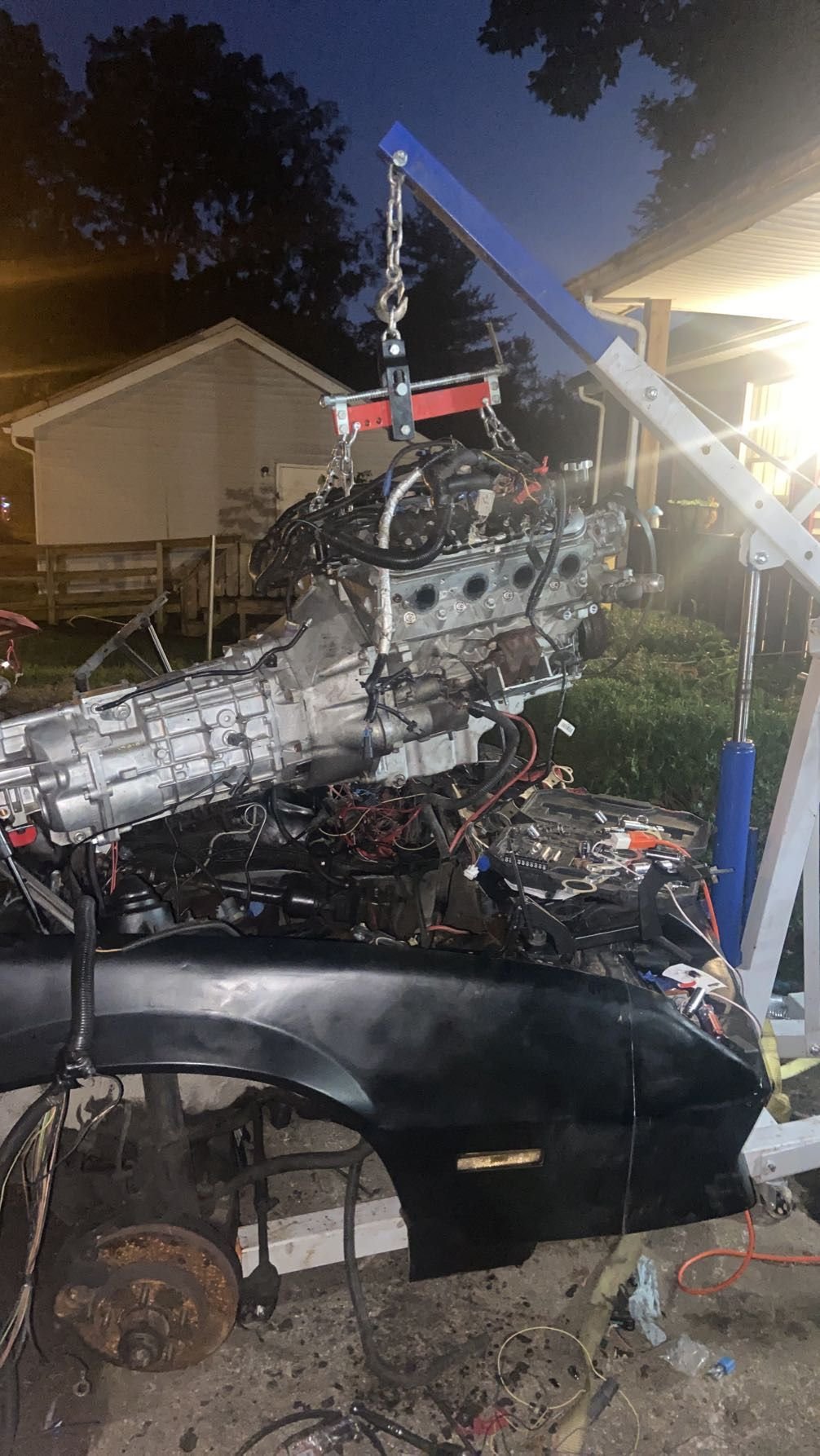

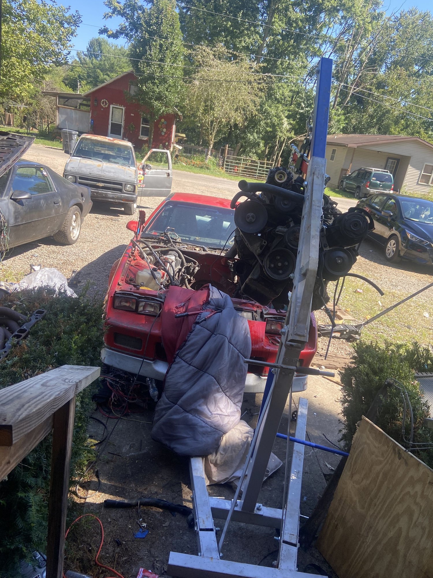

OSHA approved engine removal from the 4th gen
Removing the engine from the junk berlinetta after I accepted that it was junk

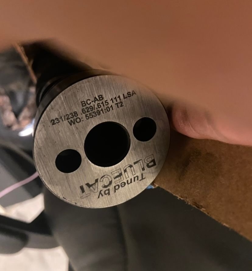

Cam before I put it in
Picture from heads/cam install (did it while the engine was in the 4th gen, wasn't the most fun thing in the world)

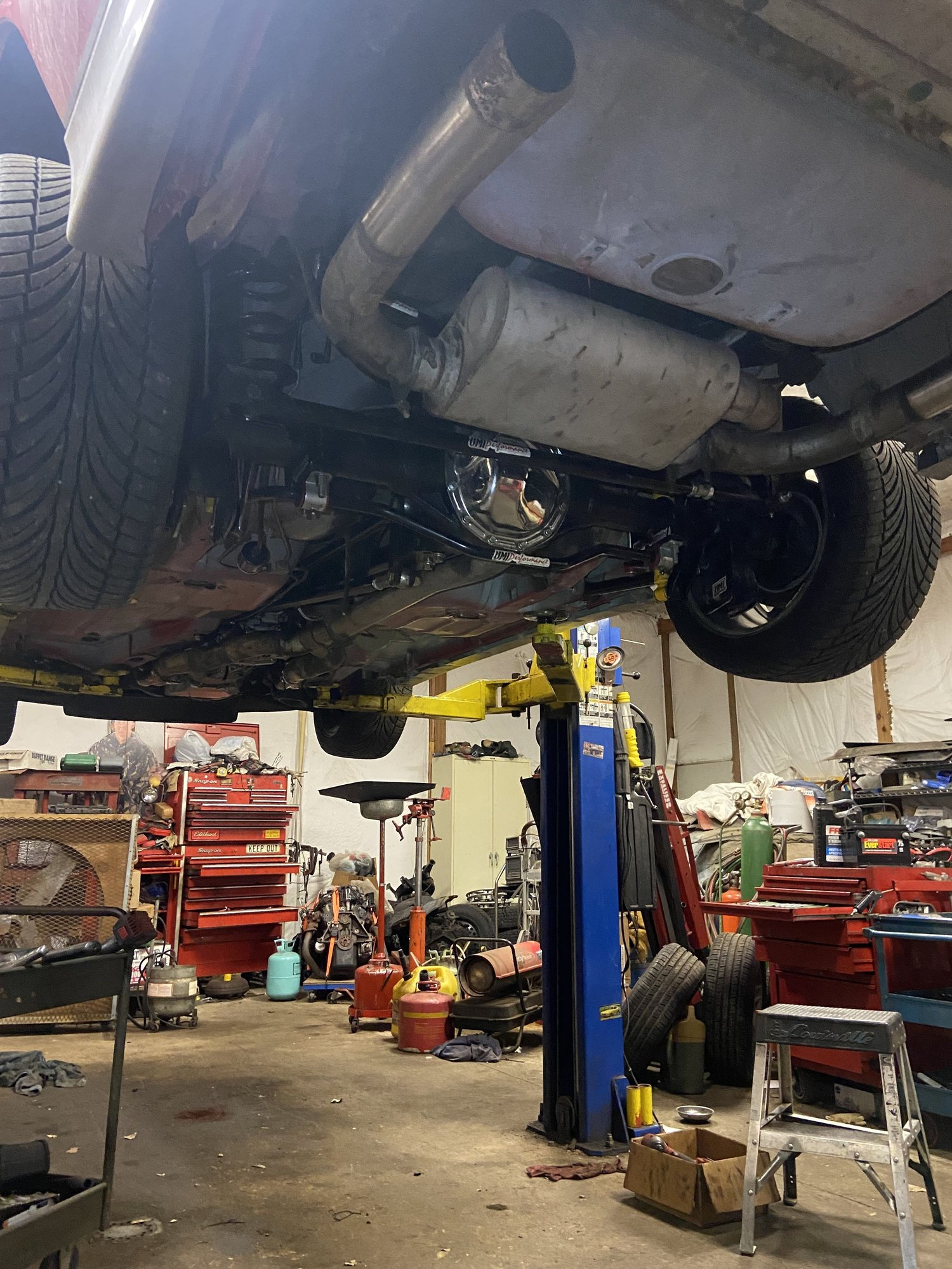

Here's a picture of the header/y pipe area, welds are super ugly was like my 4th time ever. Probably didnt help that i cut the pipe with a grinder and not a single cut was straight, had to fill a bunch of holes with weld as a result. I used a 4th gen y pipe i had lying around and tore that apart to make it

I will say I did need my driveshaft shortened by 1 inch using the hooker system, but I'm not sure if that's just a me problem. Also I welded in those subframe connectors and it feels amazing 10/10 absolutely recommend them

Update to the engine bay, cleaned up some wiring and put in a 4th gen coolant overflow, think i may have screwed something up car struggles to idle a little bit at times, not sure if tps or iac are screwed up or a wires not hooked up
Old Jan 29, 2024 | 07:48 PM
ShiftyCapone's Avatar
Supporter/Moderator
Posts: 13,773
Likes: 567
From: Cincinnati, OH
Car: '90 RS
Engine: 377 LSX
Transmission: Magnum T56
Re: Professional(not even close) Ls swap
Did you have the car tuned after the cam install? If not, that's probably your issue.
