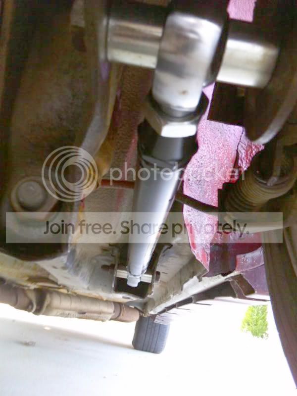

So I did some work on the Camaro to get it ready for an event on the 16th. Basically new control arms and panhard bar. Now my car should be more predictable and actually slide easier in spite of the differential that works half the time.
Here's what I was drifting with...
Replaced by
Old Jul 22, 2011 | 12:59 AM
gideonstyle's Avatar
Joined: Oct 2009
Posts: 9
Re: Drift Camaro
New control arms were very nice to drift on. Made the car so much more predictable. Just needs a diff now, but I'm not sure if I will be keeping this or not. Don't worry I will not be getting a 240sx or anything like that.
