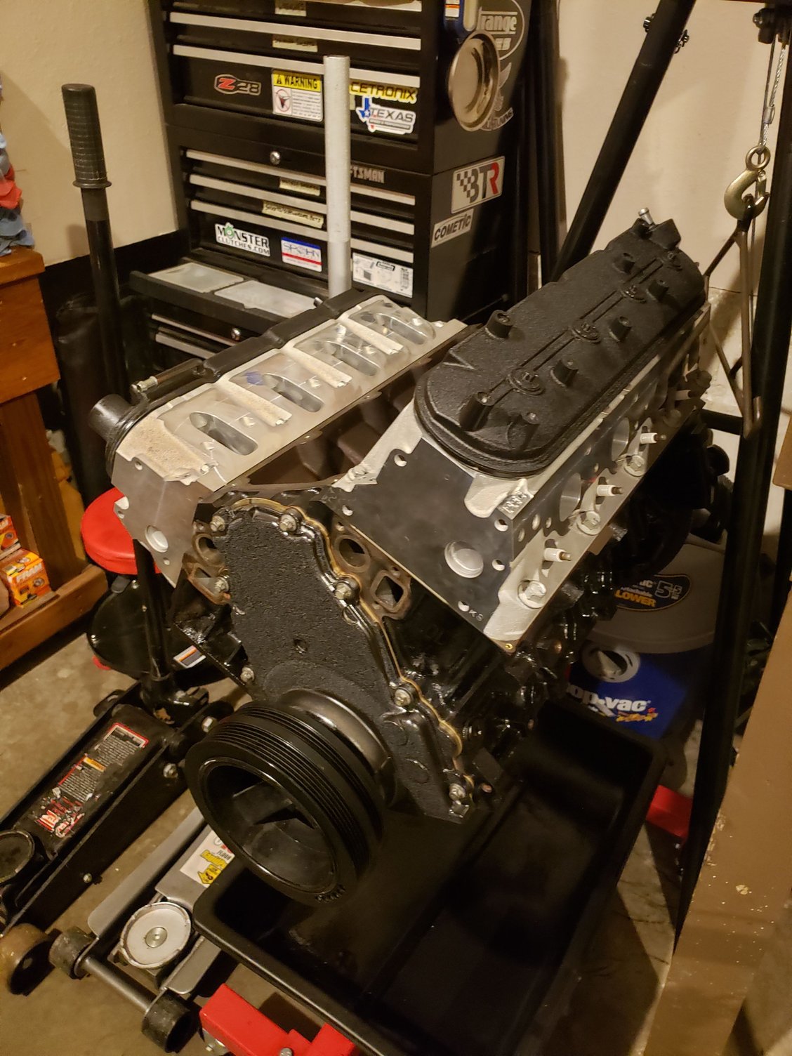

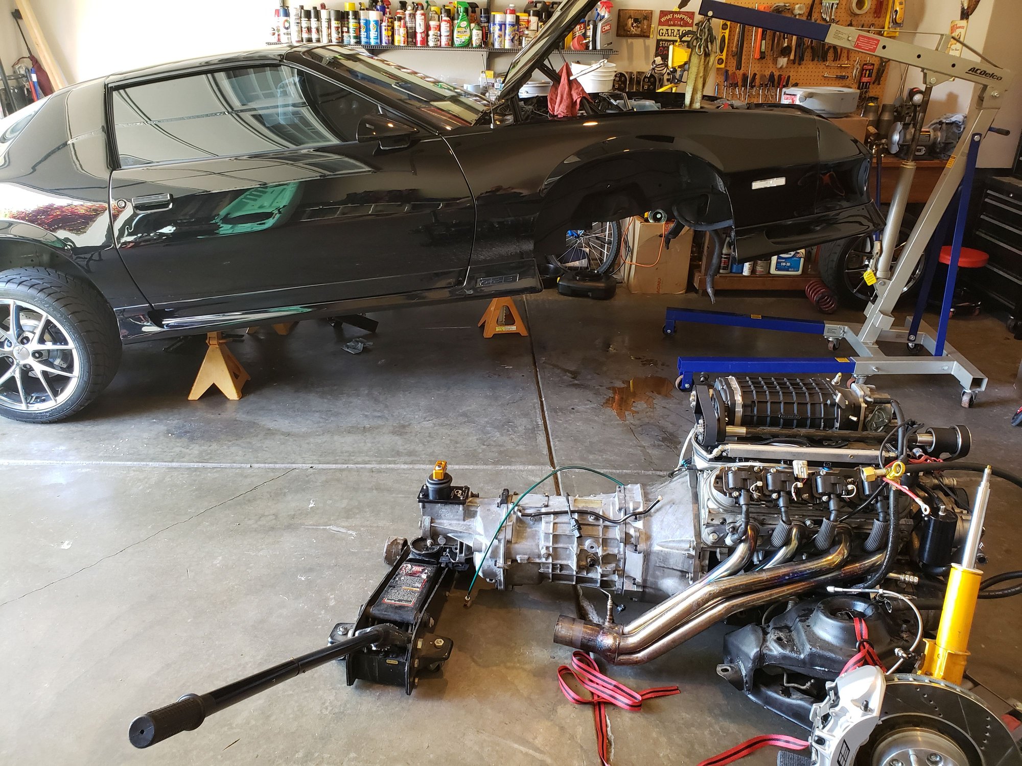

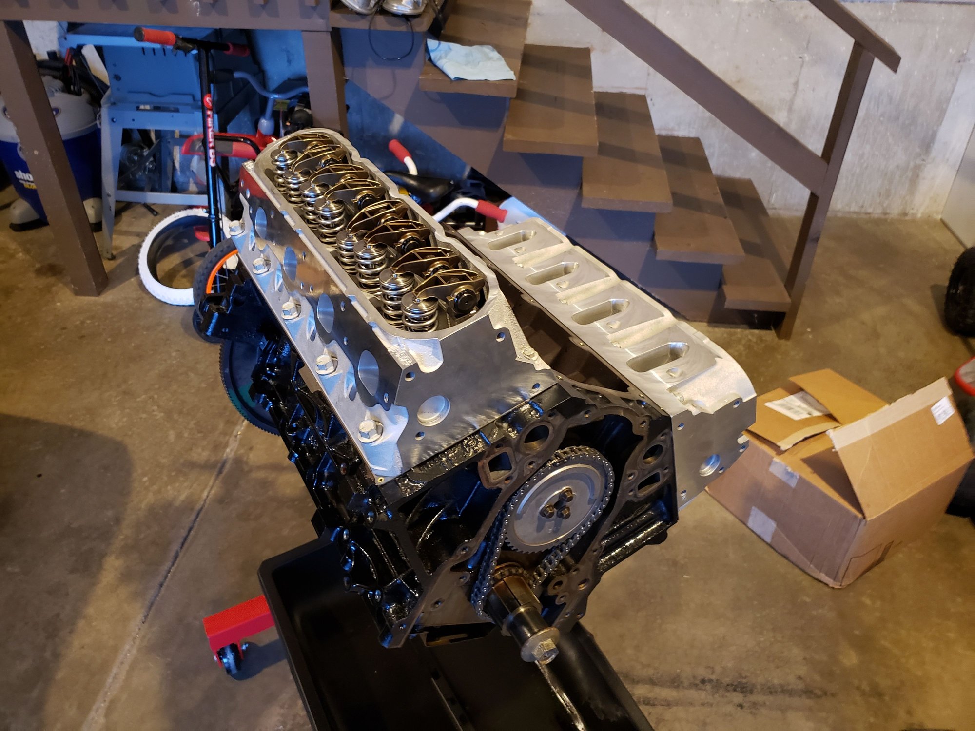

Ls1 is out and a 05 lq4 is in now. PRC 2.5 heads and cleetus McFarland's boost cam.
Out with the old
In with the new.

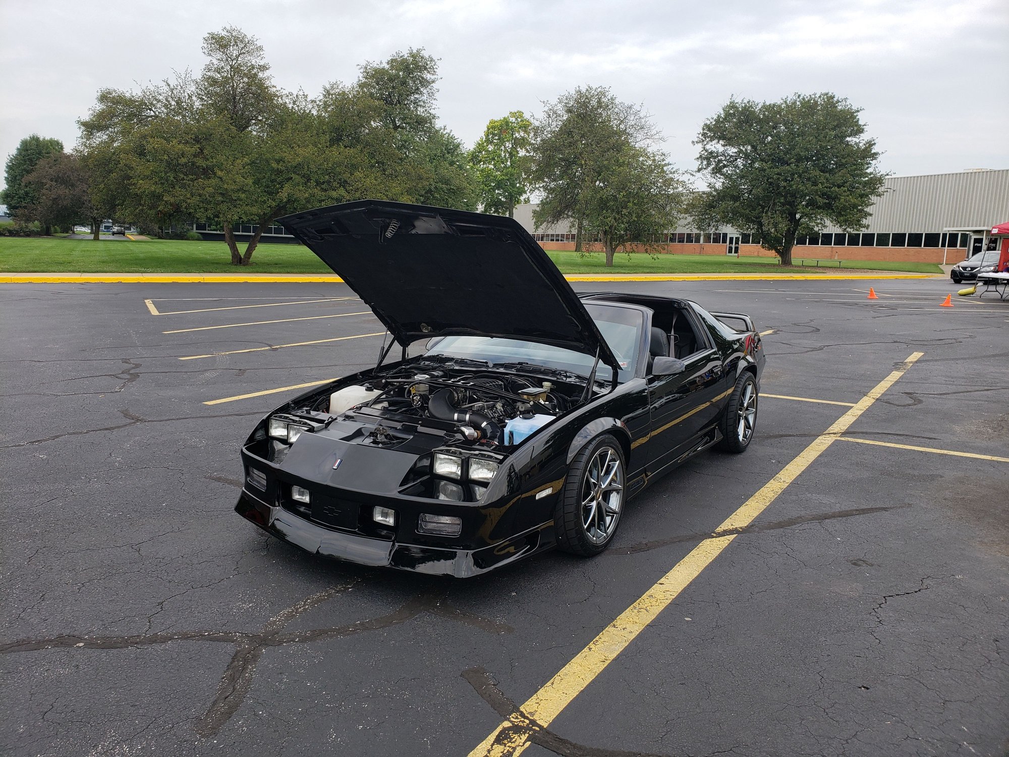

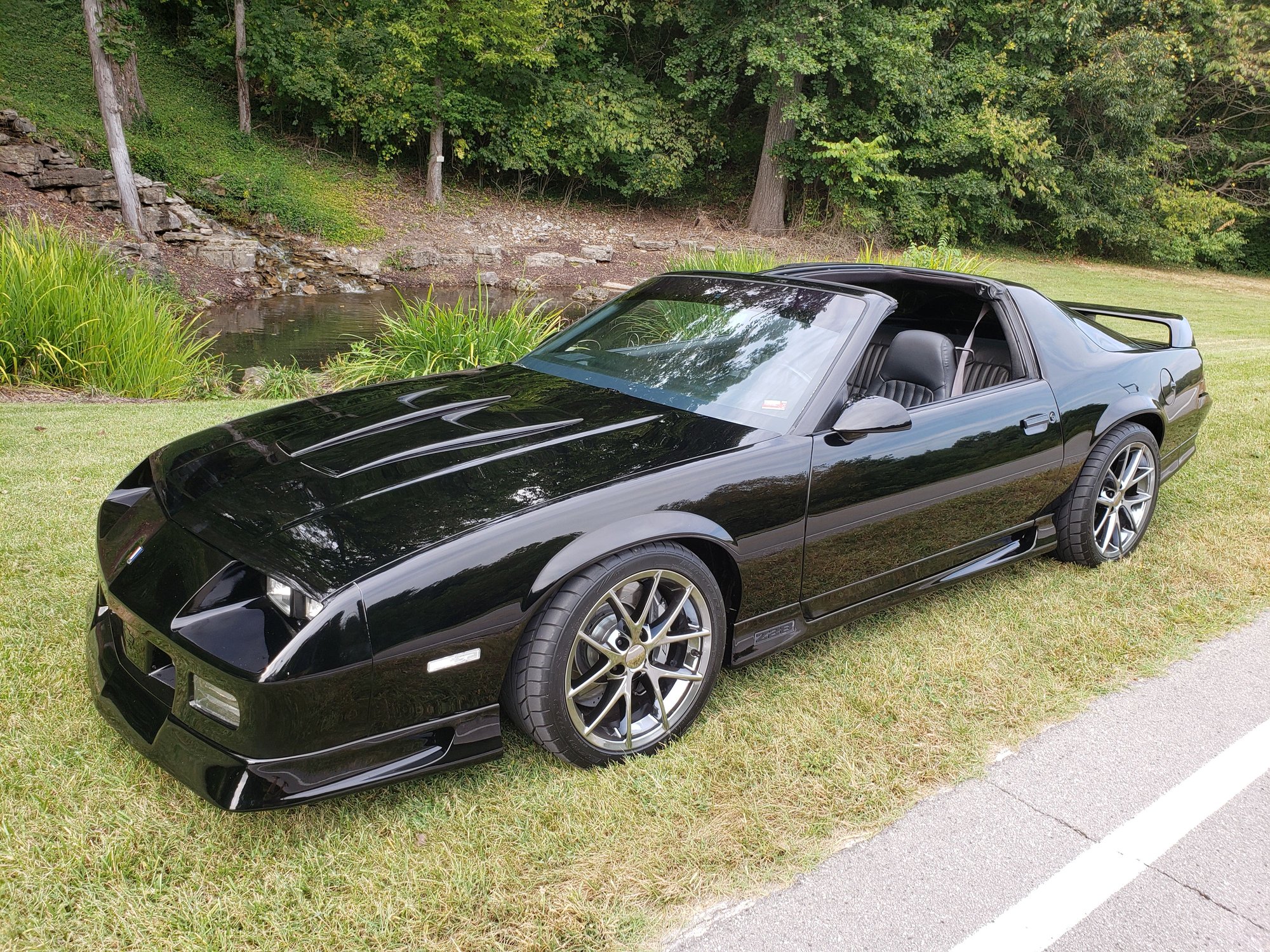

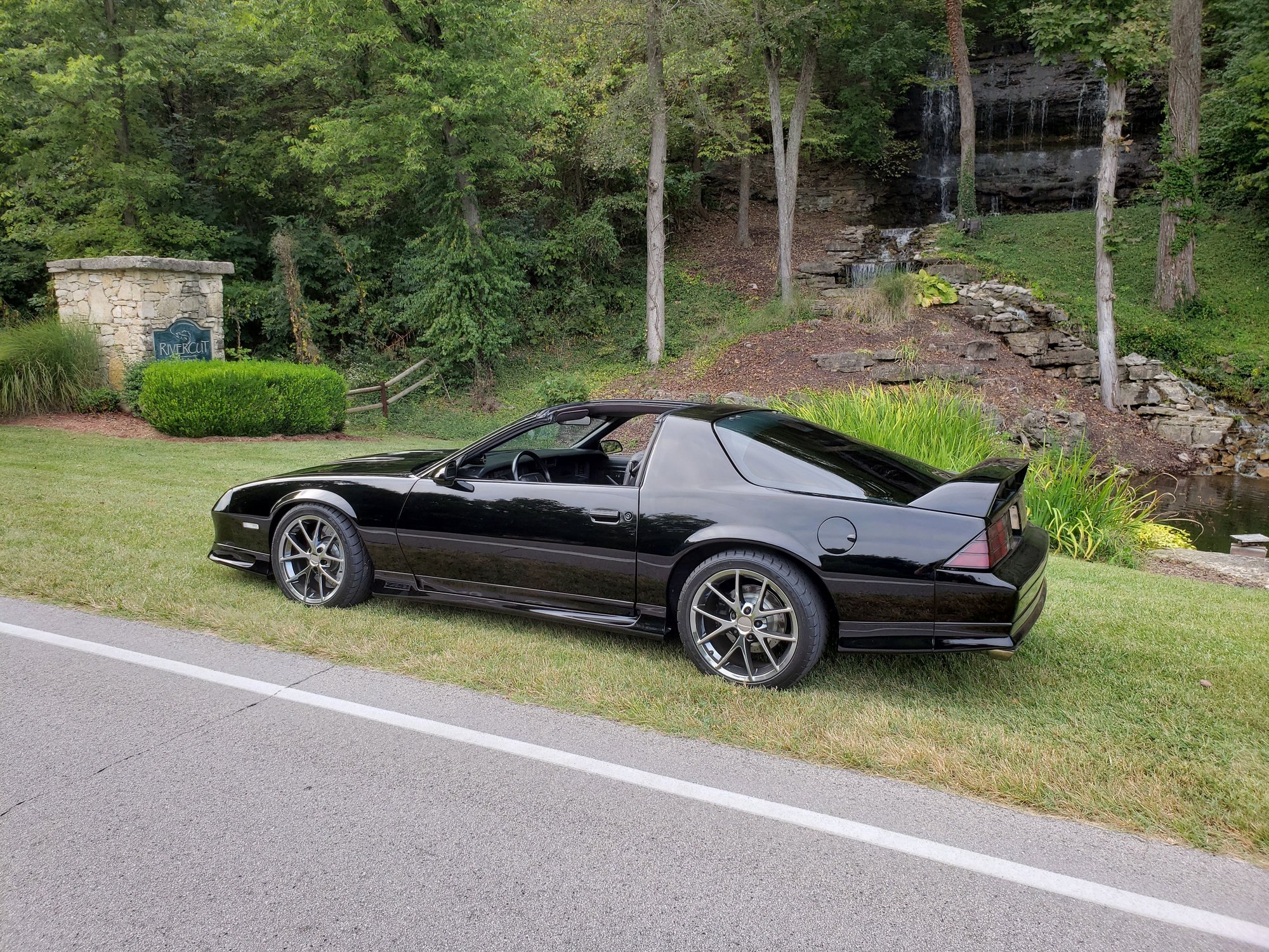

Here are some pics from this last friday. I had a buddy buff the car before i went up to the local cruise in. I also got the taillights done except clearing them.
I love this car!
So let me ask a couple of things:
How did you lower the car? The stance is absolutly perfect in my eyes!
Do you run the same rim width front and rear? Do you use spacers or is it a 4.Gen rear?
Where did you order the front brake conversion kit ?
Thanks man and alway have fun with this amazing ride!

i just have it setting on Eibach springs.
yes front and rear are both 18x9.5 and i have a strange s60 rear 4th gen width so only 1.75" spacers in the front.
front brakes are ls1 bracket with cts v calipers and rotors.

But i´m curious about the springs, because I also had Eibach Sportline for my Iroc with the 5L TPI.
The stance was ok, but when I installed the LS1, which is way lighter than the SBC, the front raised at least one inch.
Didn´t u have the same problem?
Are these aftermarket rims or original GM?
Which tire size are u runnin?
Thx and cheerz, Robert

id did not notice any rise after going to ls1 but it did notice a drop when i put the lq4 in.
aftermarket wheels. tires are nitto 555 275 35 18.
