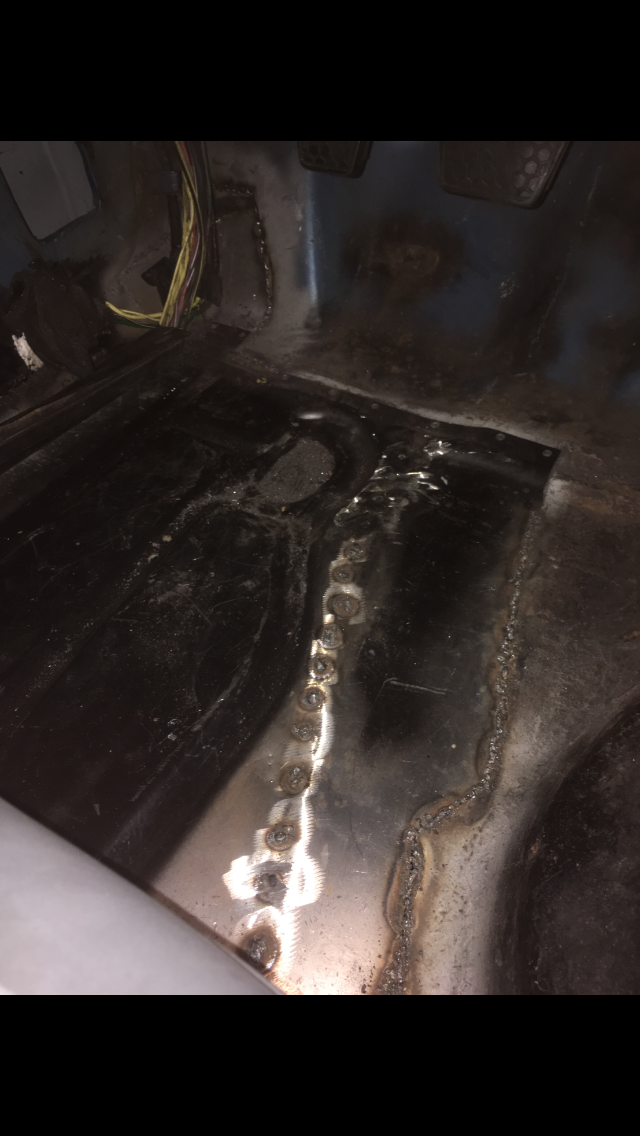

Before anyone complains about my welds- I just got a welder a month ago and don't know too much on using it. The back side of every piece was sprayed with weld thru primer before being patched in, and it was all coated in POR 15 and seam sealer when I finished
Edit 8/5/16- Re Welded this area to be stronger and look better. Turns out the welds did not come out right due to an empty welding bottle...

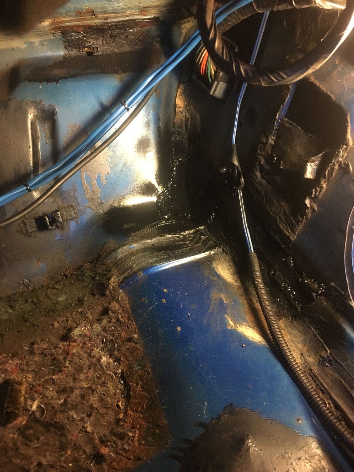

And here are pics of the new floor, rear has been welded and seam sealed since this picture, and the front floor has more spot welds and bead left to do

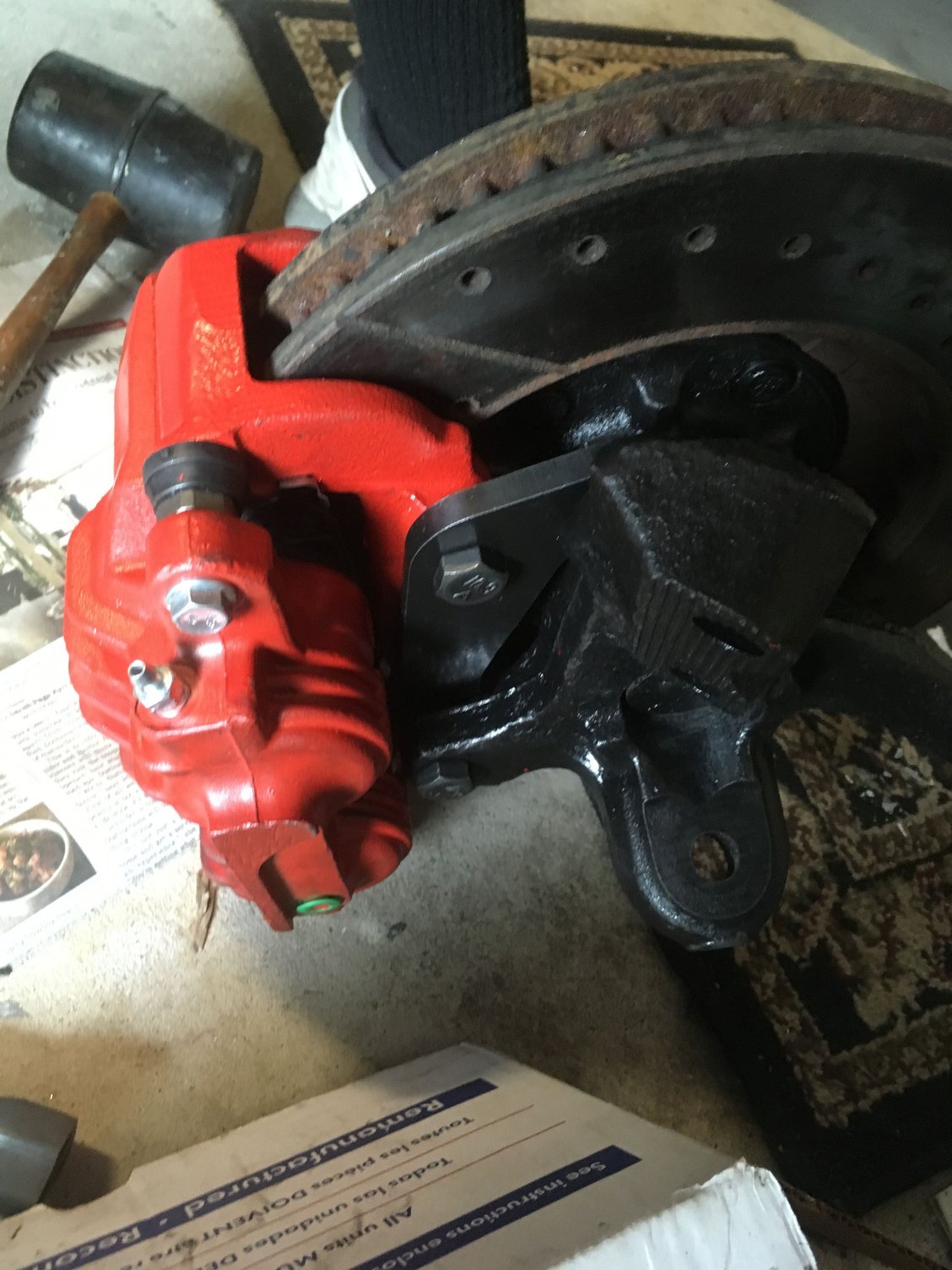

Here are some pics of the new brake setup, got the hubs and brackets from BBU.com and modified the spindles myself. Also took this opportunity to install new control arm bushings, ball joints, lowering springs, Founders strut mounts, and KYB struts.

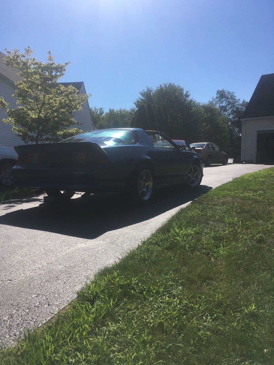

Thanks! I went through a lot of trouble getting them without losing my shirt, between selling my 3rd gen offset wheels and buying 4 brand new tires, I am only into wheels and tires for about $750!

Thank you, I take a lot of pride in my ability to cut and shape the metal using only a hammer, grinding wheel, and block of wood. My welds on the other hand could use some work, but it has definitely been a big project and I have plenty of welding left

Eastwood MIG 135. I get really good welds when I have the heat turned up a bit more than recommended, along with the right amount of gas. The manual says it should be at 25 (Not sure of the units) whenever I pull the trigger, so I leave it around there. Just take it slow and practice a lot before touching your car. First time I handed my dad the welder he burned a nice big hole into my rear quarter
Old Aug 6, 2016 | 01:48 PM
  #65
Billgluckman's Avatar
Joined: Jan 2015
Posts: 565
Likes: 47
Re: First Car - 1991 RS
I've practiced 3 days and the welds have improved greatly. I'm just running flux core though. I don't plan on doing much welding on my car other than exhaust hangers so I probably won't buy gas any time soon.
Old Aug 6, 2016 | 01:50 PM
  #66
Joined: Jan 2015
Posts: 565
Likes: 47
Also, I'm def no pro or even remotely experienced but have you tried adjusting the wire speed at lower voltage?
I wasn't really understanding what was happening at first and my welder was spitting and sputtering. I had the wire feed speed wrong. Too fast and you're poking the surface, too slow and you're running out of wire/filler.
Old Aug 6, 2016 | 02:24 PM
  #67
-=Z28=-'s Avatar
Joined: Mar 2015
Posts: 1,072
Likes: 48
From: Minnesota
Car: 84 Z28
Engine: 383 Stroker
I'd run your gas as low as you can with out having it blow away in the wind. I believe we run around 12-14 on out hobarts. But when outside and windy, have to turn it up. I recommend practice welding on a piece of metal the same thickness and having it as hot as you can w/o burning through. You can watch the steel melt and flow and start to cool and loose its glow, then bump it again, repeat. I generally bump weld thin steel if I'm not tig welding it. Make sure your ground is GOOD. You dont need it right next to you. Anywhere really. But out of your way. When welding thicker steel you want to hear a constant zap zap zap, about 5-8 zaps a second, but at a constant rate. Also a good investment is a good welding helmet. Speed glass is nice but they are kinda heavy when welding upside down. What I like the best is you can adjust the darkness and speed of fade. Different welding styles, stick, tig,mig all have different levels of brightness. I believe stick is the brightest. Make sure to protect your eyes. You will know it when you burn them. Just like burning your skin but your eyes instead. Some other welding tips is check out youtube. LOTS of great videos but honestly the best is practice. All the great welders I know learned on their own.
Keep up the good work, You are an inspiration and remind me of myself and how I learned all my skills.

Just looked at your welder. I was referring to the gas regulator adjustments. Not amps/power. You can use what they recommend but it usually is never right, close but not right. Another thing that is crucial is clean, mig welders need clean surfaces. If there is paint on either side it will burn crappy, rust, crappy, needs to be clean clean steel. I highly recommend youtube and practice welding on dads mustang! LOL JK, but seriously, weld on a junk fender or a body panel. Also, learning to weld upside down is way harder than welding upside right.

Wire speed and amperage is the key. You want a constant zap. Having control of the gun is very crucial. Leading into or away has been a controversial topic among welders. Do what works for you.
Thanks! I've gotten better with the welder since these pictures were taken, hopefully I'll get some more work done on it tomorrow night. And believe it or not I will get some practice on dads mustang because he wants to put sub frame connectors in it, and last time he welded he burned a hole in my car and I banish him from using it near my car... Stay tuned, thanks for all the advice!

Last night I welded in a piece to patch the rust below the firewall created by the previous owner drilling holes for alarm wiring, and not using rubber grommets, causing water to slowly drip onto the metal for the past 15 years

Much better welds now, the upper half will not be welded because of its close proximity to a lot of dash wiring and insulation. Too risky. At this point, the piece doesn't move around anymore, so it will be painted then seam sealed where it is not welded. And the gap at the top is much smaller than it looks in this picture, about 2.5mm wide at most.

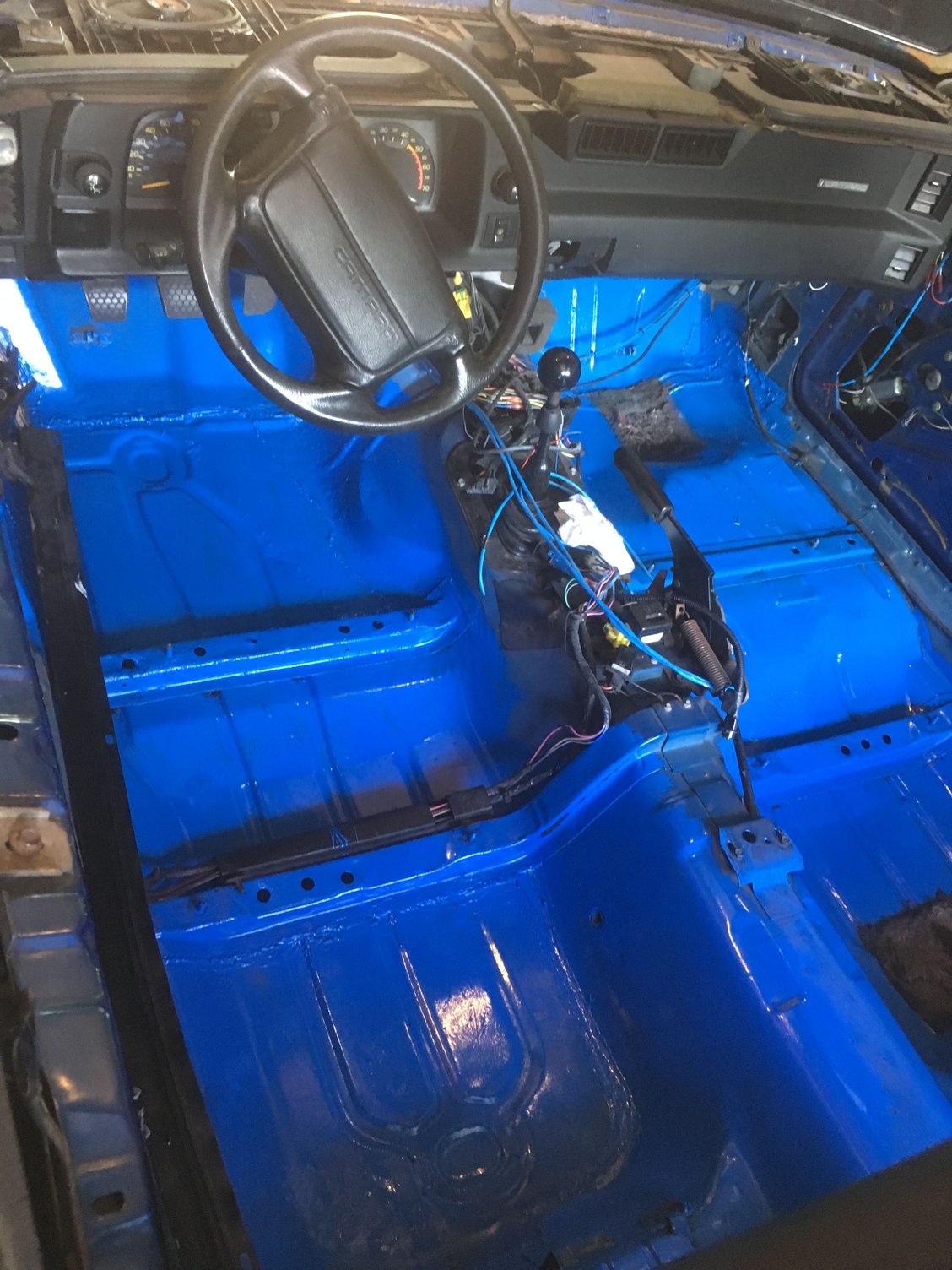

Update- Finished the floor, just need to seam seal and rust proof the whole thing

Big update for this weekend. The interior was stripped of paint and ground down and snaded with 36 grit sandpaper, then painted with POR 15. Then over the top of it a layer of rustoleum blue, then started to get part of the interior installed.

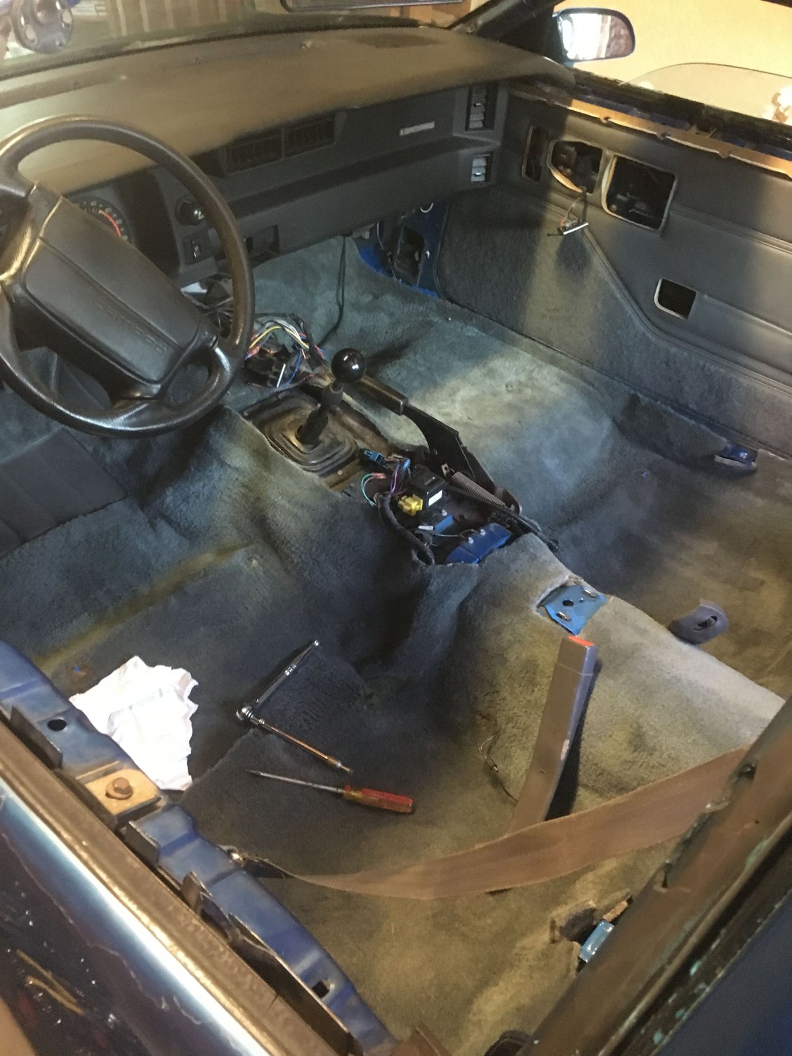

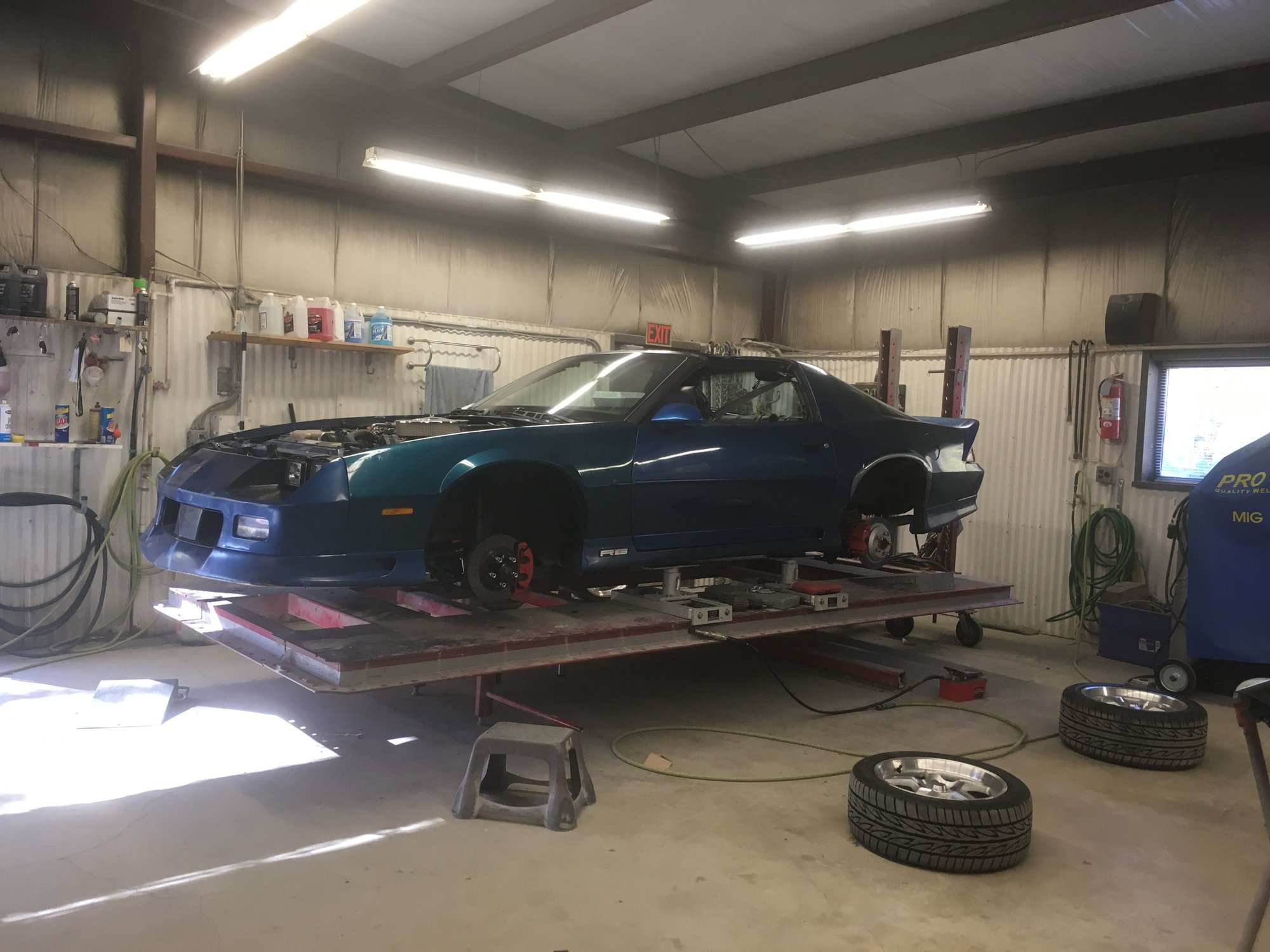

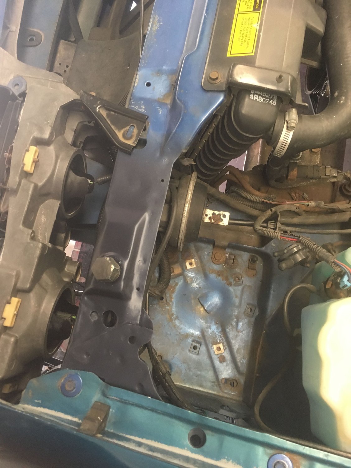

Lots of updates for today. To start off, I got a real job a month ago to start saving up for paint. Up until then, I just sold parts to make money, which was slow and I'm an impatient guy. The biggest update is that the car is officially registered for the first time in 5 years. My stepbrother bought a car, and adding his insurance to the family policy would've been 500ish per year, but if we added both his car and mine, it dropped down to 440 a year for both cars. So after working on it for nearly two years, I finally got to drive the damn thing. Overall it handled great, went over bumps great, sounded great, and ran great. The issues I'm having with it now though are lack of funds for paint money... along with really vague steering. The tie rods, centerlink, idler arm, and ball joints were all replaced, so I am leaning towards the steering box being bad. The rag joint steering shaft seems really good, but I'm replacing it with a jeep Cherokee shaft just in case. If anyone has any ideas on what the vague steering could be, or where I could get a new, correct steering box, please let me know.

Updates for this past weekend include a number of things. Before I got the car, the previous owner was driving it in the rain, couldn't stop quick enough, and hit the car in front of him. If you look at the first pictures I posted in this thread, you can see the damage on the drivers side. It also caused damage to the radiator support. I took the car to my friendly local shop and together we disassembled the car and pulled out the dent in the radiator support.
Old Oct 23, 2016 | 01:49 PM

I also re bled the rear brakes and installed a new spring for the prop valve. The car with its 4 wheel disc LS1 brakes now stops nearly as quick as dad's 2011 mustang. And will stop quicker once I learn more about using non ABS brakes. The car is now also getting ready to get it's dents removed, the right way. I am picking up a hammer and dolly set tuesday, and I have 3 different types of 3M body filler coming in from amazon over the next week, along with brand new weatherstripping. Also, I will be rebuilding the steering box next weekend and installing a jeep Cherokee steering shaft, so big things coming up.

Here are some pics- Having a license and registration are great things.
