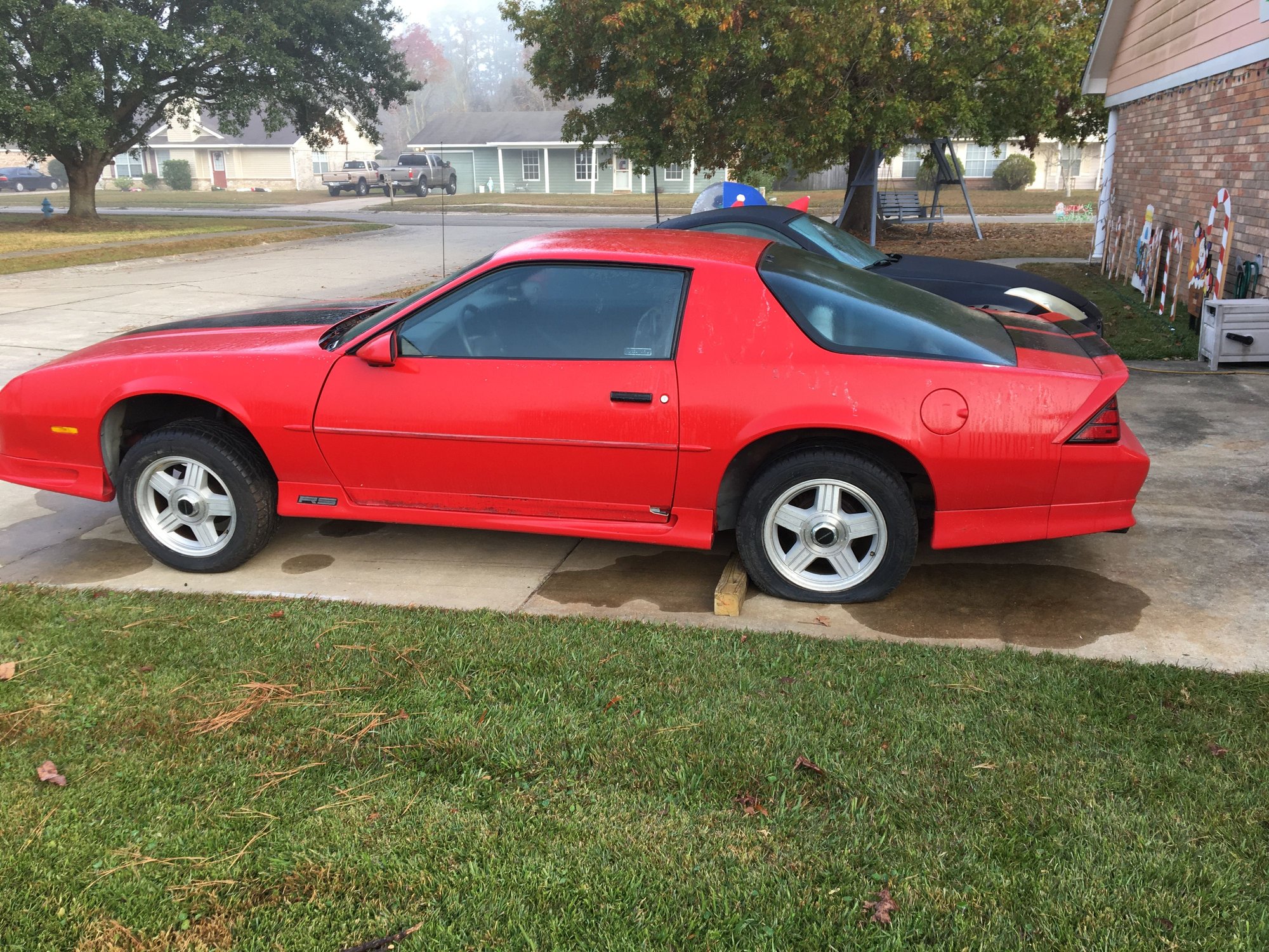

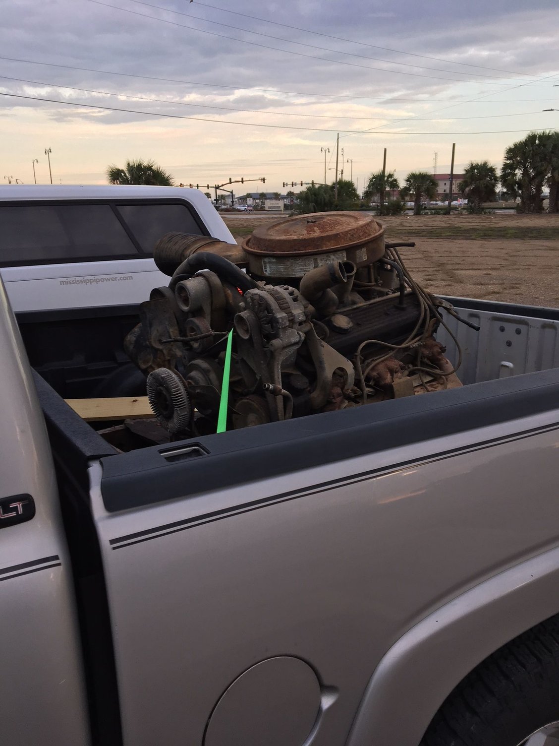

Anyway, he and I picked up this '92 RS in early December to build into a potent little street car. We bought it as a roller and have a lot of work ahead of us. The previous owner included a TBI 305 that he planned on putting in the car, but we found a TBI 350 to rebuild. We also picked up a 700R4 from craigslist to rebuild.

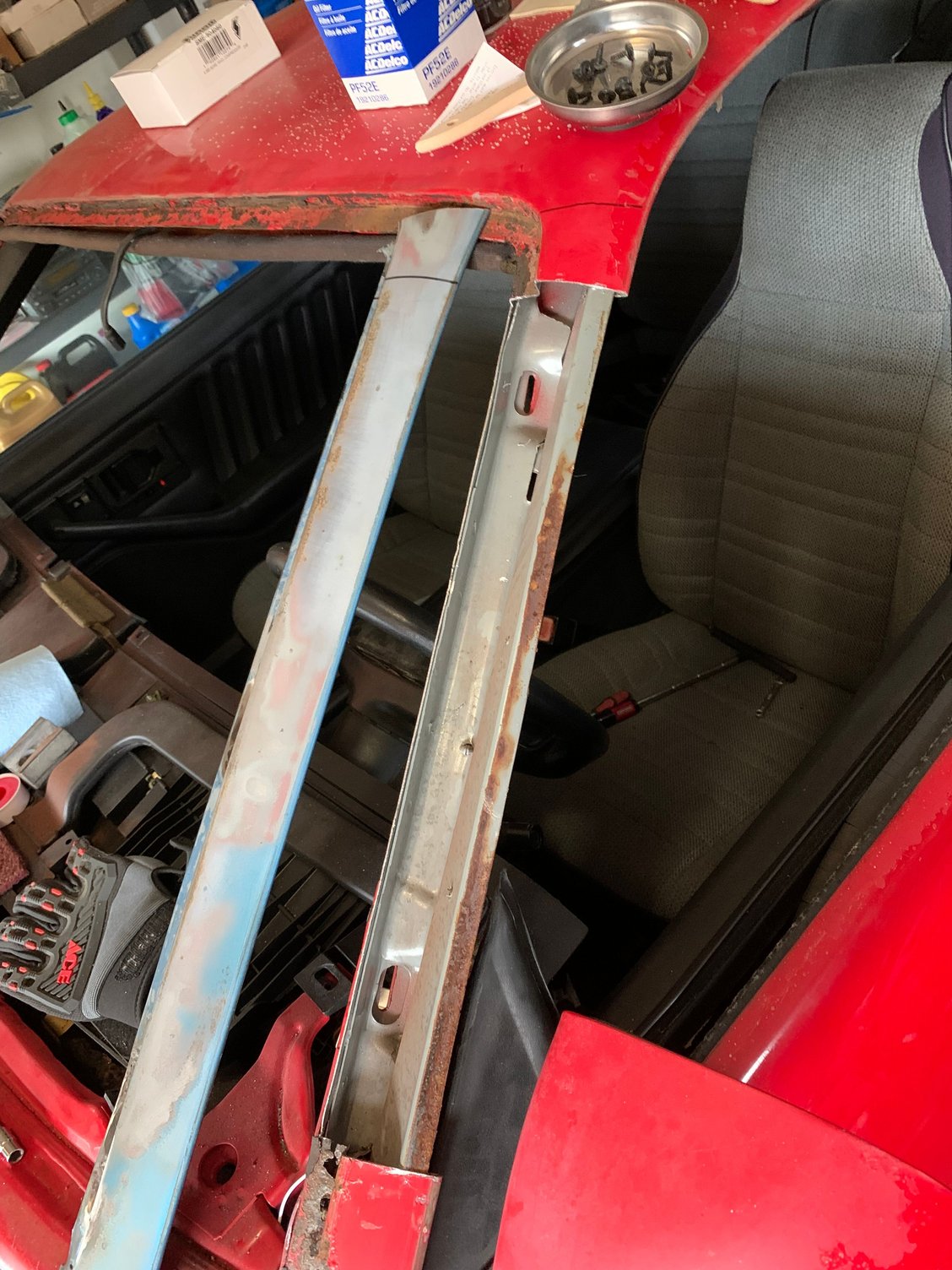

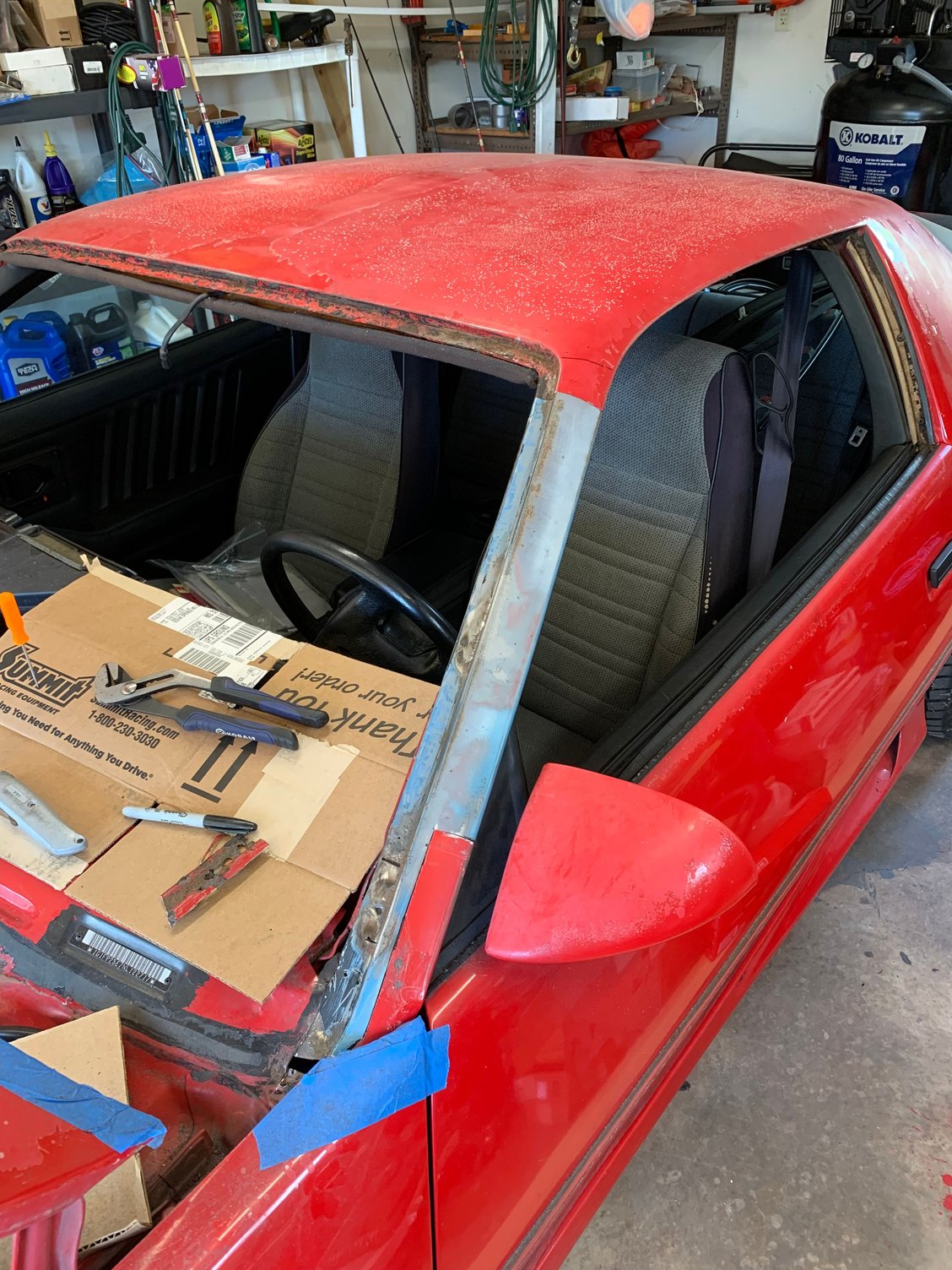

The interior is in good condition, a little elbow grease and we decided to leave it as-is for now. The body is as straight as an arrow and is solid with the exception of the A-pillars. Both A-pillars have holes rusted in them, so we'll be looking in the wrecking yards for a car with rust free pillars to use for patch panels. The paint is in bad shape, but we'll worry about looks later on after we have it roadworthy.

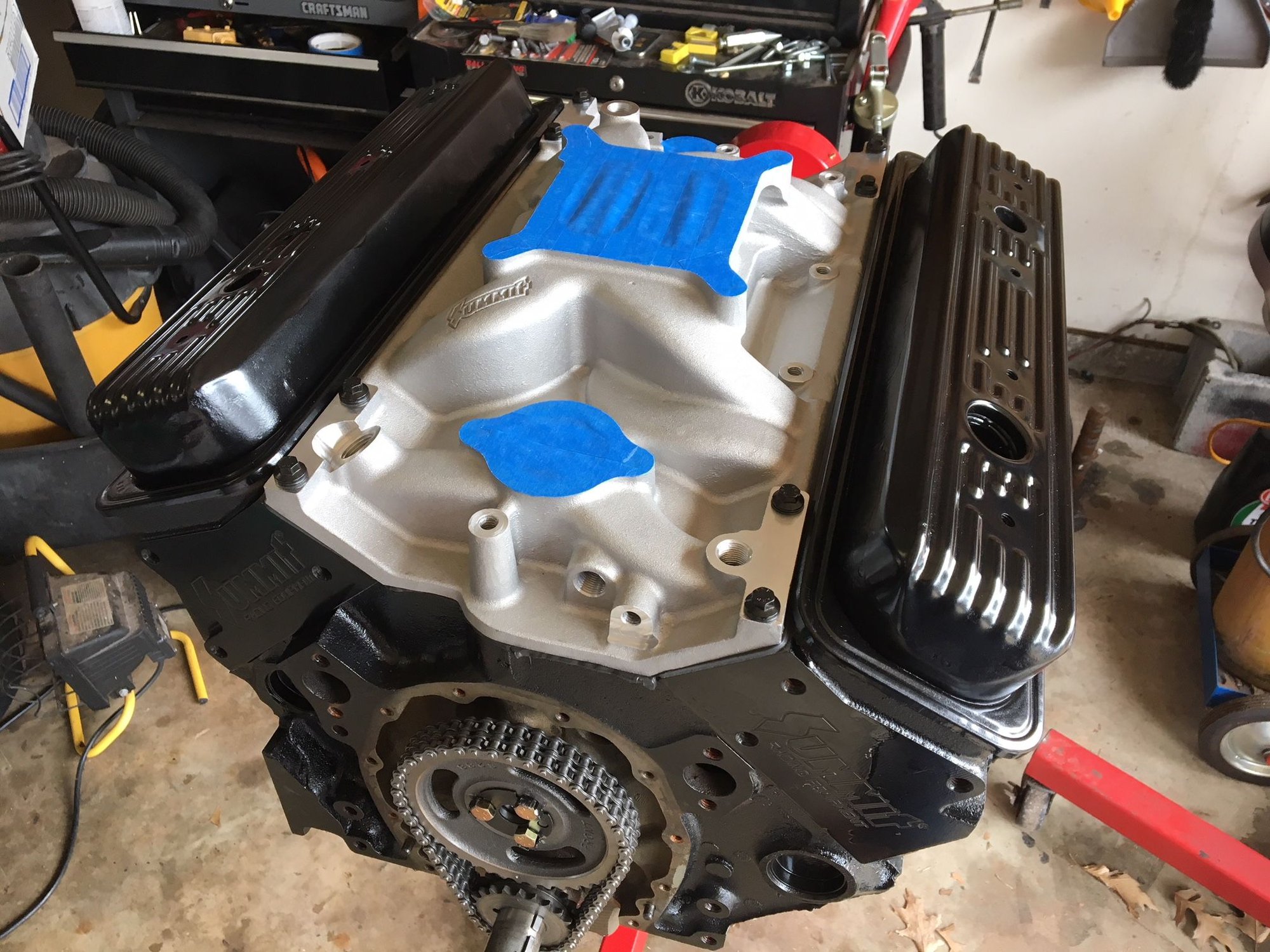

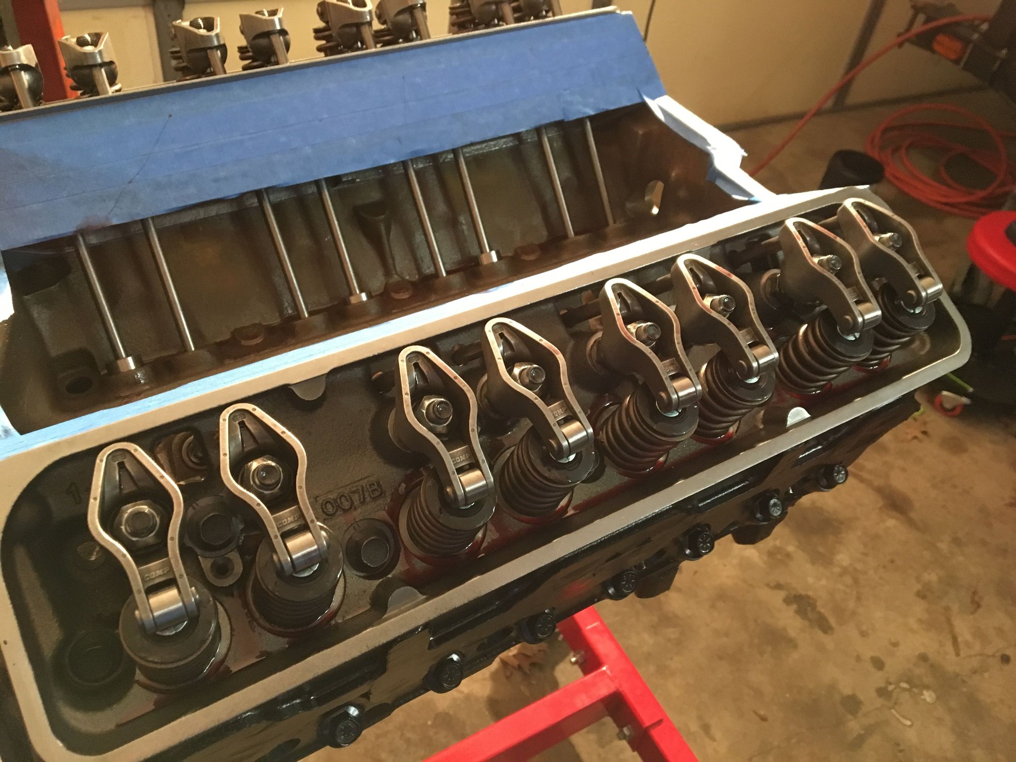

We had the block bored .060", and assembled it with flat top pistons w/2 valve reliefs, stock crank and stock rods with ARP bolts.. A Comp cams XE274 cam was chosen since we wanted to stay somewhere between wild & mild. Comp lifters, springs, pushrods and rocker arms finished up the valvetrain. A set of Summit (Dart) Vortec heads and a Summit (Weiand) Stage 1 intake with a Holley 670 CFM Street Avenger carburetor top it off. Hedman long tube headers will direct the exhaust gases to the rear of the car. MSD's Streetfire HEI will give us the necessary spark.

Our new (to us) project!!
TBI 350 in need of a rebuild.
Long block assembled
We're getting close now!!!

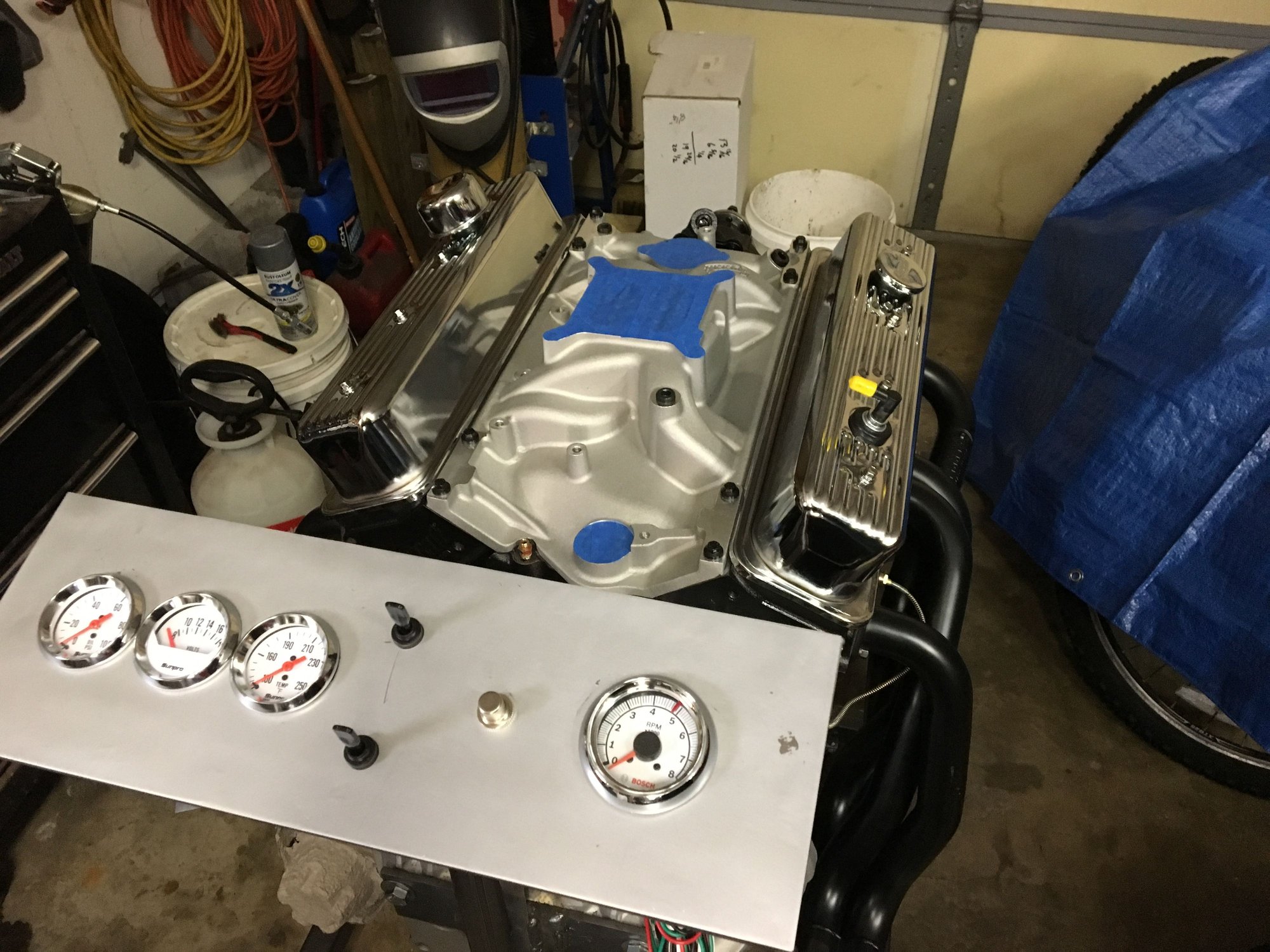

We're making progress, the engine is on the test stand. We should get everything else done this week and break it in this weekend!
On the test stand
Won't be long now!

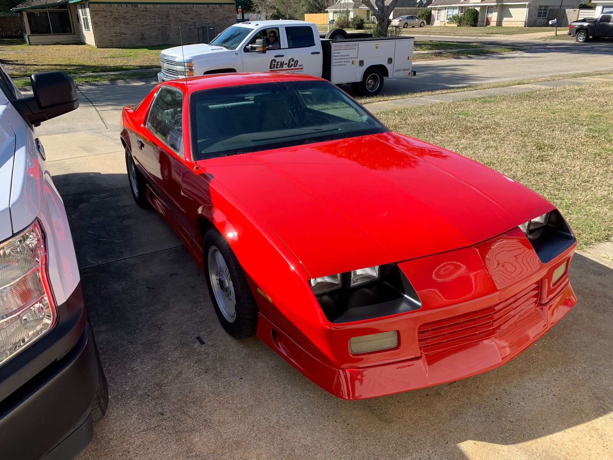

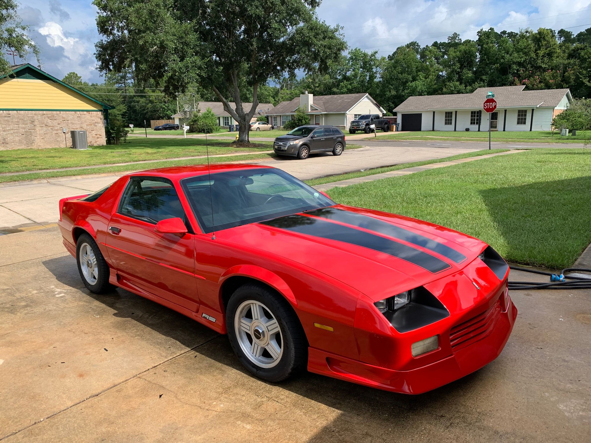

I took so long to finish this project, that I had forgotten about this thread. Two replacement A-pillars, a lot of sanding, a little paint and a few decals later we called it done.
Patch panel from our donor car.
Donor panel still had some holes to weld up, but much easier to repair than the originals.
Paint is finished.
Paint is finished.
New decals and emblems all around.
