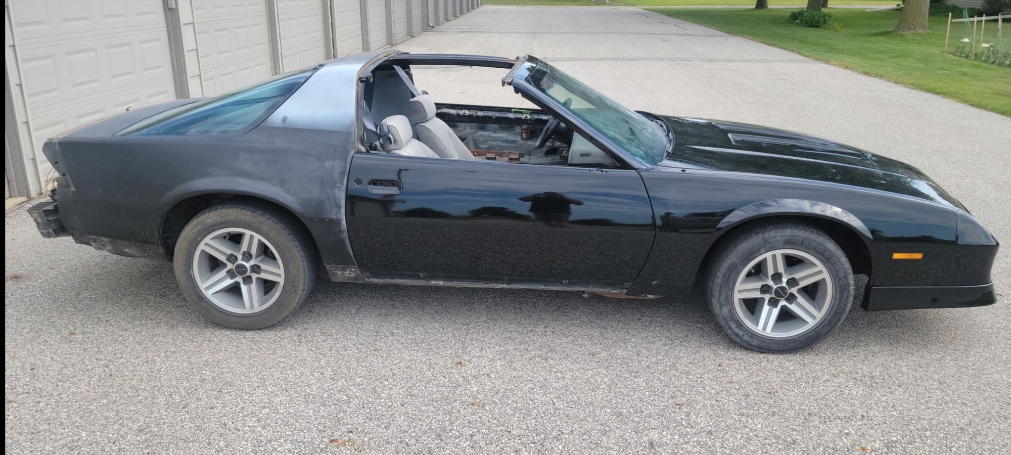

I really like this pic; it's a portent of greater things to come.
Good deal on your constant efforts to bring these cars back from the dead.
Thanks man!
The car is currently in the exhaust shop getting a new 3" exhaust system

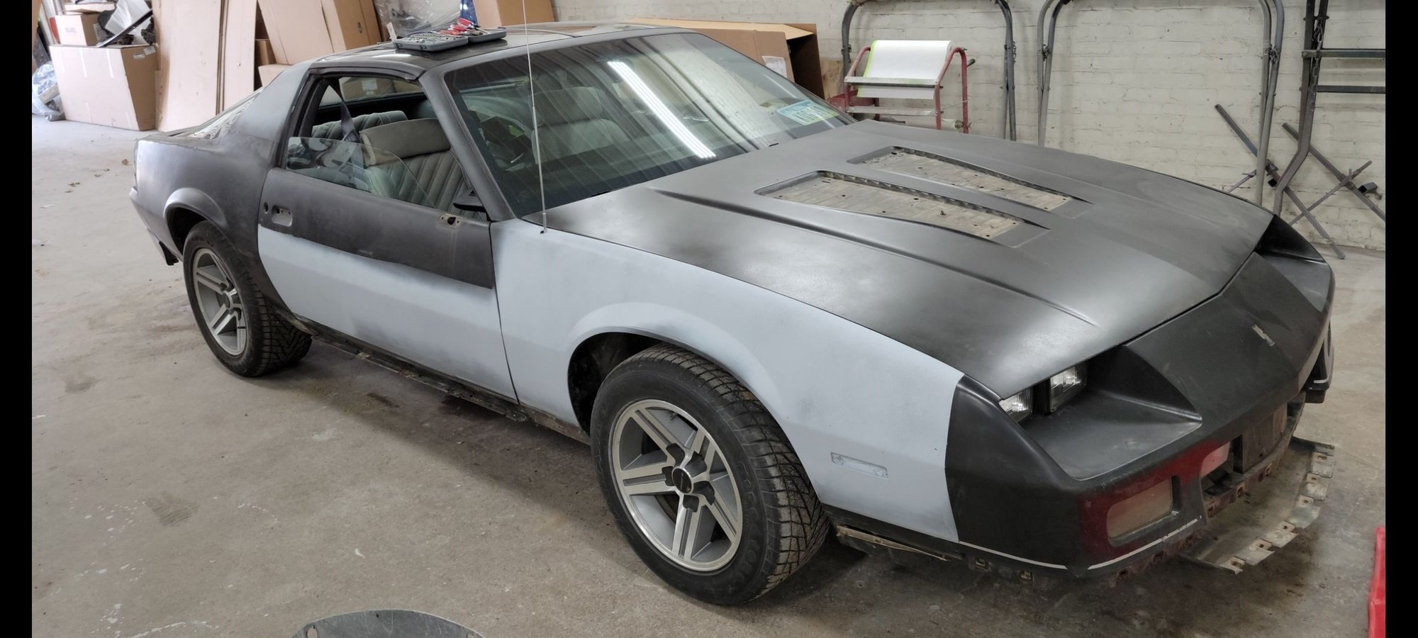

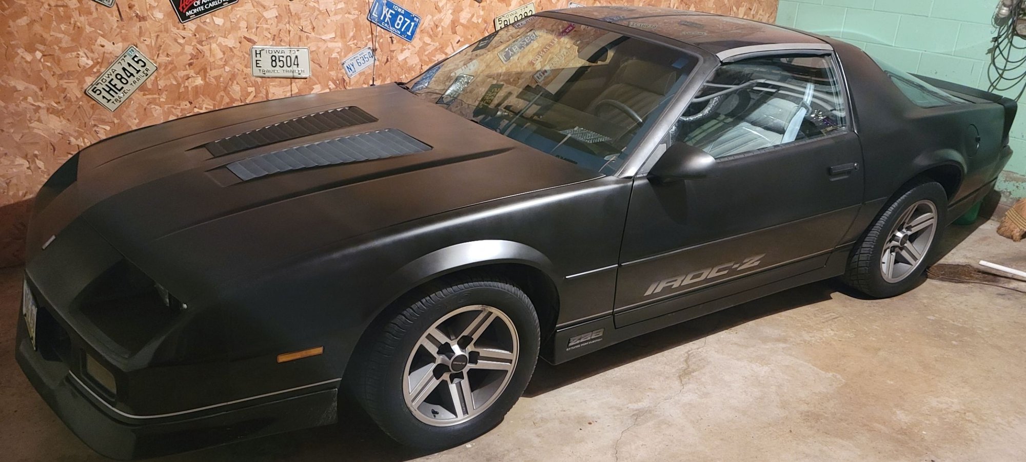

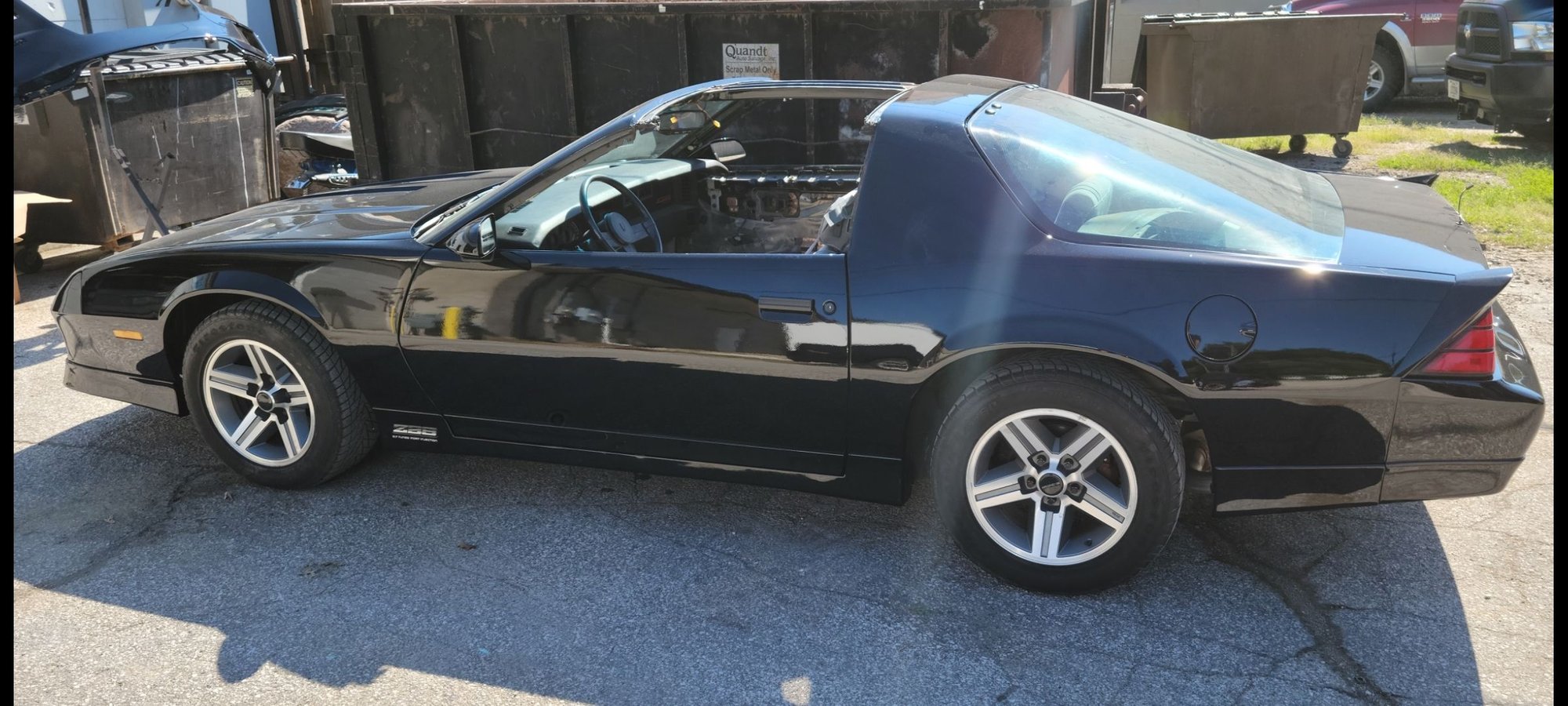

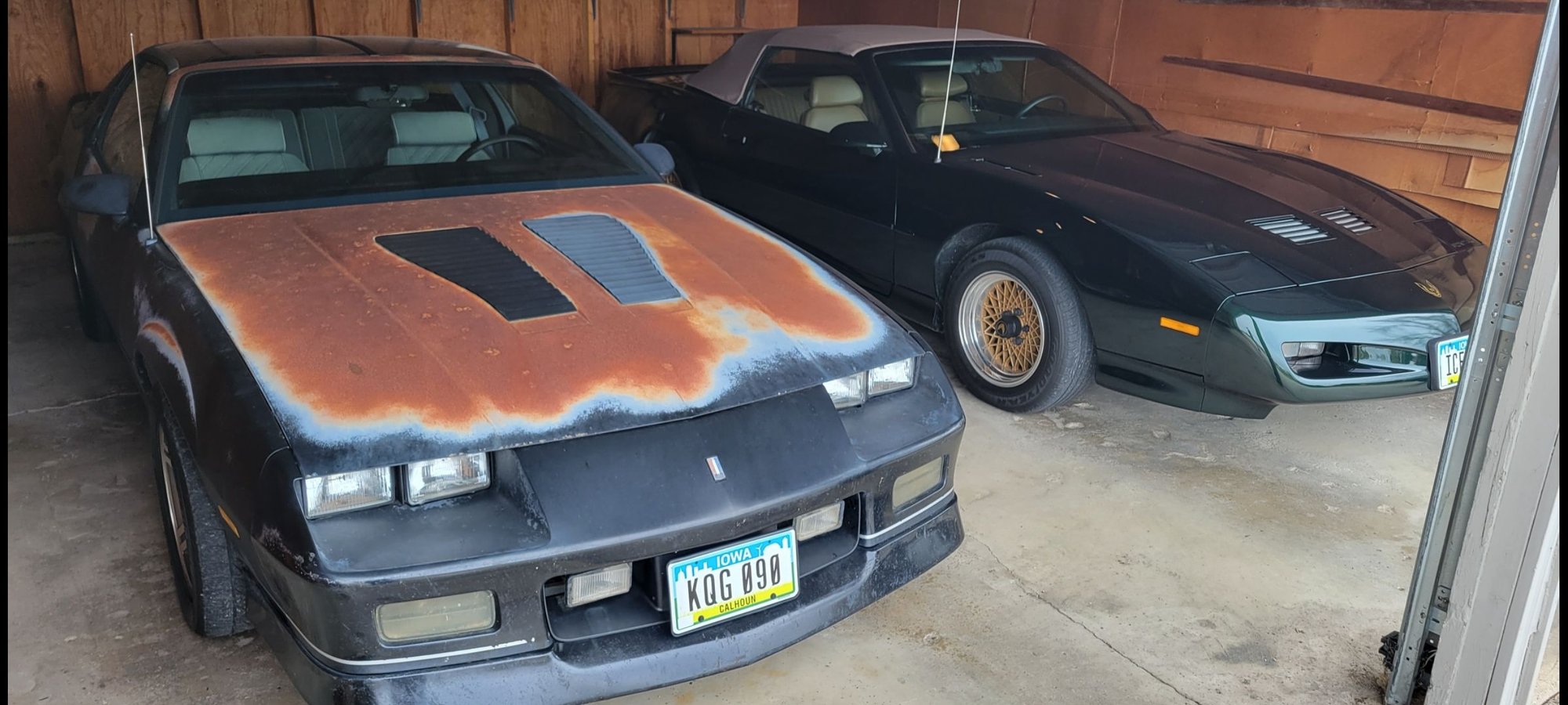

No more patina LOL. Temporary fix until I get a nice paint job on it

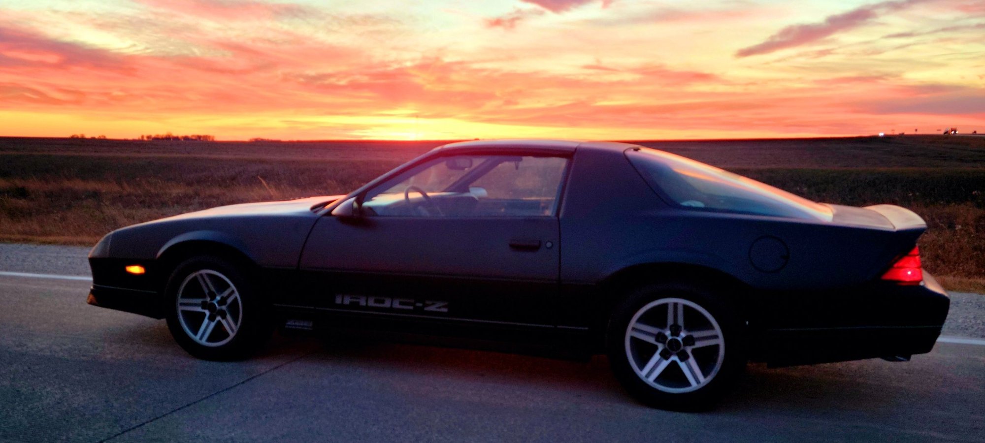

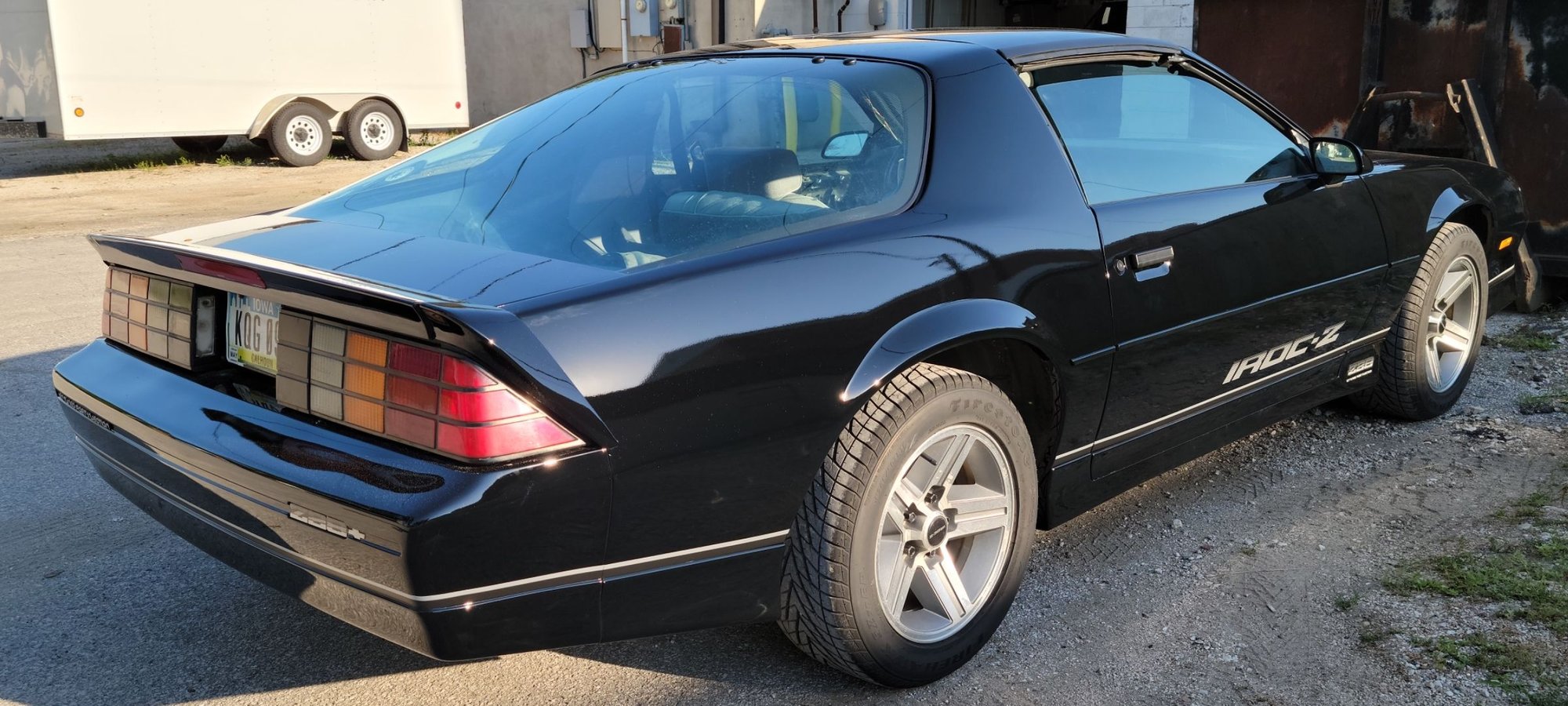

I snapped this pic tonight. Ya know....from 20 feet away....with the light on the opposite side of the car....she's kinda sexy

Patina delete! Looking good, another one saved!

Well it's just a temporary fix until I get the car painted the right way. It's at least all one color

Me personally, I liked the patina.

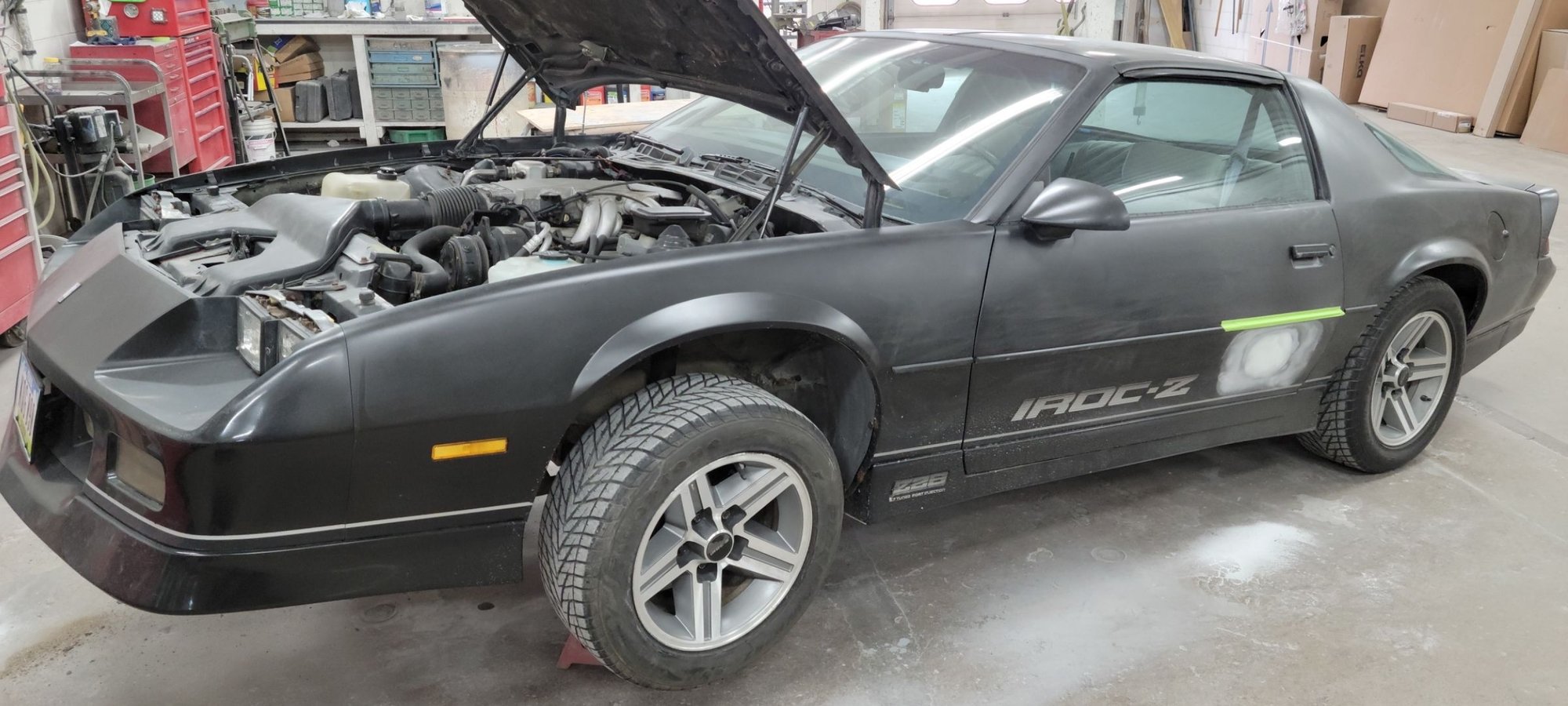

Here we go again....it has begun lol
The front fender had dents where something fell against the car while it was sitting outside for 25 years. They needed to be pulled. The others were just tiny dings. The car is actually really straight given the age, and having 74k miles. Can't wait to get this one looking like a new car. It deserves it

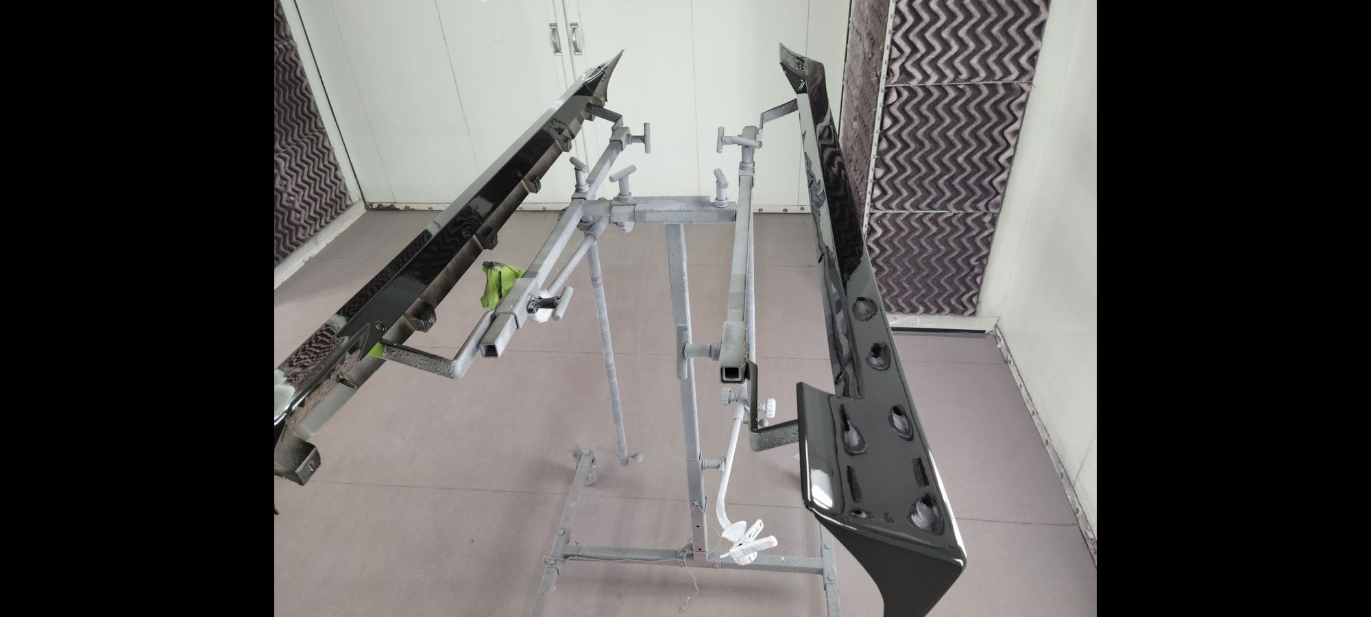

And here we go!

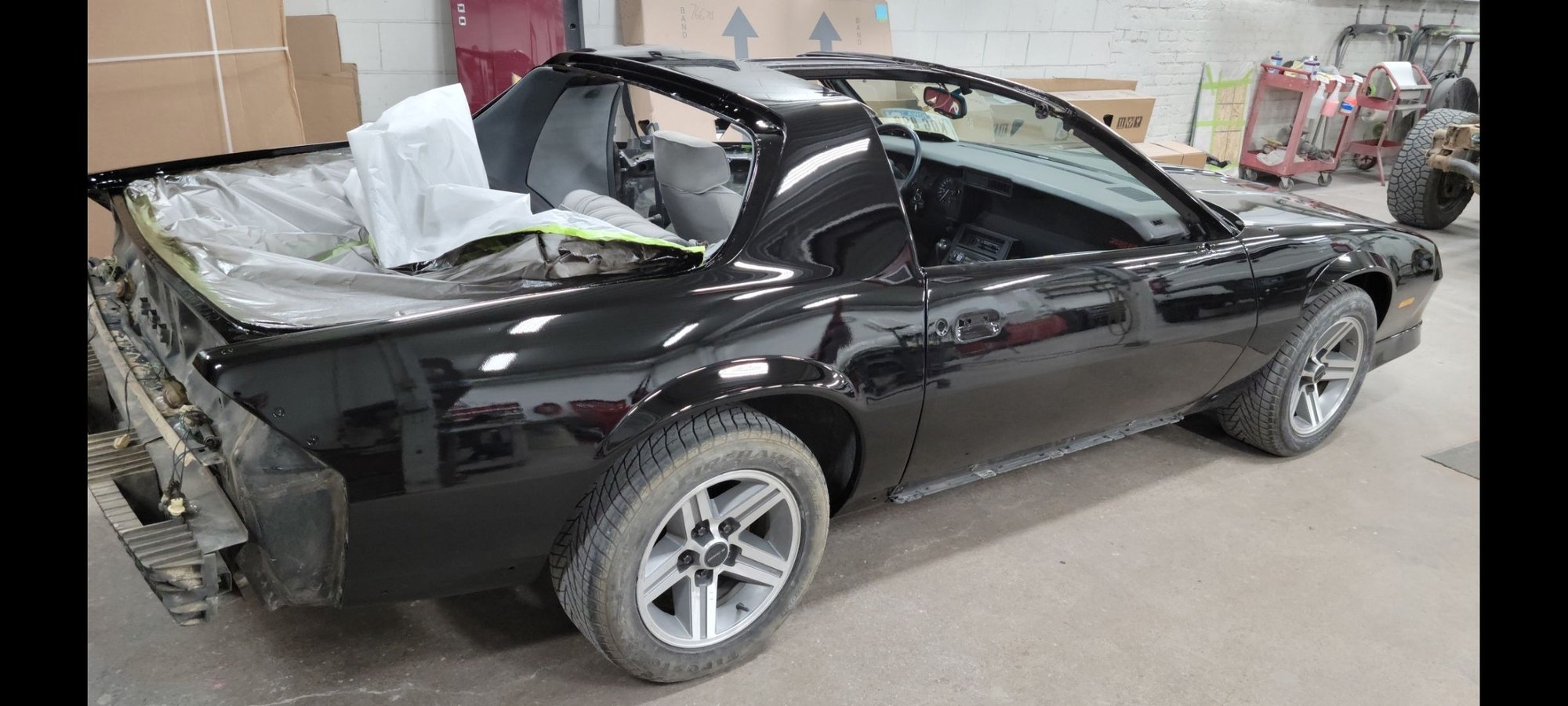

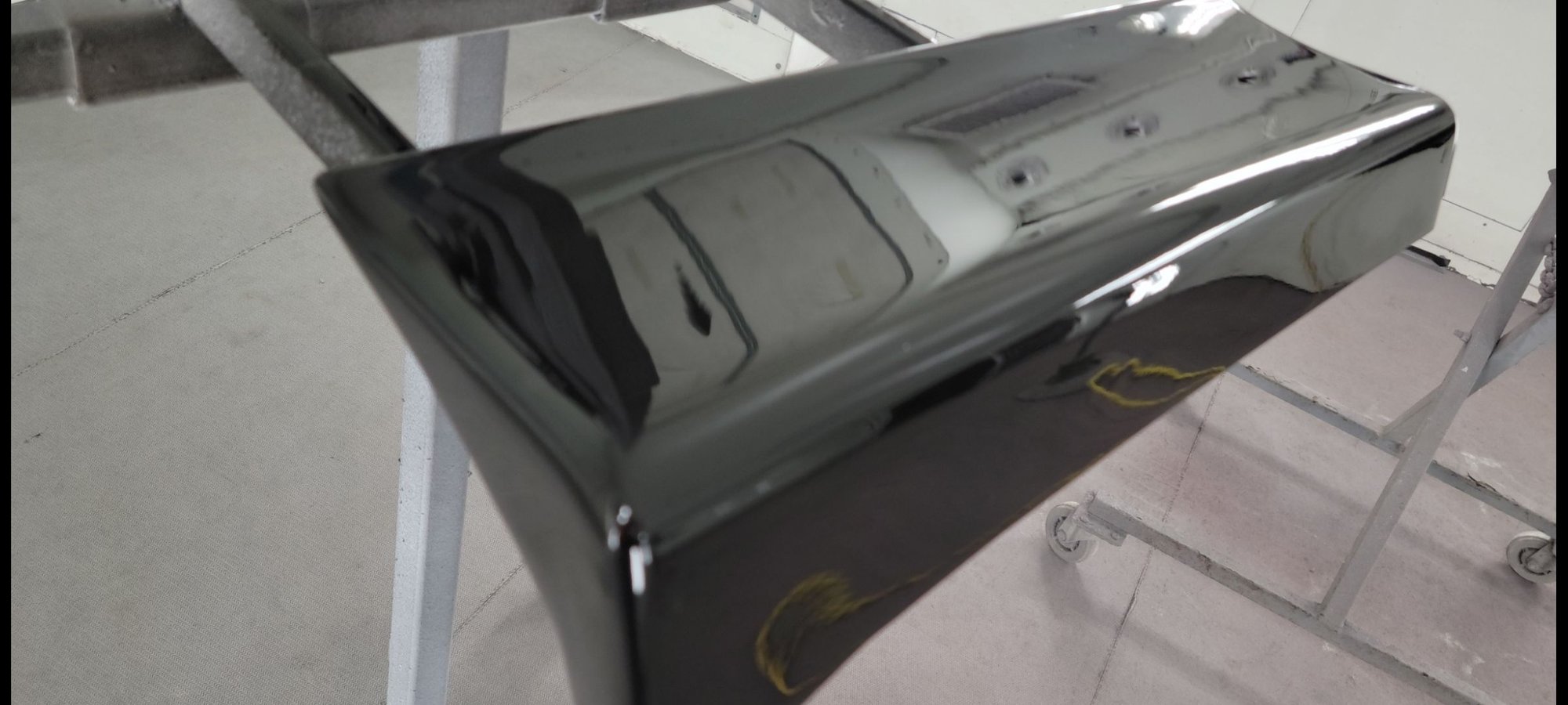

There's a bunch of wrinkled up packaging plastic sticking out of a box next to it on the floor that's making that weird reflection on the right side lol. Got my new emblems on.

Lulz.
You're getting closer. Gonna be a cool post when the car is finished and you can show the side-by-side before/after pics.

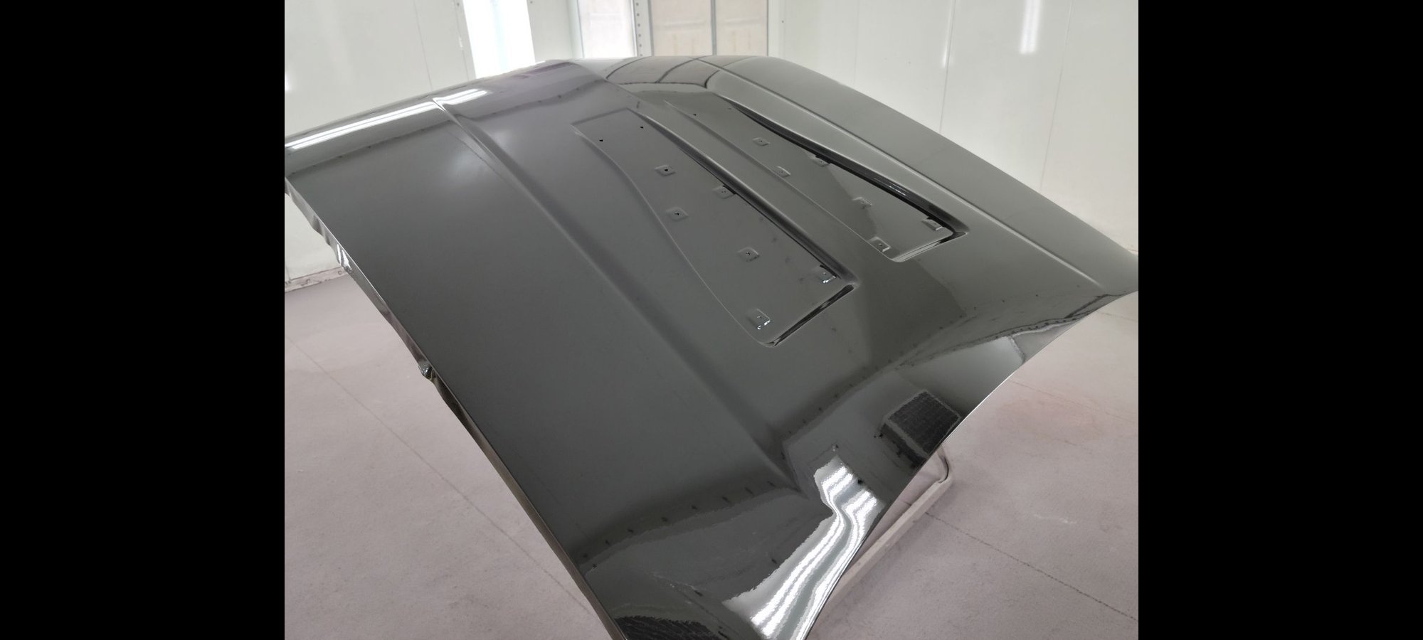

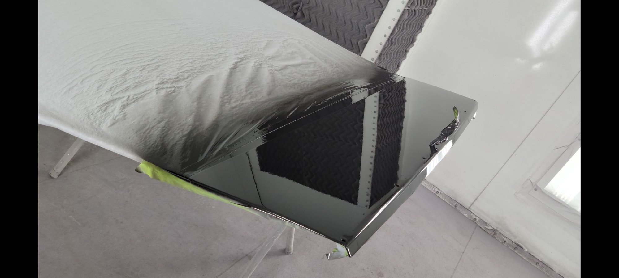

Originally Posted by chazman
This car will be spectacular!
Thanks Charlie! I cant wait!!

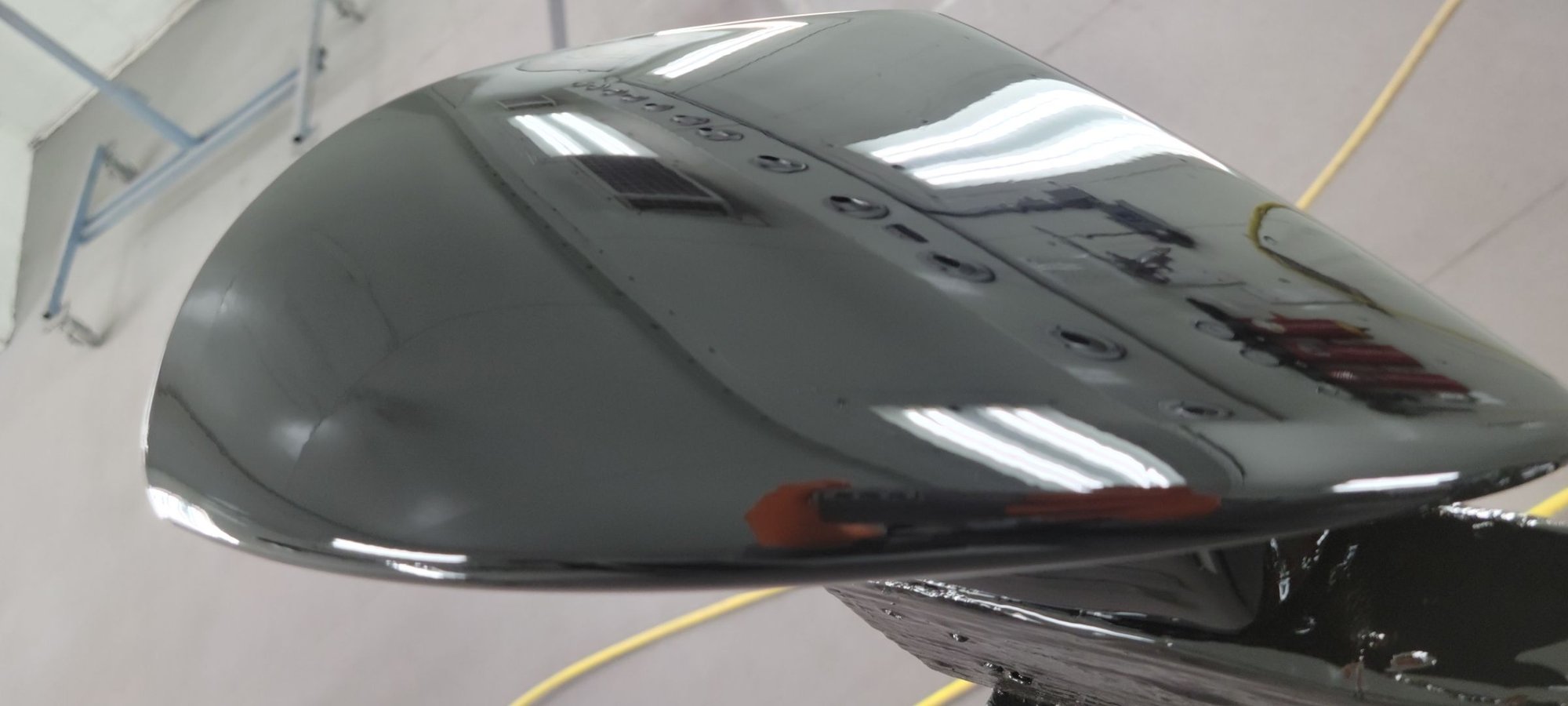

Its hard to believe thats the same hood LOL. And believe it or not, all that surface rust cleaned up and it looked like a brand new bare metal hood. Took 80 grit sand paper and PHIX rust inhibitor chemical, but actually cleaned up very quickly

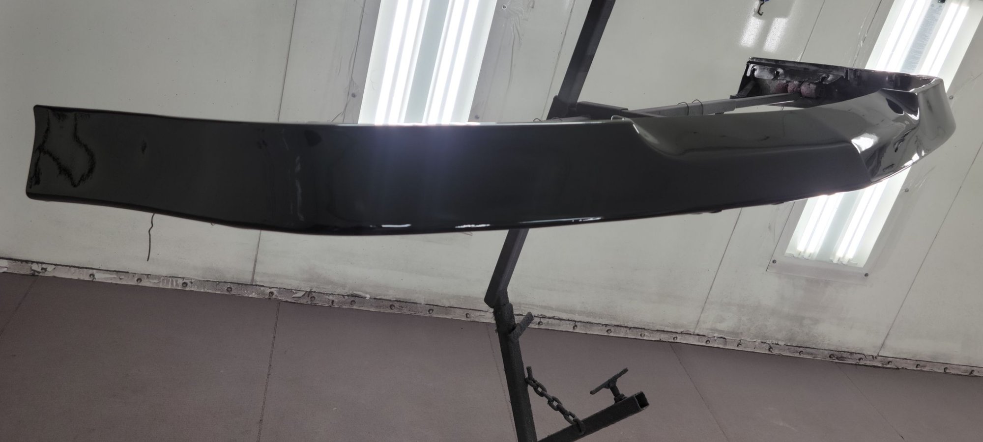

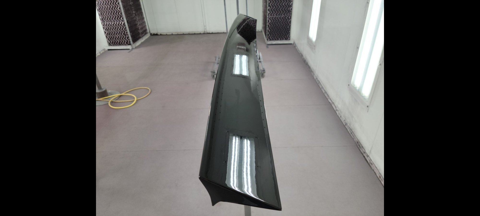

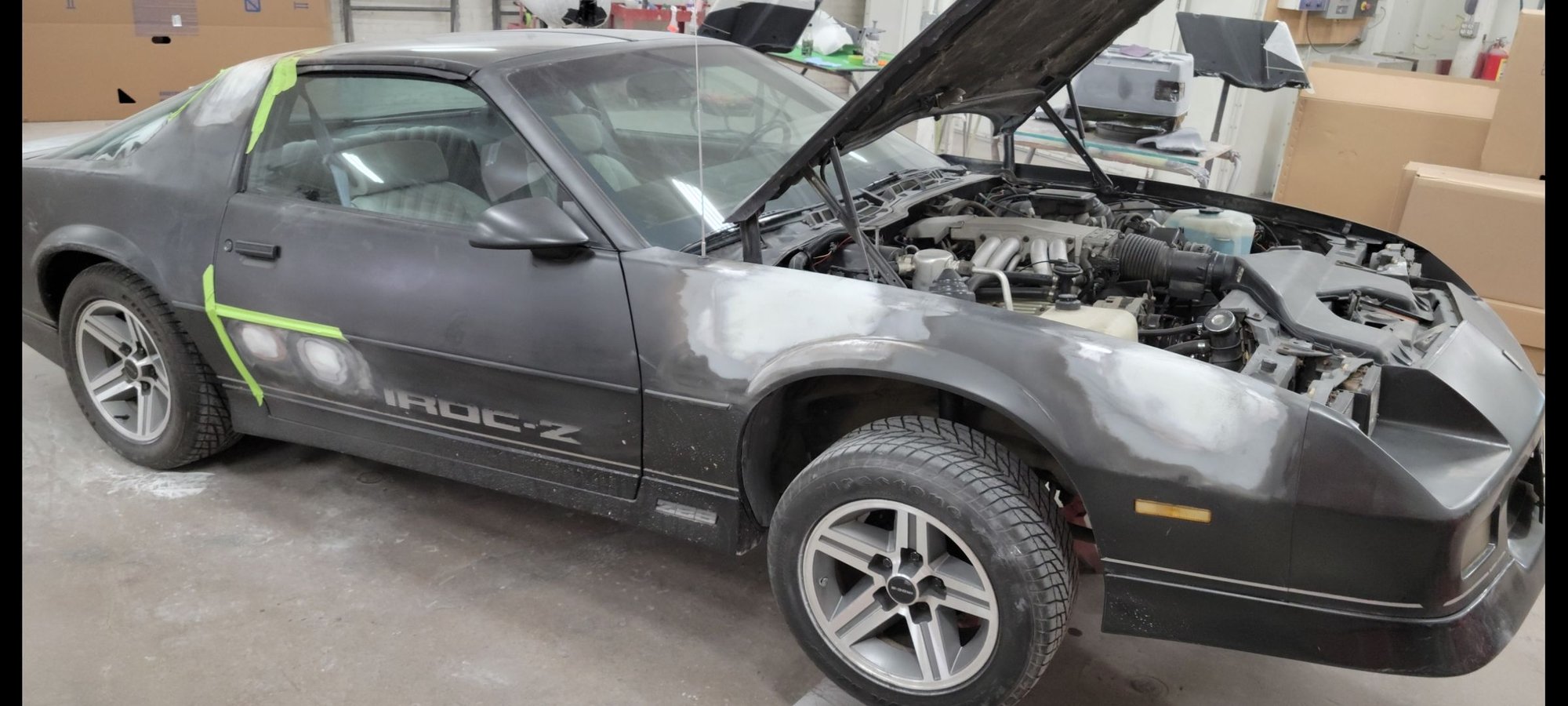

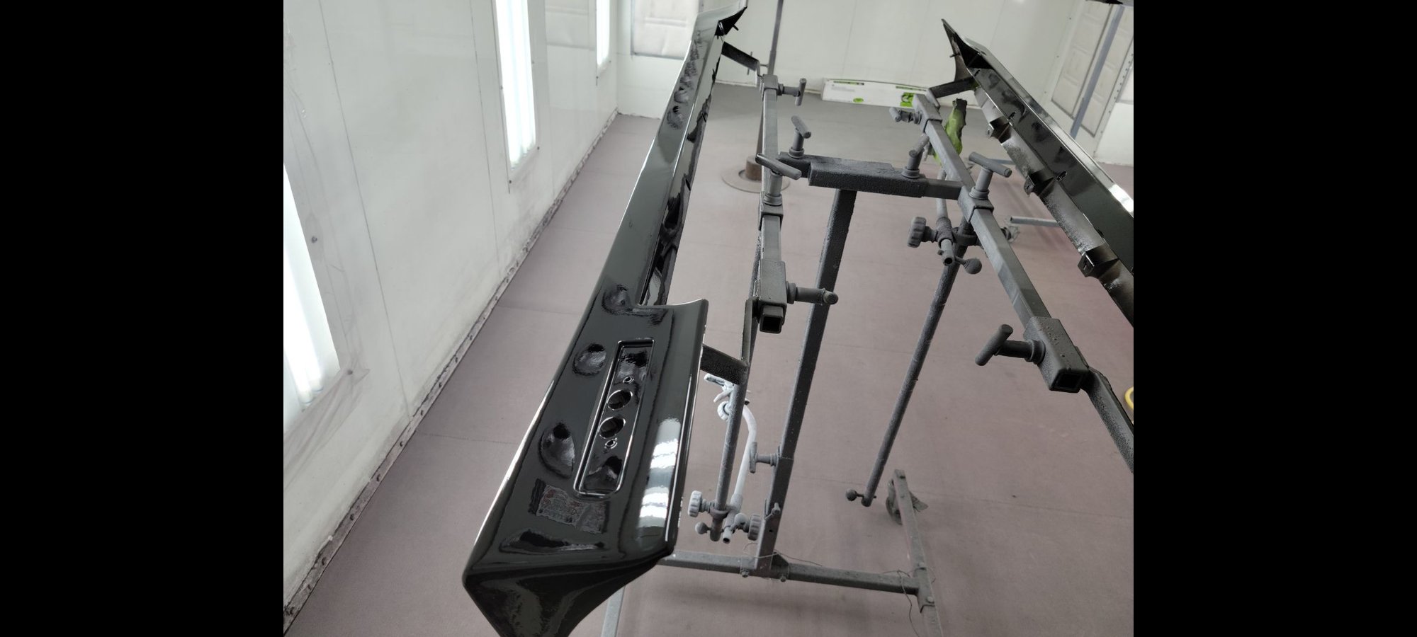

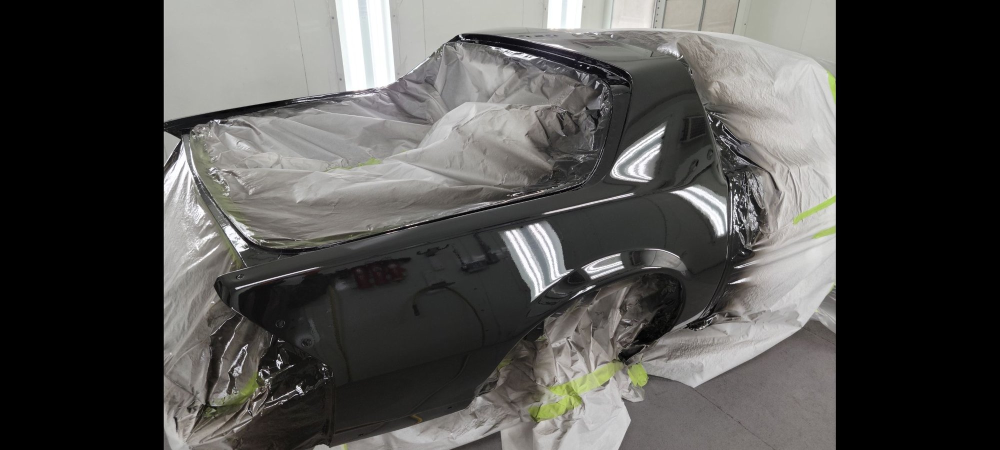

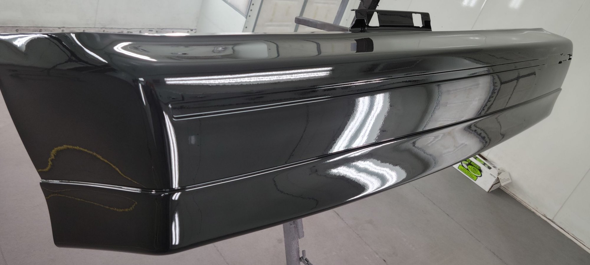

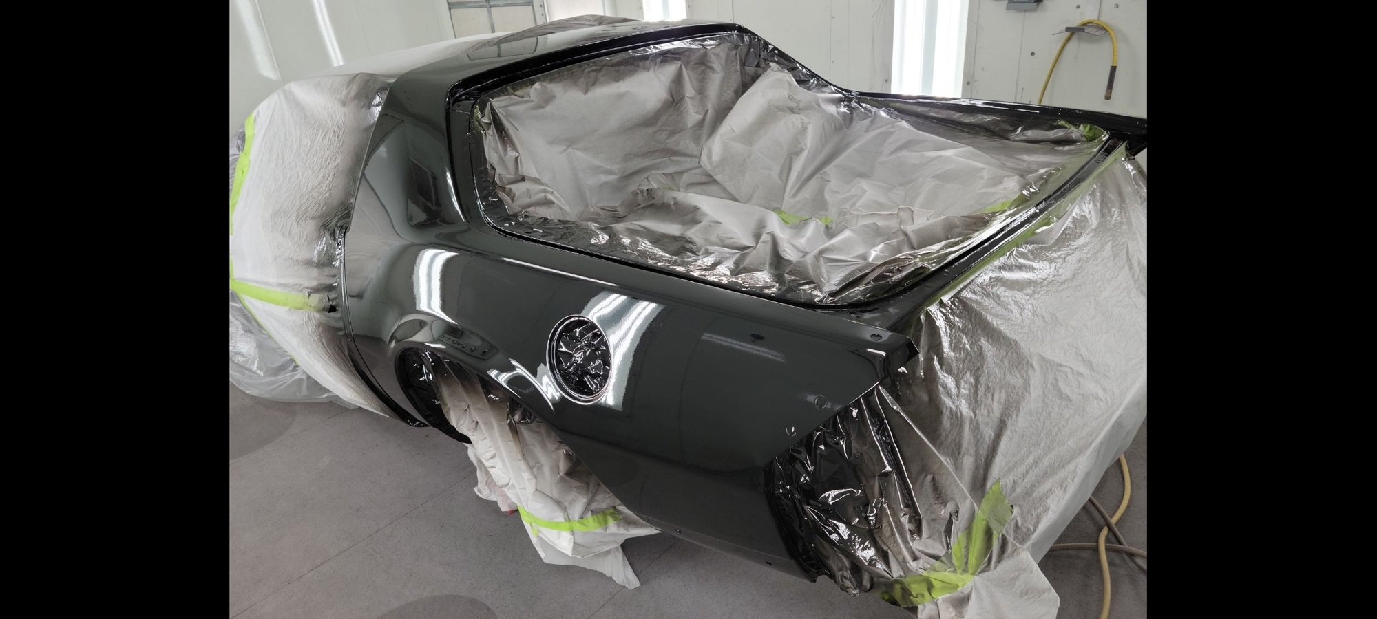

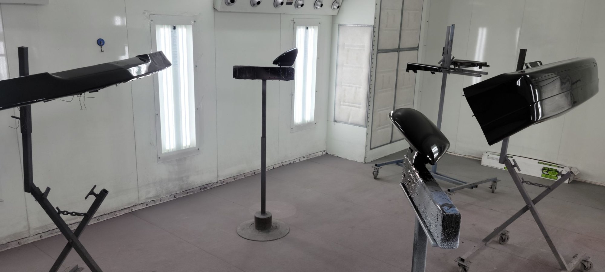

I've been painting the car in sections as time allows on weekends and after work. And I finally finished all of the painting tonight, other than the headlight buckets still need the semi gloss treatment. Other than that, it's FINALLY all one color!

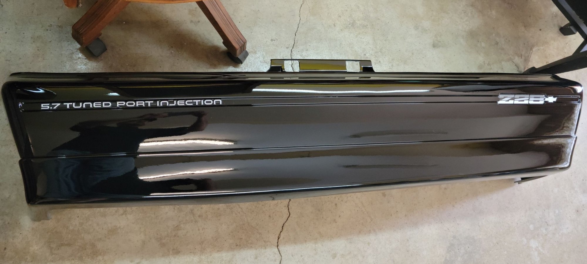

There's a car show Saturday morning. Gonna try like hell to make it!! I have a TON of work ahead of me over the next 3 nights after work

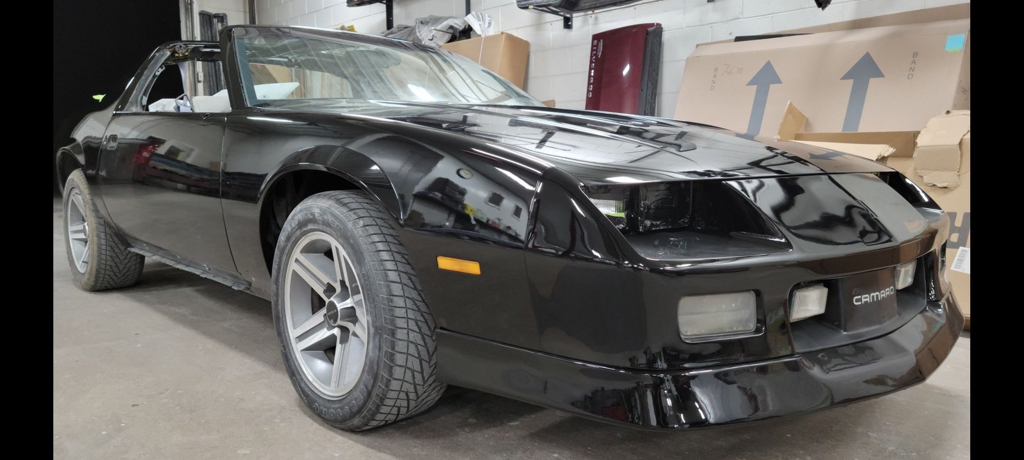

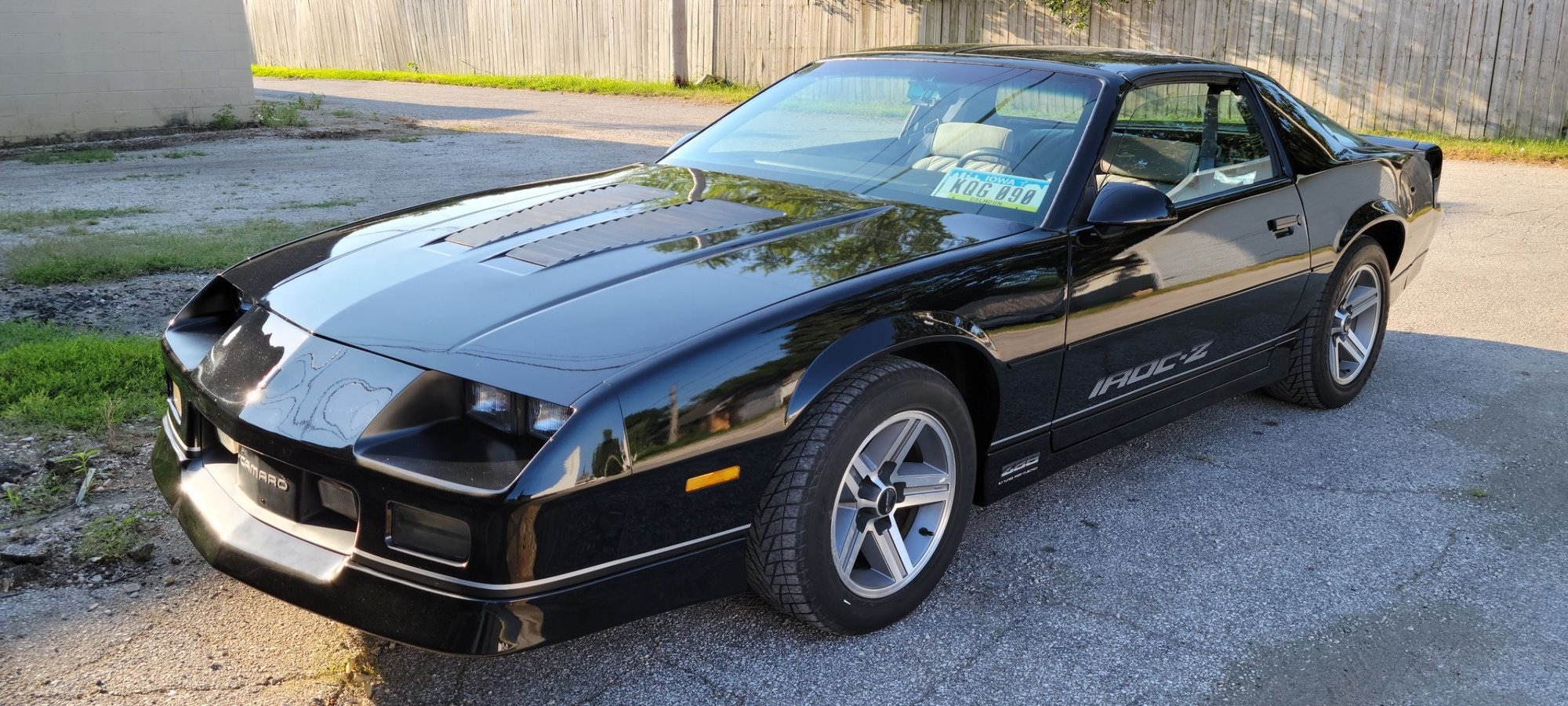

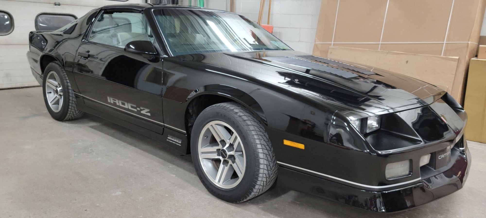

Alllllmost there!
Old Jul 14, 2022 | 11:43 PM
  #79
Reddragon88gta's Avatar
Joined: Apr 2017
Posts: 1,149
Likes: 445
From: Northern NY
Engine: 5.7 L98
Re: Barn find 1987 IROC-Z
Wow! What a transformation that Z has went through. You do excellent work.

Looking sharp! I'm curious about the semigloss headlight buckets; is that a factory thing for earlier years on black cars? I ask because my '89 has full gloss buckets and no evidence of the front being removed or repainted.

They were all semi gloss black. Although the semi gloss does get shinier over age due to cleaning, etc. I wasn't positive if they were like that on black cars or not, so I asked Chazman about his 11k mile 1989 that he bought new, and yep, they were indeed semi gloss black on black cars as well.
I actually painted the buckets last night. Unless you're right on top of it, it's not thaaaat noticable

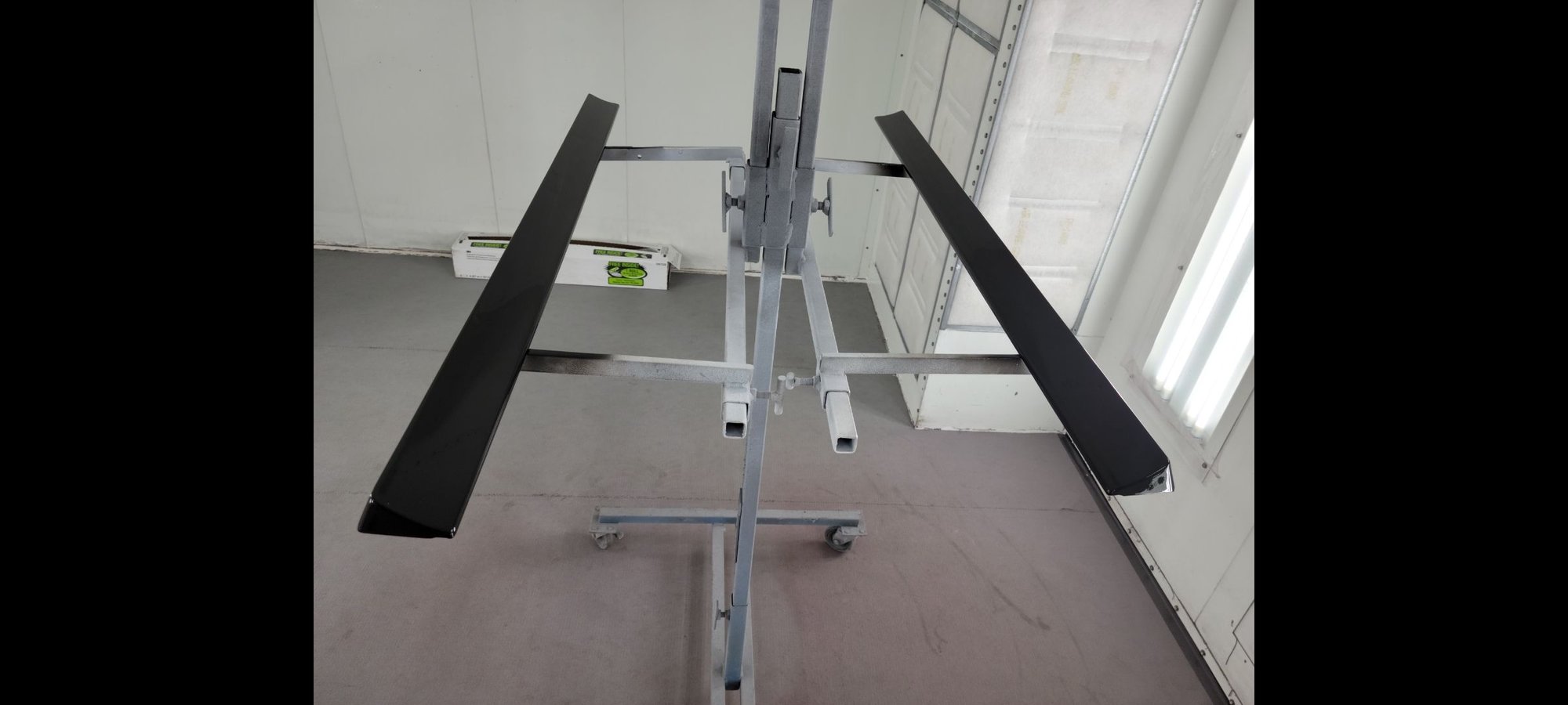

Nice, I'd love some photos that show off the contrast of your buckets so I know what I'm missing .
I use PPG Hot Rod Black on the buckets when I do these cars. Only i double the catalyst and reducer to get more of a sheen. Hot Rod Black is pretty flat, otherwise.

Took her for a spin around the lake tonight!
Still have to install the new headliner, sun visors, and sail panel covers. Oh and dye the carpet. That's about it!
Its going to a car show in the morning, and im going to the old lady's place on Sunday where i bought it from to show her and let her drive it

Beautiful car, I do like the subtle semigloss buckets.

Nice work on the paint. So glad you were able to bring her back to life.
