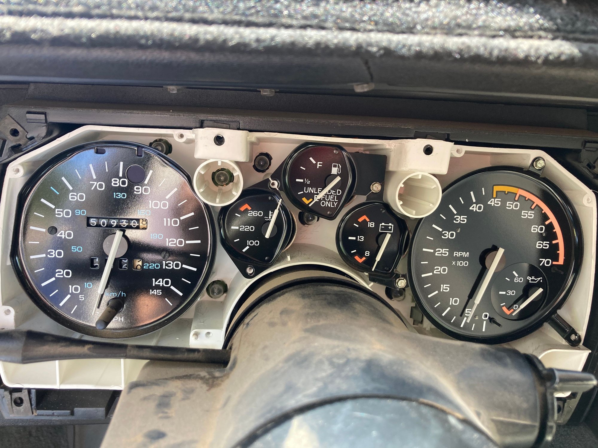

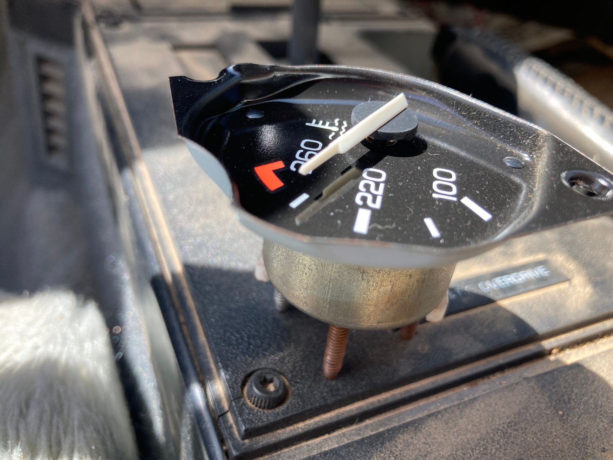

More updates from the long weekend. I had the seemingly common temp gauge stuck straight up on the tin. Took it apart this morning and massaged the tin so hopefully it won’t happen again. Now all the gauges work correctly. All I need now is to fix the power windows and the power locks and I believe all the electrical stuff will work. I’m sure the motors are gone in the windows and the actuators in the locks. Next priority is going to be tires and a wheel though.
You can see where I rolled the lip into the tin just behind the 260 mark.

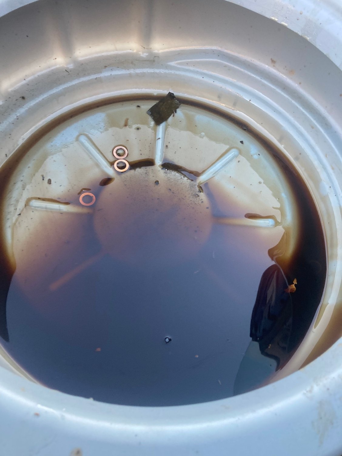

Saturday, I tightened up the alternator belt a little, it was squealing some when cold. I changed all the rubber brake hoses, and completely flushed the brake system. I let each chamber of the master cylinder run completely dry so I could wipe all the crap out of them and start as fresh as possible. I gravity bled each wheel until I had only all the way around. I also changed the oil, it only had about 3 hours total on marvel/15w40 combo that was in it, but it came out pretty black. The lifters were a little sticky when I first fired it up, but they have only gotten quieter the more it’s run. I also topped off the oil/friction modifier in the rear end.
I finally got the new tires and rear wheel back under it, off the jack stands, and moved it around the house and turned around in front of my neighbors farm shop. I haven’t been down the road yet because my son was spending some time with his grandparents this weekend but I’m hoping our maiden voyage will be this week, while I’m off of work. He has to tag along with me when I go. I still need to flush the coolant real good and change all the belts but everything else seems to be good.
here’s a few photos. Check out that nasty brake fluid in the drain pan. There is nothing but brake fluid in there. That’s it. It still needs a lot more work to be what I want but being drivable is huge progress.
The master pic is with the front chamber cleaned out and refilled the rear drained. Like I said the brakes work great.

Very cool. Man that brake fluid was nasty. Good call getting that done.

Yea that brake fluid was pretty bad. We took it for a drive yesterday, he was all smiles. Pretty cool to enjoy its first cruise in 20 years. It actually ran really nice. The suspension is still tight, the engine ran great, as good as I could have ever began to expect. The transmission works about as good as a 700R does. I did the normal lock it in 3rd at low speeds to keep the hunting gears away. OD does work and it shifts nice and smooth. All in all it was 100% a success. Still a lot that needs done but it’s on the road now. That’s the hardest part sometimes. Here’s another shot of the brake fluid from the lines. And of course the cruise.

Junk will probably accumulate a couple more times in the brake reservoir as it cycles in and out of the master cylinder, at least mine did and my fluid was in similar condition. Nice work getting it on the road, my trans also hunts in OD before its fully warm. After I've been driving it around for a while and everything is nicely up to operating temp, it seems to be normal. I recommend frequent short trips to give the drivetrain gentle heat cycles, slowly driving it longer and eventually harder.

Yea I’m sure you’re right about the fluid in the master, I was already getting a little bit of old fluid right after I flushed everything. I’ll probably drive it around a bit and then flush it again, and repeat until everything is clean. I agree on the short trips/heat cycles for now, that’s exactly my plan. Today I drove it about 8 miles, this time between 60-70 mph average. Again it ran smooth as silk and had plenty of power, and no issues. I’m really starting to like this car a lot. I think it’s going to be a good alternative to taking my 5th Gen out for those short stress relieving trips.

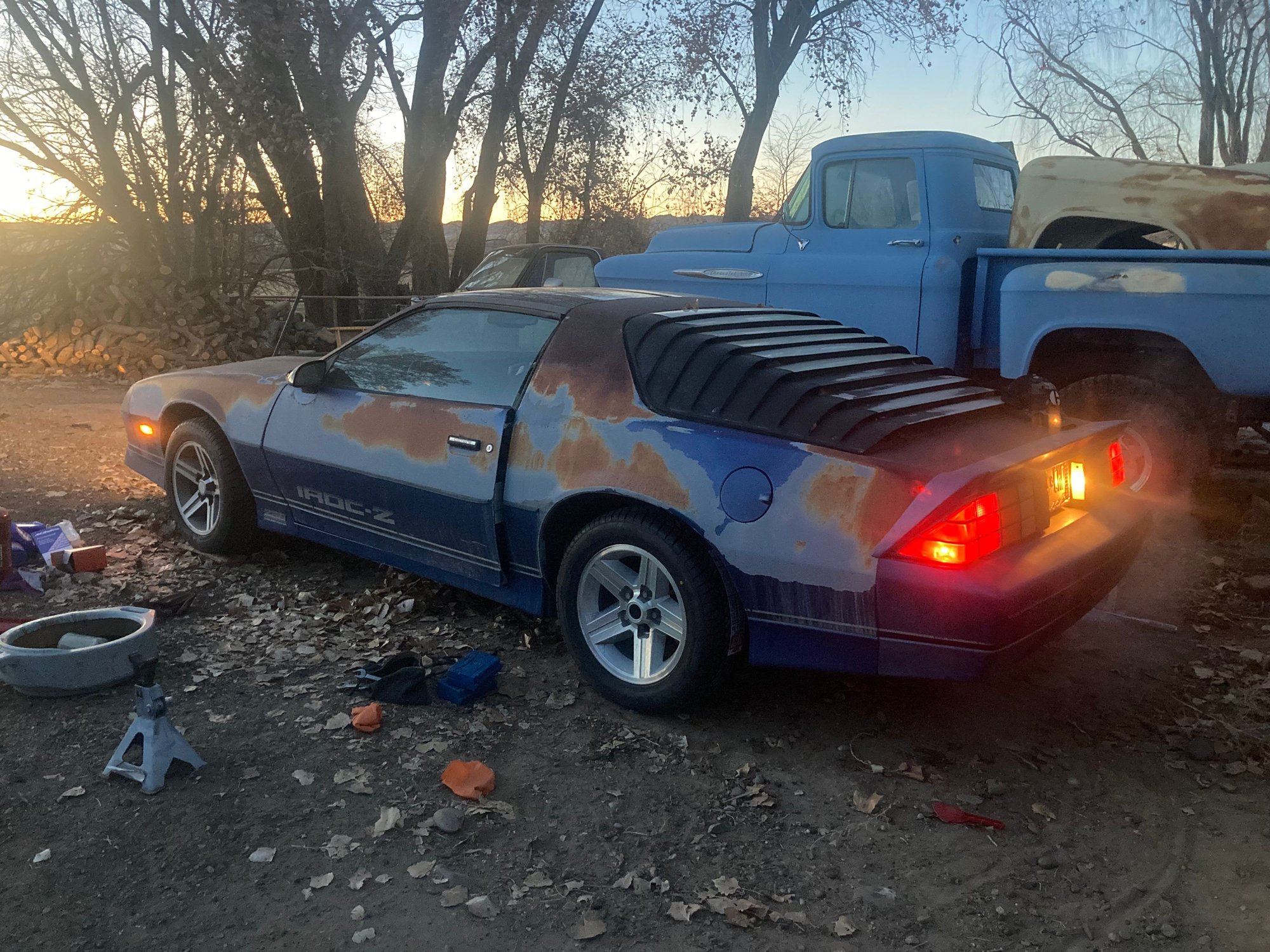

A couple more recent shots… the Z is running really good. I need to do the T top drip edge seals next, they keep getting caught in the window when opening and closing the door. Finally got my 5th Gen out for the first time since November last Sunday.
