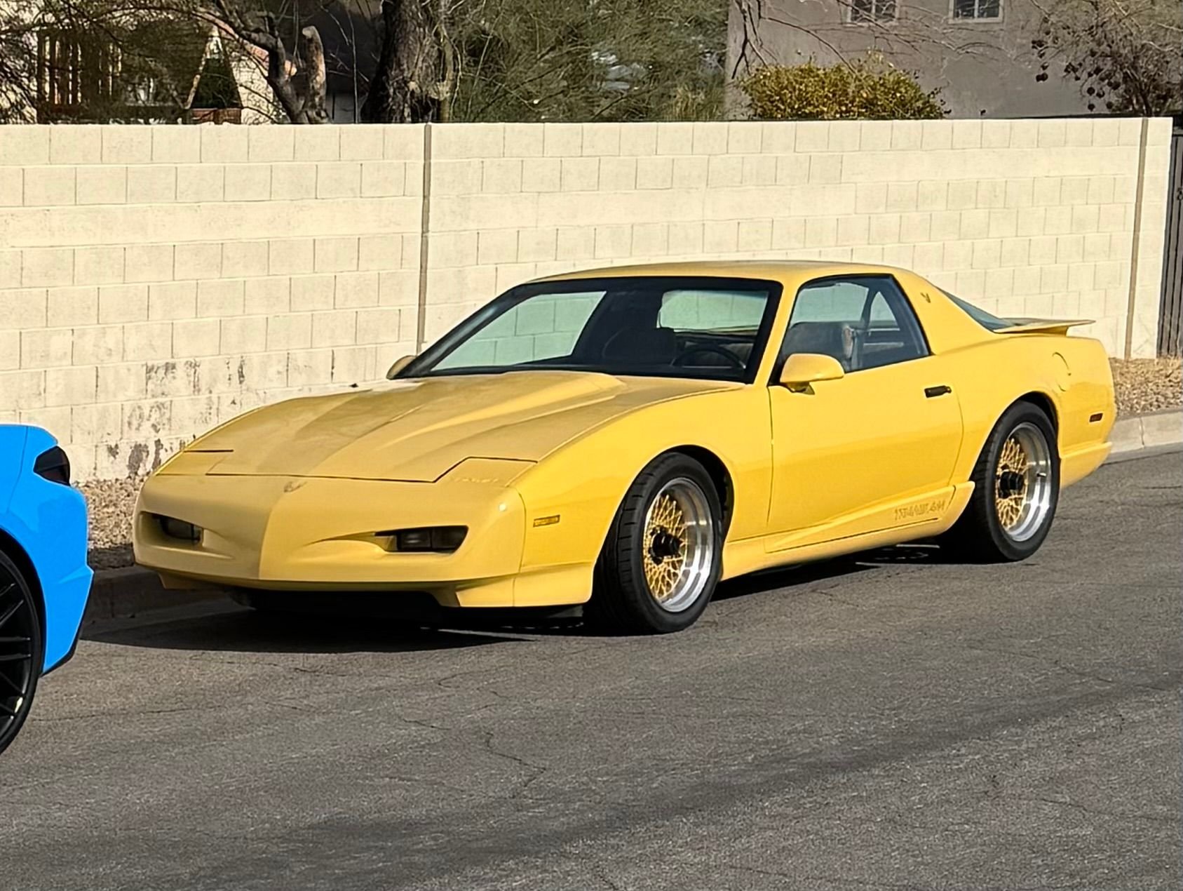

I'm a little reluctant to post because the car needs some tweaking, but I'll put this one picture up for now. I was working on putting the car back together until 9:00 on Thursday night, and hit the road with it at 10:00. It poured most of the way from Las Vegas to Camarillo, and by the time I got up to Morro Bay the car was trashed. When I get back home I'm going to fix the headlight gaps, adjust the ground effects, put all the decals on, give the car a good cleaning and then do a little photo shoot.

Niiiice! Love it.

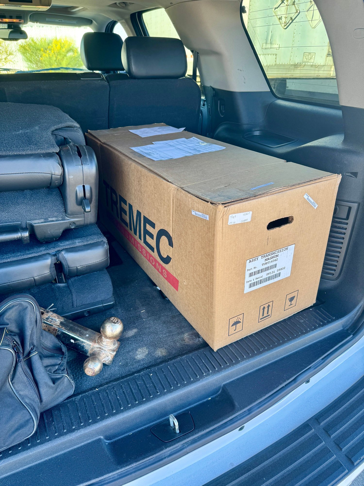

Over the past couple of weeks, all of my new transmission parts have started rolling in. Most of it came from Tick Performance, including a new bellhousing, all the hardware, a slave cylinder with bleeder line, and a new clutch master cylinder. I also picked up a new crossmember and transmission mount from Hawk’s. Then, this morning, I finally got the call that the transmission had arrived at the freight terminal. Perfect timing! Starting Friday at 3:30 PM, I’m off for the next 24 straight days, so it’s officially go-time.

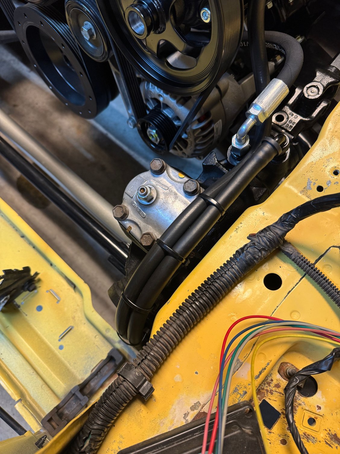

Last week, I decided to knock out the power steering system. I made a trip to my local All Hose for new push-lock hose for the cooler and return lines, and had them build me a new pressure line. I only had one end crimped initially so I could take it home, trim it to length, and clock it correctly. The following day I brought it back to have the other end crimped, and now the power steering system is completely ready to go. I’m running a 4th-gen pump, and the steering box was rebuilt by Turn One a few years ago with very few miles on it. When I drained the old fluid to swap the lines, it came out just as clean as the new fluid going in. Always a good sign.

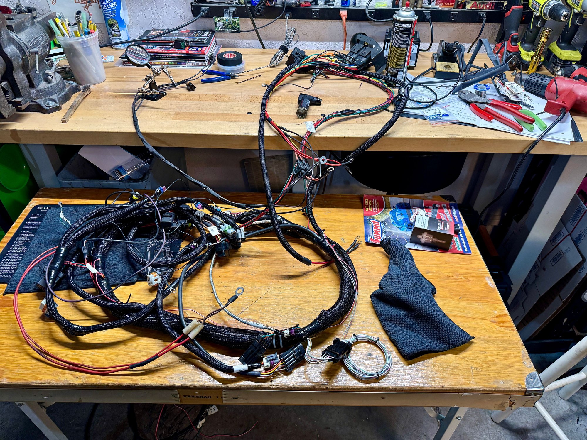

This post is more of an advertisement than an update. My swap is almost done except for some minor odds and ends. I'll get into that some more in my next post with pictures, but for now, I want to highlight a cool product I found that will benefit anyone converting their thirdgen to a T56 transmission, not just LS swaps.
Last night I was doing some Googling, specifically looking for a way to use one of the triggers included with the Holley Terminator X to control the reverse lockout on my T56. When I did my initial T56 swap 10 years ago behind the TPI engine, I used a momentary switch on the handle of the shifter to activate the reverse lockout solenoid. In my quest for an answer, I came across a post praising this harness from Bowler Performance Transmissions. Bowler All-In-One Harness
Basically, this standalone harness eliminates the need for a separate converter box for the speedometer by using a Bluetooth module in the harness that pairs to an app on your phone to get the correct VSS signal. It will also operate the reverse lockout of your T56 with parameters that can also be set on the app, and it has a provision to wire in your reverse lights. I haven't received the harness yet but I have read the installation instructions and reviews from several users and I think it's going to be an excellent upgrade over the Dakota Digital SGI-5 I'm currently using to manipulate the VSS signal and the momentary switch I'm using to activate the reverse lockout solenoid. For anyone interested, I also found a 10% off coupon code. BPTTENOFF

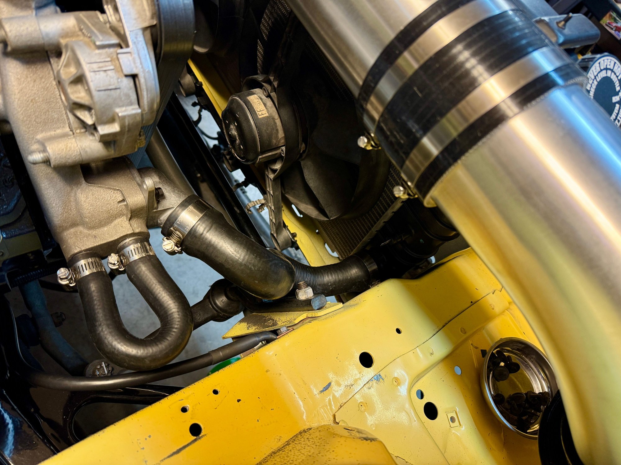

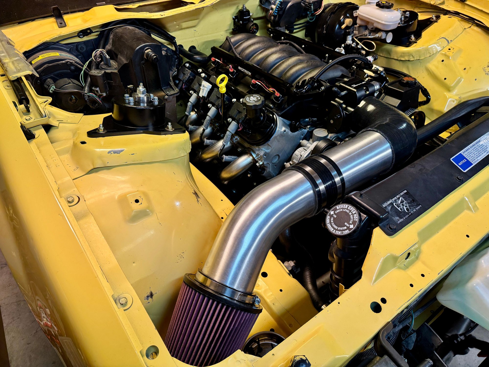

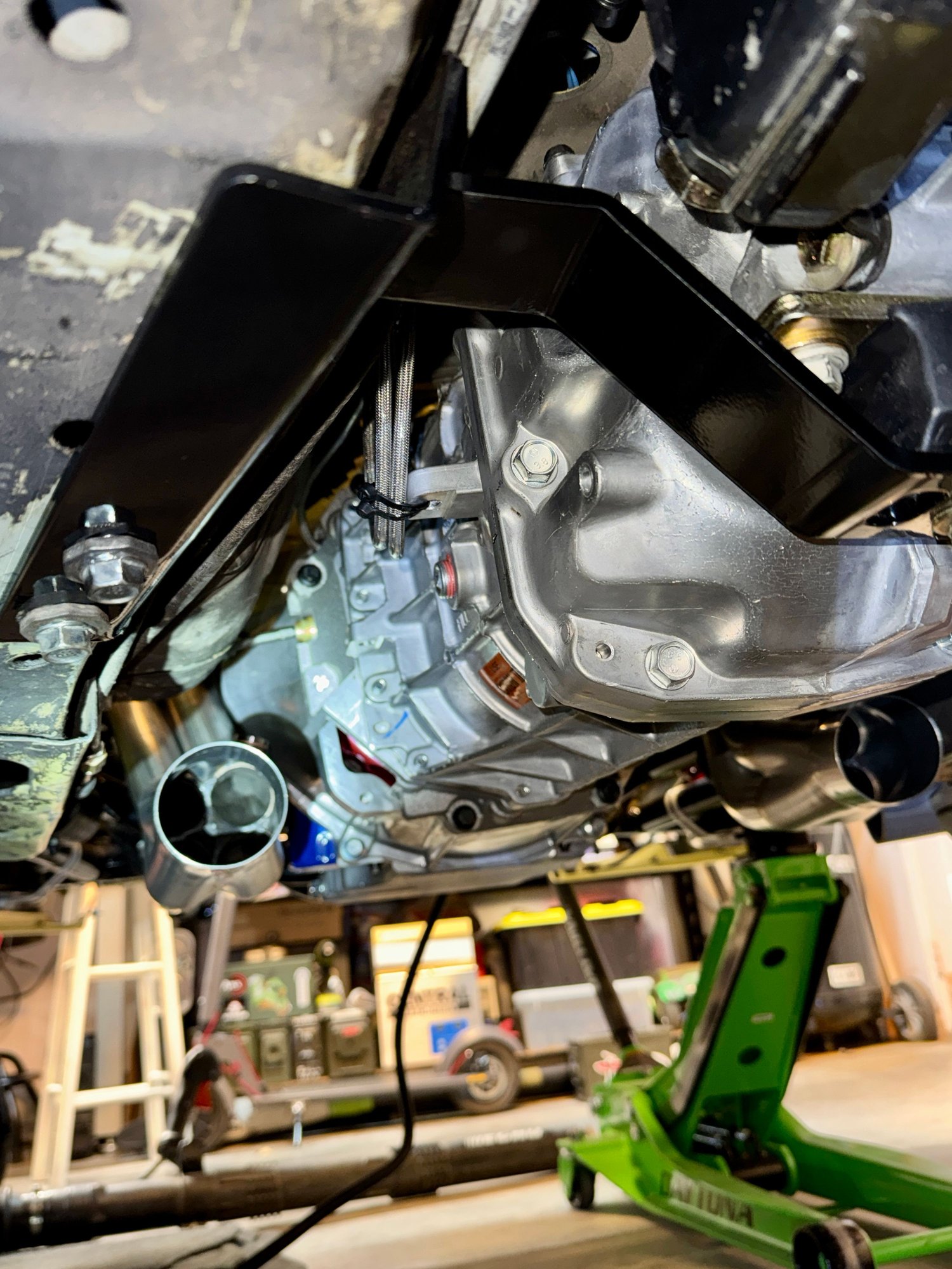

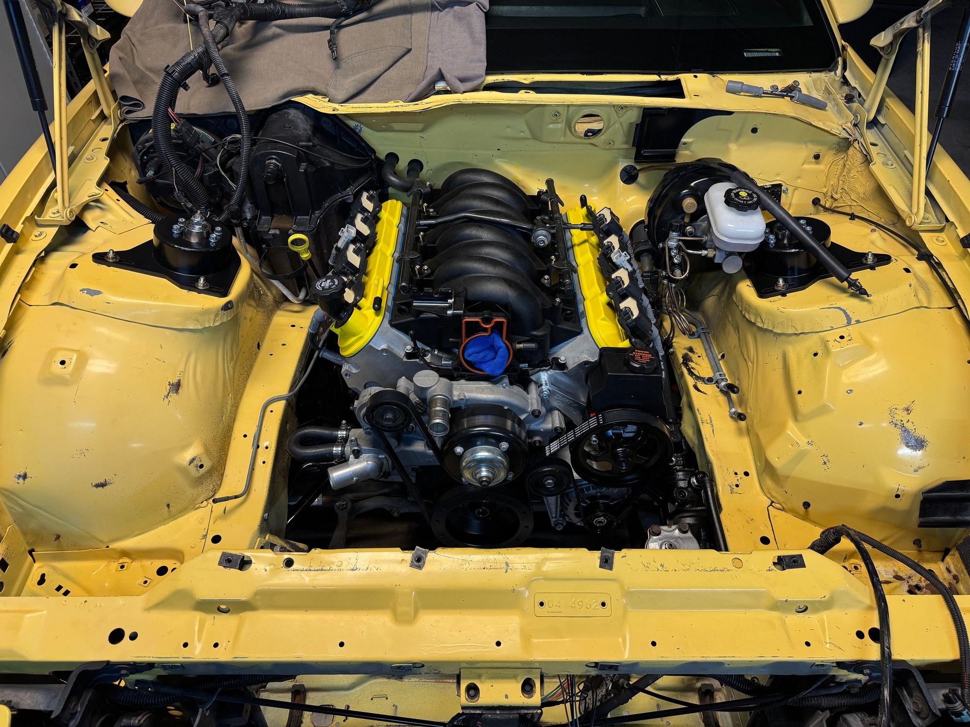

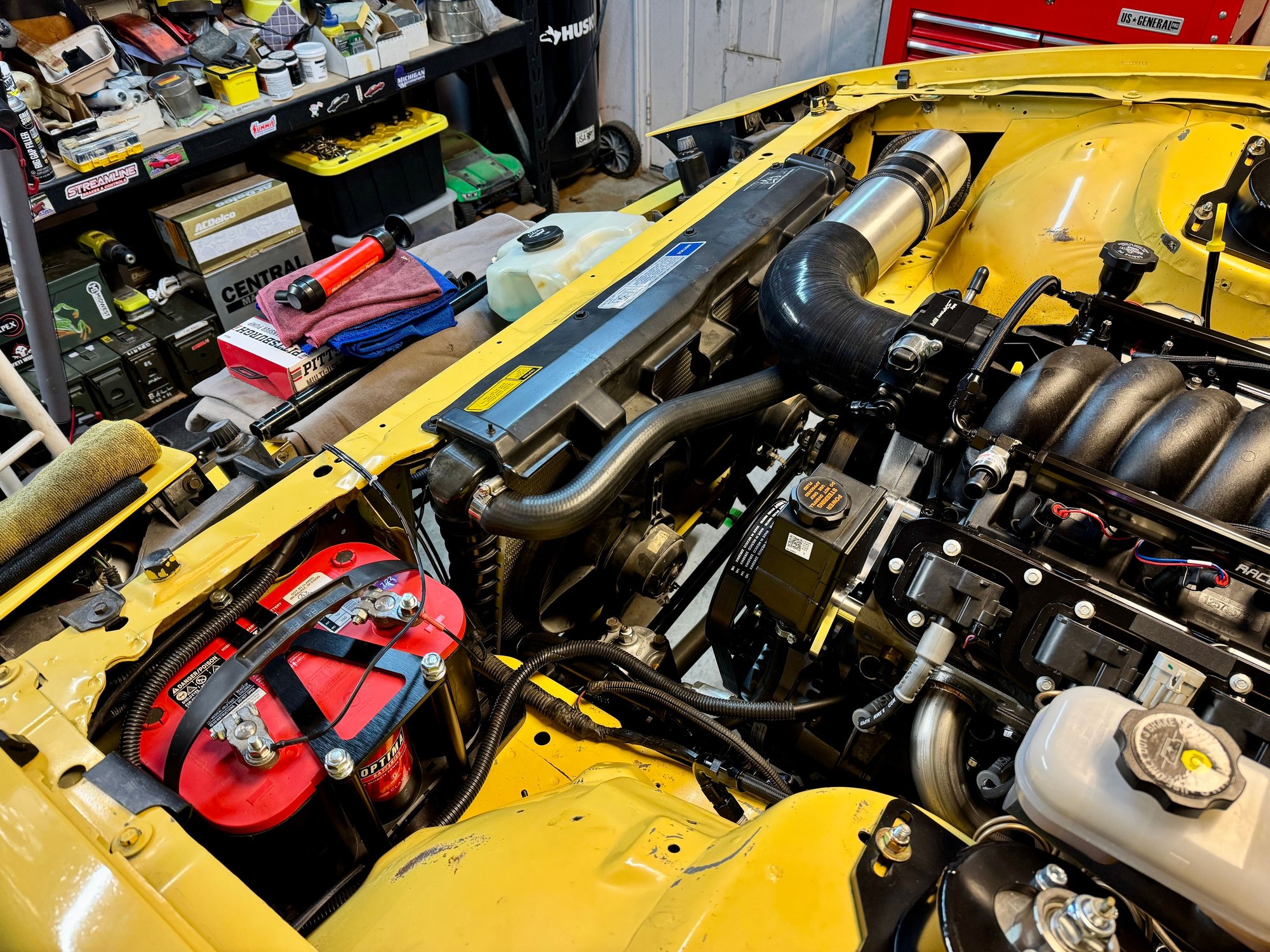

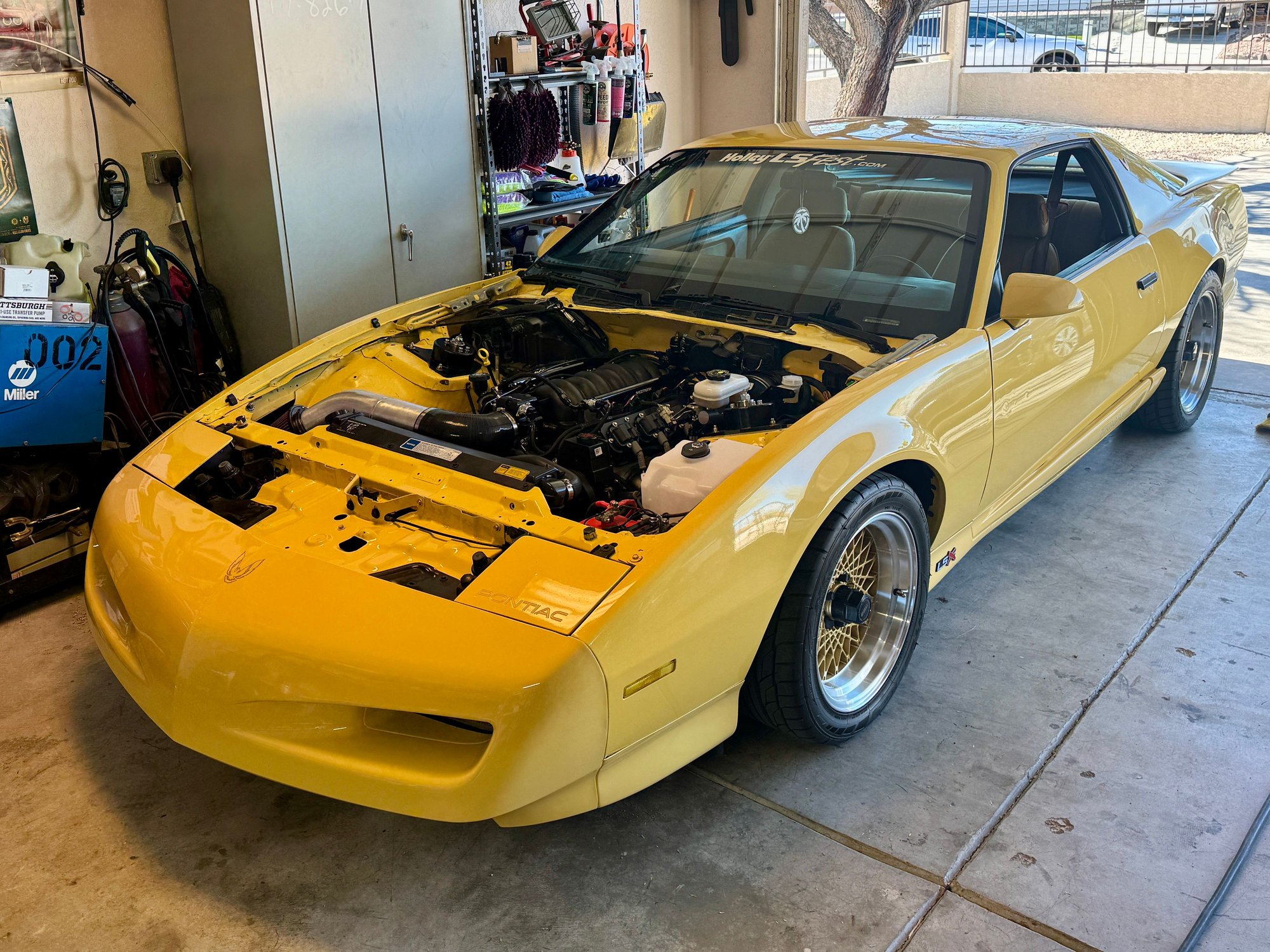

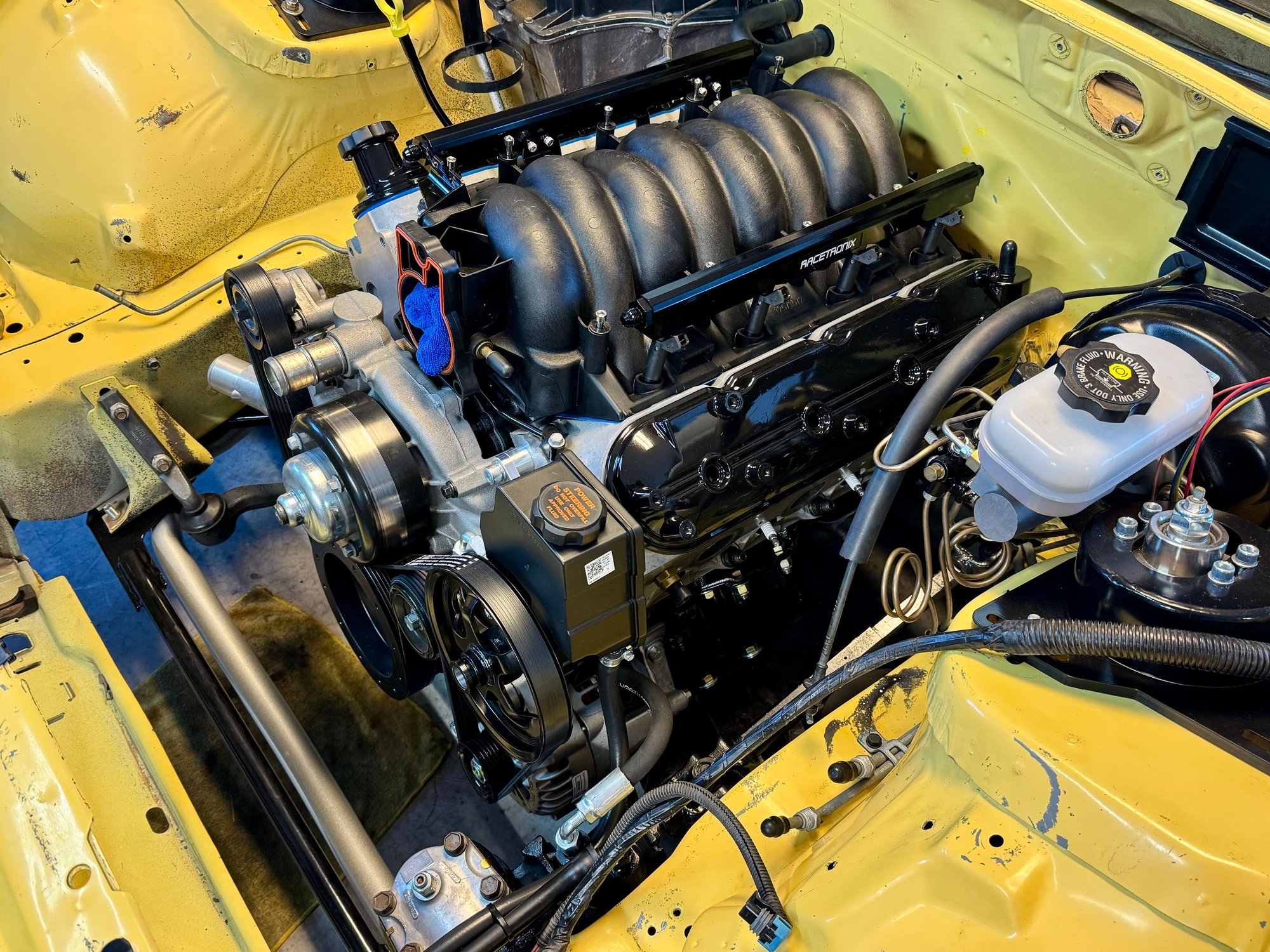

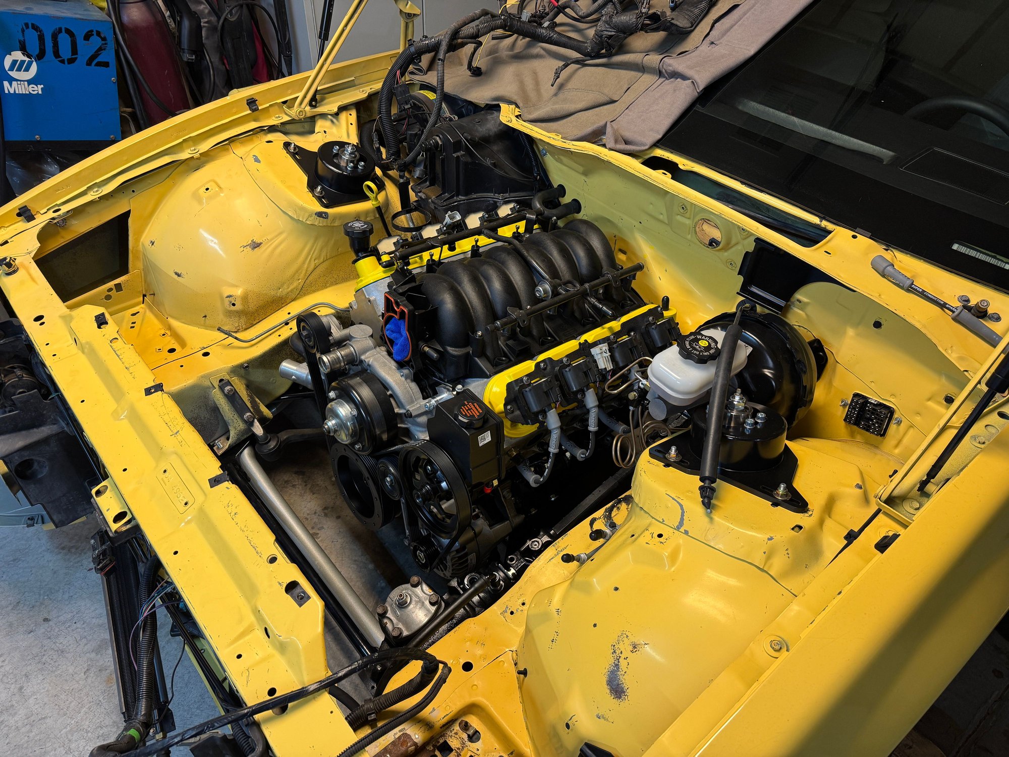

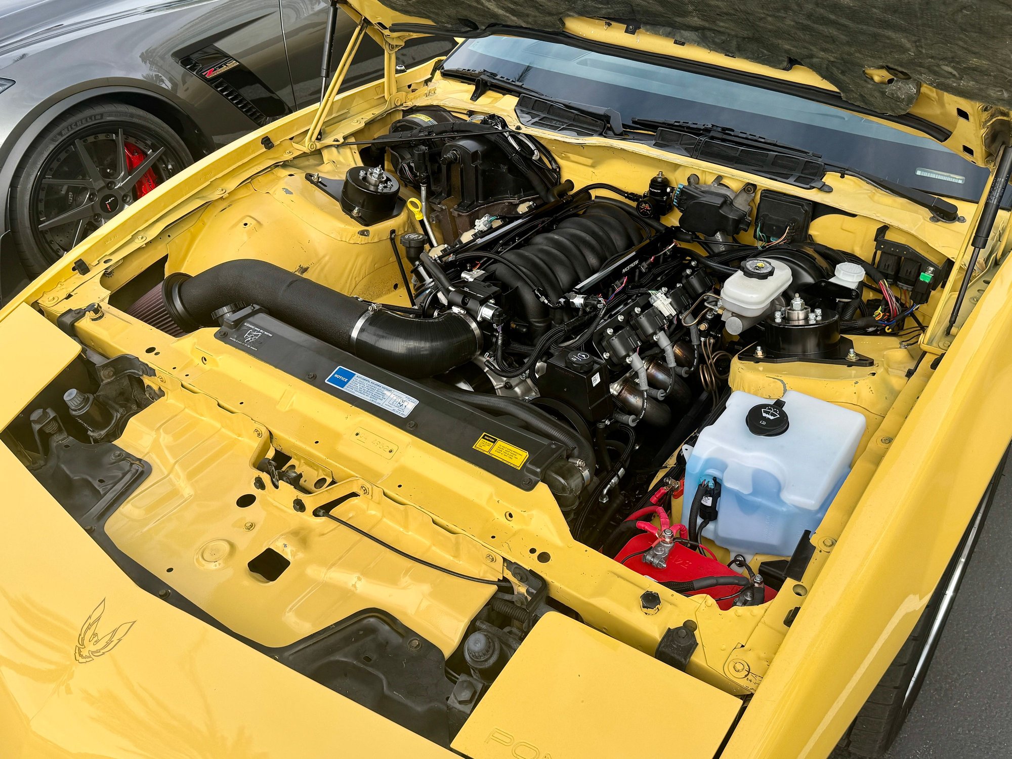

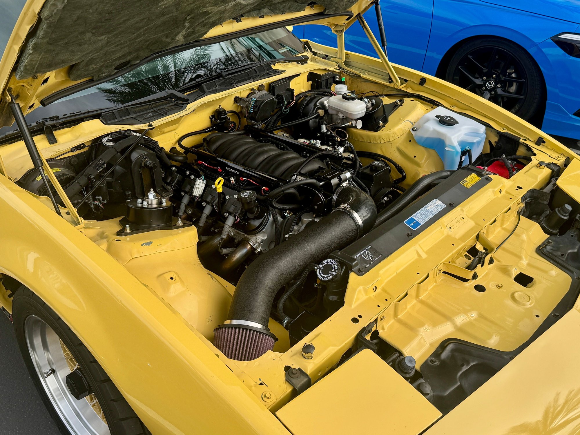

I’m just going to drop this huge photo dump on here and try to work through what I’ve done on the car over the last six weeks.
Wiring – I started by disconnecting the C100 connector from the firewall, removing all of the underhood relays and wiring, disconnecting the computer inside the car, pulling the passenger-side fender liner, and removing the engine harness from the car. I then spent a couple of days with the car’s wiring diagram separating all wiring necessary for the car and the engine. Once I had the harness stripped down, I went through each wire and labeled them all. Next, I installed the new Holley harness in the car, labeled all of the connections that don’t go to sensors, and routed everything. I then used zip ties to build myself a new harness and keep everything in place so that I could pull the merged harness out of the car and solder everything on the bench. I’m just waiting on some loom right now to make everything look good. I should have the harness ready to go back into the car for good by the end of the weekend. I’m using TechFlex F6 loom on the complete harness so that everything matches.

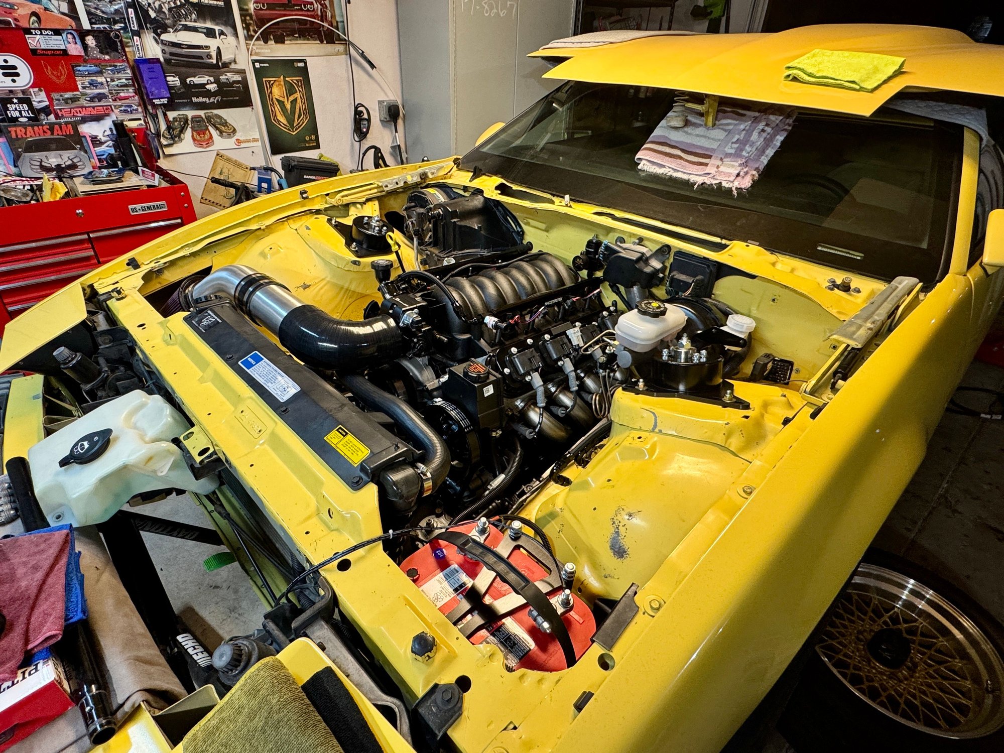

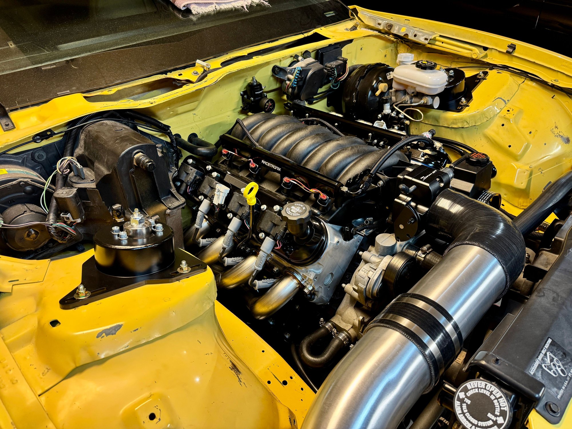

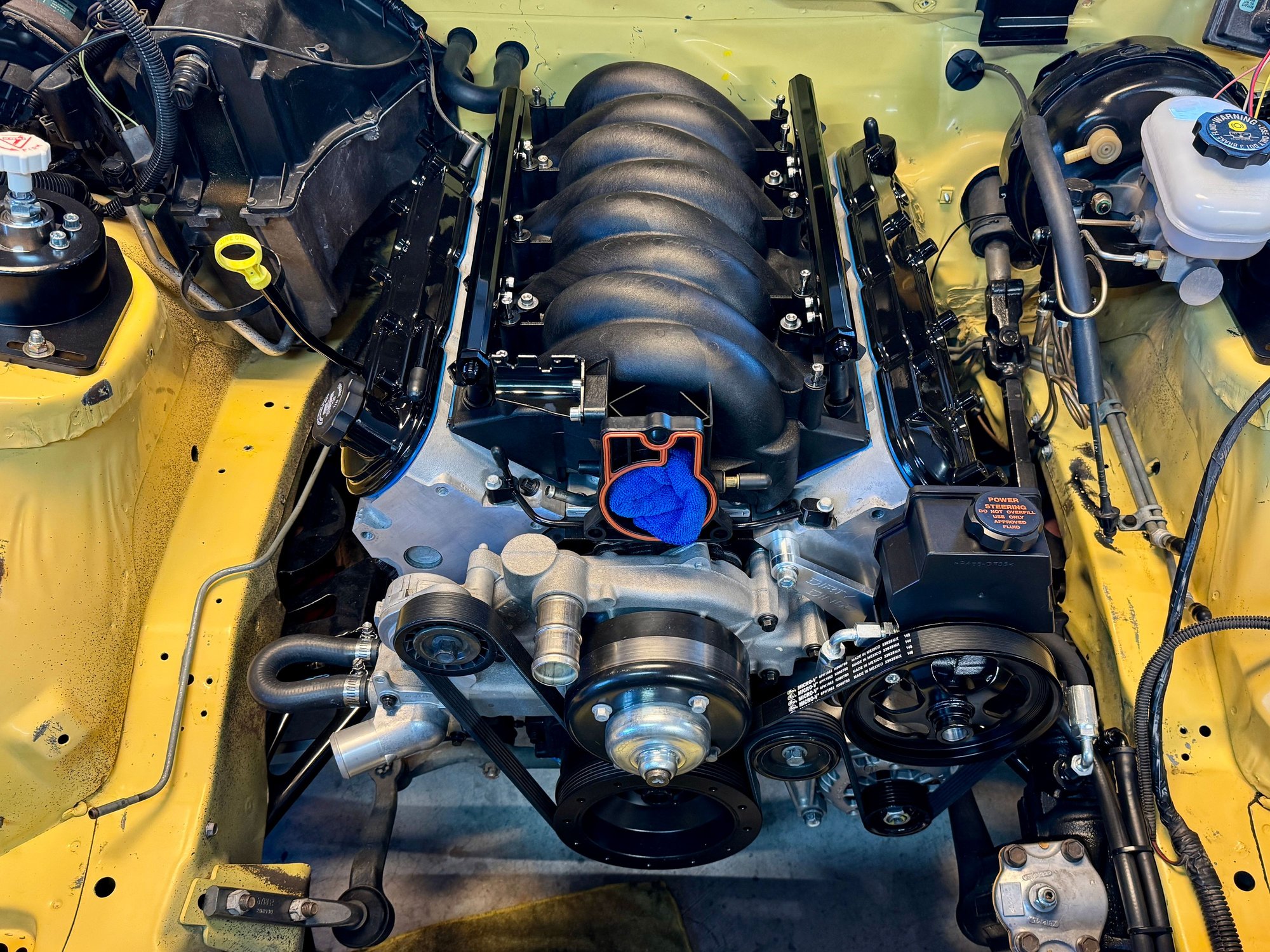

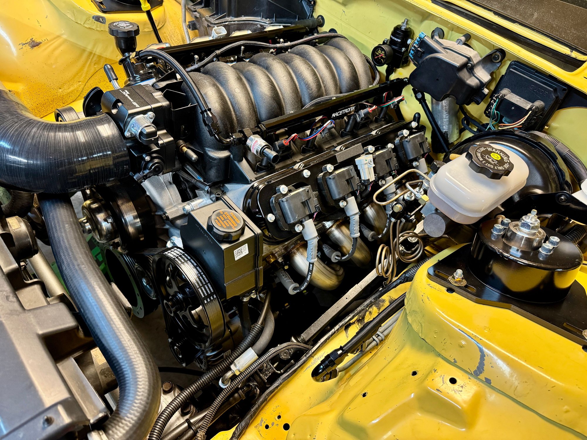

Engine – The engine has been in the car since my last post, but it’s now ready to fire. The fuel system is plumbed with 6AN PTFE hose under the hood, and I’m using the stock supply and return lines under the car. The only things I have left to do are to cap the barb on the fuel sending unit that ran to the charcoal canister, install the new tank vent I purchased from Hawk’s, and install the AN adapters on the sending unit and return line so that I can run an AN hose and replace the original clamped rubber line. I was going to purchase my headers from Hawk’s, but after reading through posts on multiple forums about the headers from Speed Engineering, I figured I could save some money and gave them a shot. The headers are beautiful. The welds are fantastic, the flanges are thick, the plug wire clearance is excellent, and they fit perfectly without any modifications whatsoever. The only headache they gave me was having to lift the engine slightly so that I could install the passenger-side header. This wasn’t a header issue—I just didn’t have enough room between the transmission bellhousing and K-member to install them.
The 85mm Holley Sniper throttle body that’s now bolted to the intake came from Summit. To finish the air intake, I need to get a few clamps, and I need to trim about an inch of silicone off the 90-degree boot that connects to the throttle body to give me enough room to run a hose from the radiator to the coolant overflow tank. Right now, my plan is to take the two aluminum tubes that are connected with the coupler to the machine shop near me to have them welded together, and I’m going to have a bung welded in for a threaded IAT. Then I’ll have the tube powder coated. I bought a fourthgen radiator for the cooling system, but I didn’t like how it fit, so I sent it back. After doing some research, I found that Hawk’s sold the upper and lower radiator hoses I needed to run my stock thirdgen radiator. I already have provisions on it for the coolant overflow tank, along with another outlet that I’ve threaded to install a hose barb to connect it to the coolant crossover from the heads. I’ll be using my stock dual fans, which have already been rewired and are connected to the triggers on the Holley harness to control them.

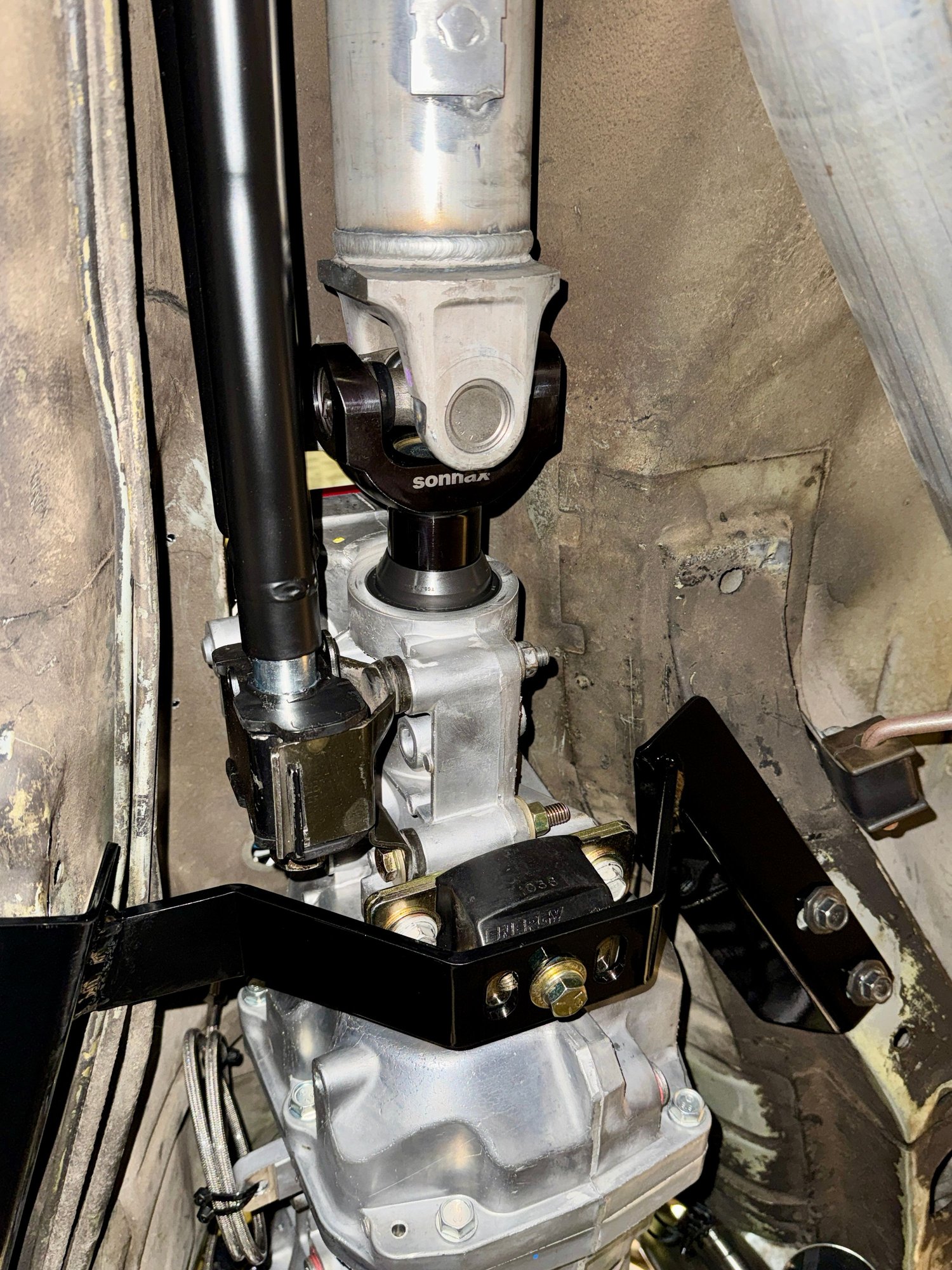

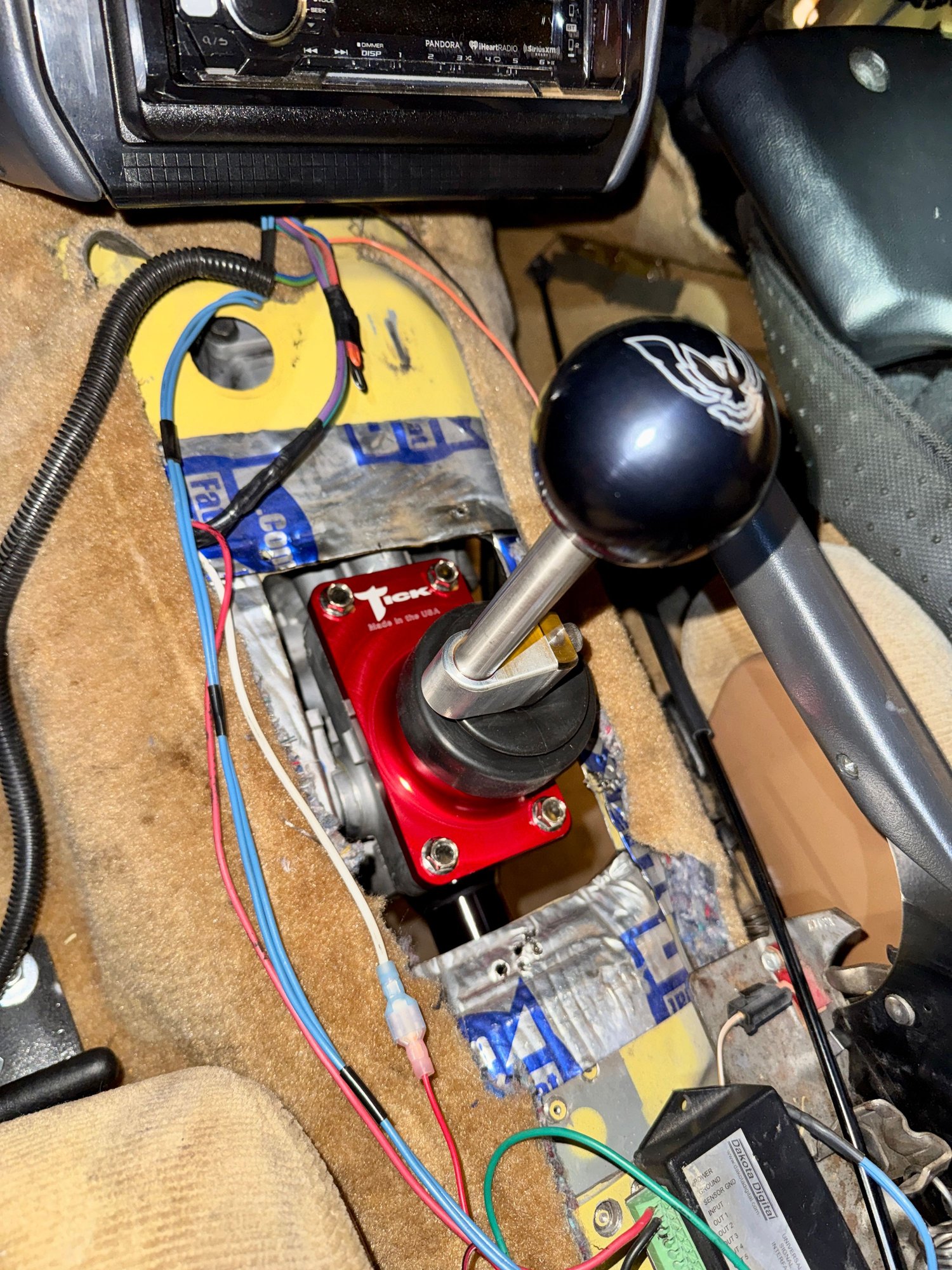

Transmission – The transmission install was absolutely uneventful. I started with the pilot bearing, followed by the RAM HDX flywheel and clutch that were recommended by Tick when I purchased the Magnum F. Next, the transmission was bolted in and supported by the new Hawk’s crossmember. I initially didn’t buy a shifter, but the one included with the transmission from Tremec just wasn’t doing it, so I sprung for the Tick shifter. In the past, I’ve had shifters from Pro 5.0 and MGW, and the Tick shifter is right up there with them as far as feel and quality go. All of the clutch hydraulics are GM from Tick, and I opted to add the speed bleeder line when I purchased the slave cylinder and throwout bearing. I bled the clutch using the line, and then got every last little bubble out of the system with my MightyVac. Before installing the transmission, I also did all of the measuring required to correctly shim the throwout bearing, and the correct shim was installed.

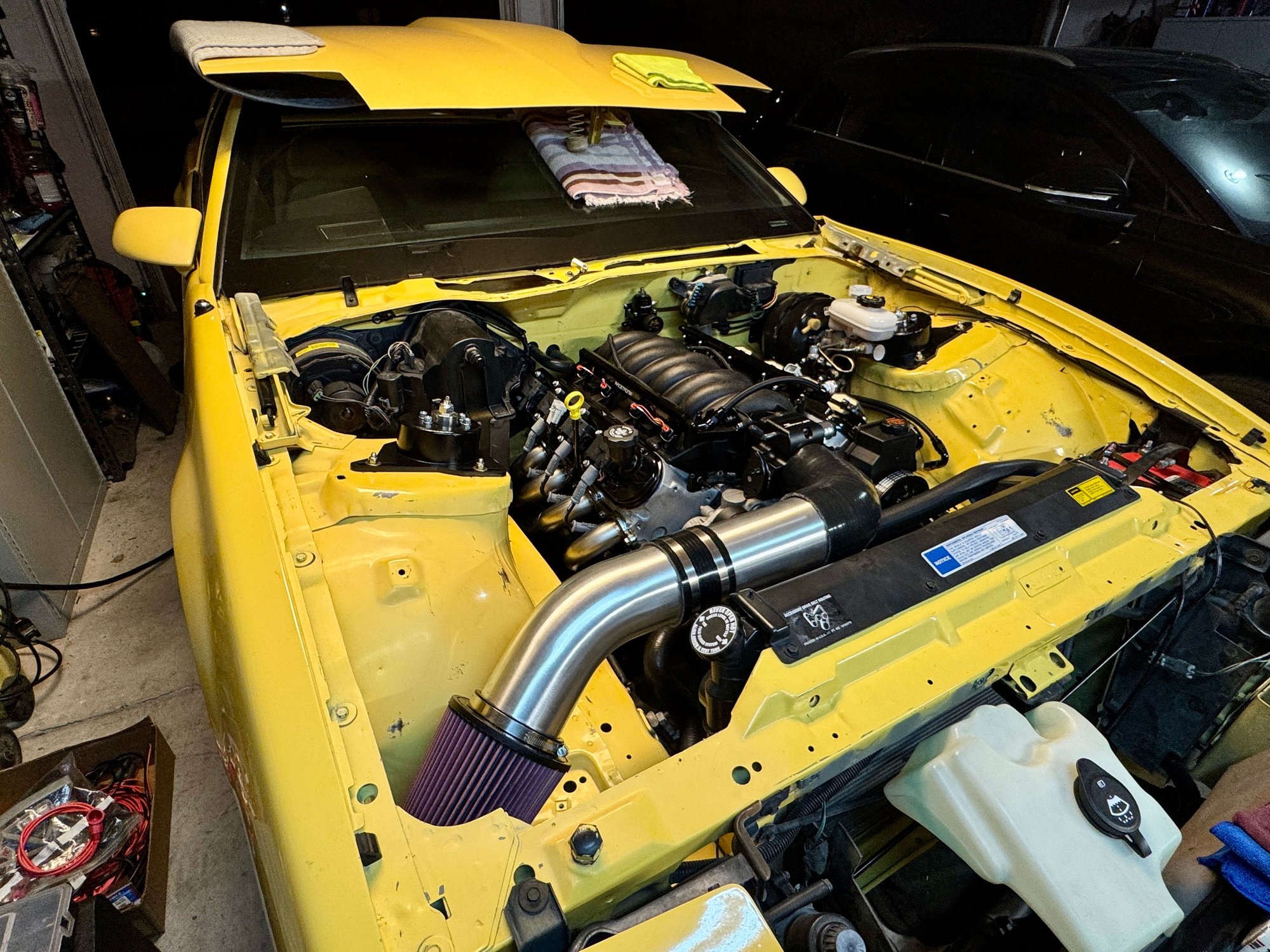

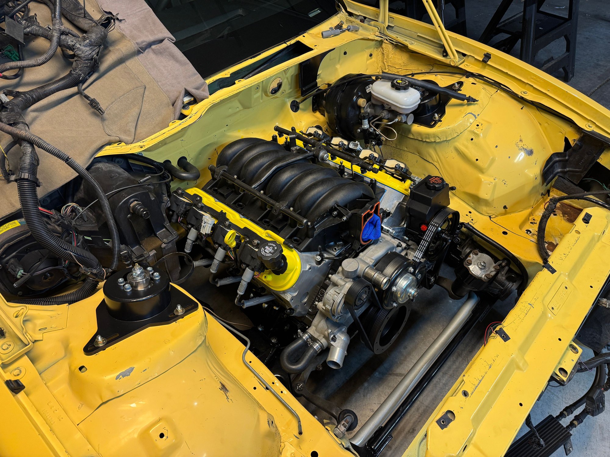

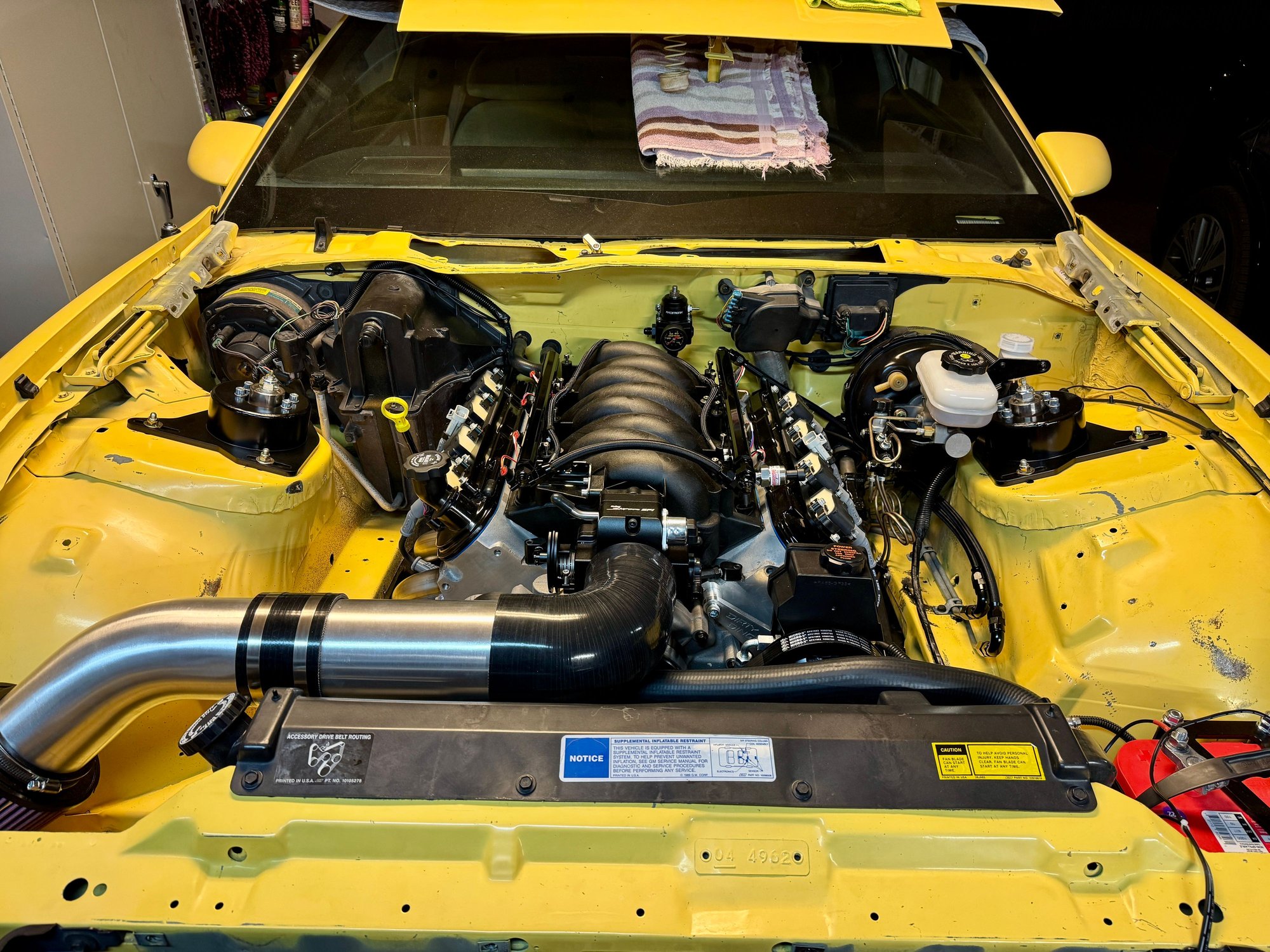

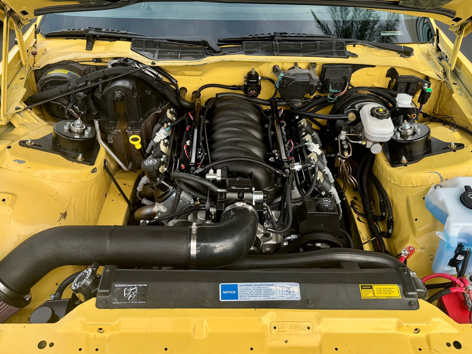

My Trans Am is officially LS swapped. I moved it from one side of my garage to the other yesterday under its own power so I could bolt the hood back on. I need to rig up an exhaust extension now so I can drive it over to the exhaust shop to have a y-pipe made. The way it is currently the computer can’t learn because the AFR is all over the place because the O2 sensor is only a few inches from the outlet of the collector. It needs more pipe so the exhaust gasses aren't constantly contaminated with fresh air. Stay tuned!

I have a short list of minor things to finish up, but I feel incredibly accomplished seeing it move under its own power again. The car will definitely be ready for LS Fest West in April, and I have already taken the time off.

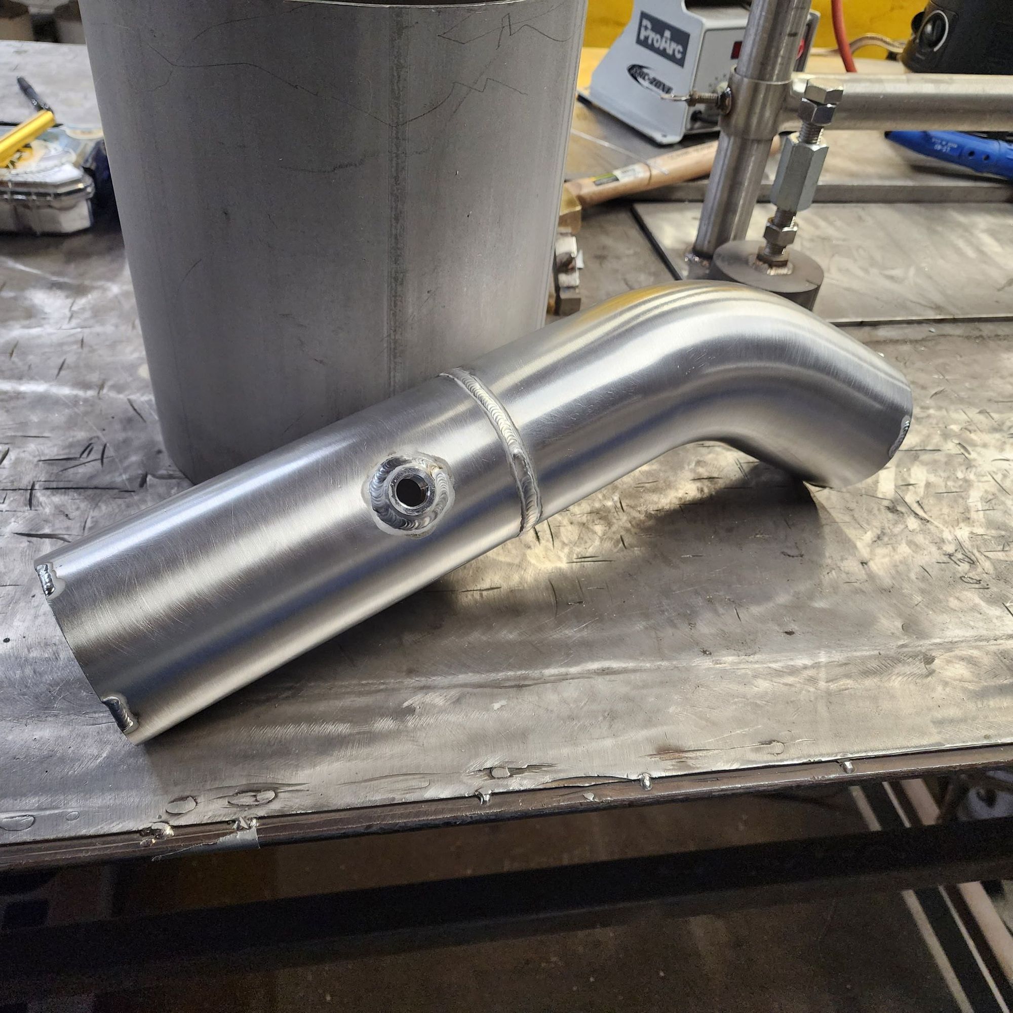

Right now, the air intake is off the car getting painted. I had a friend weld everything up so I would not have to use a silicone coupler. Of course, I did not have the new coolant overflow installed when I mocked everything up, so now it is interfering with the intake. I noticed that Canton Racing Products makes an overflow tank specifically for thirdgens, so I am hoping that solves the issue.

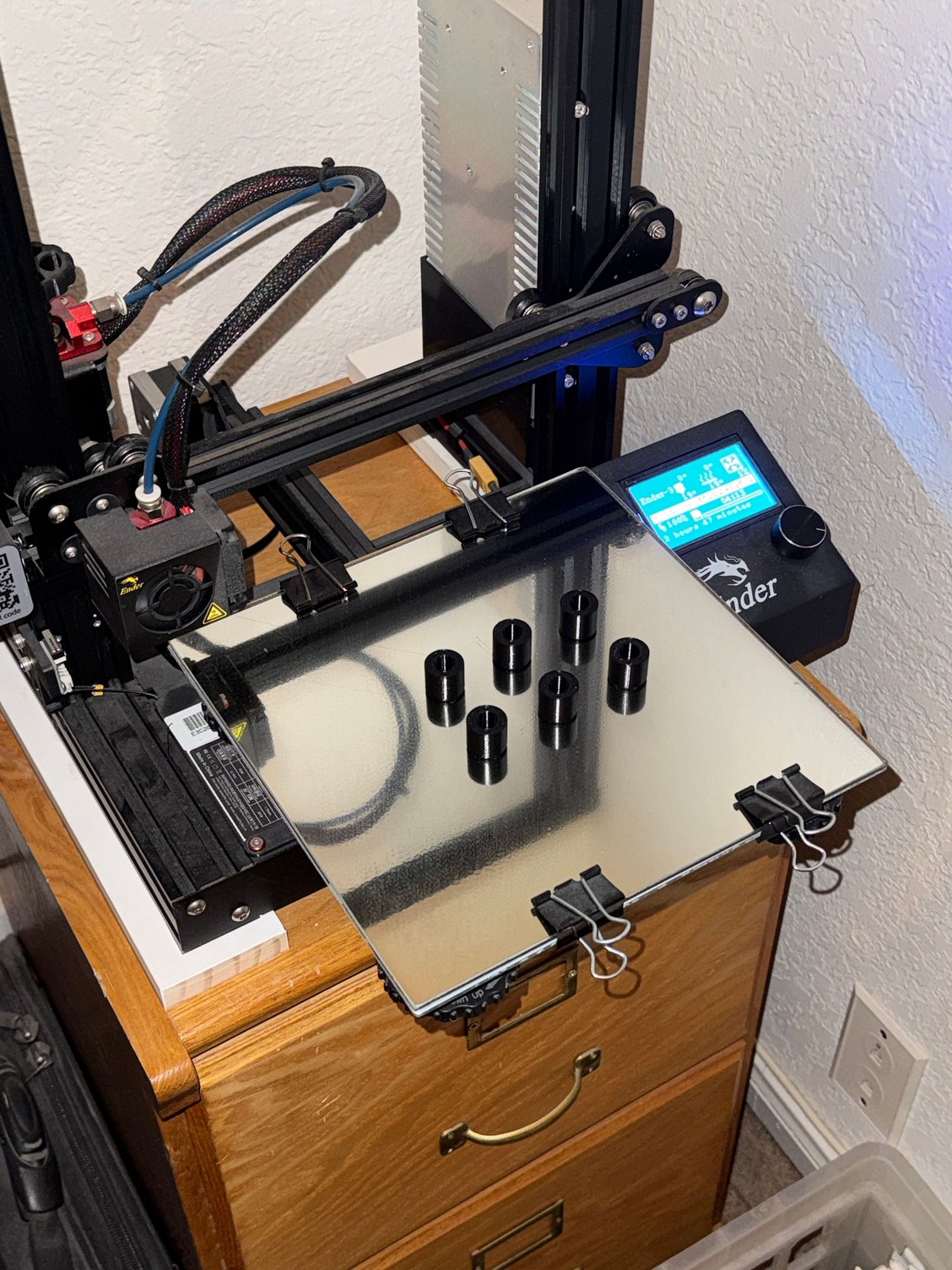

I watch a lot of YouTubers use their 3D printer to make custom parts and I'm happy to announce I finally jumped on the bandwagon. I needed a set of spacers to mount my new coolant overflow reservoir so I designed them in Tinkercad and then printed them on my Ender3 using TPU. They came out excellent. Next I'm working on a mount for my Holley dash. What a great tool!

Welcome and thank you! If you check out post #161 it has one of my favorite pictures of the car out in the sun. I'm replying from my computer but I'll check my phone for something more recent.
Good luck with your RS. This place is the best resource on the internet for all things ThirdGen!

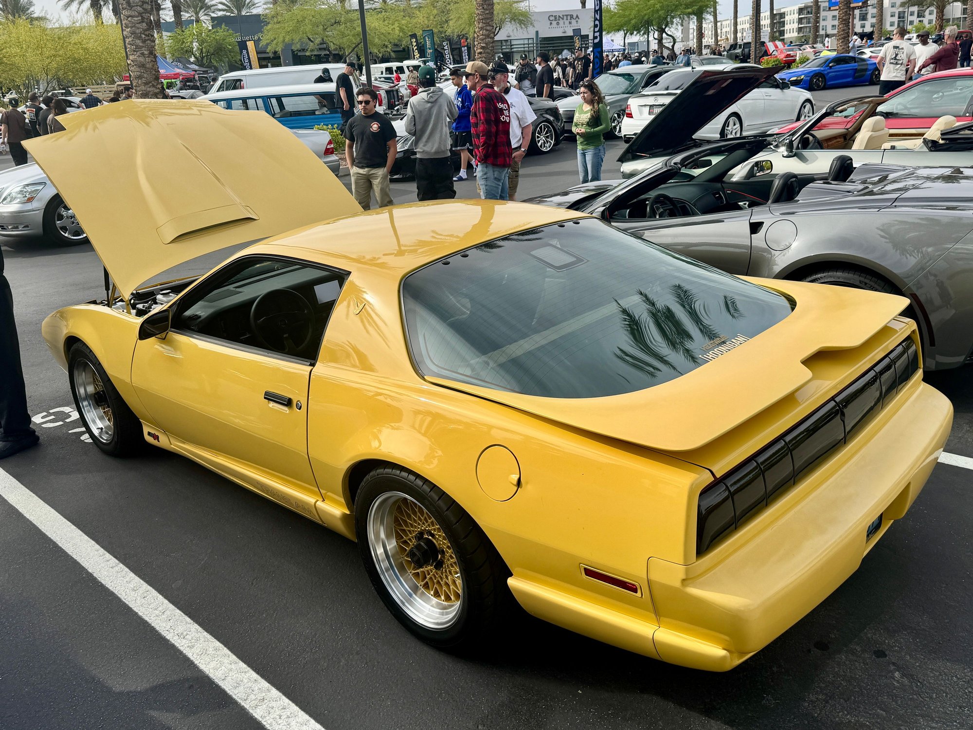

This is the best I could do for a picture in the sun. I’ll get some more posted up here soon as the weather is warming back up quick!
