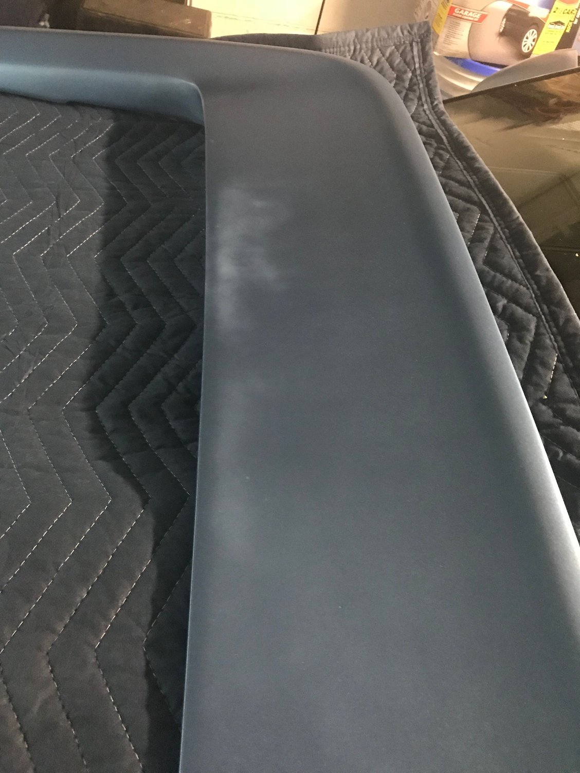

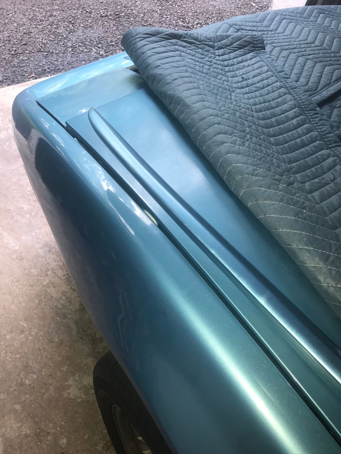

Wetsanded and did a second coat to the spoiler. Color matched pretty well. In the first pic you can see the spoiler “tip/wing” against the car body.
Still trying to figure out some weird areas though. It seems like the paint isnt covering very well a few spots, as you can see in this picture.

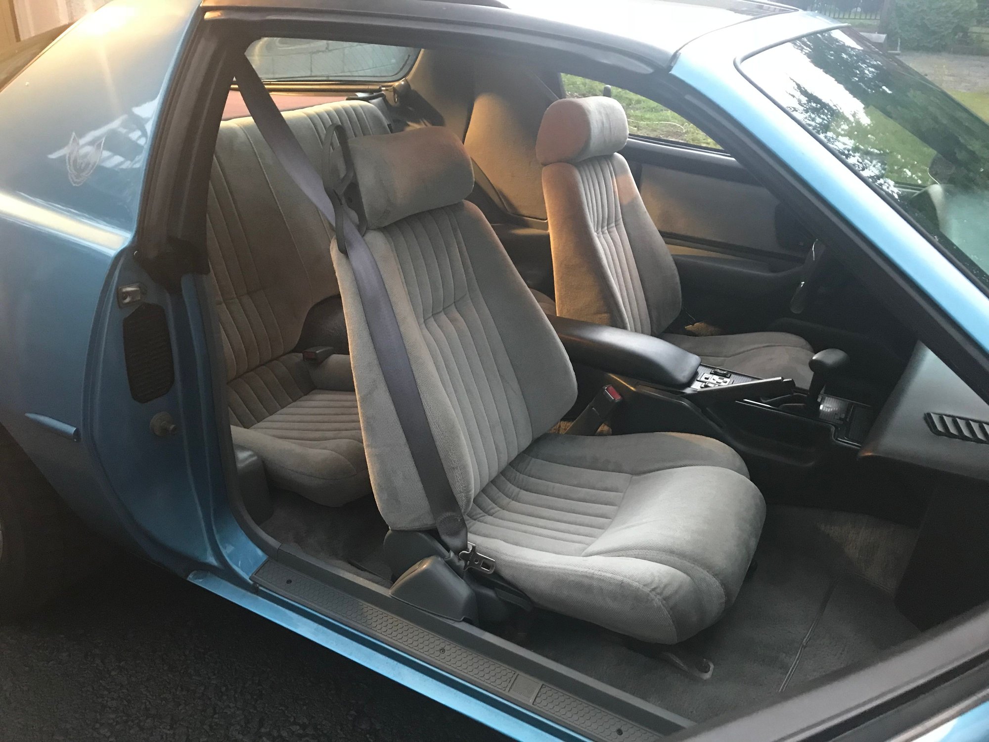

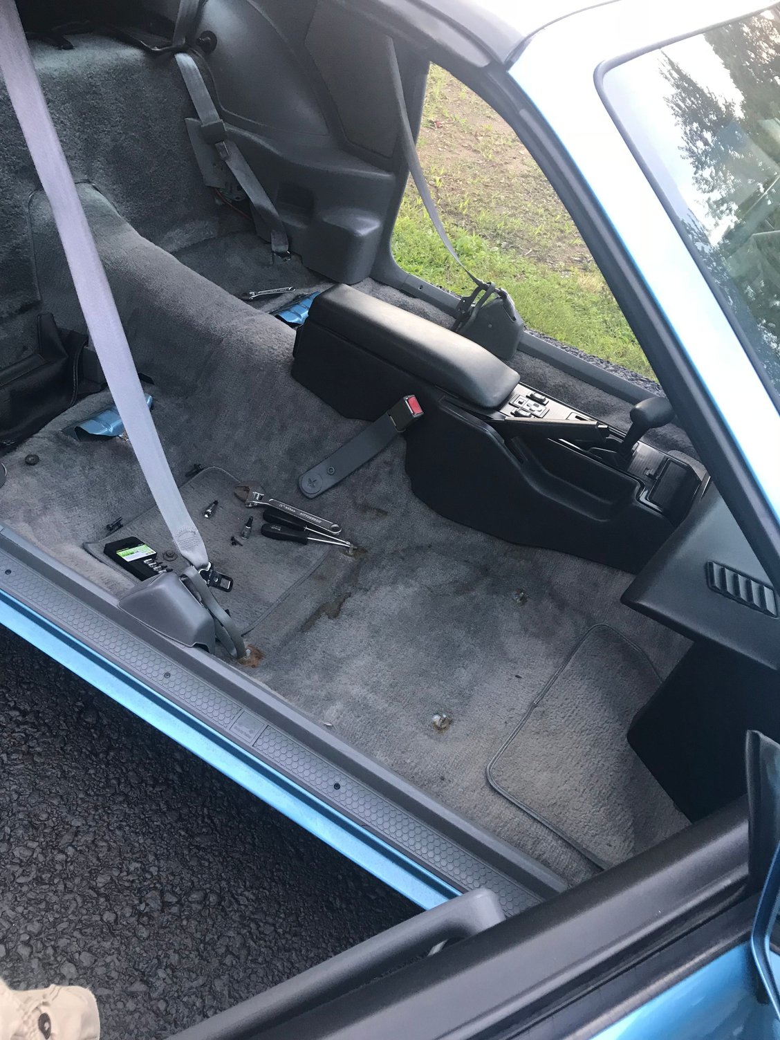

Finally decided that I wanted to get rid of the seats sitting in my garage. So I pulled the old crappy dark grey 4th gen seats and put in the original seats. They look so much better but have some rips. I figured it was better than having them take up room in my garage since I wont get around to recovering them any time soon. The swap took about 2 hours total, with me also sweeping and changing out the seat belt receivers for a new set I bought from Hawks. I like it, but will like it even better when they get completley recovered.

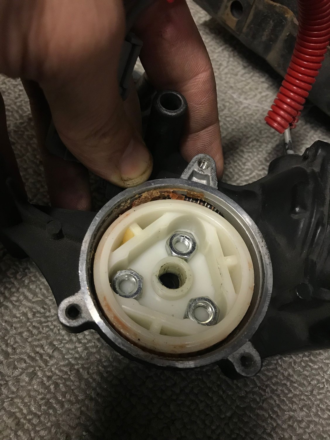

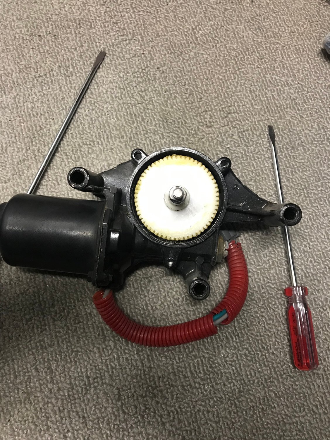

So it’s been awhile...like 7 months. Amazing how much time a utility job, house and baby can take lol. Anyways I finally started going back into the bird with some things I planned on doing over the winter; radio, headlight motors amd window motors. I already removed the radio and started on tge headlight motors. There are a ton of videos out there on it but then you gotta find the 3rd gens, then find the one that shows removing the assembly, then one that doesnt suck. But I finally found one and got the passenger side out in about 45 mins. Then got the driver side out in about 15. The drivers was fine but why not change both together, right? The passenger side was slightly slower going up than the driver and stuttered when shutting. Took the motor apart and found 3 nuts acting as the bushings, or whatever you want to call it. So someone half assed replaced it at one time. I think the gear is still in pretty good shape.
(If i can figure out why my pictures are uploading extra freaking large i’ll post a picture)
The driver side motor I took apart and noticiced is slightly different. The pin doesnt go through the housing like the passenger side and the gear has the “open” side face down. I can not for the life of me get the pin or gear out of the motor. Anyone know what im doing wrong?

Some guys have forced the gear out past the pinion gear I never could.
You have to take the 2 screws out of the motor housing and lift it up and out. Those screws break easy so, heat, lube and any other trick you can think of b4 you try to loosen them helps. Becareful, little ballbearing on the bottom of the shaft, motor brushes and thin shims. It's fun to put back together.

So I either have to pull and yank that gear out of there or tear the whole motor apart? That sounds like a pain. Couldnt just easily pull out like the other side.

Nope, for some reason they thought the gear needed a rib around one side..

Finally got around to repairing my headlight motors...what a pain in the butt. I had to take the top part of it (which i was trying to avoid) and had a fun time getting it back on. Thankfully my wife was willing to help put the top piece in as I held the insides of the motor apart. TDS sent great product and directions on what to do. As well as a youtube video or two to help. Just got to get the headlights back together and in the car now.

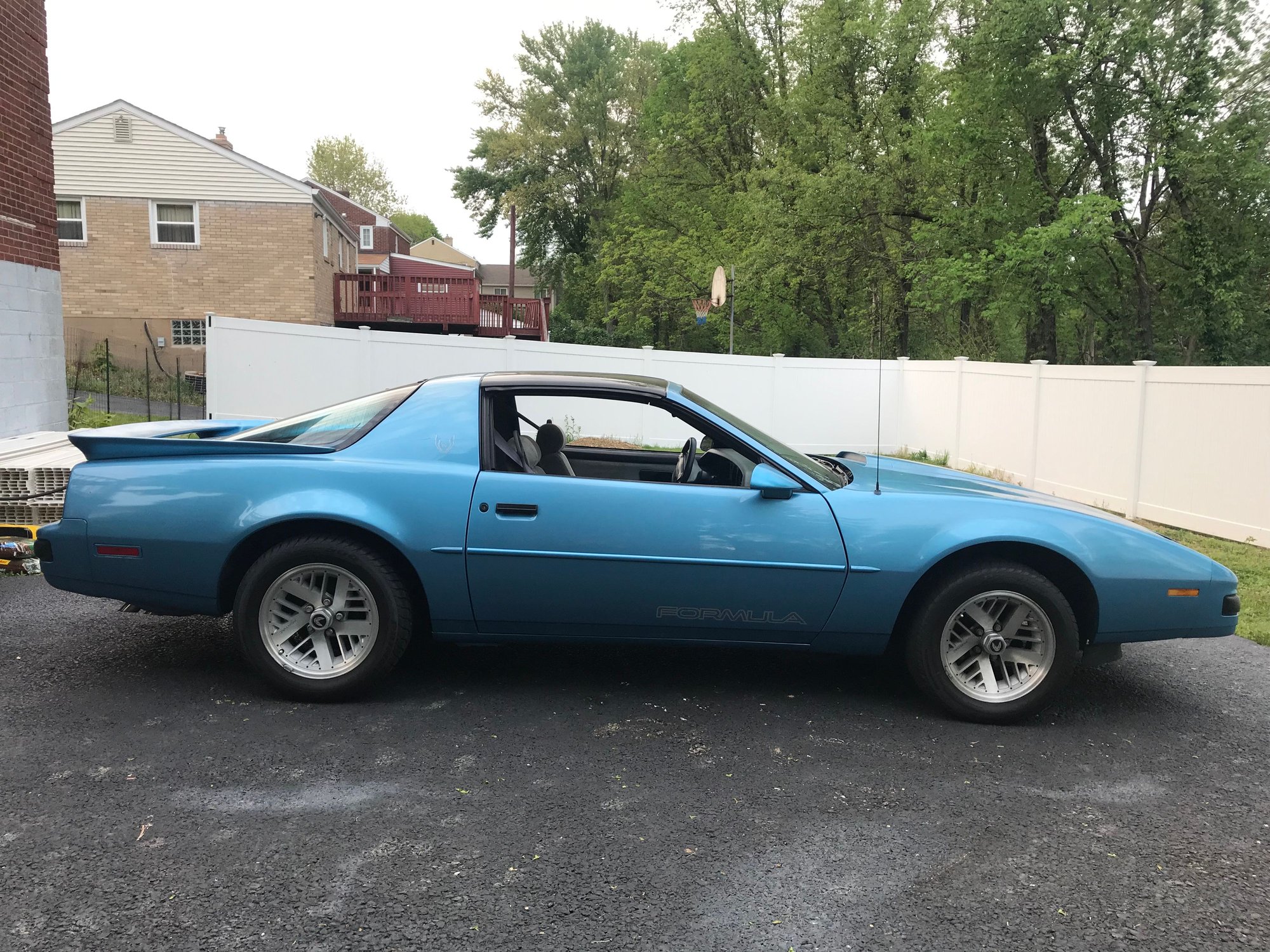

Not much work done on the car. I was going back and forth about if I should save for paint or try to do the engine first. Still not sure. On one hand, it runs pretty strong and if it was repainted (next year) I could take it to shows and cruises and feel good about it. On the other hand, I have a torn down L98 block scattered all over my work bench. And I’d be pretty nervous pulling and swapping engine with brand new paint....decisions...
Anyway I do get the car out about once a week to cruise around town. So I just snapped a few pictures in my drive way after I washed it.
