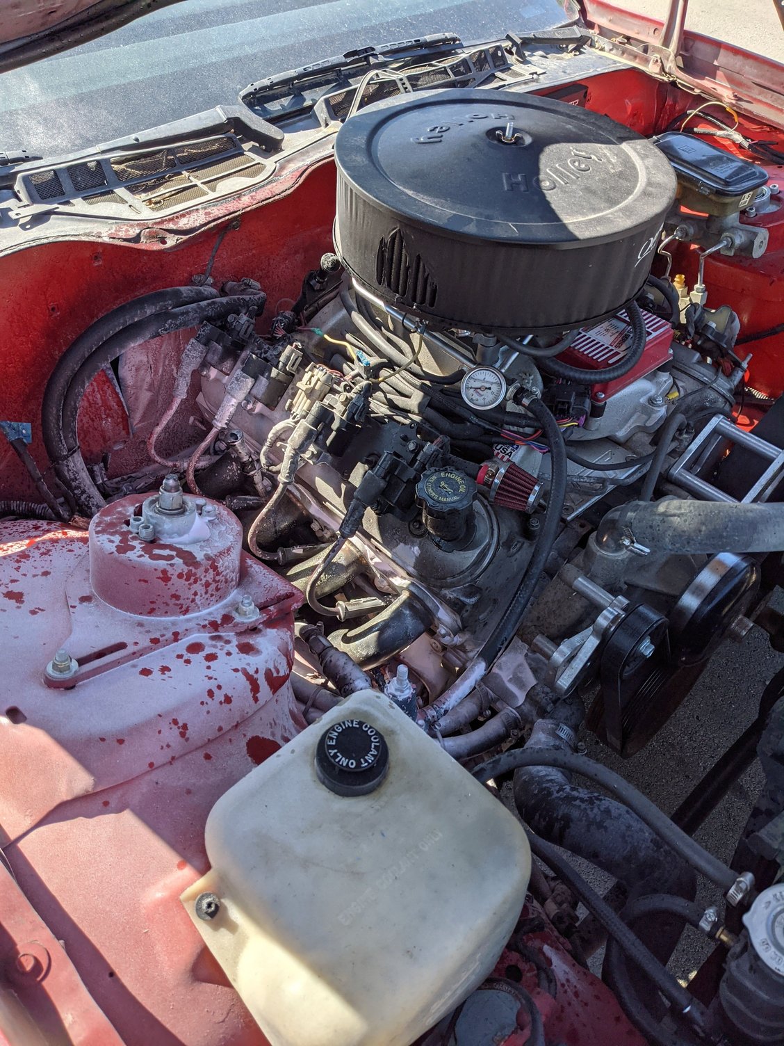

Updated the air cleaner. Taller filter, and no more top filter bit. Backfire through the carb on a bad tune burnt a hole in the old one. Solid metal shouldn't burn right?

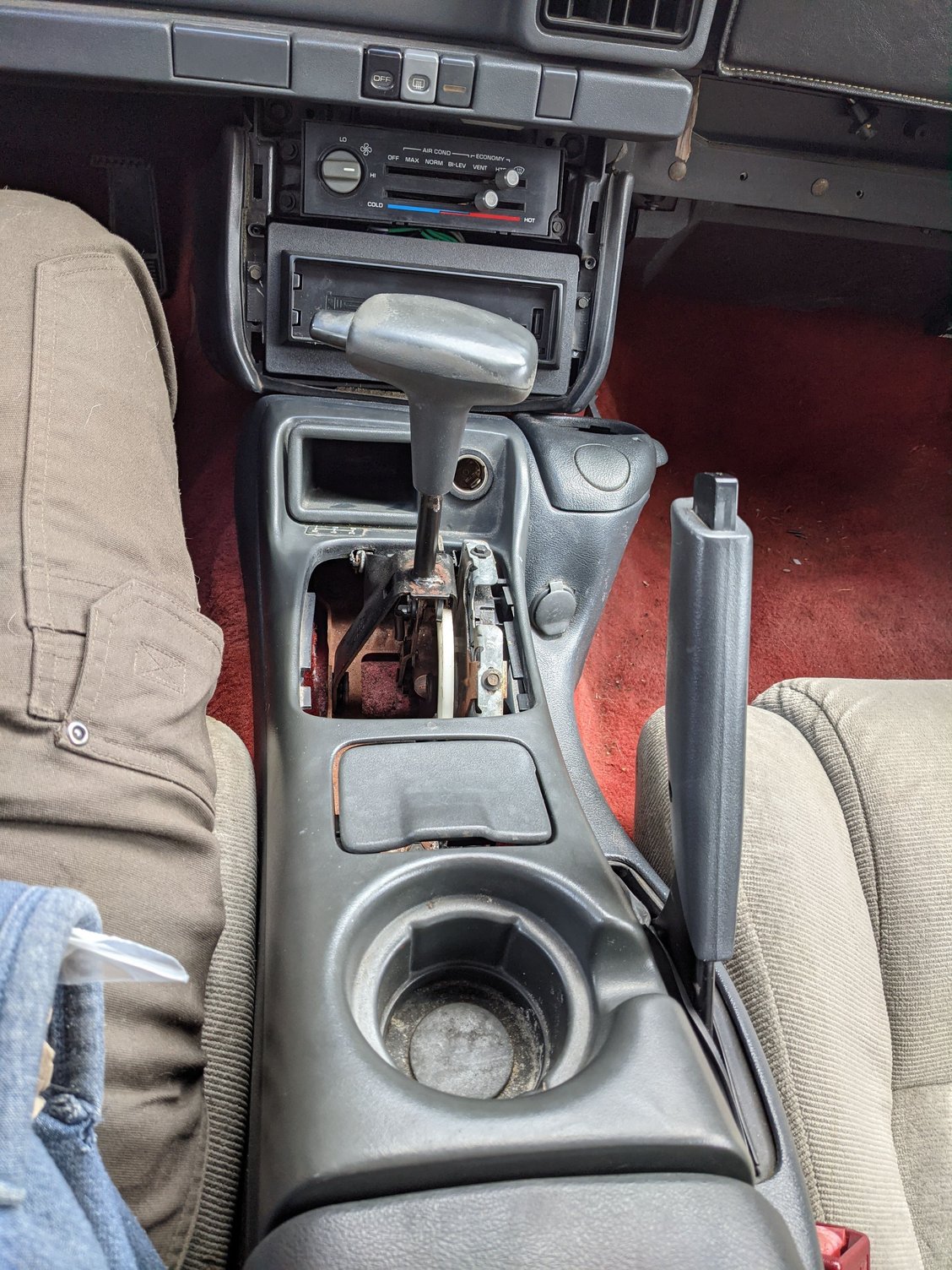

Put a 4th gen 5 speed center console in. Feels good to have cup holders and a lid that isn't in a dozen pieces. I do need a sticker to cover up the 5 speed decal....

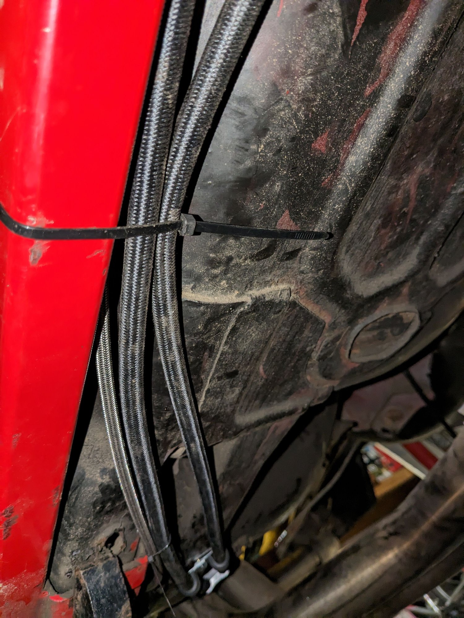

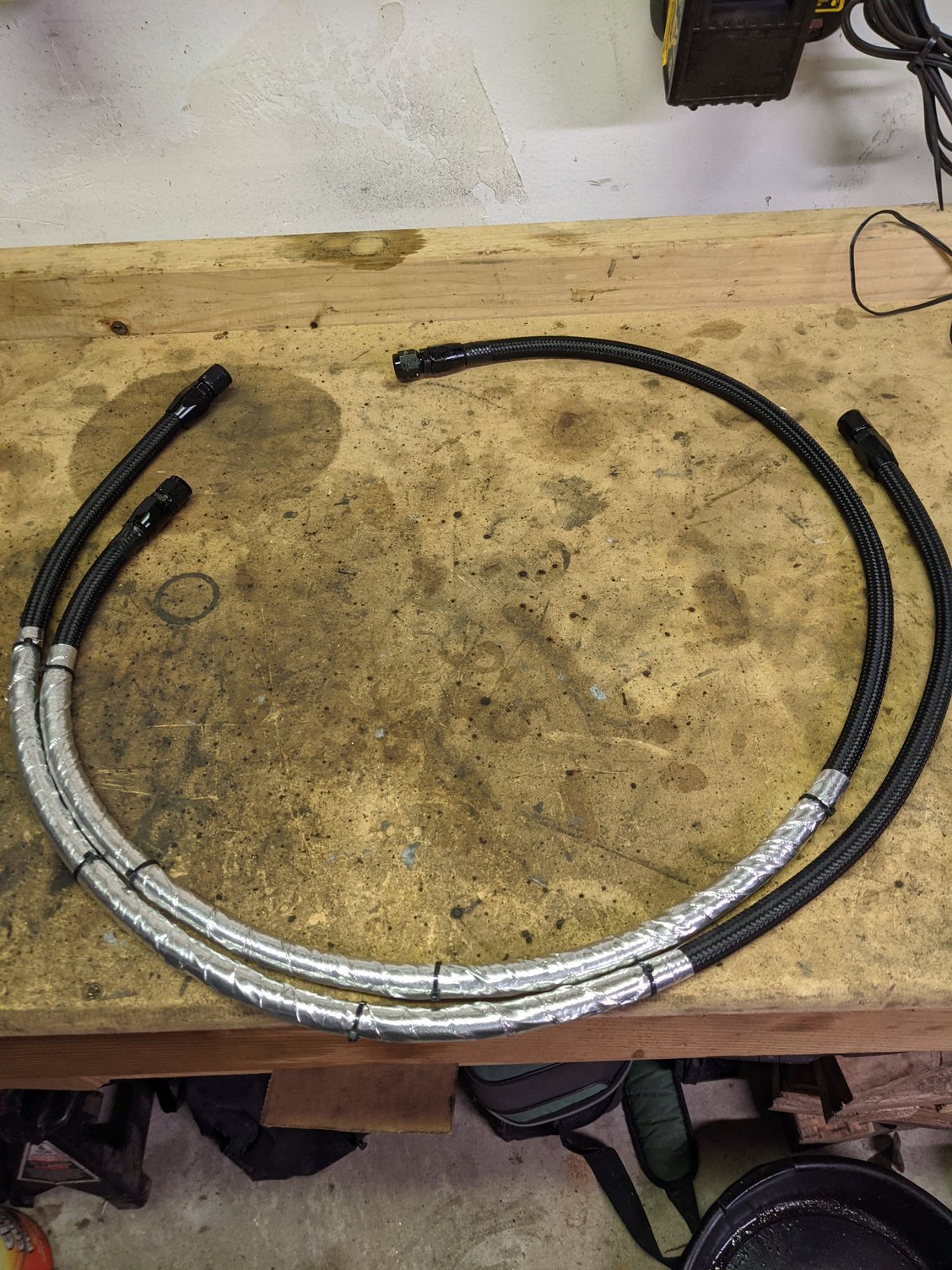

My original custom transmission lines burnt holes in them. They were resting against the headers and I didn't bother to check. Luckily they went out only a couple blocks from home so I was able to limp it just fine. Street still has the trail of fluid.....
Put new lines in with some heat shielding:

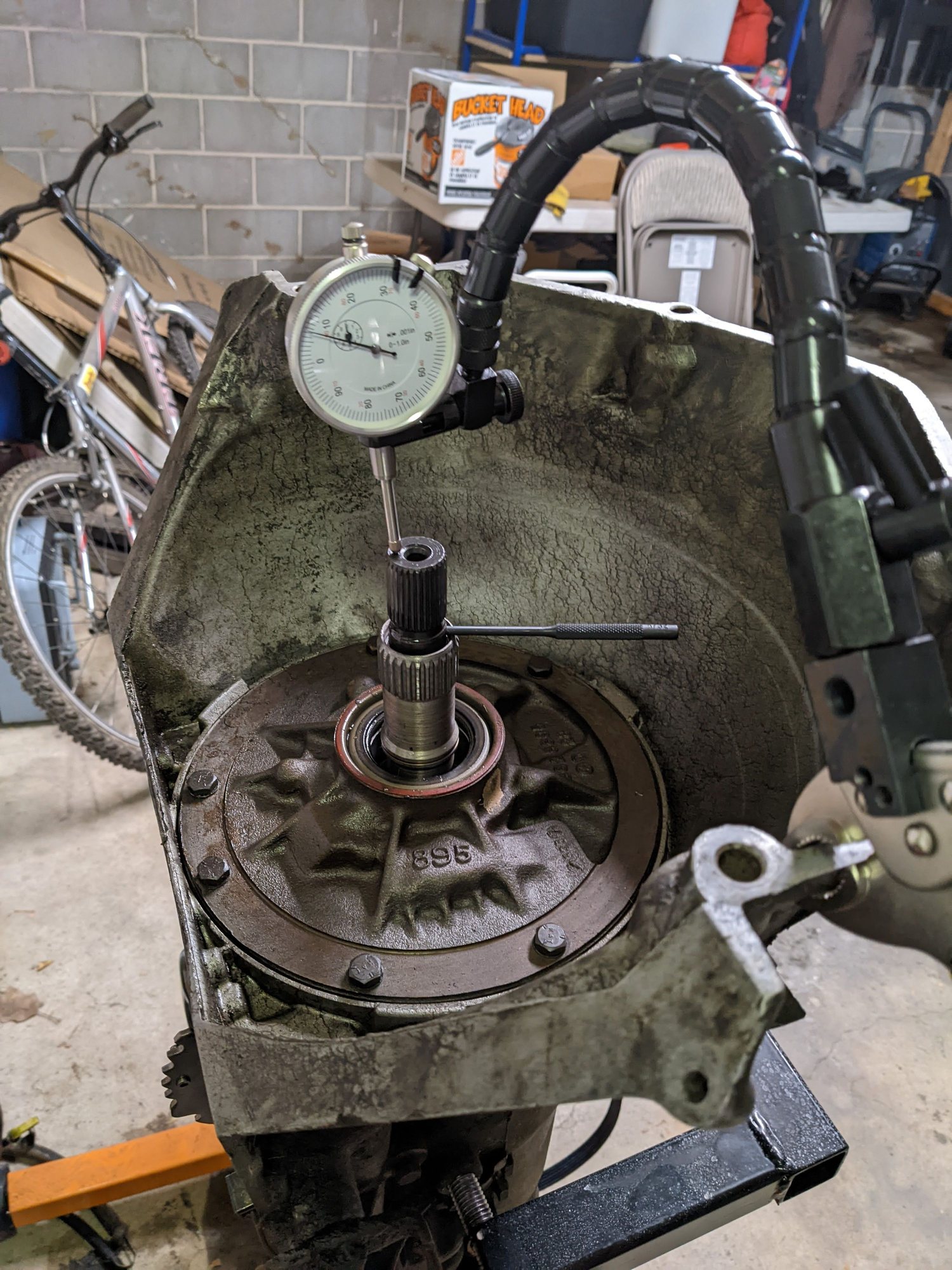

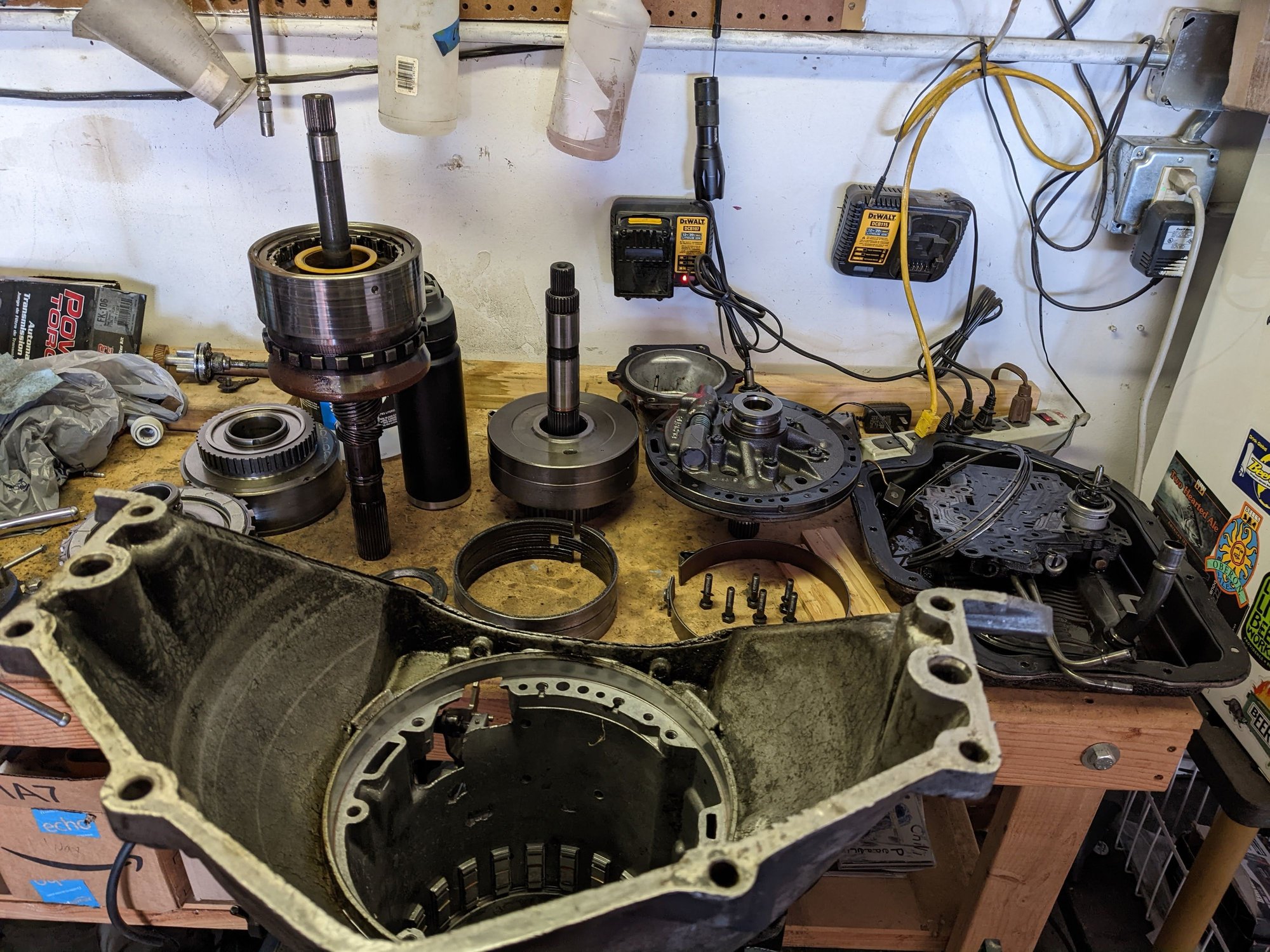

Didn't like how leaky the TH400 was, and had a spare, so decided to tackle a rebuild over the winter. Here's a couple pics
Rebuilding my first transmission was scary, but I think I got it right. Repaired the wiring damage from the fire, ran new Stainless Trans lines, wrapped the headers, and got the car on the road in early May

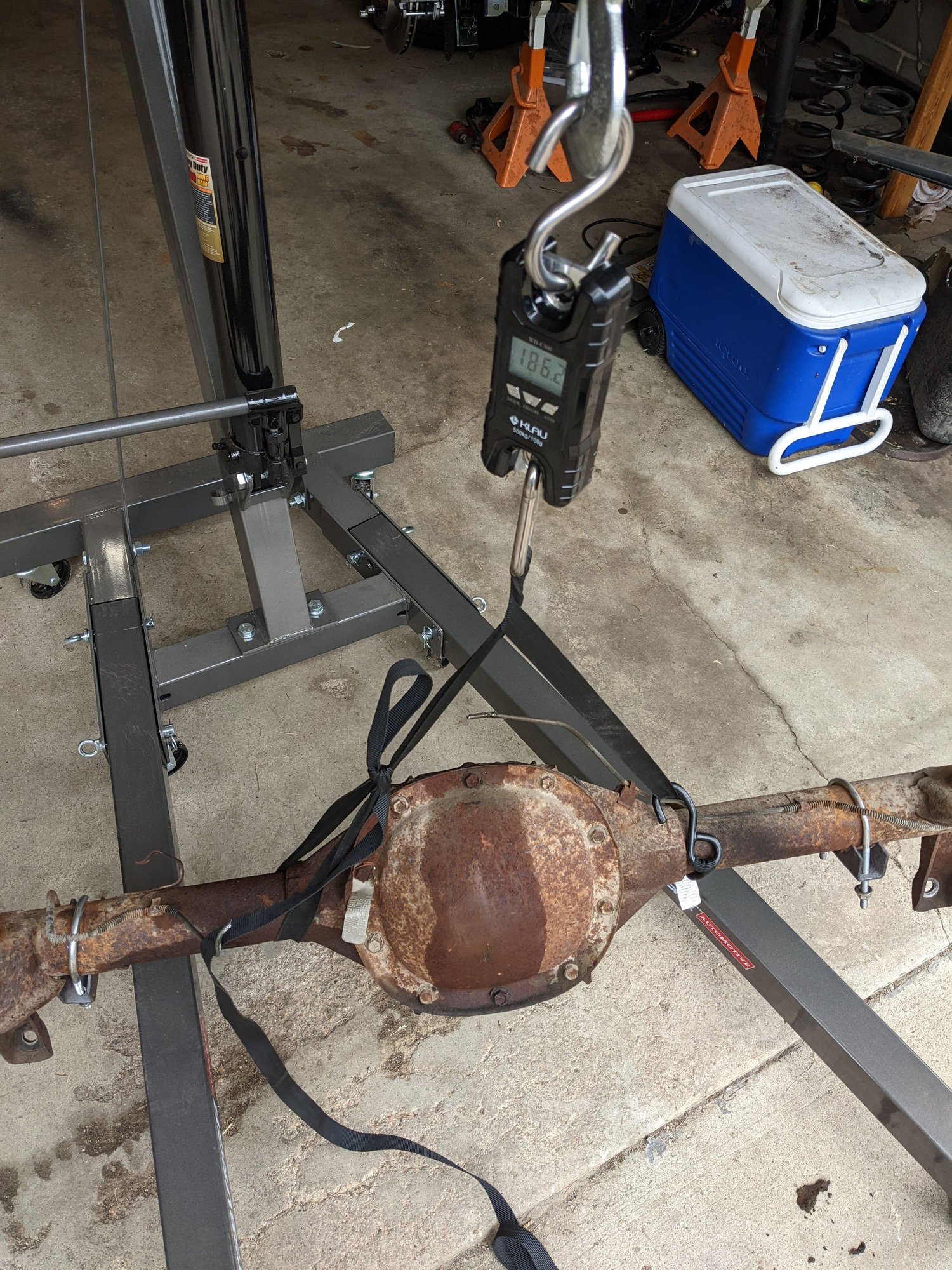

If anyone wants to know the weight difference between a 9" and the 10 bolt, here ya go.
It's not 100% apples to apples, as the 9" was dry, but it's a decent comparison
I figure 66lbs is an easy price to pay for the increased strength and better ratio.

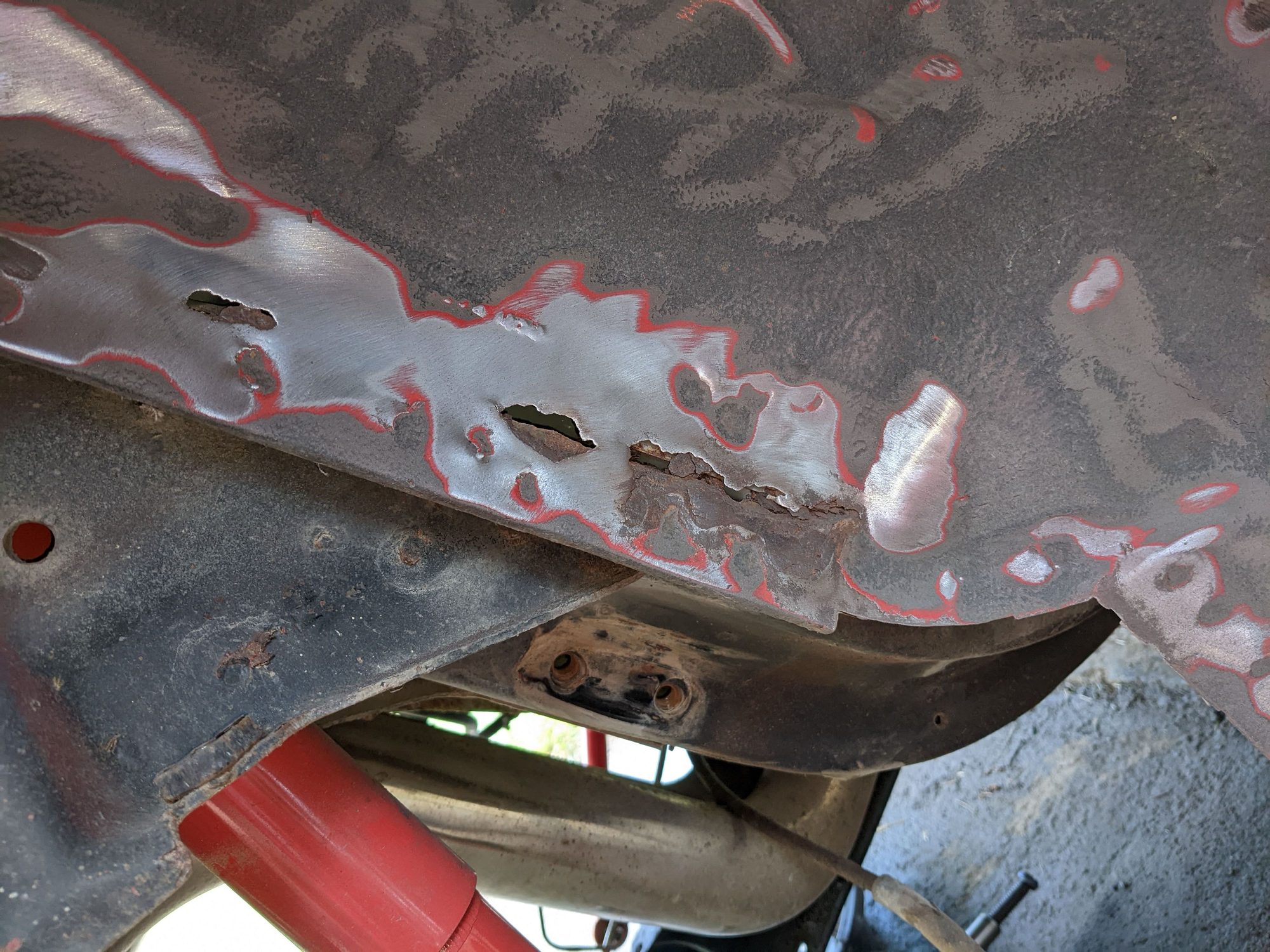

Bought a new welder this year (another Flux MIG) and took at stab at patching in a rusty area. Results are here
Honestly, Flux MIG is not made for sheet metal work. The patch works (and I was able to cover the ugliness up a decent amount) but I sure wouldn't try it on outer body panels.
Went ahead and POR 15'd the rest of the rusty spots on the wheel well and shot good old rustoleum black over it.

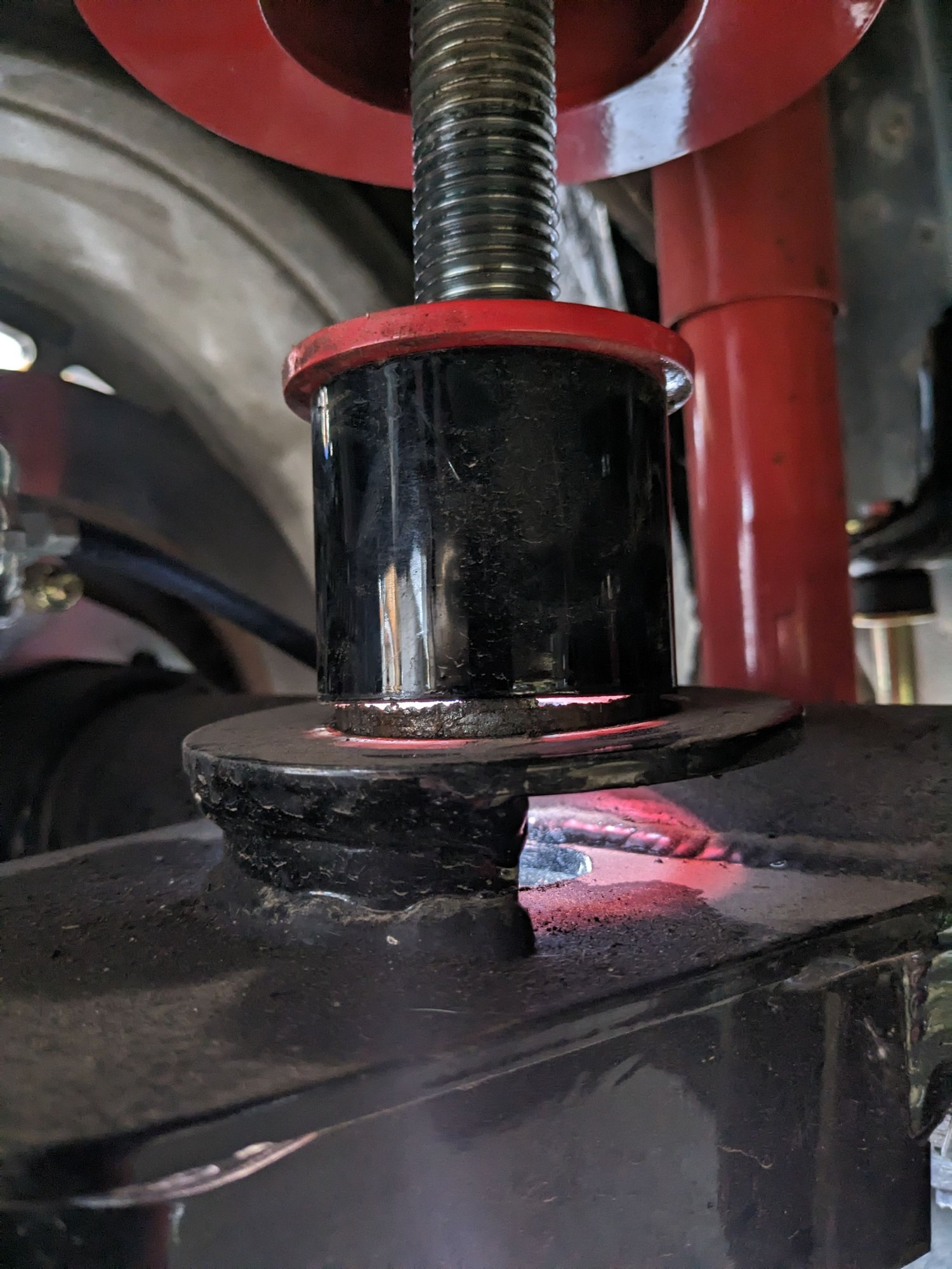

Skipped taking pictures, and the 9" is in! Installed UMI weight Jacks as well. FYI if you're running this combo you will have to create the hole for the adjuster on the driver side. Takes a hole saw, a die grinder, and some patience.

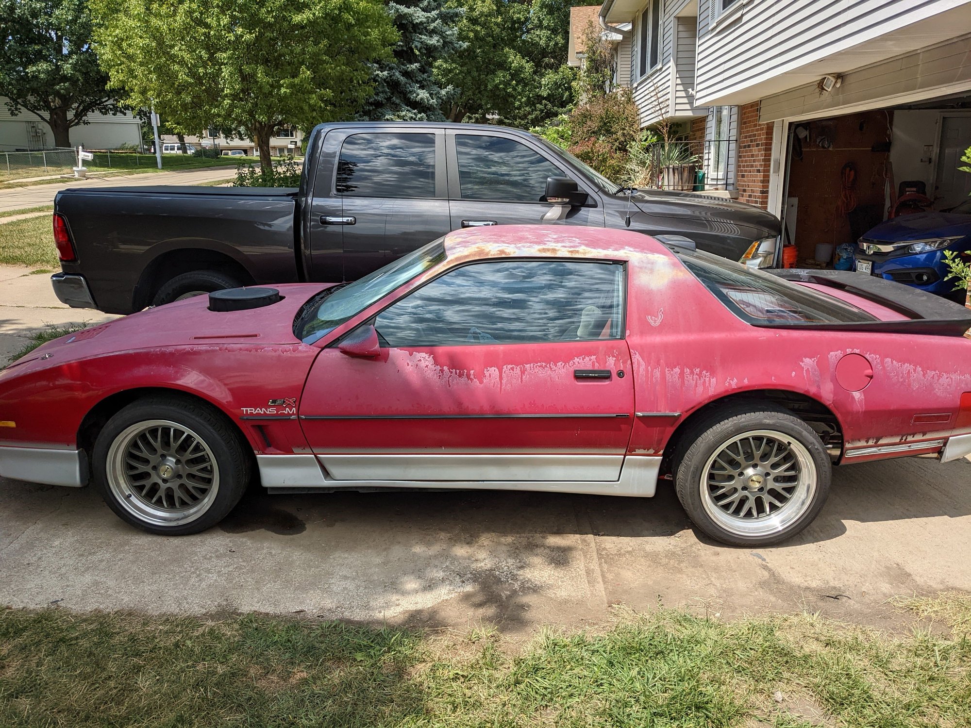

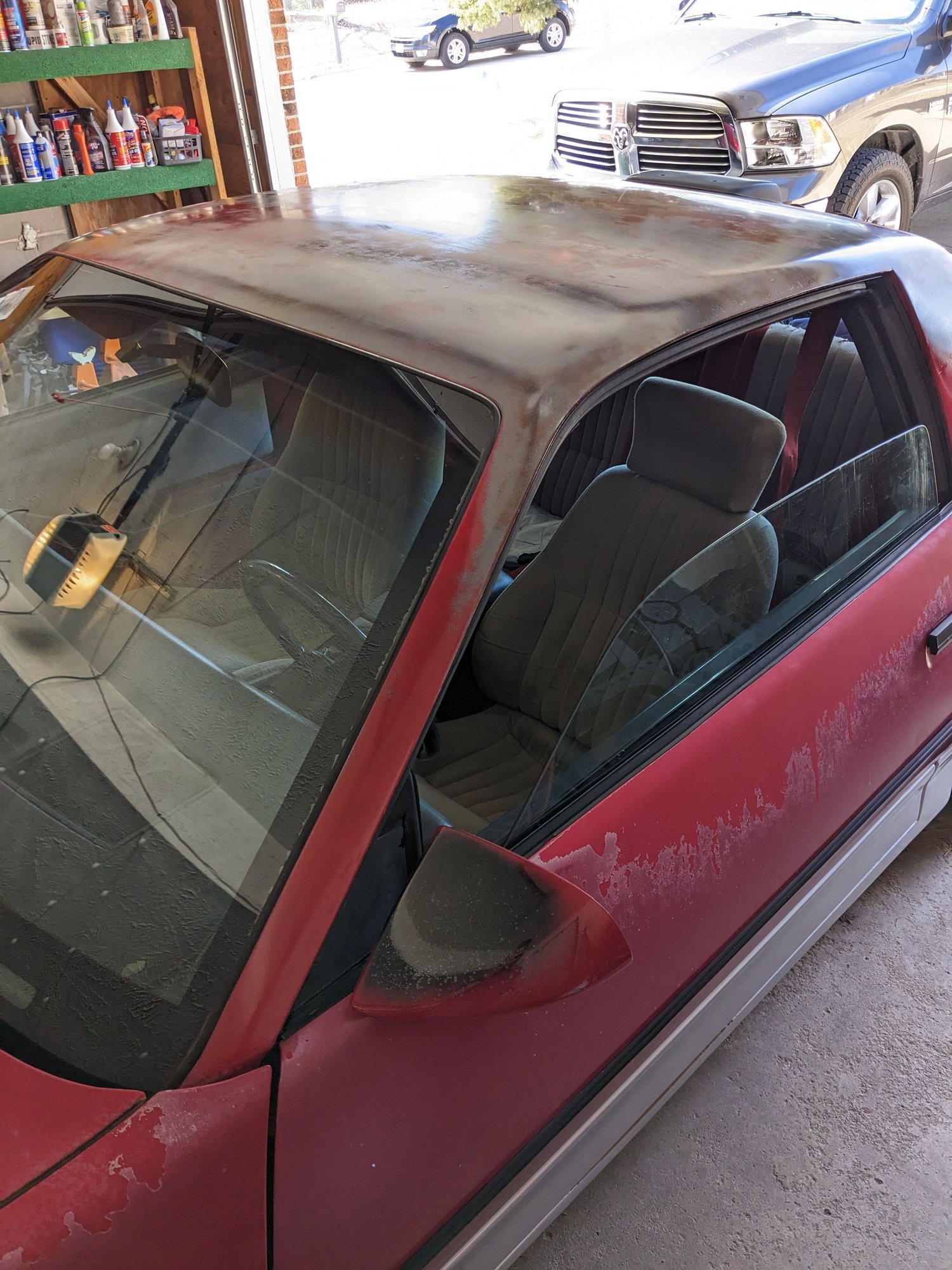

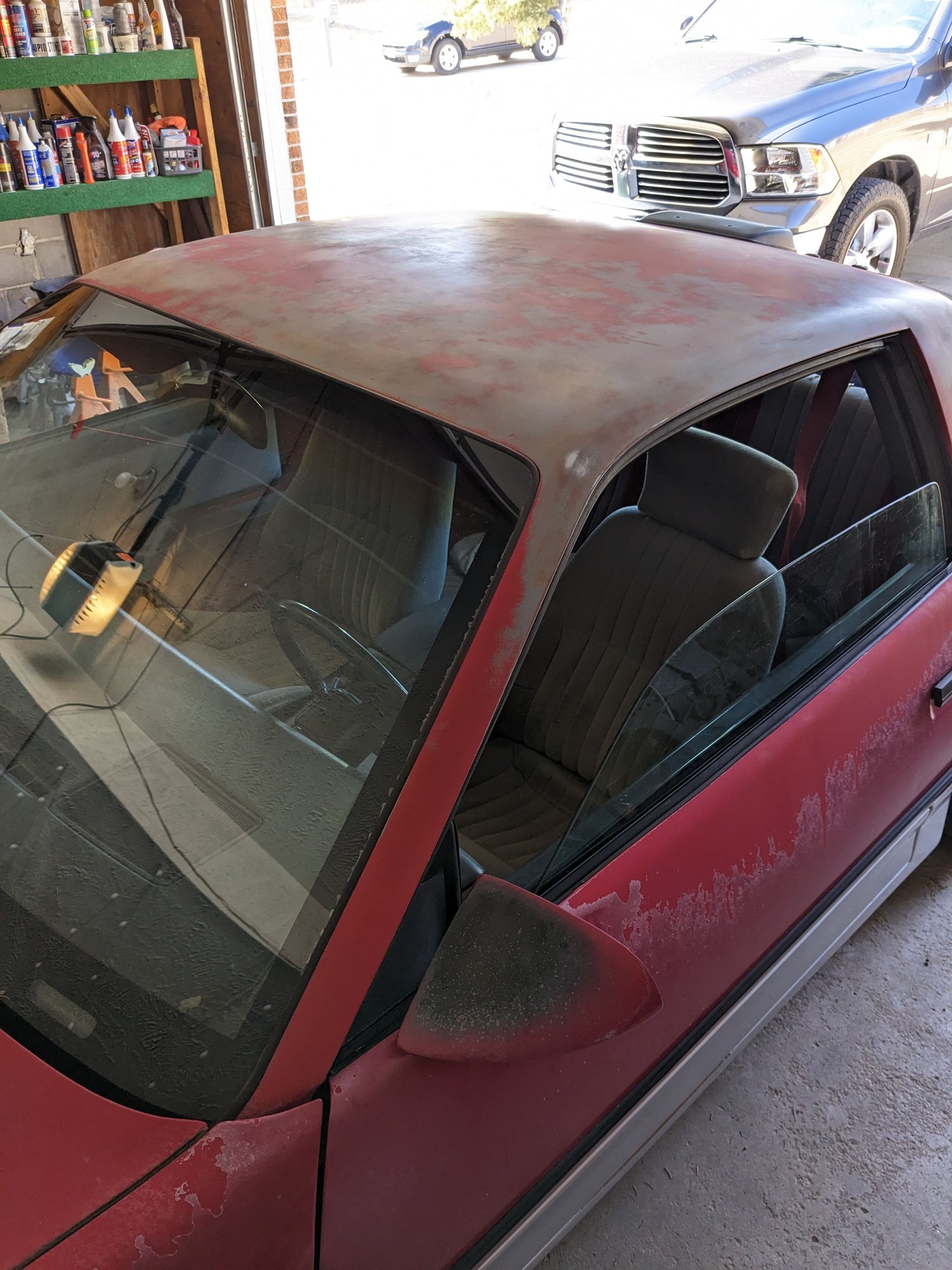

Ya'll didn't think I stopped working on this car right?

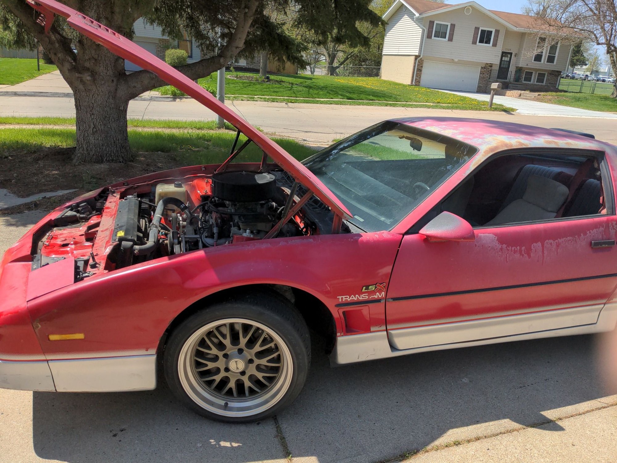

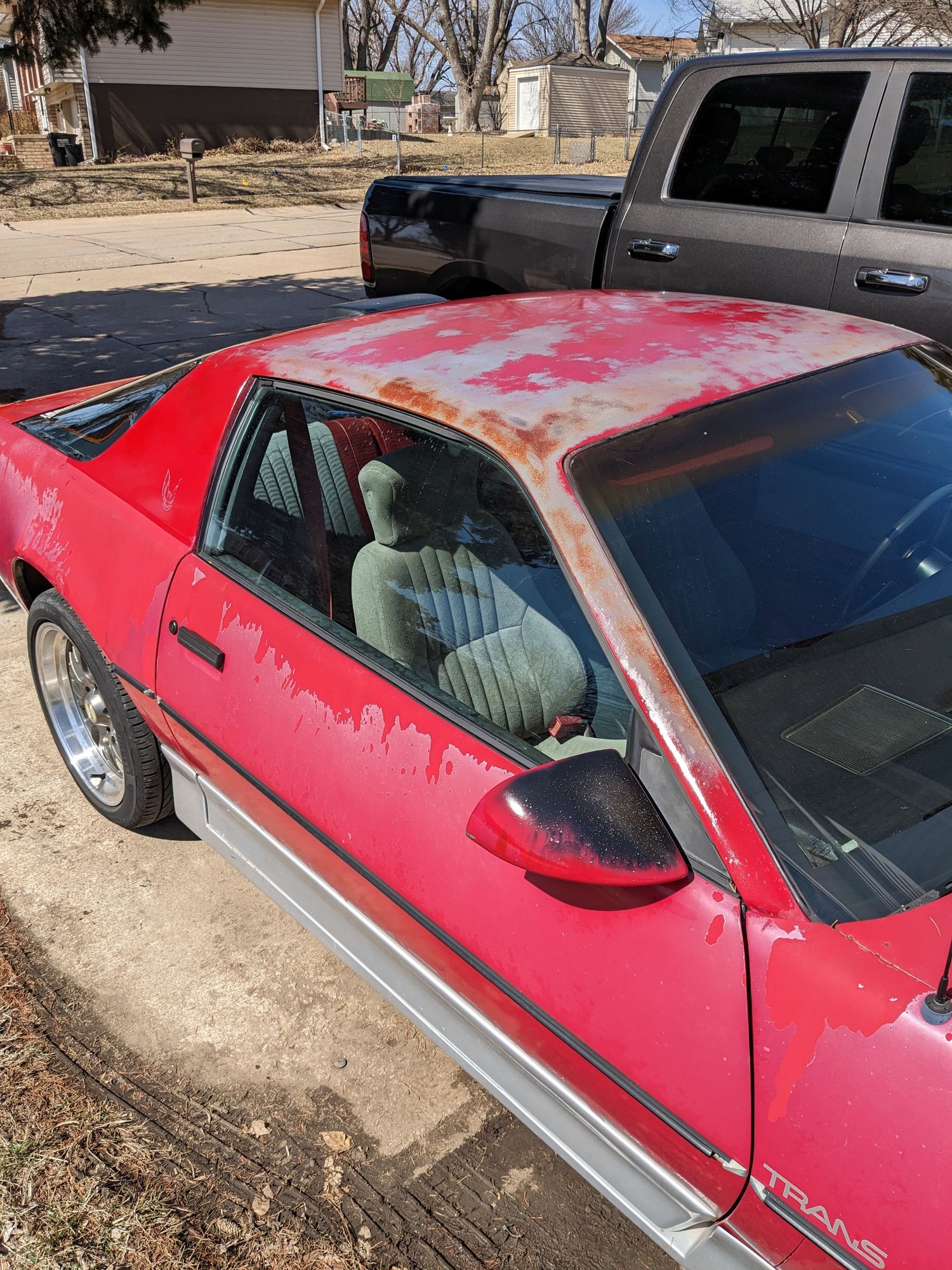

Went all in on the patina look in March. Guy that runs Vice Grip Garage makes something called "Shine Juice" and added it to the car. Results are pretty neat and I don't have to worry about the rust spreading more
Drove the car a bit in March and April

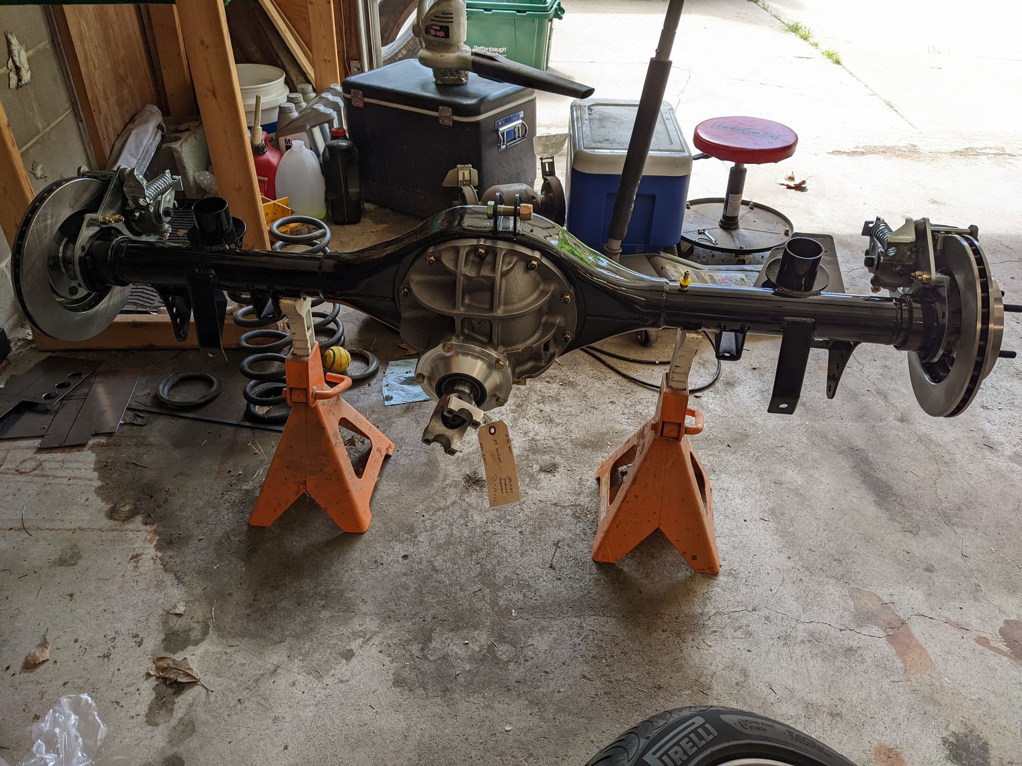

Car felt weird so I got underneath it to adjust the weight jacks. Glad I did. One of the welds failed on the rear end.
Very happy I caught this in the garage instead of dropping a spring going down the road. Quick Performance took full responsibility and I decided to pull the rear and take it back to them so they could give me a new housing better setup for the weight jacks. All in all a crappy situation but I'm impressed how they handled it.
Hey I got an upgrade out of the deal too!

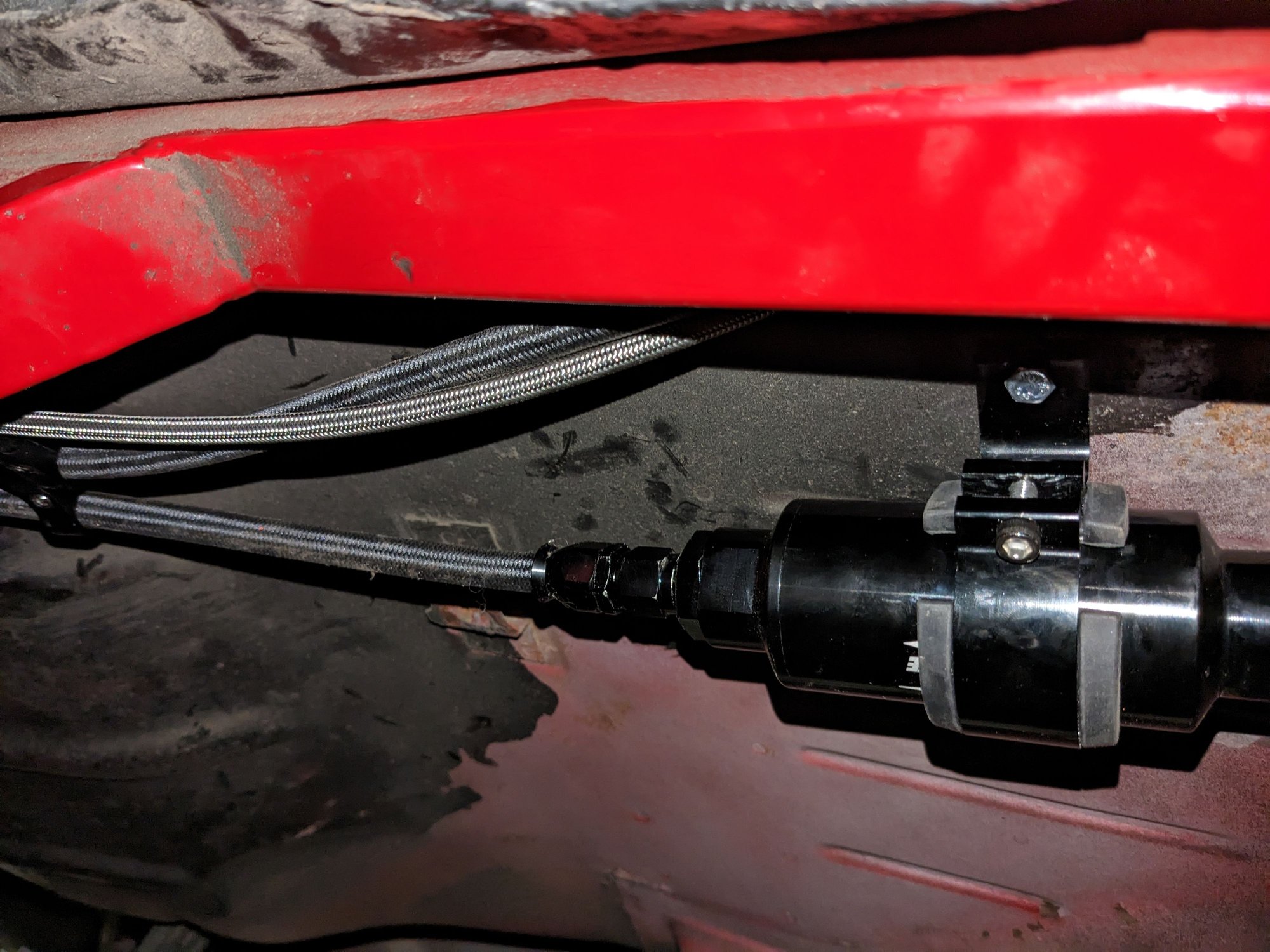

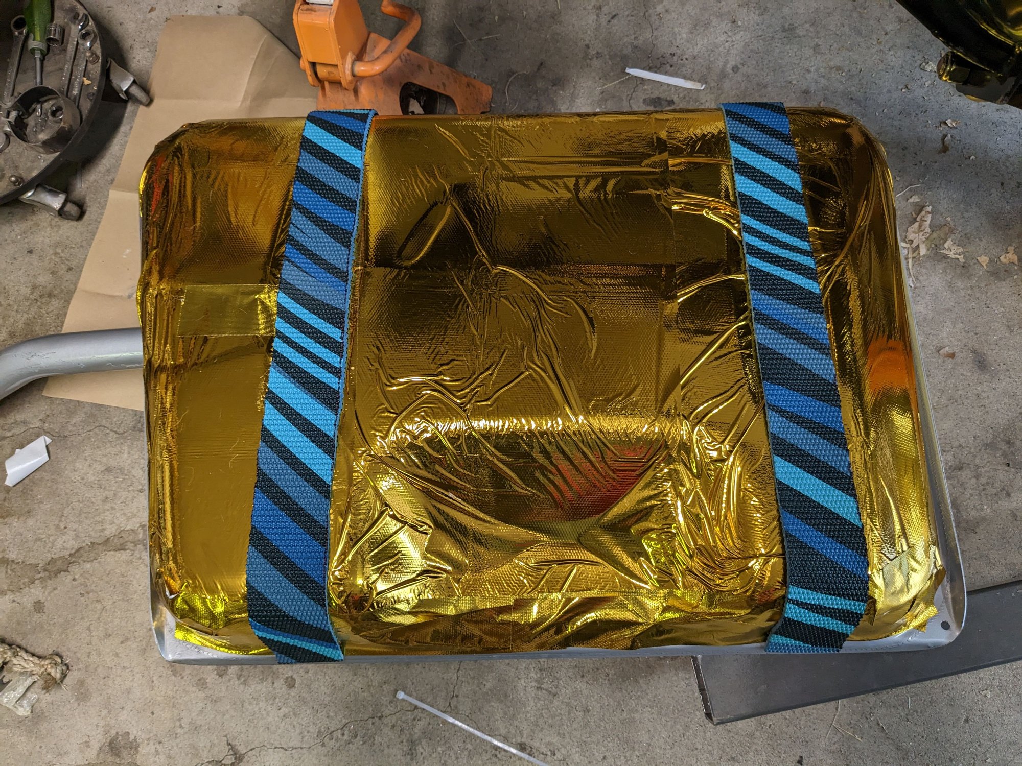

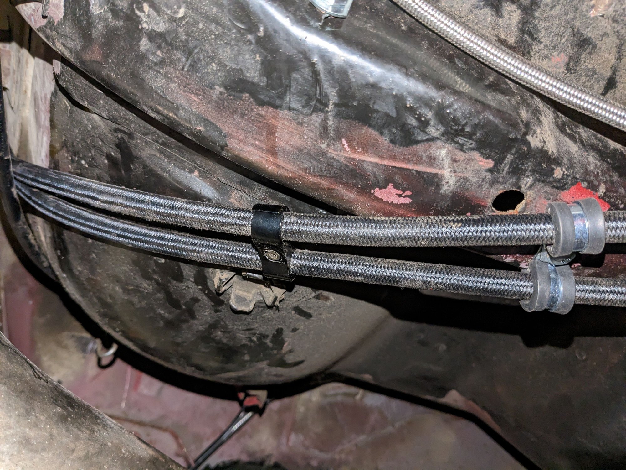

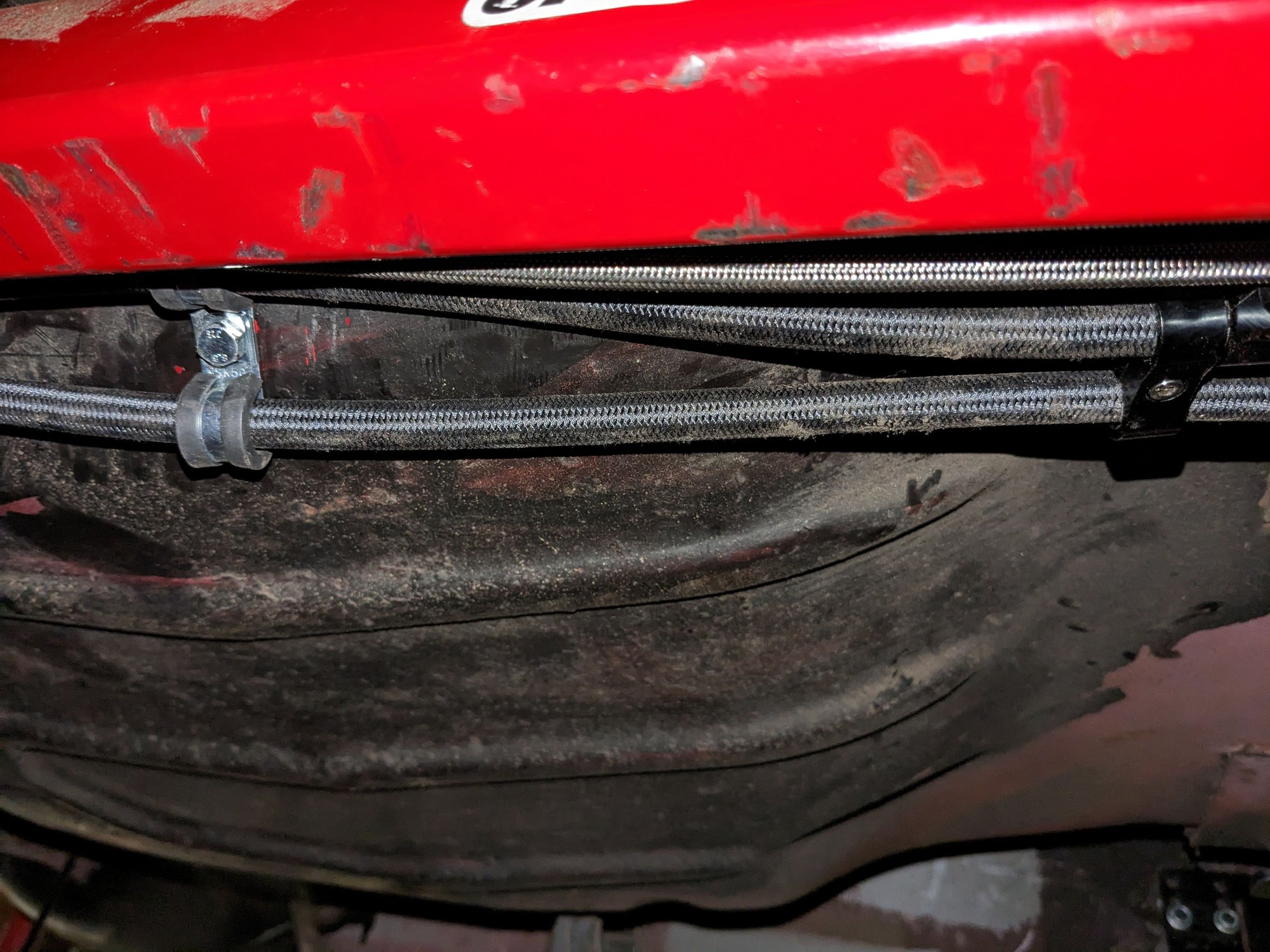

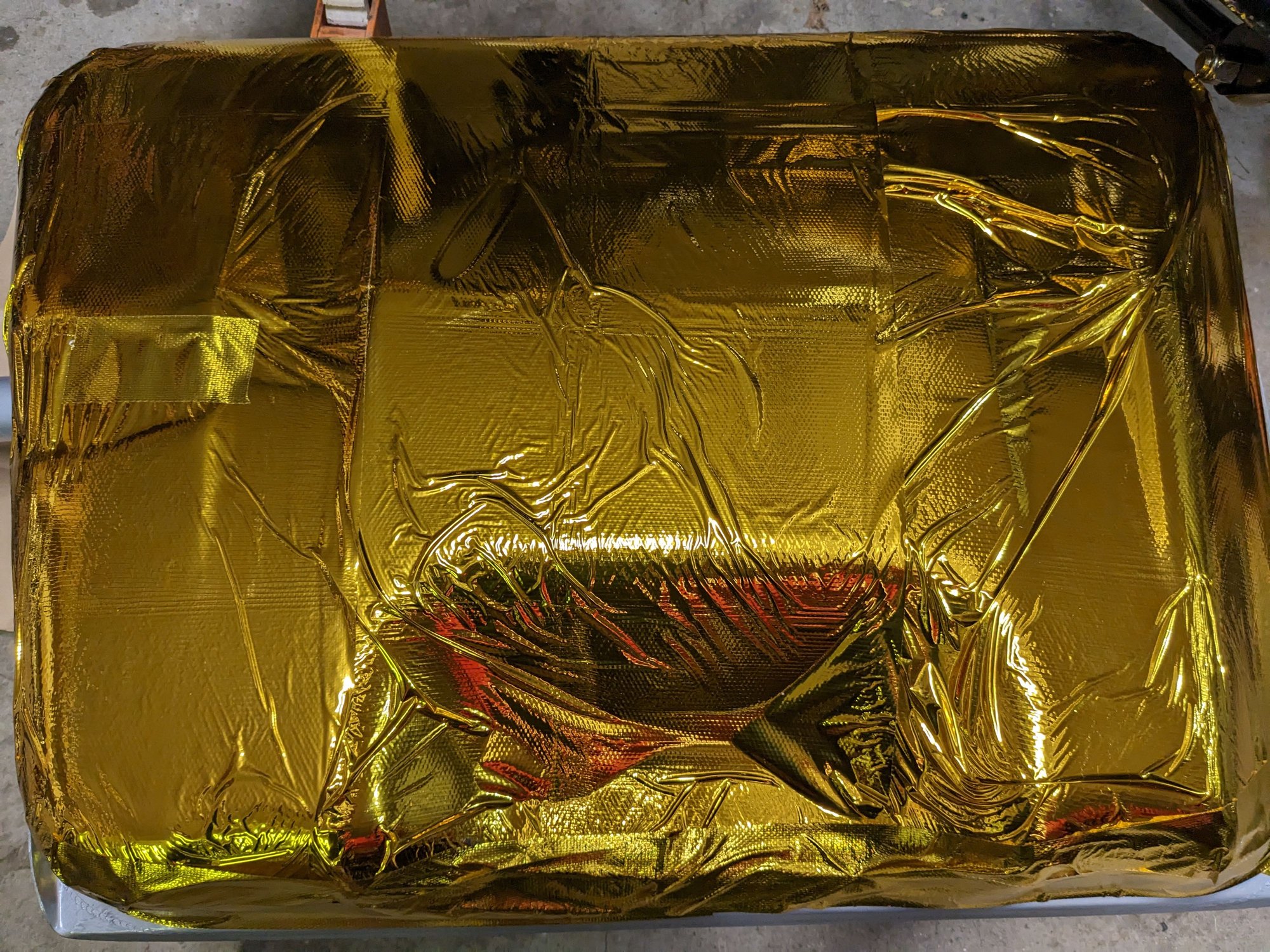

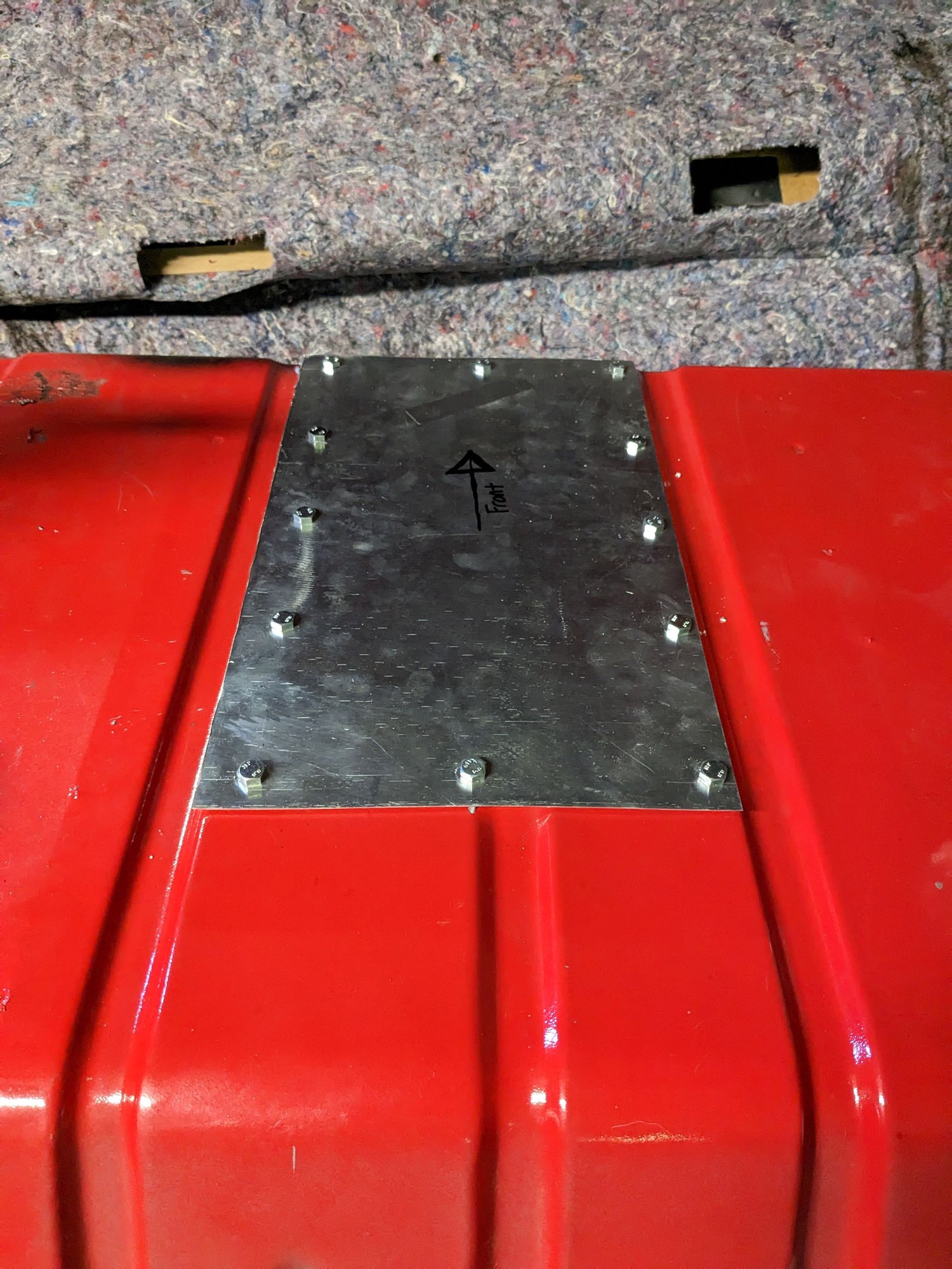

With the rear out, went ahead and upgraded the entire fuel system. Went with the aeromotive in-tank unit. Never really liked that holley black setup and how it ran close to the headers always sketched me out. All new AN PTFE lines passing through the frame on the passenger side is more better. As long as I don't pinch them with a jack they should last forever.
yoga mat tank isolators
I've added more nutserts since this picture
Pictures aren't "final" setup but they give a good idea of how everything was ran.
Yes I cut a trap door

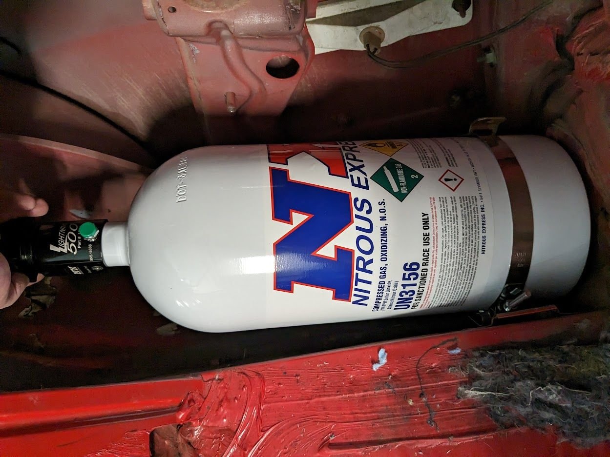

If you're wondering why I went through all this trouble, here ya go:
Fits like it's meant to go there
I've since driven the car, haven't hit the juice yet. Right now the car is in a fabricator's shop getting the exhaust replaced. Never really liked the dual system, it constantly dragged on the ground. I obviously need more pictures of the nitrous and fuel system setup
