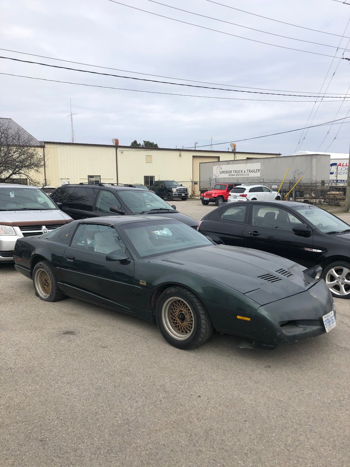

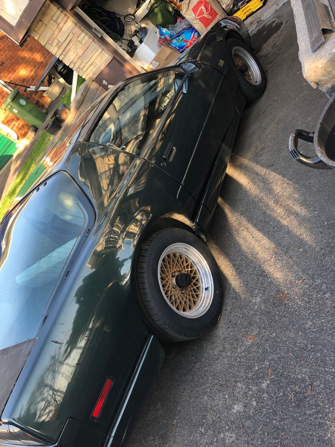

Alright fellas, I THINK I've found the one that will actually hang around for a while. When I was hunting for my old green GTA, a friend of mine got me in contact with someone who had an identical car: a 91' ttop green GTA, but automatic. The car had some damage, a miss-matched interior, the hatch was replaced and no spoiler, so I figured meh, it's probably a clap wagon. That was months ago. Then last week, it gets offered to me for $2000 (canadian), so with nothing better to do I figured I'd go take a look. Sure enough, here's a car with absolutely no rust, nice paint (minus the damaged spot), 123,000km (75K Miles), and thousands worth of mechanical work all done by a reputable shop. Turn the key and it blazes right up, runs flawlessly, and doesn't leak a drop of anything. Deal. The only catch is that unfortunately the codes reveal that she's just a nicely equipped Trans Am with GTA badges on it, though they're very well placed! Still a WS6 car, with all factory equipment still in place, so really I don't care. I'll leave the emblems on and admit my true identity to the few people who ask. The car's covered in dust and a million finger prints, so she doesn't look like much in the pics. Keep in mind though that finding such a clean car anywhere in Ontario is damn near impossible, never mind one for this price point with all the other goodies.

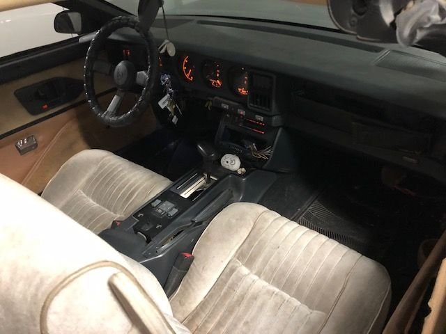

So as she sits right now, I need a driver side fender, nose, passenger side front GFX, hatch, spoiler, and one center cap. Interior wise, I'll leave the wheel because I hate the look of the air bag wheels and at least this horn works, and I'll convert everything back to proper beechwood as I come across the parts. It comes with the original seats but apparently they aren't in great shape, so we'll see. I'd like to get another set of tan ultima's, but I probably won't find a set for lord knows how long. For now though, my heart feels happy about having another green bastard in my world

Nice! That's my favorite bird color. Someone went to a lot of trouble replicating a GTA. Are you sure that's the original RPO sticker? Either way, great looking car! L98?

A late Trans Am with WS6 is usually pretty close to a GTA. Stickers instead of emblems, and the seats are about all that separates them.

Cool car and looks like a good deal for the $$$ and Love the green.

Thanks fellas, I appreciate the positive responses! At the end of the day, a 305 is a 305 when it has an automatic behind it, so I'm not too worried about it. I can take a car from work when I need to go fast, so I really only care that A: it's a TPI, and B: it's healthy and only has 123,000km on it. As for the GTA part, like I said, I really don't care as the car was still born a TPI T/A, not a base bird that got the clone treatment. To the few people who will ask about legitimacy, I'll give them story.
Funny enough, I'm actually pretty happy about the gearing in the car. I do a lot of highway driving and take a lot of fairly meaty road trips, so being able to cruise along at low revs makes those drives a bit more enjoyable to me. My last GTA with 3.42 gearing could get sideways without missing a beat, but she'd also confidently chug a tank of gas at a frustrating rate when cruising at 120 km/h.

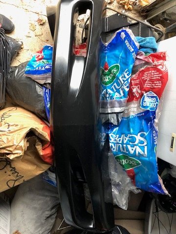

Parts wise, I've already found a fender, nose, GFX, and a few other small things. What's important right now is a hatch from a 91-92 with the correct T/A spoiler mounts, and a tan Firebird interior. Obviously I'd love a set of GTA's in there, but I'm perfectly fine with a nice set of base seats, as long as they're beechwood. If you guys come across a reasonably priced set that can be sent to Canada without costing a year's salary, let me know!

If you want to drive to Jersey I have an entire Beechwood interior I would sell you, inexpensively. Even have a couple of 91/91 hatches with the proper clips, there's one on my formula that I will be swapping out since I am going to put a non-defrost glass on the car, the deck is that color green too

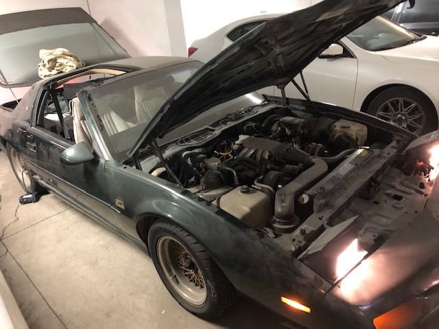

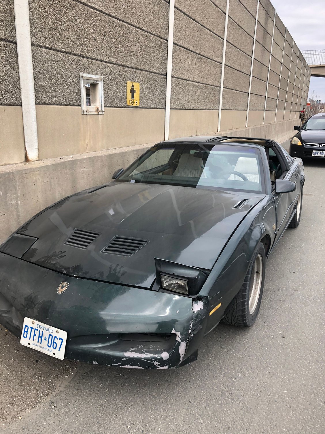

After all the hype, I present to you, well.. this thing. Know when that girl’s a 10 in a dim bar, but then the next morning when the light hits her, you just don’t really want anyone to know what happened? This car’s giving me those vibes. In her defence, she’s FILTHY, and everything important is awesome. Paint, body, mechanical, fantastic, minus the obvious damage. She just looks like she’s going to ask you for 3 smokes in return for some ball cradling behind a Harveys dumpster.
Maiden voyage started well. Put a battery in, air in the tires, and pedal to the metal immediately down the highway. Power was there, trans behaved as expected, alignment was horrible, suspension was rough and noisy. Then that rear tire absolutely exploded while doing 120. Towed it back to my shop, looked at it in disgust, then got some Buddy Burgers. At least now I have something to occupy my endless Covid free time.

Here are a few pics that I just snapped of the ol' girl. Still looks like hell but how nice are those wheel wells? The glass is from the hatch exploding, and there's garbage and stuff everywhere in the back, but the metal is what I like to see. Both sides are rust free, and the bottom floor part of the trunk valley is immaculate as well. I still haven't gotten the car up in the air and it's too low to crawl underneath, but I took a video on my phone and from what I can see it's spotless underneath. No real updates on anything other than the driver door now being able to open, thanks to a crow bar of course. My tires are actually 14 years old so I'm sourcing a decent set to get the job done for now, waiting for a chance to pick up my replacement body panels, and working on getting everything I need to get a tan interior back in. My next small projects will be pulling the passenger door panel as my mirror is loose, tightening up the hanging head liner (which is new and is hanging from the board itself, not the fabric), and gutting the whole interior so I can assess the metal underneath everything, and dispose of the junk interior stuff that I don't want in there. I'll keep the updates flowing as I chip away at what seems to be an infinite to-do list

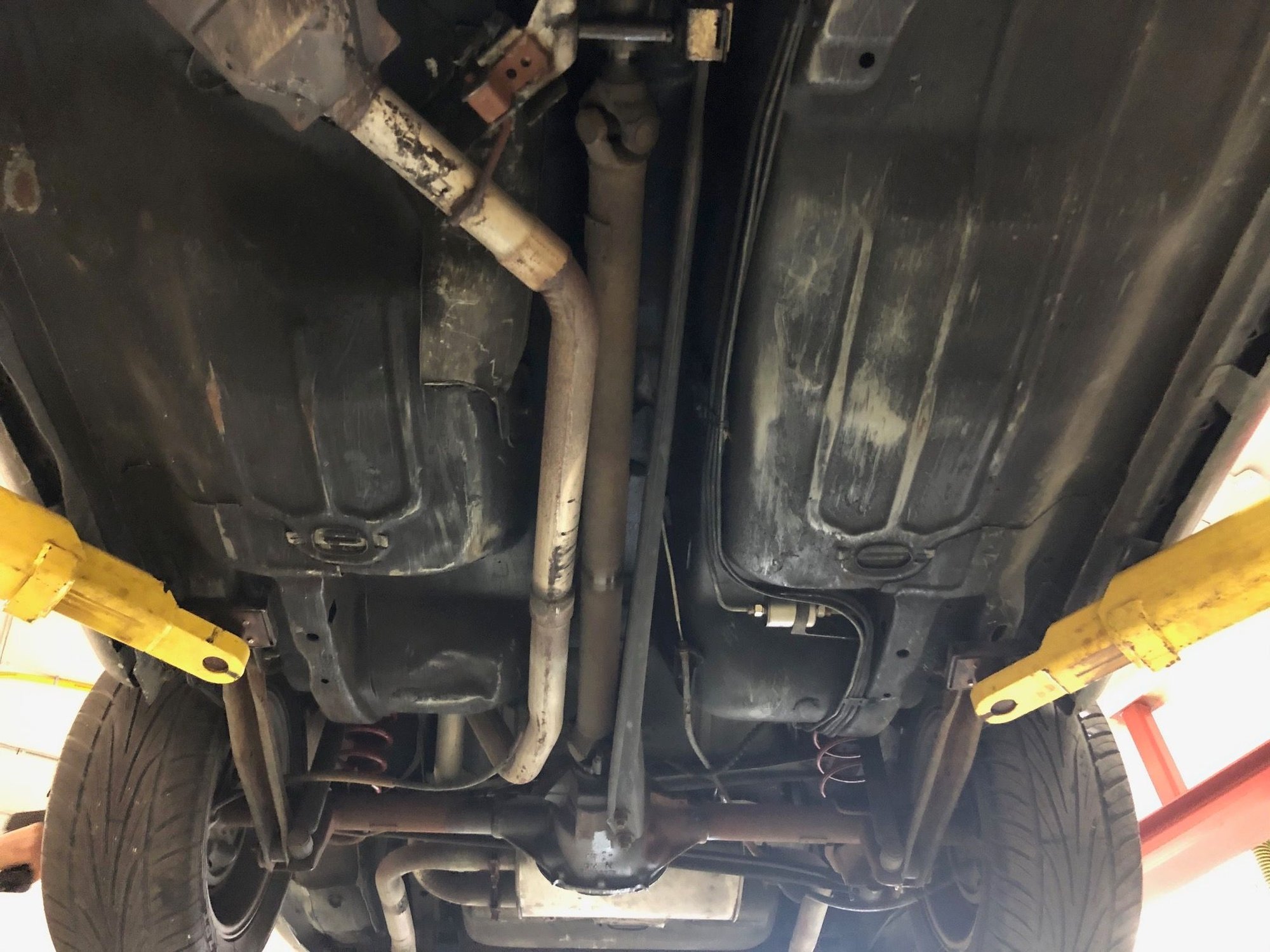

The real home run though, is that this car looks even better underneath than I hoped it would. It's lowered and has definitely kissed a few speed bumps, but there is not a spec of rust to be found. Inner wheel wells, firewall, rear frame sections, floors, everything is 100% spotless. I pulled the carpet up and the floors don't even have surface rust starting. Still green as green can be. She may be a bit ugly in her current state, but I couldn't be happier with the starting point that I have.
Also, maybe it's just been a while, but I certainly don't remember 2.73's being this snappy. The car gets sideways without even thinking about it. Even without breaking traction, she gets up and moves like my 3.42 GTA did. Rear end may have been swapped, or maybe I'm just being too optimistic, but I'm happy regardless.

Another awesome little scoop is this brand new, never installed nose that I picked up for $100 yesterday. I'm going to be testing the fitment tomorrow, which I'm nervous about, but it certainly can't be any worse than the crushed one on there now.

If you still have it in the air you can mark the rear tire and driveshaft. Rotate the tire 1 revolution (360) and count the driveshaft revolutions and that is your rear gear ratio.

That is amazingly nice condition underneath for a northern car. Really looks like you have a nice foundation there.

Unfortunately it's already off but that would have been a good call. I'll be putting it back up soon for brakes a diff service so I'll do that then and see. Thanks for the method!

Thank you! After the surprise that came with my last black 86', I was more than pleased with how this car looks. Eventually I'll get under it and sand / paint the areas that are scraped up. I imagine it's pretty straight forward to pop out the dents in the floors as well. Definitely thrilled with the total absence of rust though.

It may have been swapped. First mod I did to my '88 GT Mustang,(Back in '88) was to swap out the highway gears to 3:55's with an Eaton trac-loc posi. Iirc, you can jack up the rear to get the tires off the ground, put the trans in neutral, mark the tire at the "top", and make a mark on the driveshaft. Turn the tire forward two turns, and see if the driveshaft went around 73 times. If it's a lot less than 73, then take the tire one more time around and see if it's 42.
Been a long time since I have used this trick, but it should work.

Meh... Screw all that counting noise. Get a couple qts of gear oil, dump the diff, and turn the ring gear while watching for the markings. Right on the edge it'll either be stamped with the exact ratio, or it'll have the tooth counts stamped on it. XX:XX divide the numbers and you'll get the exact ratio. "But Drew, I don't want to mess with the gear oil it's smelly and dirty", well so is getting under the car and turning a tire, and the gear oil needs to be changed if you've haven't done it already, anyway.

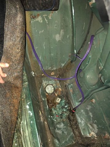

Cosmetic wise, I gutted the interior down to a dash and a driver seat and took if for a thorough cleaning because of all the broken glass and what not hidden under the carpet. Then I discovered that I had almost an entire set of spare tan plastics from my old GTA, so I swapped all of the black stuff out and ended up with a pretty good looking interior. Scooter (member) has a full beechwood Formula interior for me that I'll be getting from him as soon as the borders open, and though it needs a few things and a good bath, it has a driver side cup holder!! Super excited.
