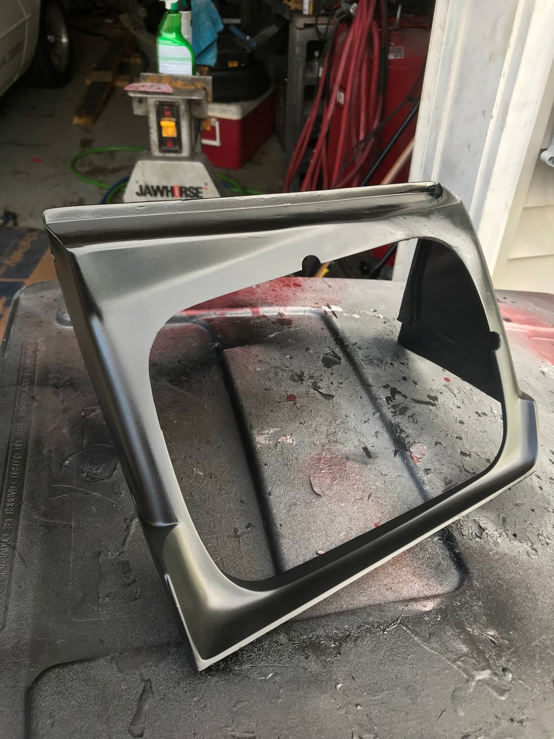

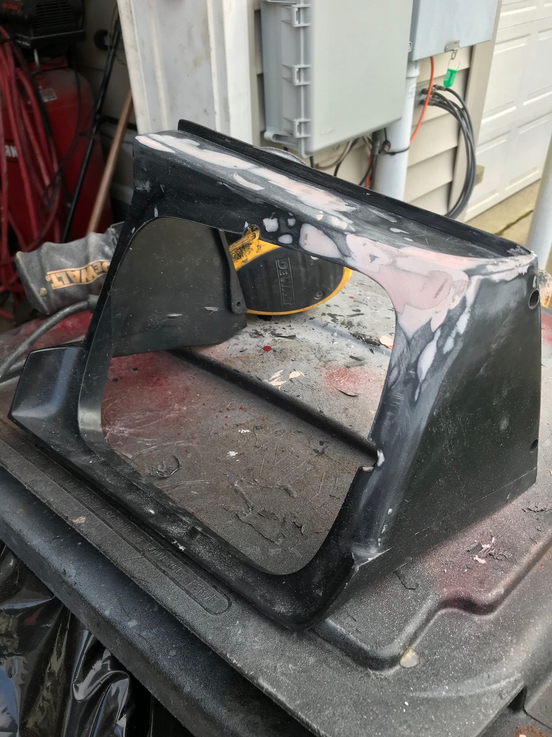

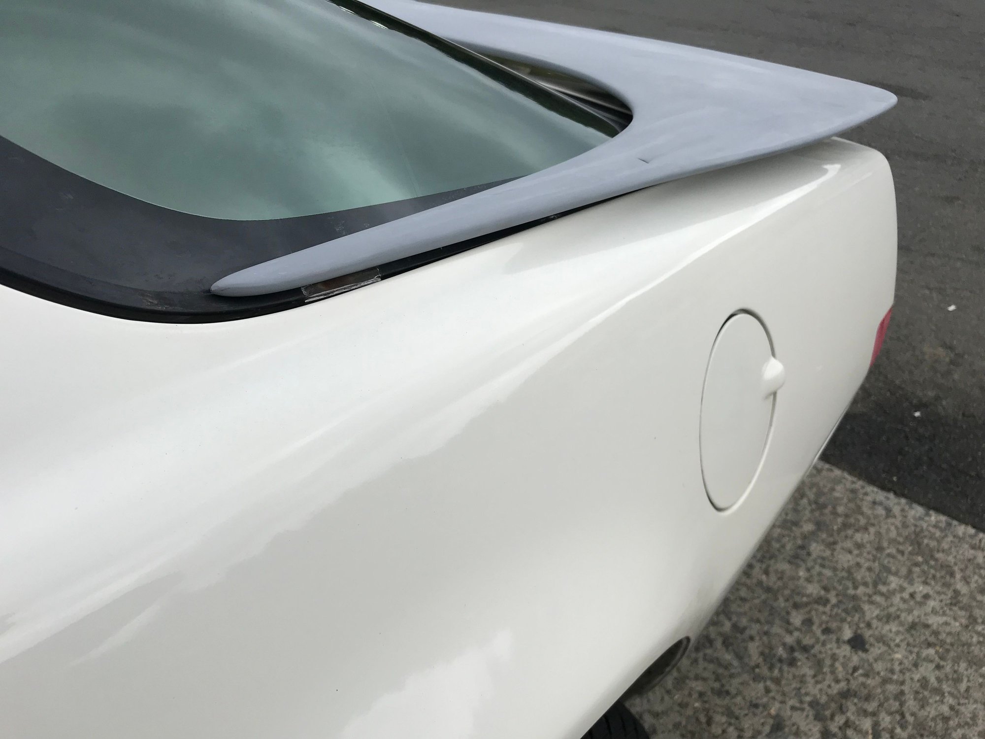

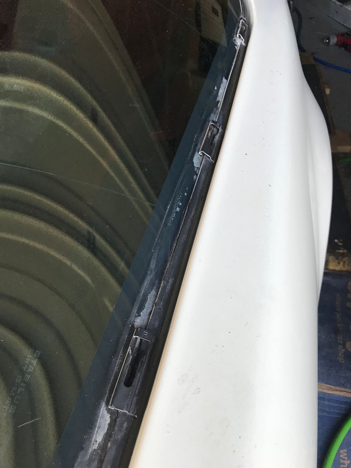

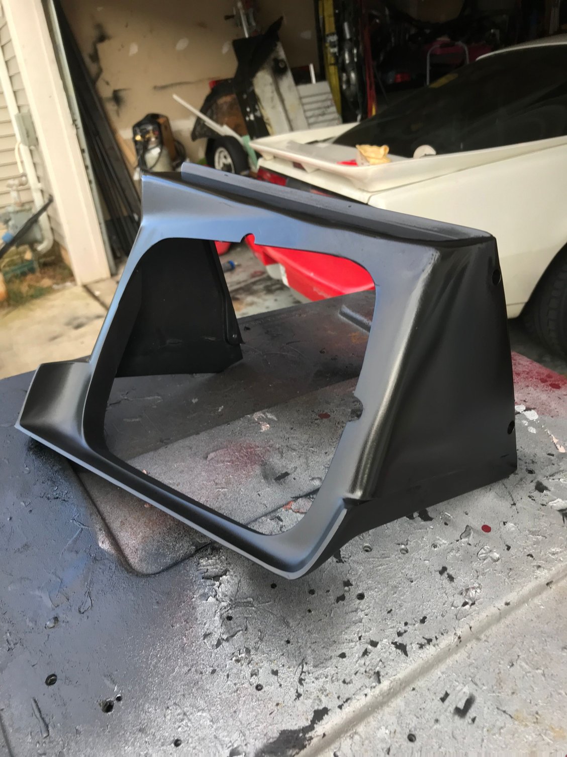

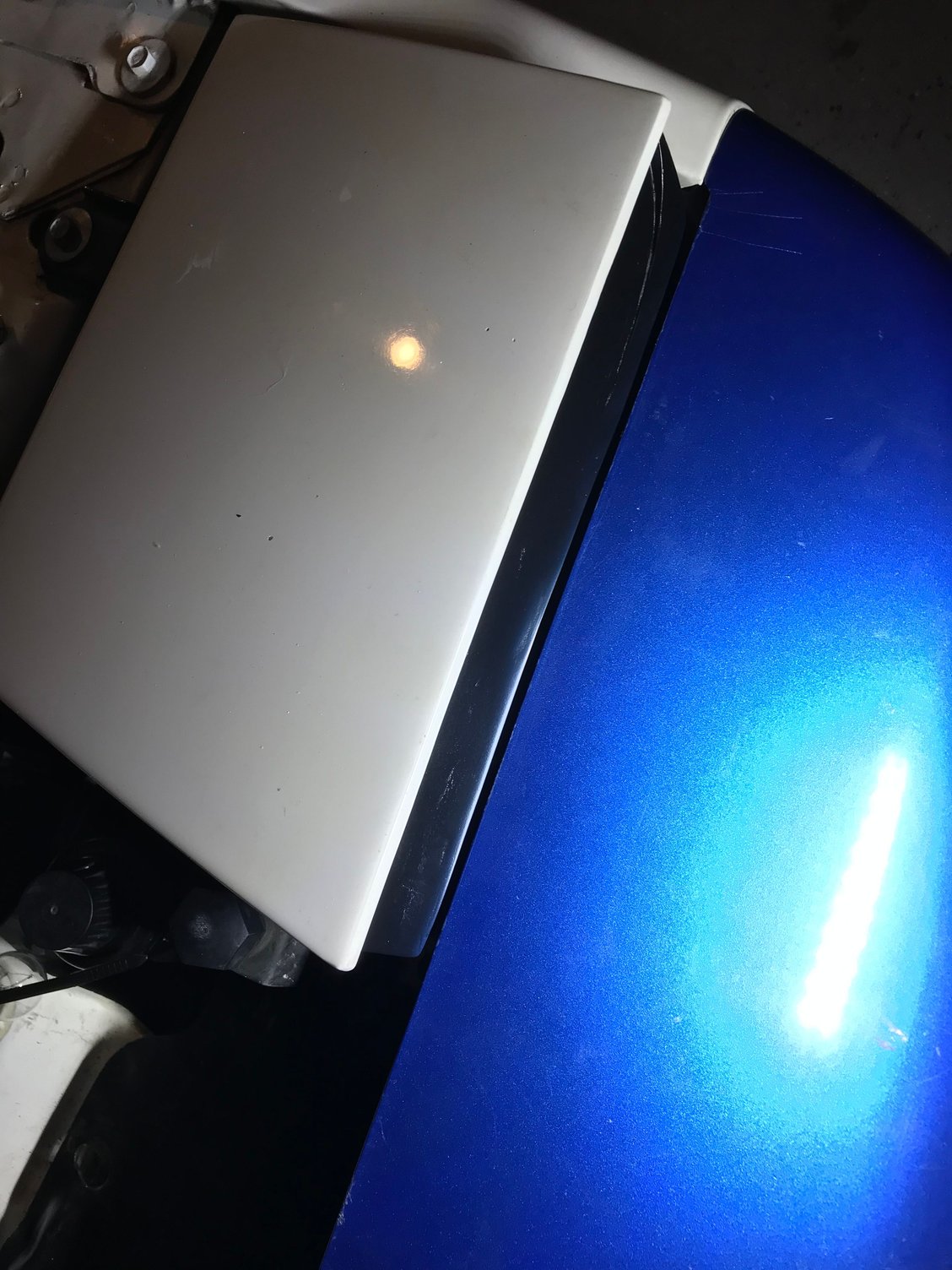

Stop the press! Put the bondo away!
On the passenger side bezel I tried a different method and was able to get good clearance with only sanding and grinding the shroud (you still will need to cut and level the lip).
This has not been completely finished or painted.

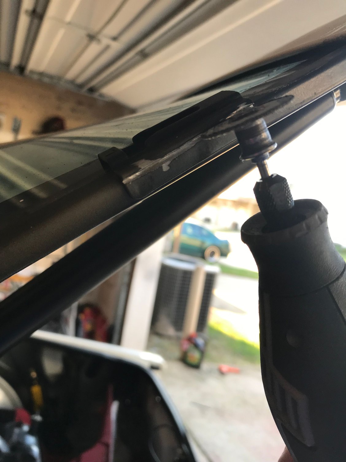

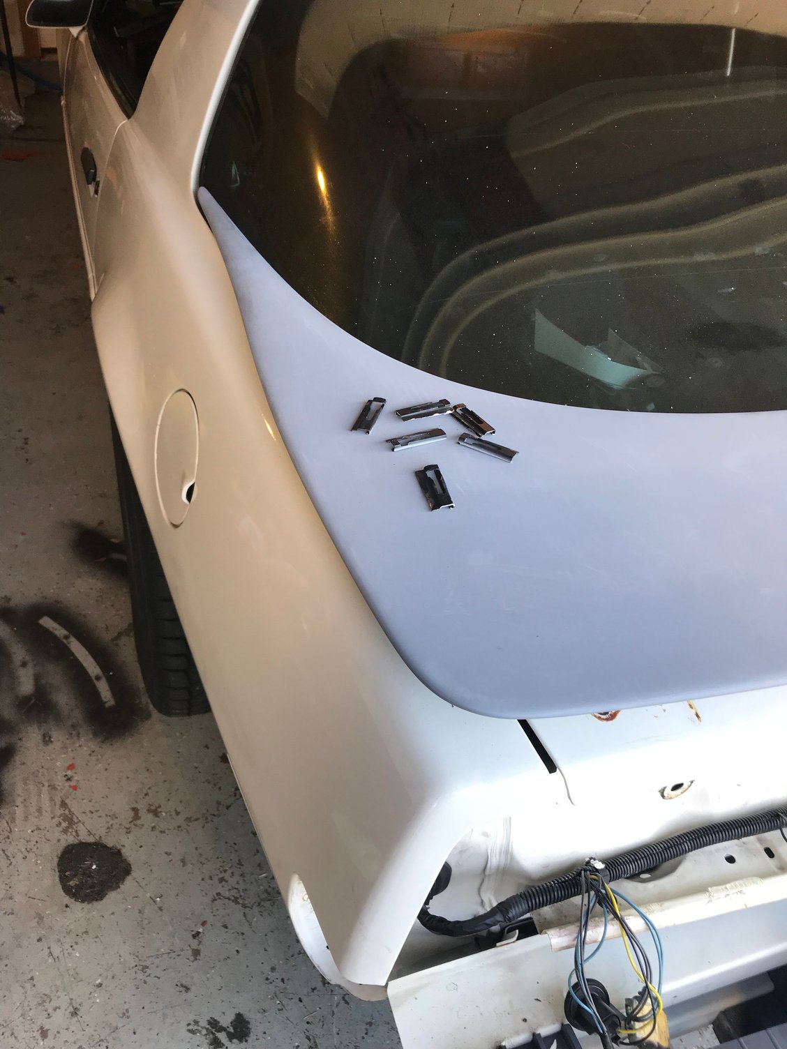

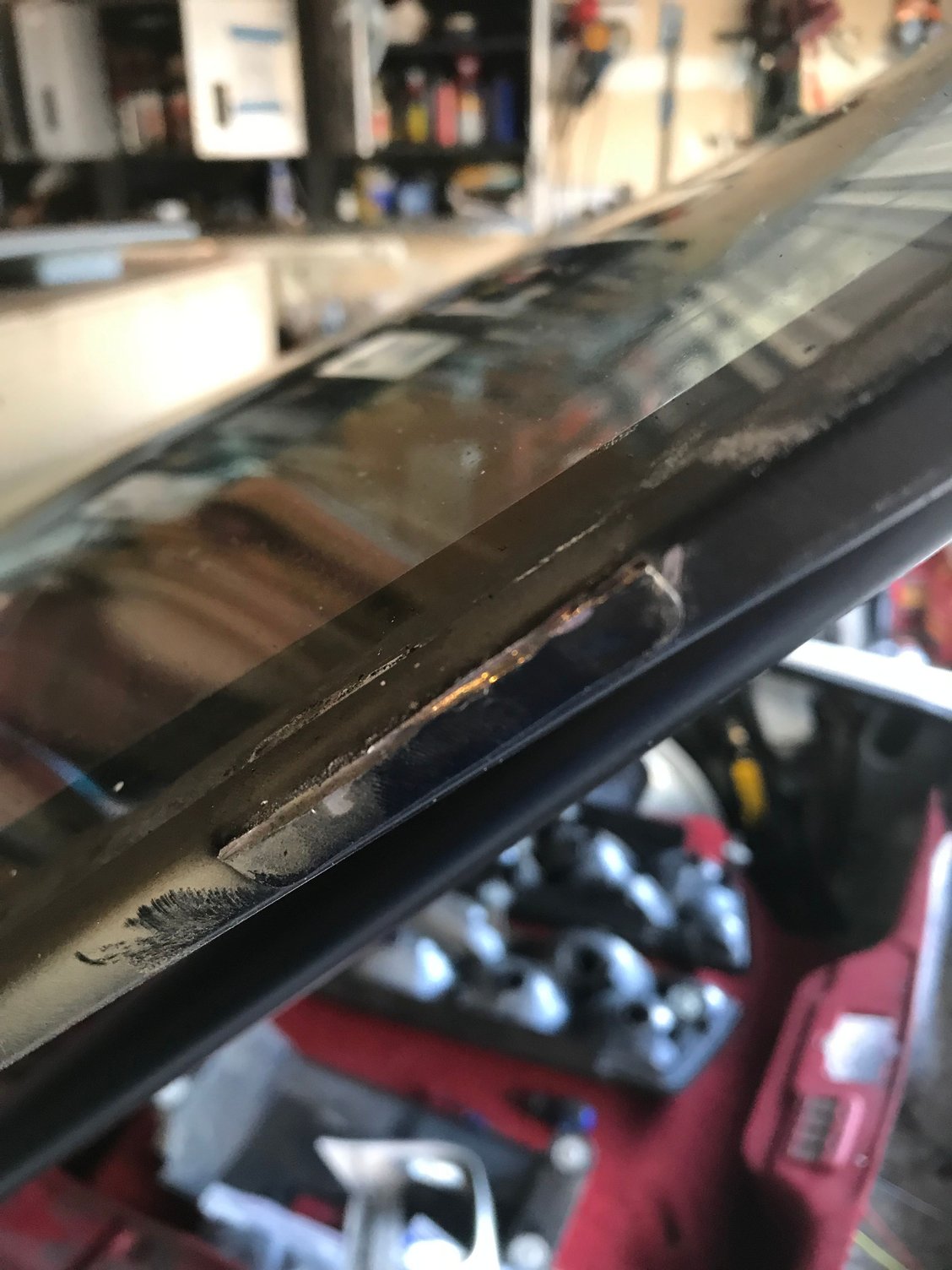

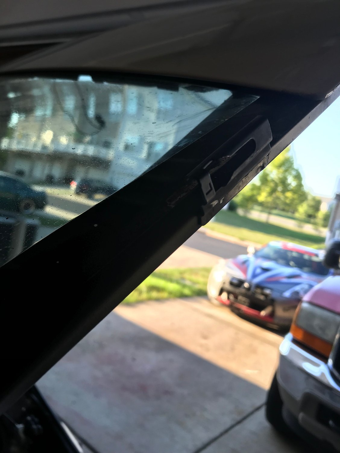

OK, spoiler is here. Looks like this is going to be an involved process. Thought for a second about fabricating a way to include the third brake light but quickly shelved that idea.
Hawks is closed for the night so I will have to call tomorrow. Have one question about the factory mounting tabs and directions are not 100% clear. It appears that I need to remove the factory tabs? Any thoughts?

Either remove the tabs or clearance the fiberglass.
I'd consider looking for a base bird window trim set to install. (I like to keep original parts.. just in case.

Cutting thin metal tabs is why God invented the Dremel tool.
Now time to talk to my paint guy about his ability to cover questionable hole repairs.

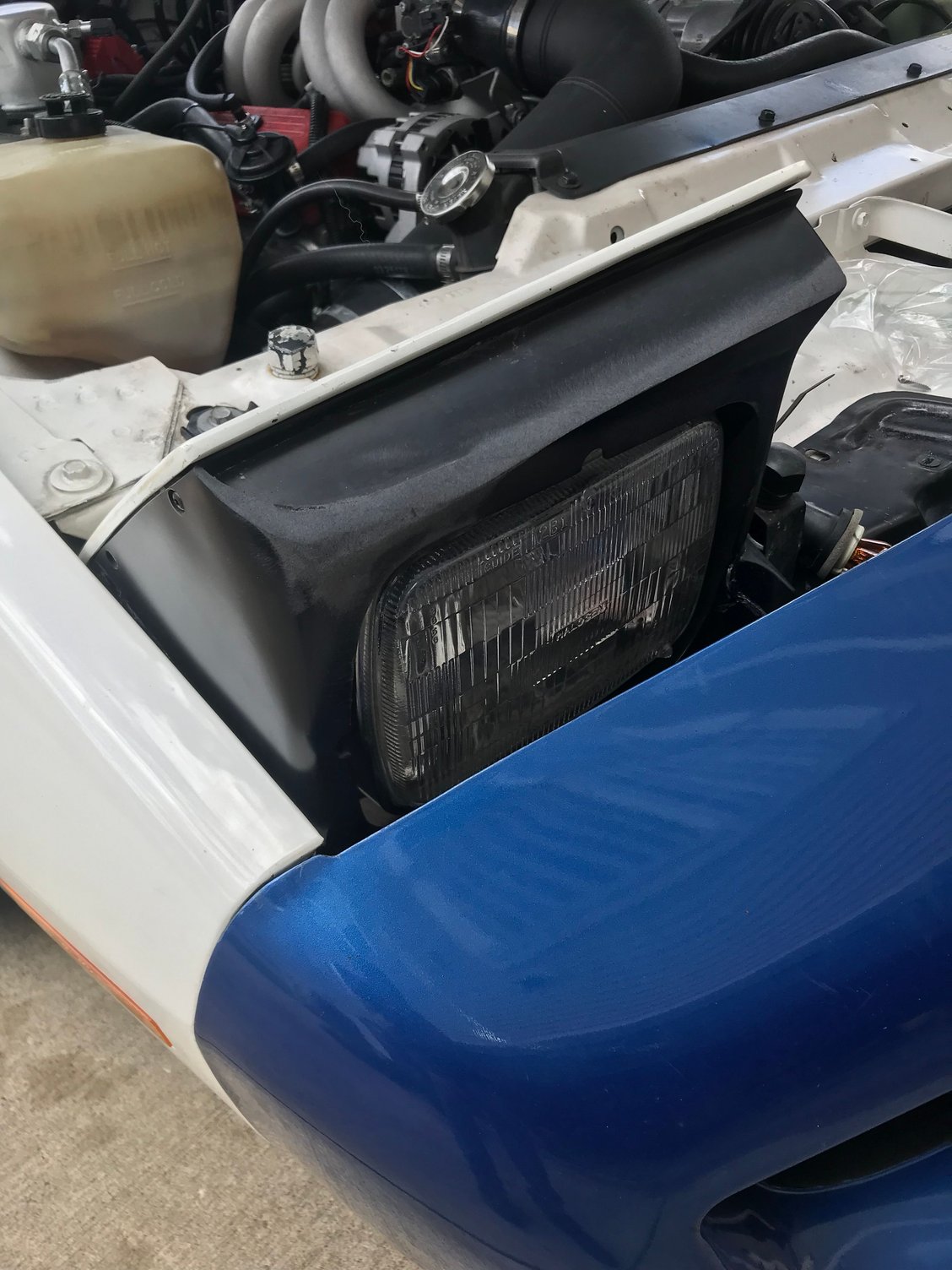

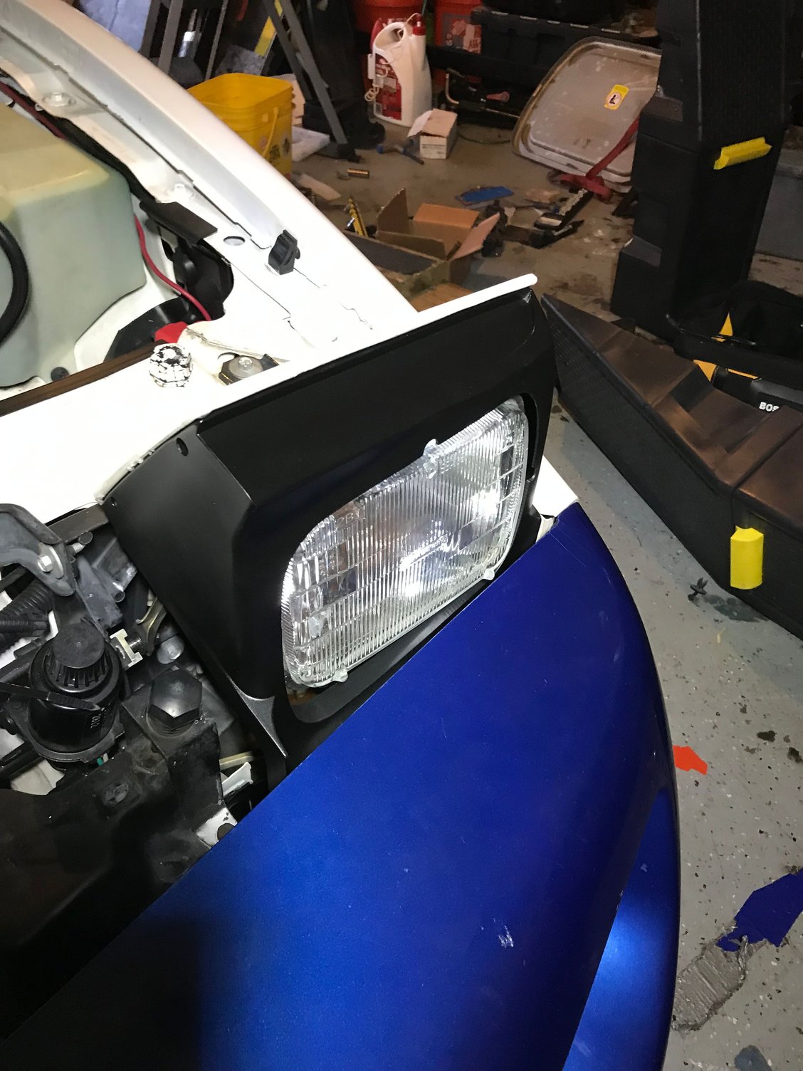

I think I’m just gonna say the hell with it and put this one on .

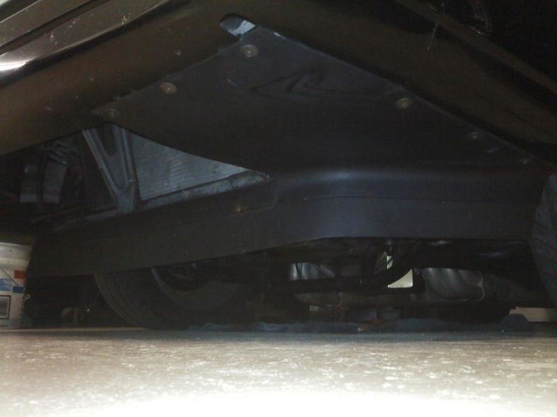

Good talking to you today and I found this pic for you on air dam

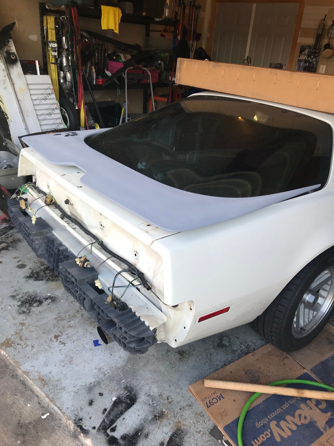

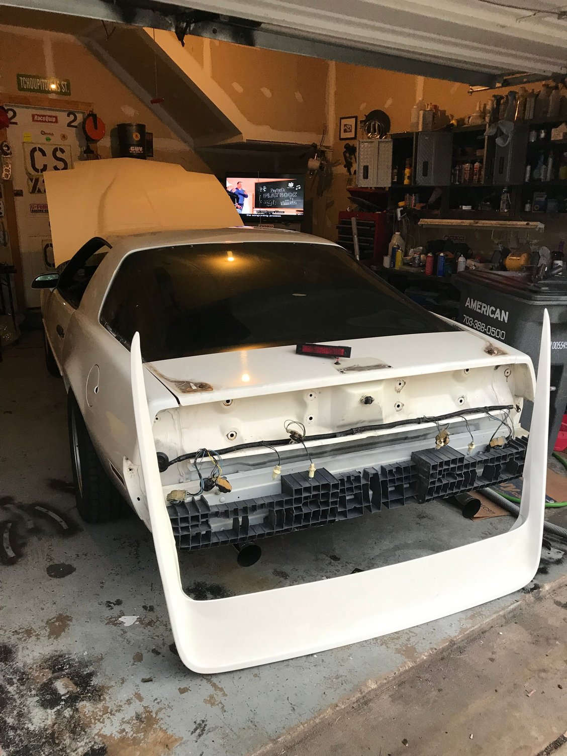

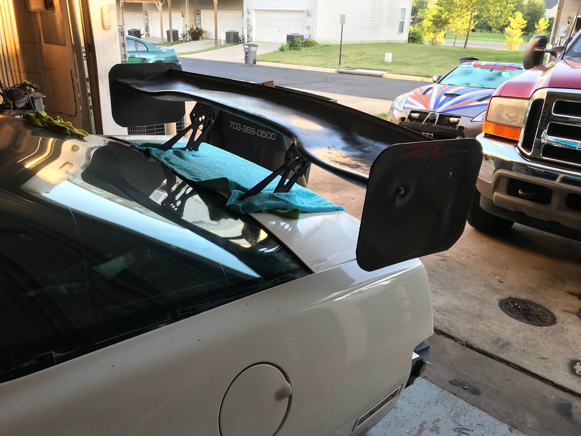

Hey Hawks, you may want to clarify your instructions a little bit about the factory spot welded tabs.
When I got the wing It seemed like it was going to be impossible to make it fit. And your instructions are a little bit “vague”. I think the confusion comes when you say remove factory clips if that means the plastic parts that inserted into the spoiler or the actual metal tabs.
Well I went ahead and took a Dremel tool and removed the factory metal tabs. And now a apparently poor fitting wing fits almost perfect!.

Originally Posted by zman1969
Ha do that and you'll be banished from here!
Thanks for the pic. Good talking to you as well. It was just the kick I needed to go back and figure outs that spoiler.

You may try moving it back to see if you can get the tips more even , course its like having 2 restored wheels on one side and not the other - who'll notice?
Old Aug 30, 2019 | 09:56 AM
  #166
ResIpsa's Avatar
Joined: Apr 2019
Posts: 83
Likes: 95
From: Northern Virginia
Car: 1987 Formula 350
Engine: TPI 383 Stroker
Re: Too long...

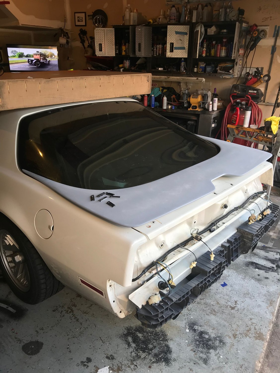

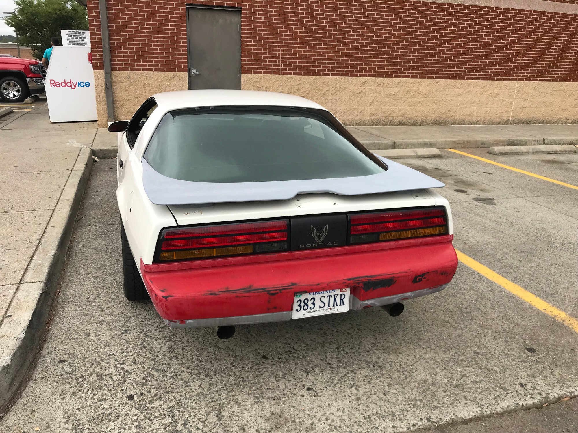

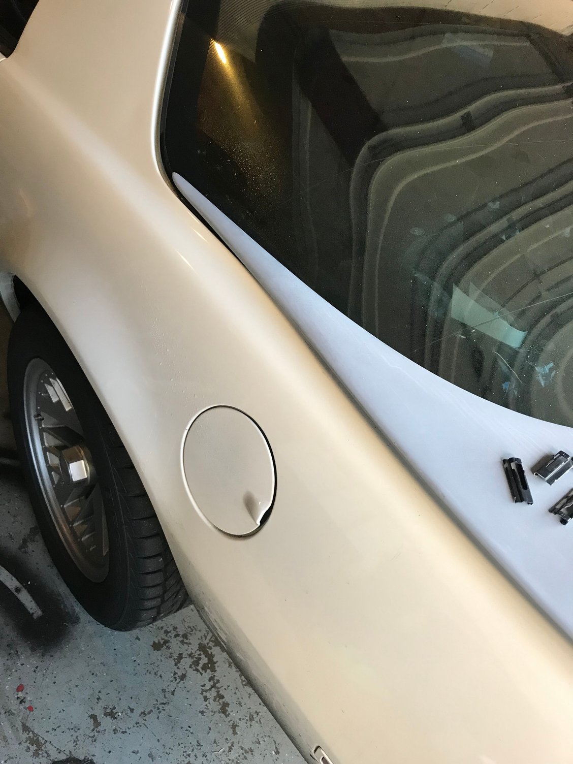

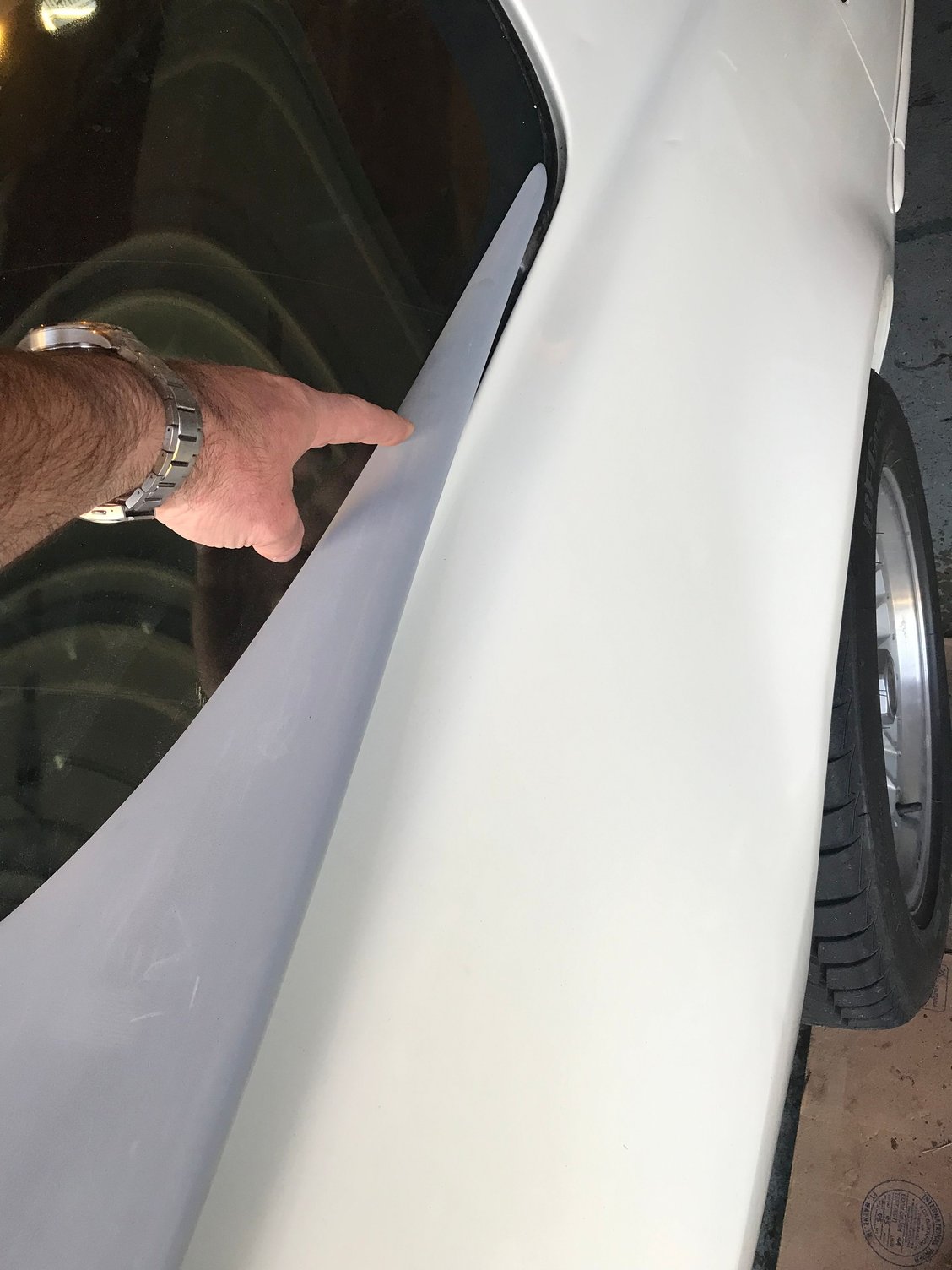

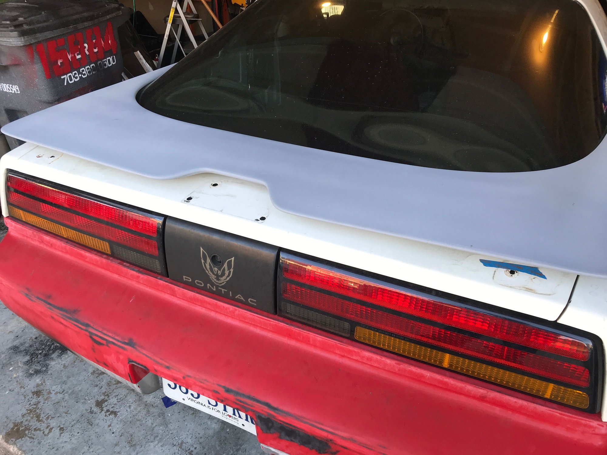

The passenger side tip is skewed up a little bit (or maybe the drivers side is skewed down...I still need to do a little more fitting).
Although, as it sitting now the passenger side tip can be gently flexed down to meet the window and it should be flush when I put the clip in.
Although, you have no idea how relieved I was test fitting it after cutting those clips off. Trying to fit it before I thought there was no way in hell that spoiler would ever look right.

I’m pretty happy where I got it. I’m currently in the process of posting a detailed installation guide in the body section.

Can one of your more knowledgeable guys clarify what year Pontiac made this version. I’m assuming a special edition or maybe an Indy pace car?

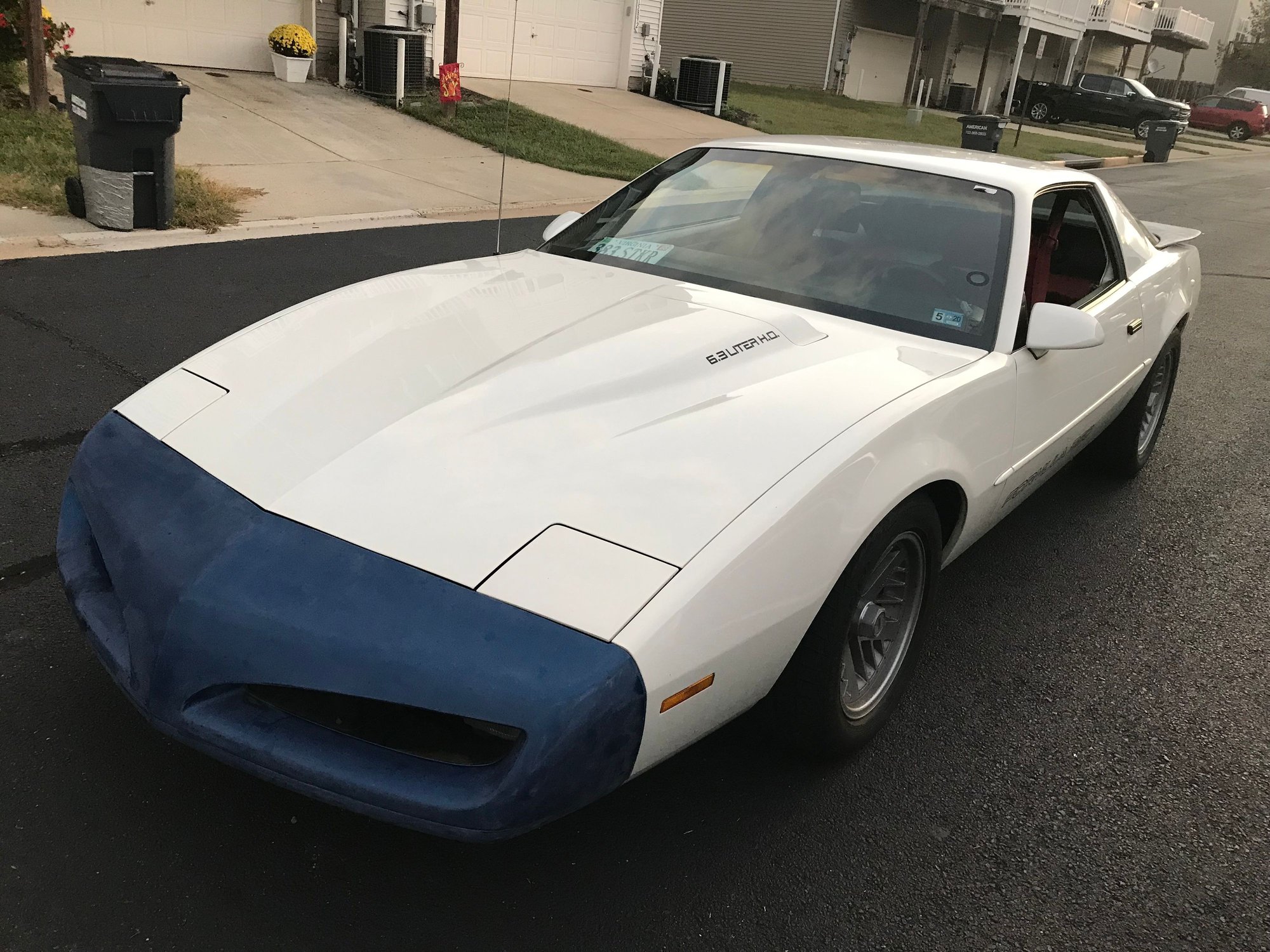

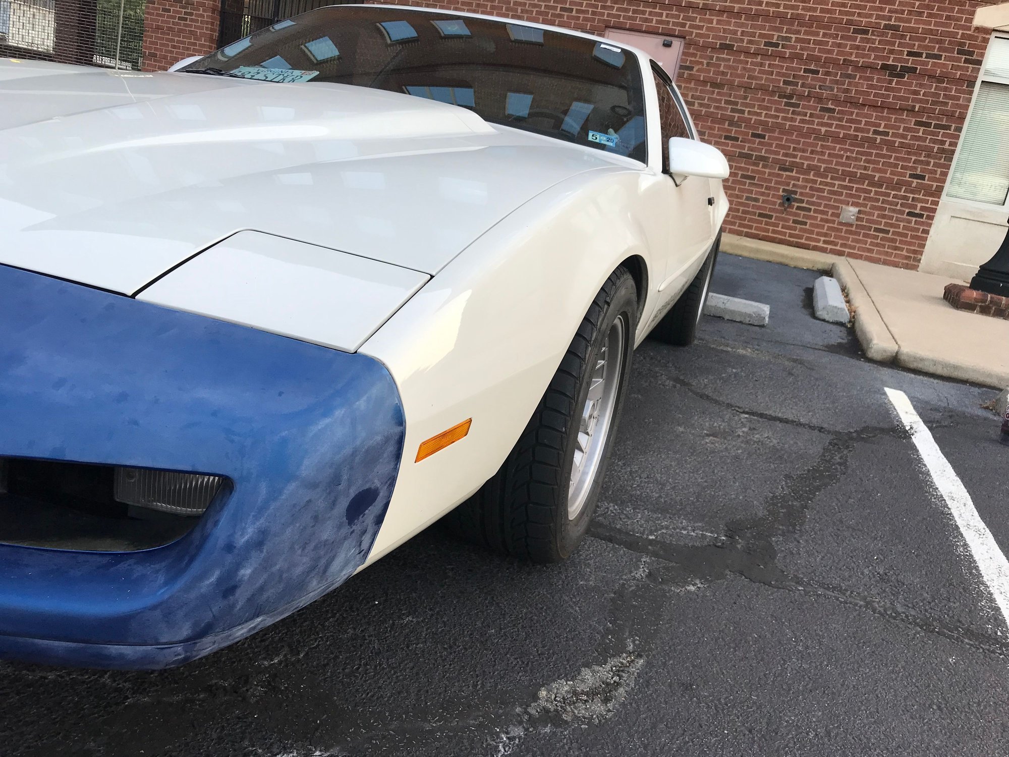

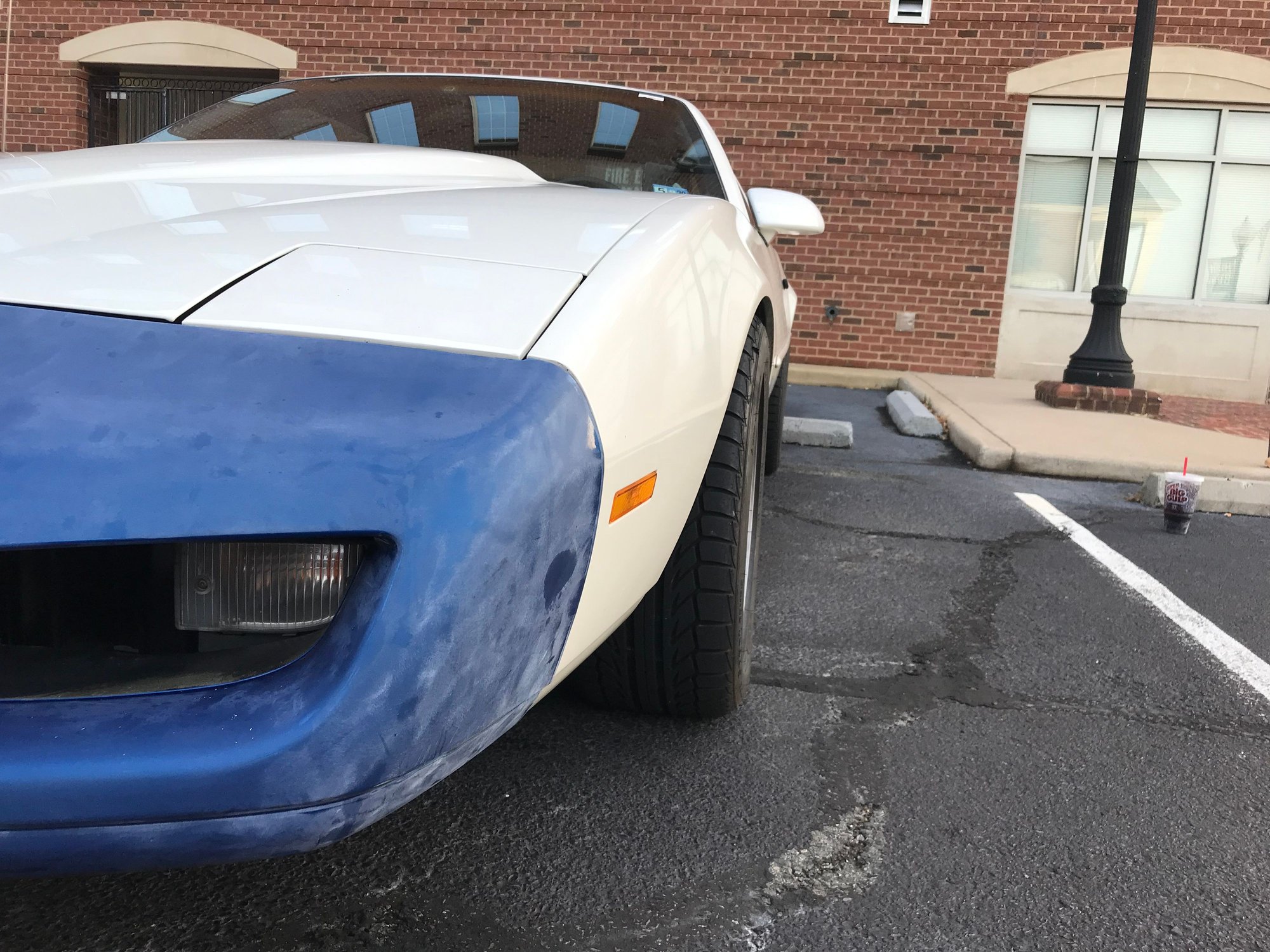

I have been experimenting with trying to get the front wheel spacing just right. I think this is a tad too much and I am getting some rubbing. Although I could dial in a little camber.
Old Sep 11, 2019 | 07:30 AM
  #173
zman1969's Avatar
Joined: Jul 2003
Posts: 582
Likes: 205
From: DFW
Car: 90 Formula 350
Axle/Gears: Dana 44 3.54
Re: Too long...
Rubbing? what are you running 255's? I have run 255s on my 87 and no issues or are you pushing them out ?

They are stock 245’s but they are spaced.

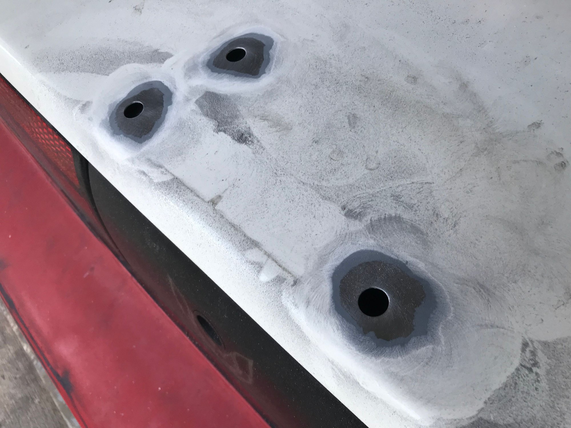

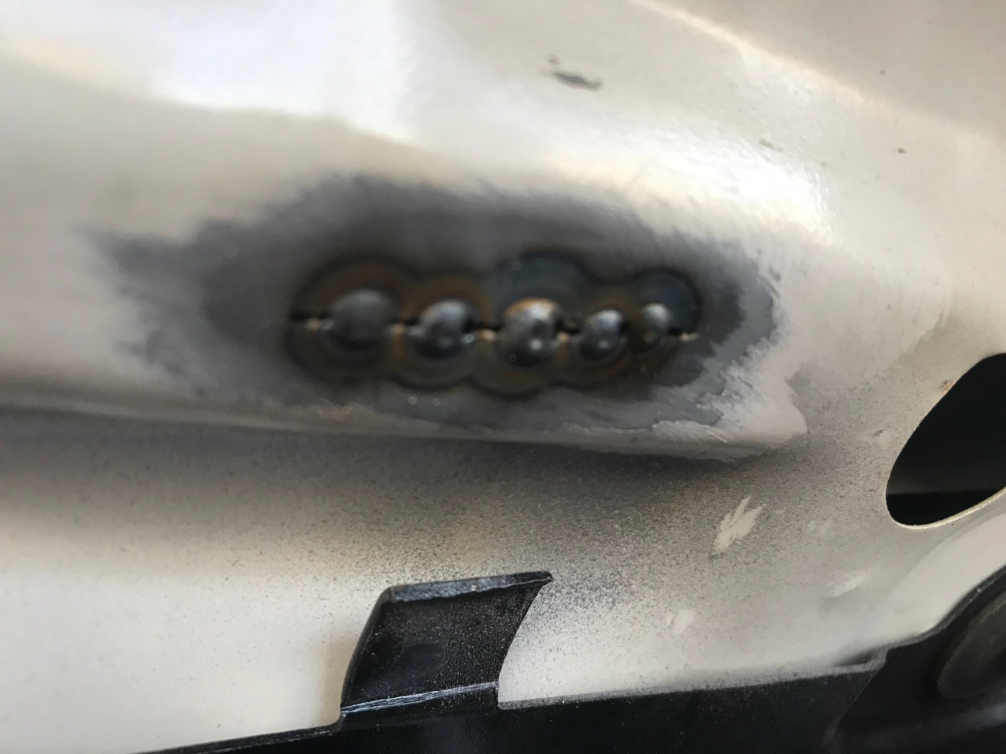

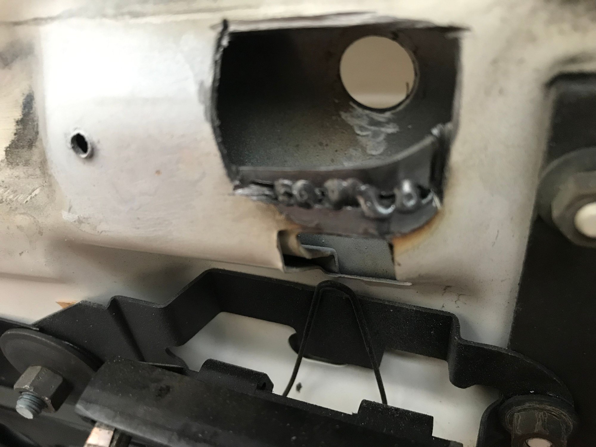

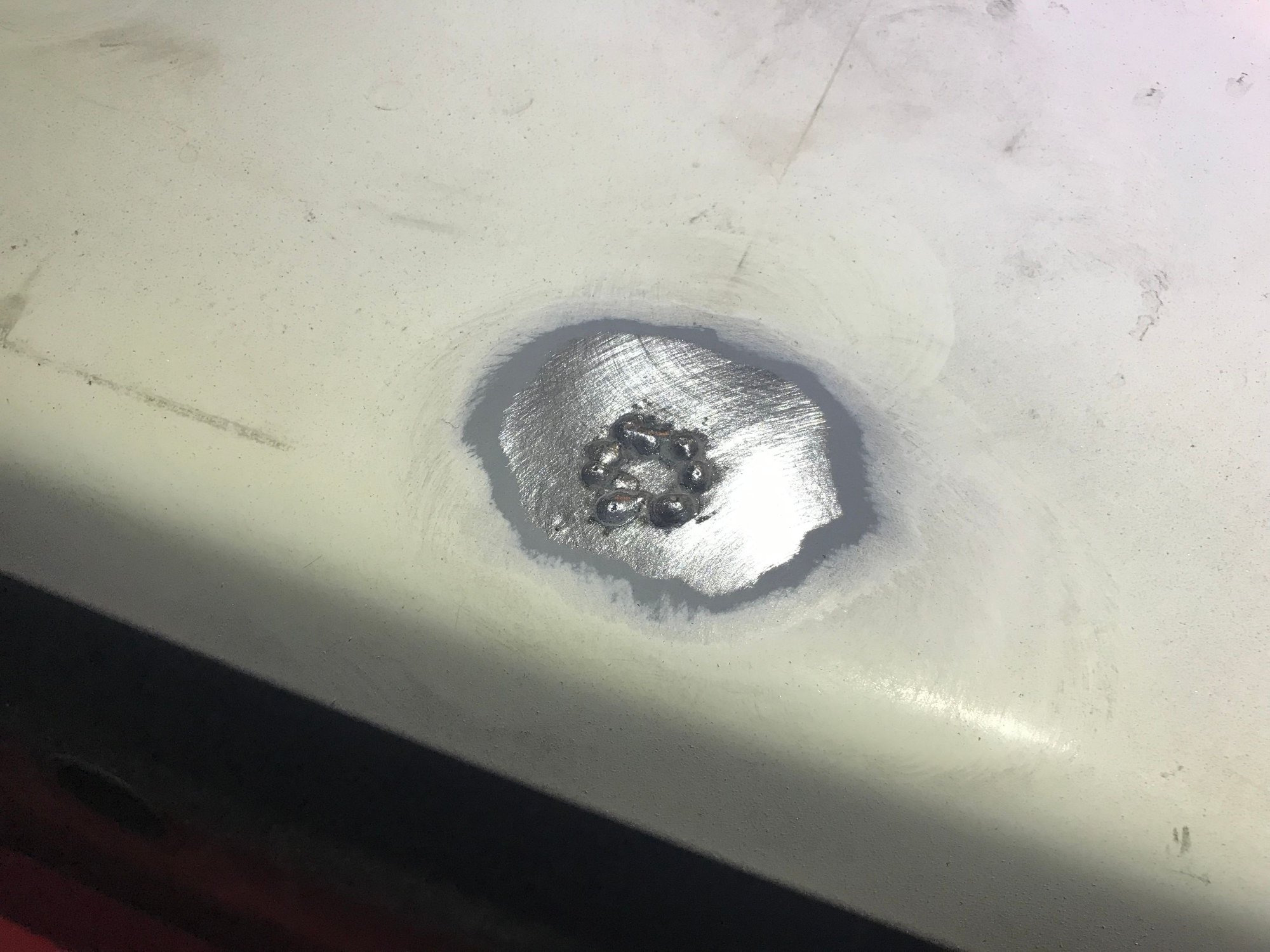

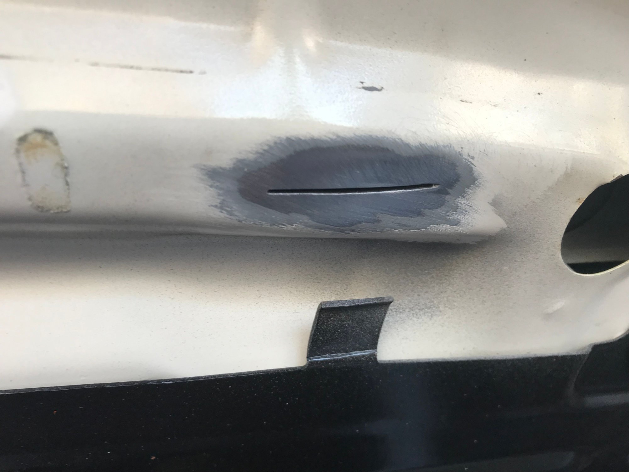

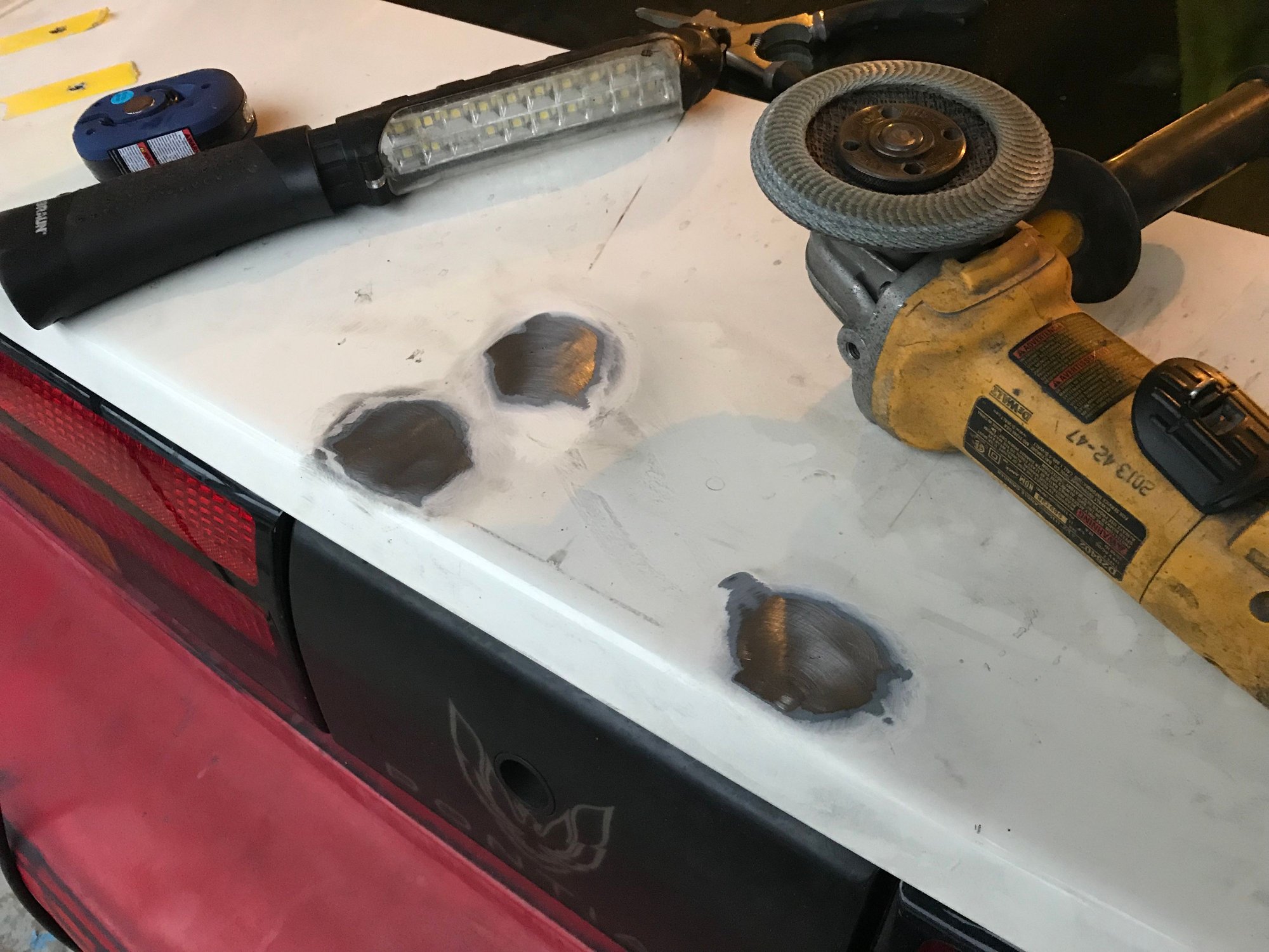

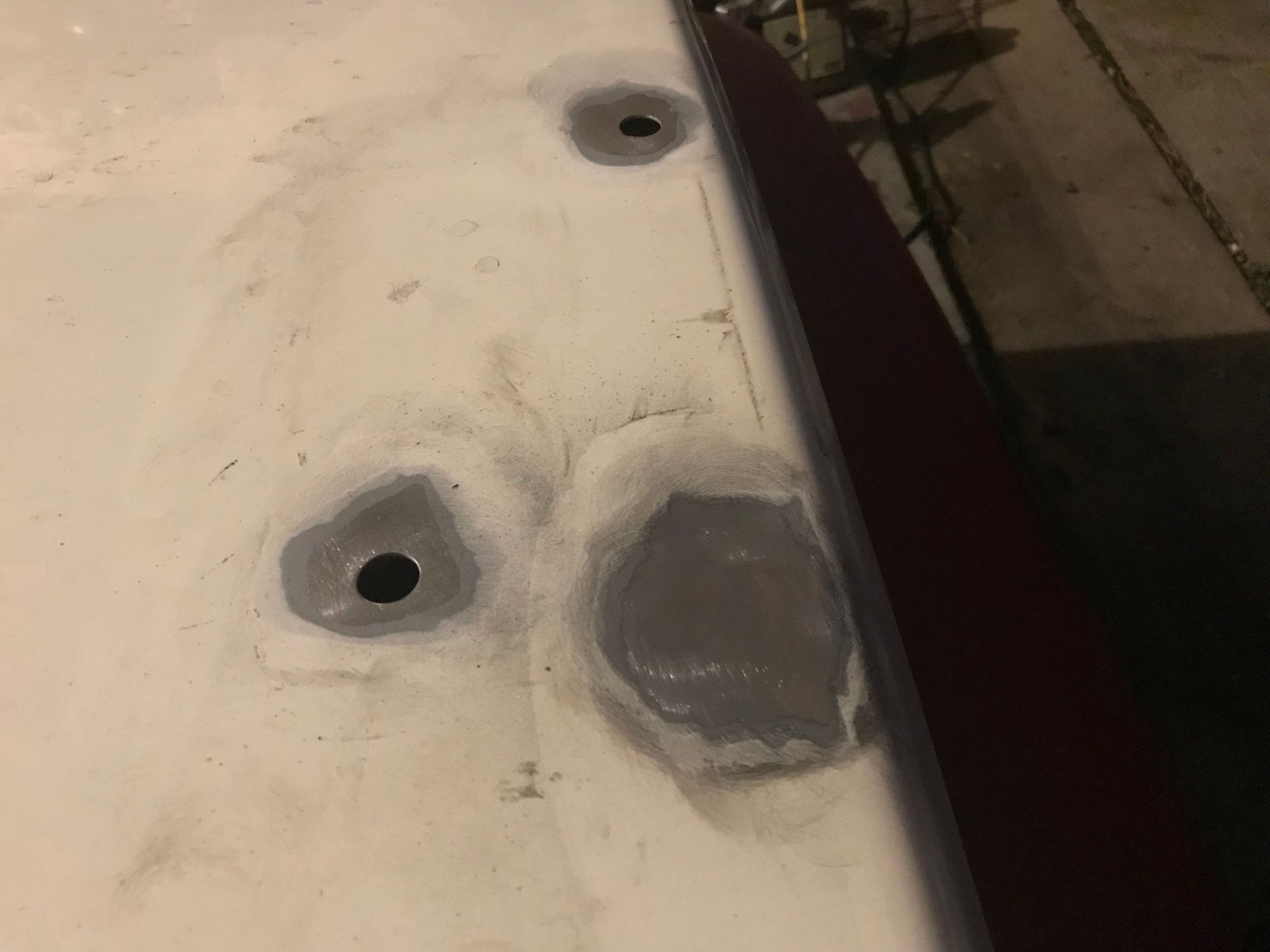

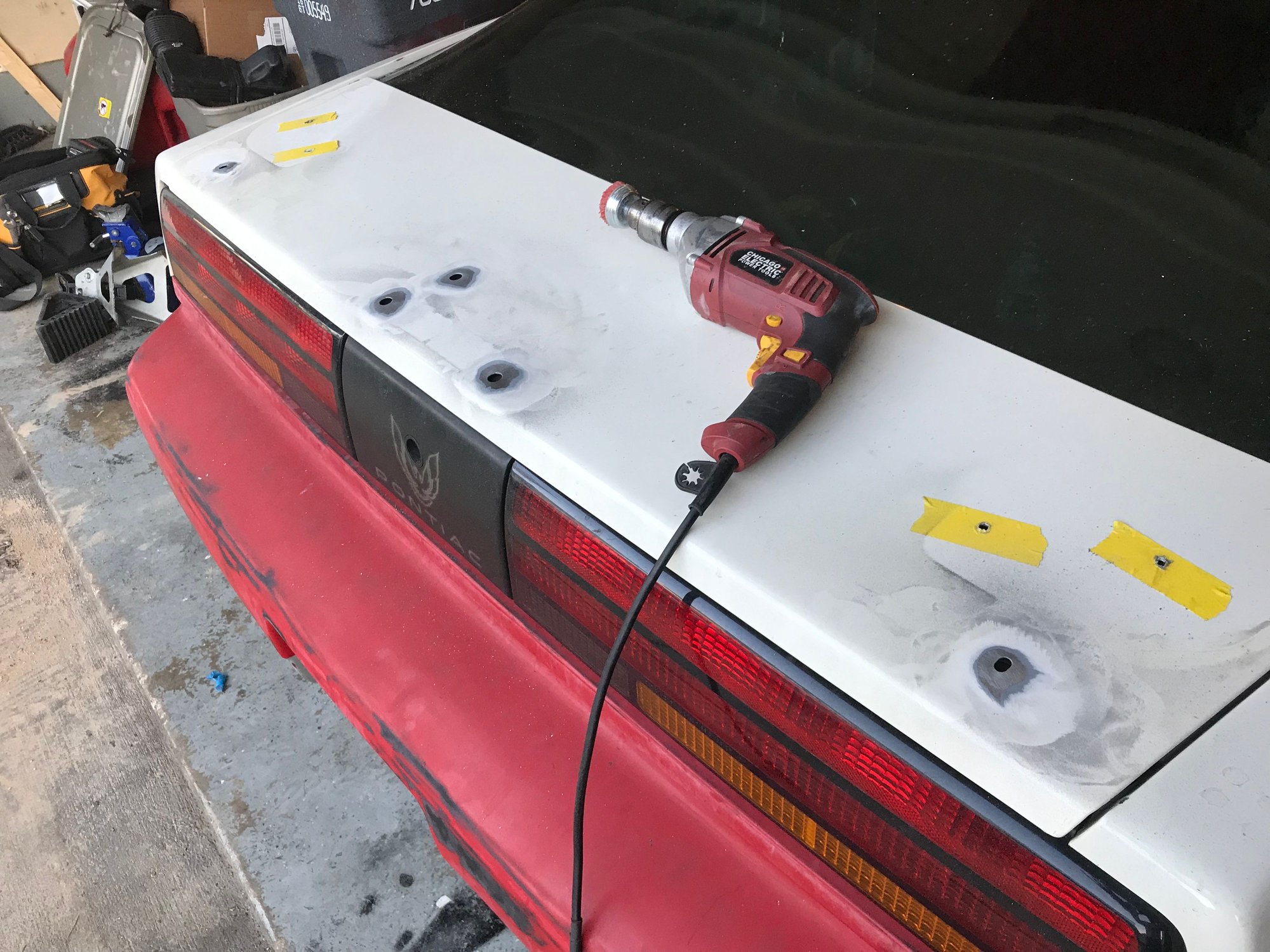

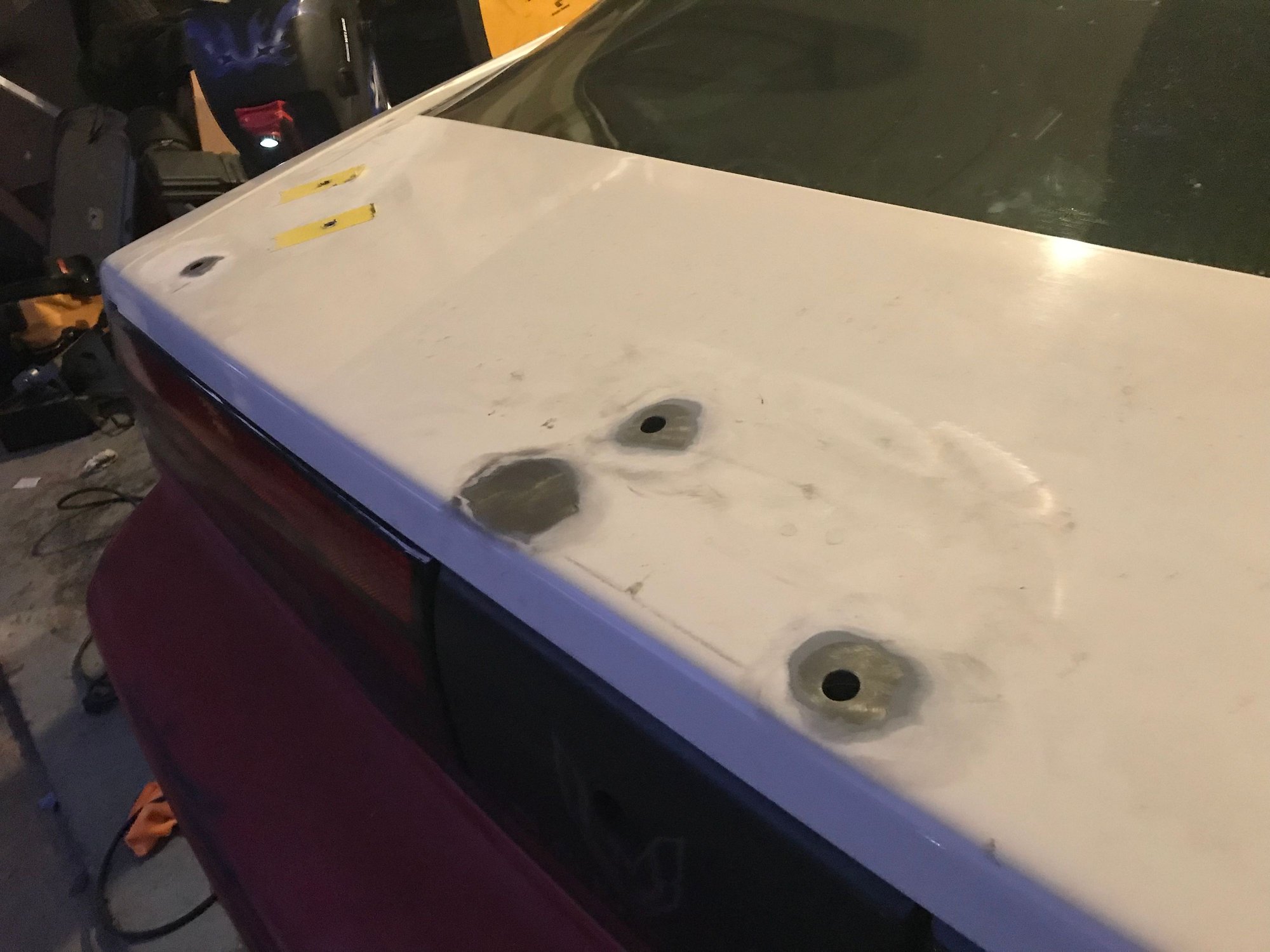

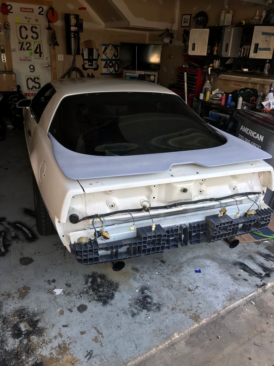

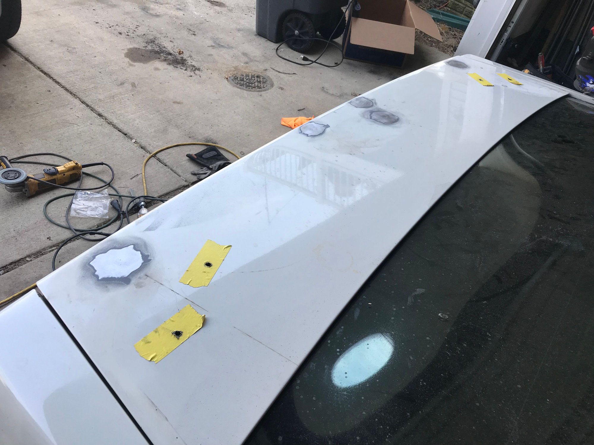

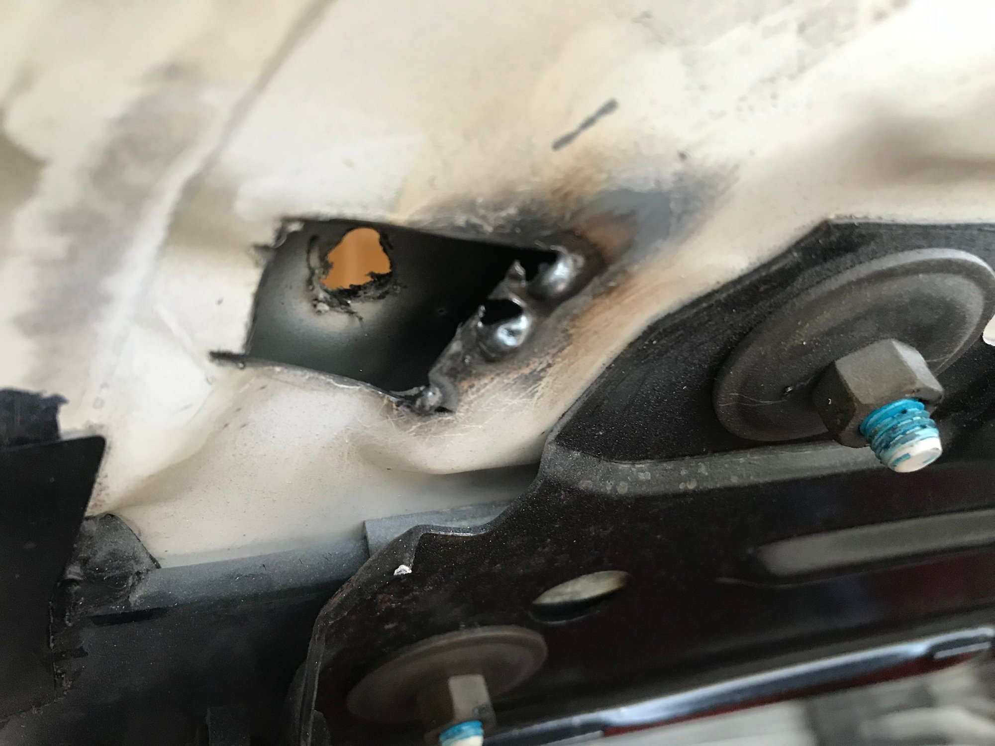

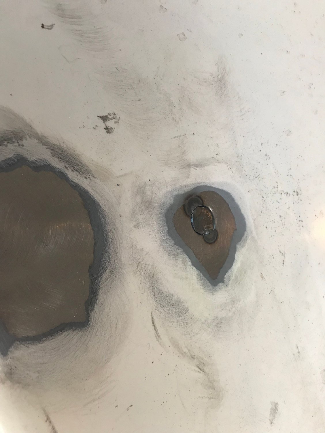

As I mentioned in my last post, all the places I have got estimates for painting seem to be really concerned about filling the holes in the trunk. The only proper way to do it is to weld them and that leaves the potential for warping the metal.
Currently, my trunk has three approximately 1/2 inch holes for the brake light and two 1/4 inch holes for the old spoiler mounting bolts.
So I find myself in an operational pause on the bodywork. I have a Mig welder and I am decent but I’m a little hesitant to try and fill the holes myself without any practice on similar sheet metal.

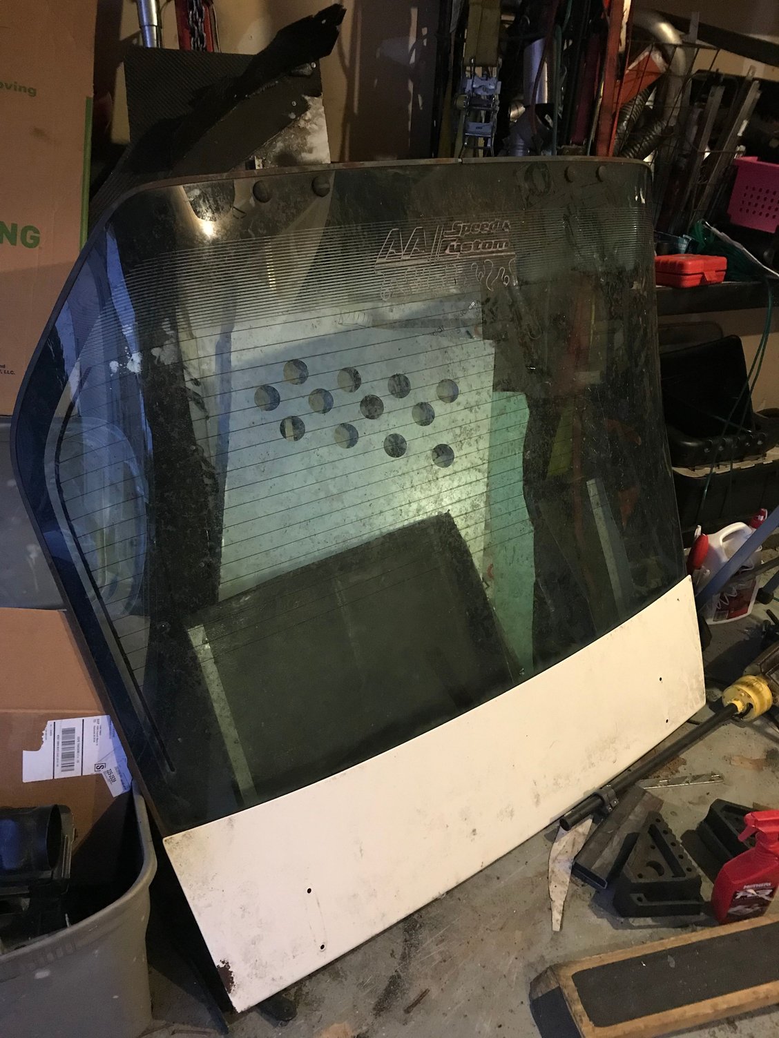

Then on Monday I decided to take a look on craigslist and found this just literally 8 miles from my office.
30 bucks later it was loaded into my Excursion. This was from a base Firebird and it has four really small holes that should be very easy to weld up. So now what are my plans? AmI going to just replace the hatch? Am I going to swap just the sheet metal piece? Am I going to just try and fill the holes on the current trunk?
I am actually not sure right now but at least I have a spare...

Good find on the hatch and I will be watching along when you install it I am very interested where the factory installed sealer from glass to hatch when my bodyman did my 87 with the 91-92 trunk and spoiler its leaked ever since so since it needs to come off - actually I'll be swapping from my 87- to my 90 and 90 to 87 I will have to buy another spoiler for my 87.
I was thinking about you couple weeks ago when I was at Pick N Pull they had a 91 and thought about pulling the lights for you but someone grabbed the motors and the fog lights I was after (they were there 24 hrs earlier when I was in area w/o tools so I stopped by to see what was left) did get few items like kick panels and the park lights. Anyway please post up the trunk sealer when you take it apart for me please, I had searched and searched here and got nuthin

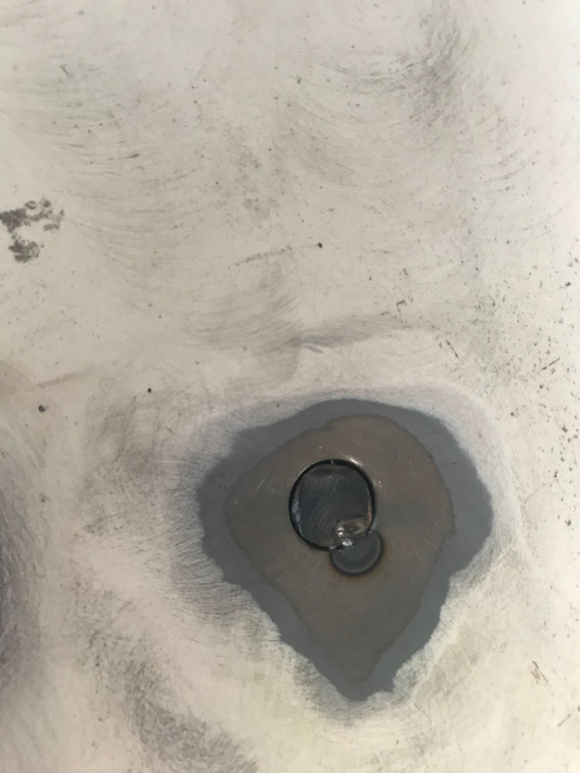

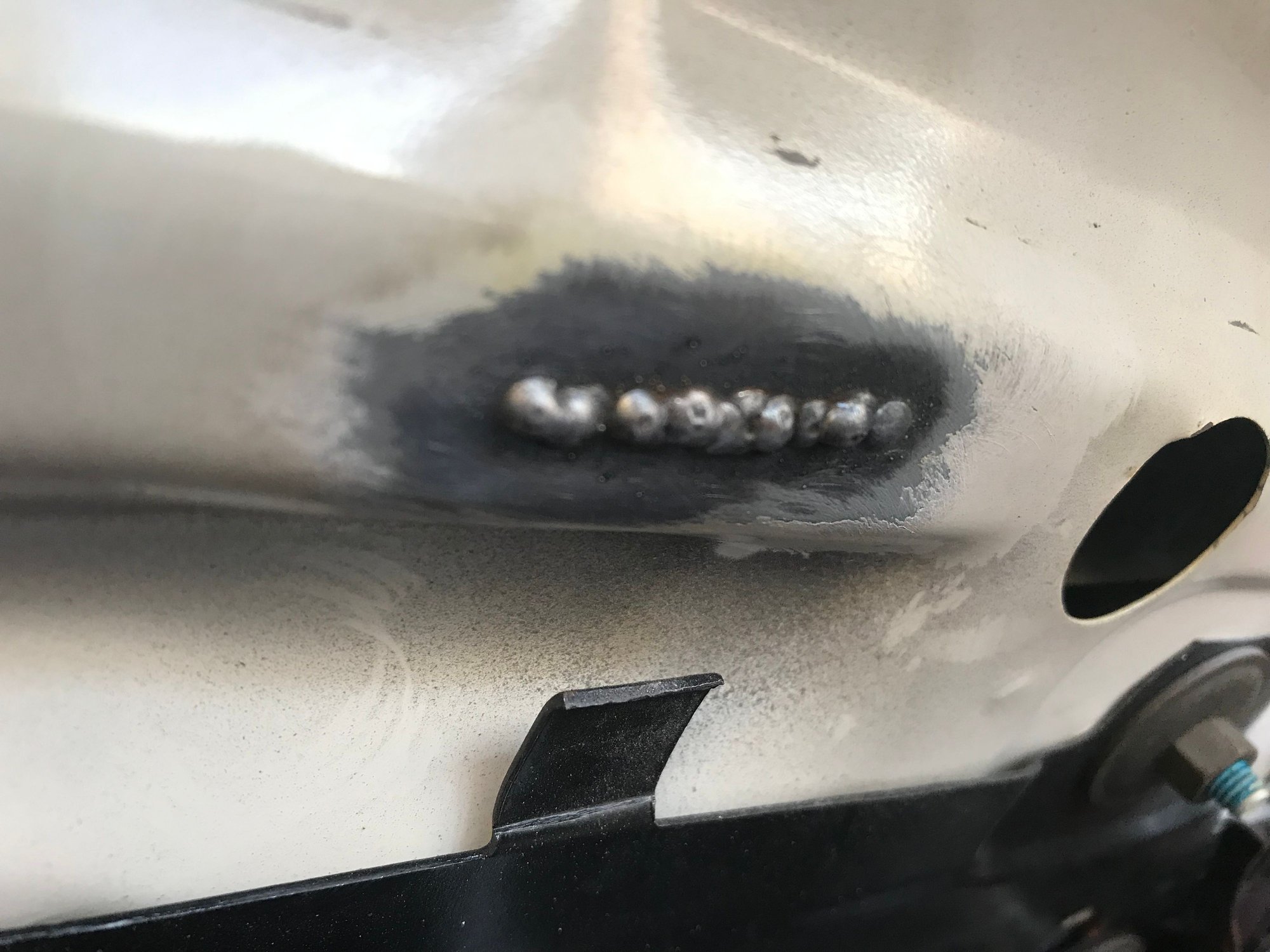

Funny, I was looking at the sealer yesterday and trying to figure out what I should use as a replacement. My initial thought was to use a high end window glass adhesive that I discovered when replacing a driver window in my old Civic (it turns out Honda Civic windows are actually held in place with glue). That stuff held tight after 3 other two part epoxies failed after a couple days.
However, my current game plan is to just pull out the welder and try to fill the holes on my current hatch.
Now that I have a backup I might as well try.

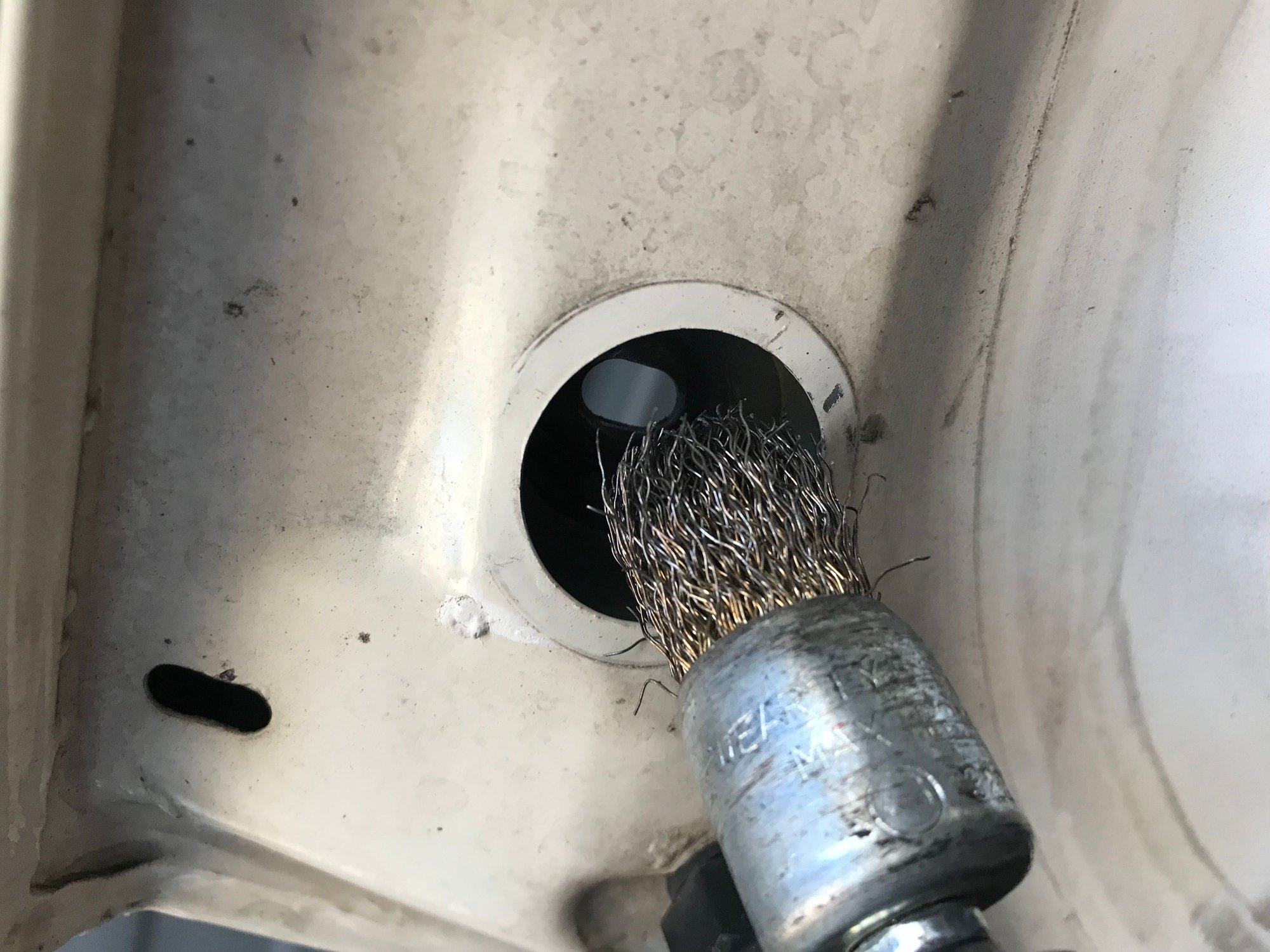

If anyone has are used a mig welder before you know that besides cleanliness machine set up is the most important factor for getting a good weld.
It’s a fine balance between voltage, wire speed, and duration of weld. To further complicate things these variables change as you weld. As the metal heats up it affectively increases the voltage into the weld.
My welder is a little 140 that runs a standard household voltage. The good thing is that on most welds I can just crank the power to 10 and fire away.
However, on sheet metal not so much. Too much power or too long and I’ll simply blow hole in the metal. Two little power or too much wire speed and I’ll build an ugly pile of metal that needs extensive grinding and has no structural integrity.
The trick is doing test welds until you get the settings perfect. And to reduce variables further Test on the same piece you will be welding on. In this case it means using a Dremel tool to purposely cut slits into the underside of the hatch and practice welding on that. I am also using the holes I cut for the new spoiler bolts for testing.
and then, even when you get the Settings perfect. If you weld too fast you’ll put too much heat in the metal. That creates warps which will require additional bodywork to correct.
Too much! I know it’s ugly… But better here on the underside. I would be in tears if I did that to the exterior of the hatch. And I will go back and do a little grinding to clean things up.
Getting closer...
I am nowhere near there yet, but once I feel comfortable with the settings I’ll transplant some metal from the new hatch I Purchased and make some blanks to weld into the holes on the trunk.

Re: Too long...
One down four to go.

One thing that has been helpful is that I have access to the bottom of the hole. That means I can start by tack welding the backside first. Then I can go back over the top.
Of course the voltage that would blow holes in my test runs barely seems to penetrate on my final welds. That’s why my top welds are so ropey (but better to err on the side less heat). Then it’s the trusty angle grinder with a flap wheel for finishing.

No more holes!

She will be going to the paint shop on Monday! And don’t worry, that oversize decal on the hood will be coming off (replaced with proper sized “6.3 LITER H.O.” decals in outline font as close to the original as I could find).

hope your protecting the glass and paint from weld splatter? looking good so far

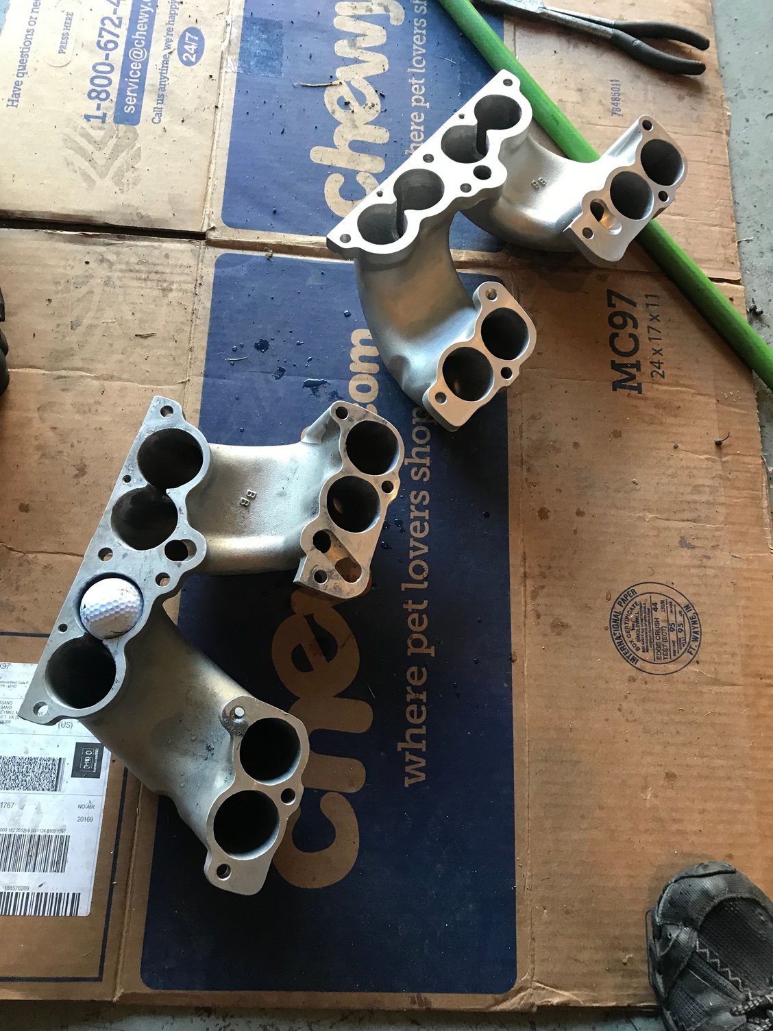

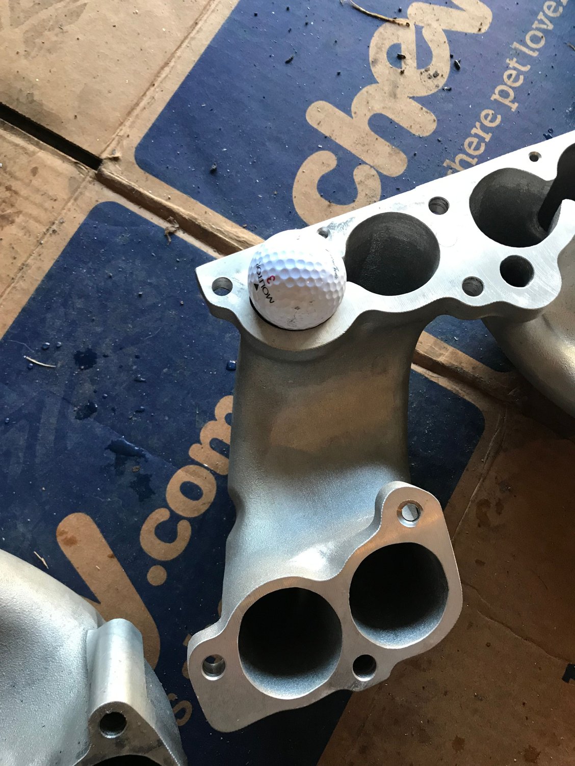

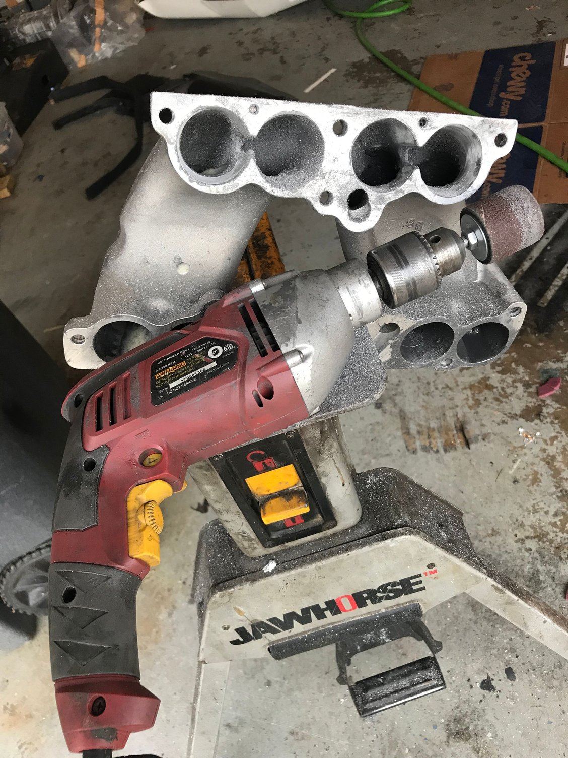

While my formula is at the paint shop (I should get her back tomorrow!) I decided to start porting the SLP runners I picked up a little while back.
No longer a Virgin and NOS runners too AWE...
I couldn't do that
Hey, I blame you! Your post in my other thread of “why not hog them out” was a driving force in my decision to port them.

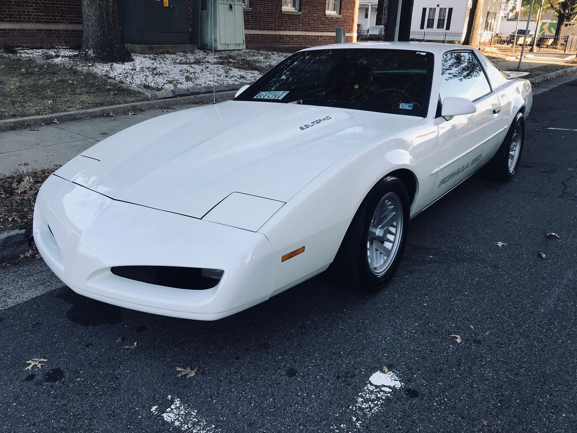

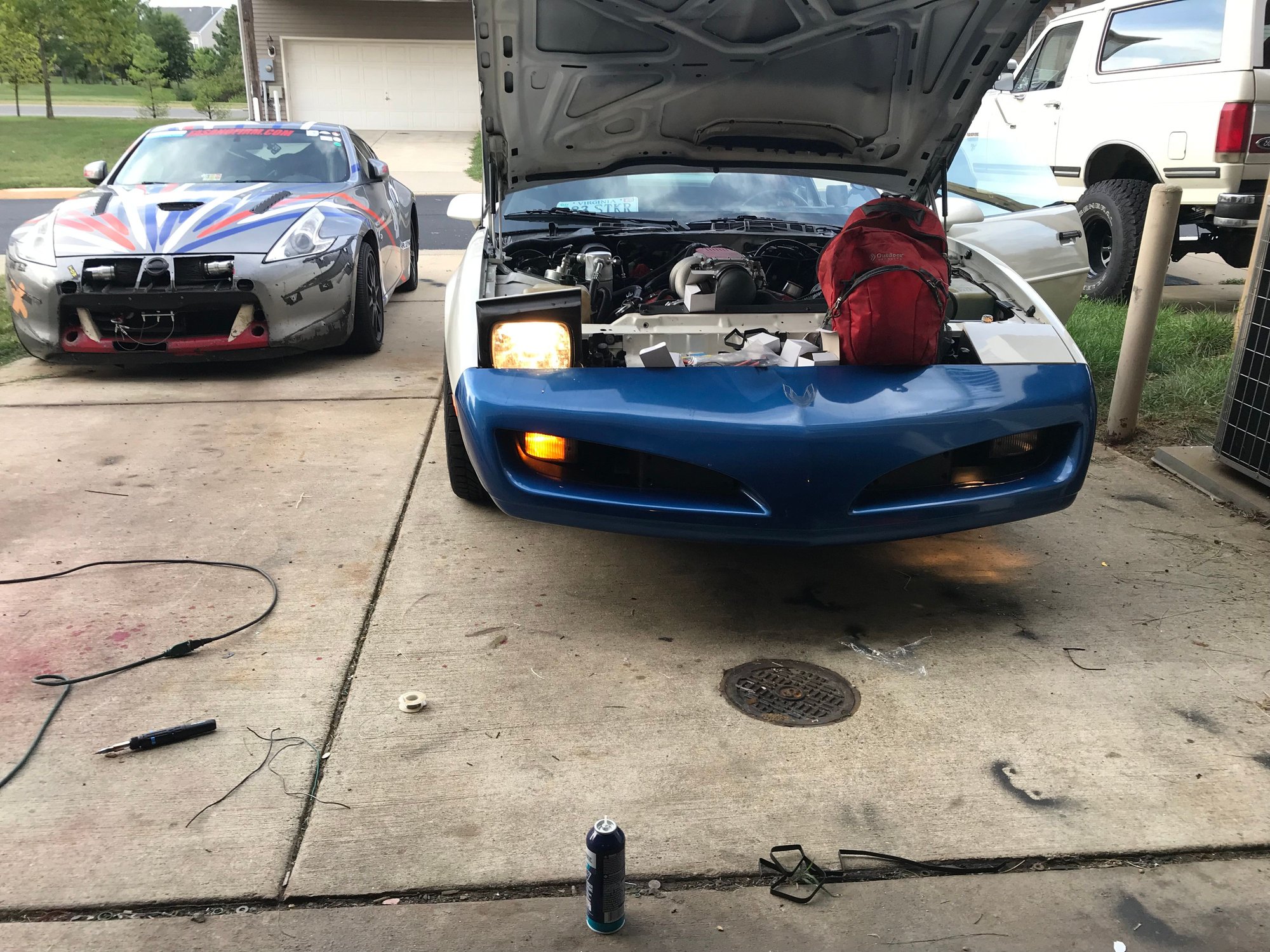

She’s back!
