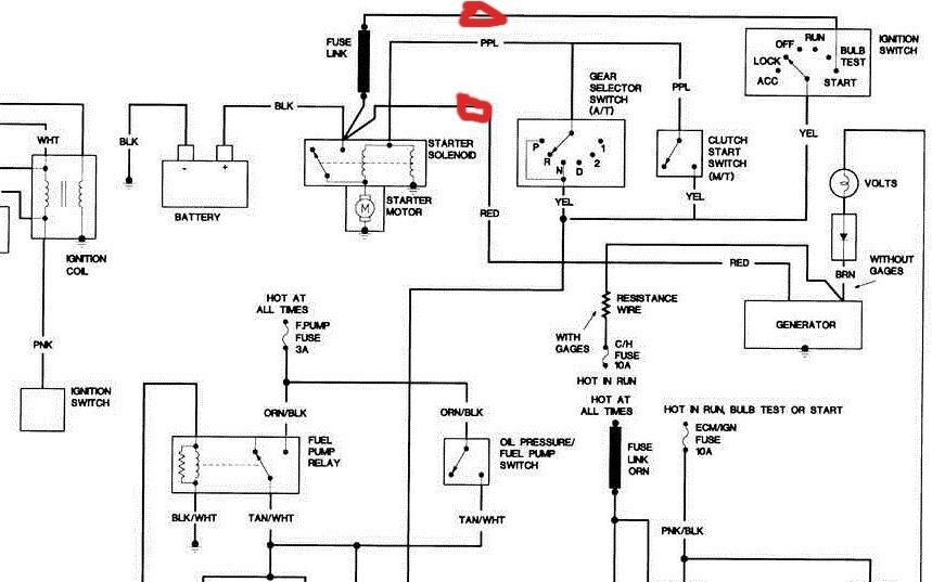

Couple of comments and a request for help. First off, I drive the TA a couple of times a week, and the other day, I went to fill up with gas, and since it was over 4 bucks a gallon, and since the high test wast only a few cents more, I filled the tank with higher octane since it was already so expensive. I didn't think it would make a big difference, but it feels stronger, and I am chirping on shift to second gear on my 700R4, and that never happened before. Next, I noticed the engine running a little hotter the other night, and found that one of the 2 fans on my new radiator was not running. I troubleshot today, and the motor was dead. I ordered a different brand with little higher flow. While waiting for the new fan, I decided to hook up the door locks on the alarm system I installed early in the restore. At the time I didn't think unlocking with the key was a big deal, but I have been spoiled with my other cars having a key-less feature. I reviewed a couple threads on the subject and found the lock relay, I hooked it up per the cartoon attached, with the light green "+ unlock" going to the black relay wire, and the light blue "+ lock" going to the blue relay wire. Bench testing before hooking up, I hooked my volt meter between the alarm leads and ground, and when I hit the lock and unlock keys on the fob, I was getting around 11 volts momentarily on each one. When I tried it for real, when I hit lock, it arms the alarm and physically locks the door (yay), but when I hit unlock, the alarm disarms, but the door lock does nothing. If I push the button on the door, the unlock works fine. Any input would be appreciated.

Arrows show relay wires that I T'd into at the relay

Re: 1983 Trans am restore, finally
I was gonna message you & ask how you were enjoying the Trans Am these days.
I know nothing about alarm systems. I do know that the power lock solenoids on these cars are weak.
As for the perceived power increase you're experiencing, two possibilities come to mind. 1) The higher octane fuel may be allowing the knock sensor to allow more ignition advance. 2) That freshly rebuilt engine may be starting to "break-in" and loosen up a little...

Thanks TL,
Good news. I was getting ready for our date last night, warmed up the engine, and tried the locks again, not having touched the system since hooking up the wires, and the lock and unlock is now working with the fob. Must have been that running the engine charged up the battery a little more. I am ordering a new set of lock motors today. I think the old ones are just tired.

Had plans for a nice Valentines evening with my two women, (wife and car). We left early in the afternoon, attended an art show where I have a painting hanging, then attended a recurring Tuesday evening car show on Hutchinson Island. We were headed to a nice restaurant for dinner, but on the bridge back to Stuart, the engine just died, I made it to the very small shoulder before coming to a stop, but everything was dead. The battery is only 2 months old and the alternator was charging all evening, showing around 14 volts when driving, so I knew it was not a dead battery thing. Turn the key to run, no idiot lights or anything, no fuel pump noise, turn to start, and nothing. No hazard lights or radio, nothing. I could not keep the drivers door open long enough to check fuses because of the heavy traffic. Checked under the hood for any issues, but found nothing. Had to call AAA again, remember I had that failed HEI module on I-95 a couple of months ago, and coincidentally had the same tow truck driver! He was the one who owned a 89 IROC! Needless to say we didn't make it to the restaurant, but the 3 of us, wife, car, and I had a great view of a beautiful sunset on the water while waiting for the tow. Next day I checked and all fuses were good. Still no crank or any electric, except did have parking lights, but no headlight pop up. Since all the fuses were good, I started checking the fuse-able links for continuity and couldn't find any bad. Jacked up the car, and got underneath, looking for any melted or grounded wires etc. Finding none, I was about ready to exit and just happened to wiggle the wires going to the solenoid, and saw a yellow ark at the bottom of heat protector for the solenoid wires. Thats not good. I wiggled again and it popped at the top of the tube. I quickly disconnected the battery and all the solenoid wires, and pulled everything out from under the engine. The wire that was arking was one of the two red wires that are ganged to one connector that bolts to the big lug on the solenoid. It came apart at one point where it was popping and only had one strand at the other end of the tube.
One of the two red wires was toast. The purple one and the other red one were OK.
Apparently the tube got hot enough from the headers to melt and ground one of the red wires.
Here is the tube that allowed the short to ground
I repaired the bad wire and added several layers of high heat insulation, so hopefully prevent recurrence. Everything seems happy now, engine fired right up.
Happy Valentines Day

Glad you found the issue and that it was something relatively easy to fix.

Nice find. Maybe time for a "Painless" kit?

Stupid design. My '83 is the same. When I replaced the engine, I replaced the fusible links, and put high-heat insulator tubing inside the metal tube for the wires to go through.
'Glad you got it figured out...

Glad you caught it before something bad happened. Or next time, and and your wife might have stood by and basked in the warm glow of your car burning to the ground.
Yeah Dave,
Weird thing is it took over 1000 miles to degrade the insulation enough to short out to that metal sleeve. Taking the car tonight for a makeup dinner date.
