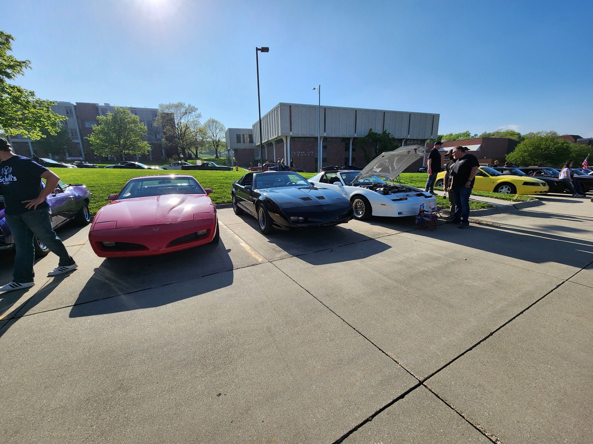

Had a couple other 3rd gens park next to me.
Overall the car show/cruise was good. Cruising at 70mph (per gps) I was turning 1600 rpms with the 6spd. That got me thinking that I could go to 4.11s and not lose much cruising. The only gauges that currently work are my tach and fuel gauge.

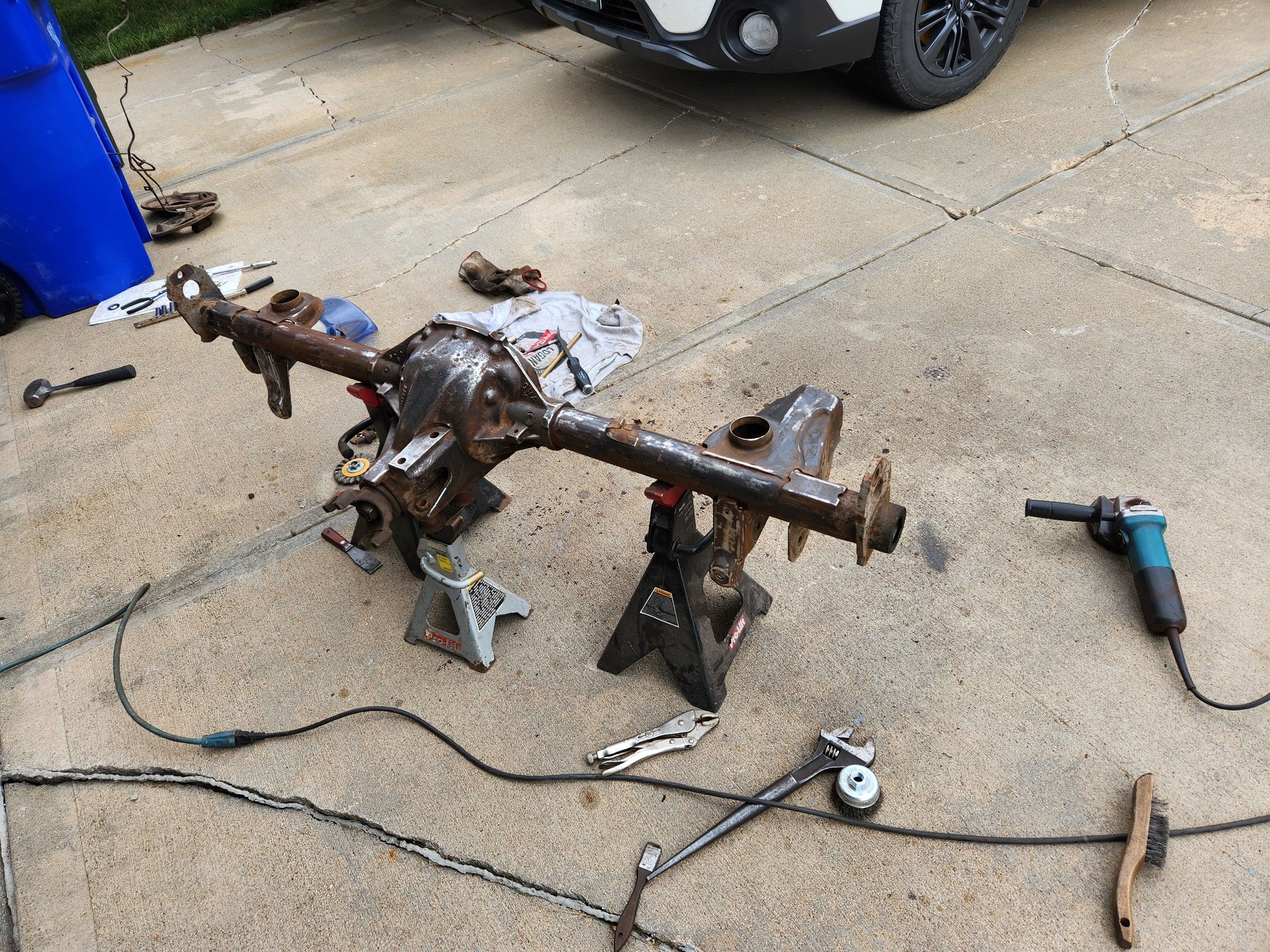

Since I picked up my new wheels, I haven't been enthused with the 4th gen rear axle. I am not a fan of the rear tires sticking out, even with the factory GTA wheels they stuck out. I have been scouring the junk yards and FB marketplace. I looked at a few axles, but they were really rusty and not something I wanted to try and fool with. I went and picked this axle up for $80 bucks. it wasn't to bad, but the downside was the posi left the chat room. Granted the stock 10 bolt is not the strongest, but I wanted to stay more towards stock. I could have done a 9" or 8.8 but the cost was significantly higher. I am looking at 3.90 gears and a track loc, maybe ugprade to 28 spline aftermarket axles. I am going to install my brakes from my 4th gen axle and call it a day.

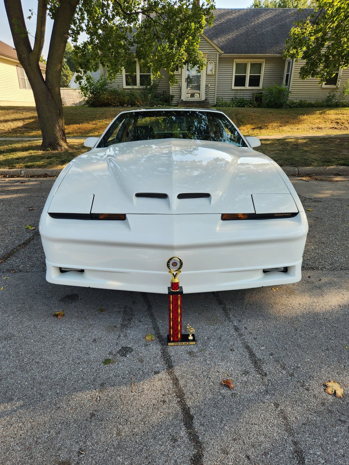

I decided to take my GTA to the Woodbine Applefest car show. I went with my cousin just for fun. I had no spoiler, my rear decklid is primered and looks terrible. So I was shocked when I heard my name called for 2nd place and the class that I was in was huge 1986 - 2003 modified. My boys share the trophy in their rooms.

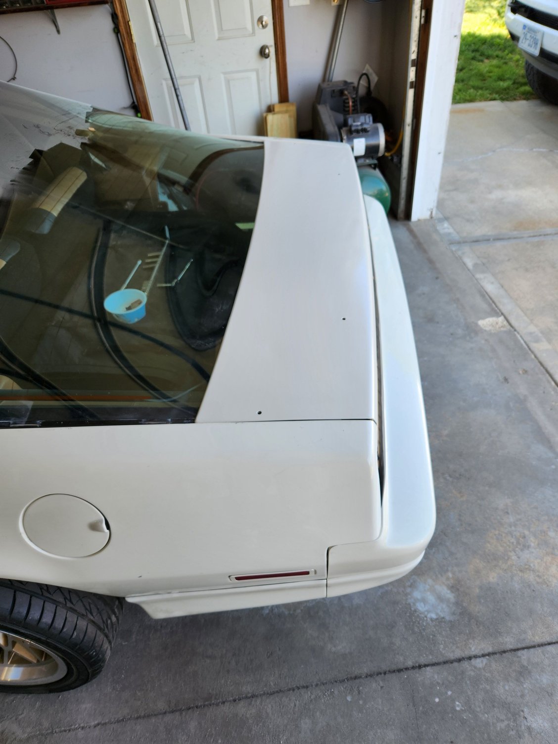

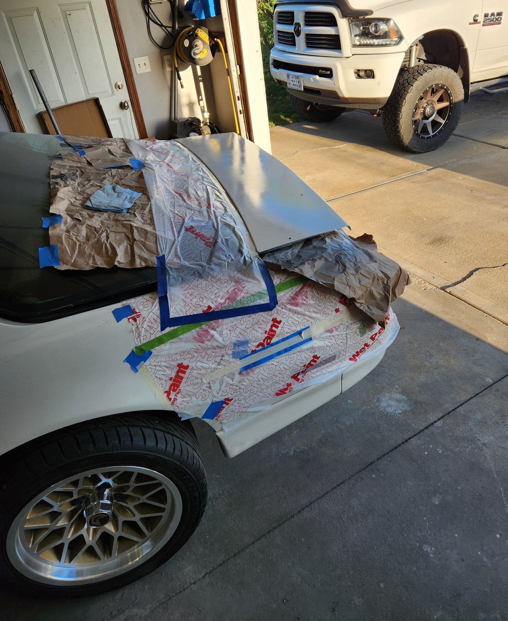

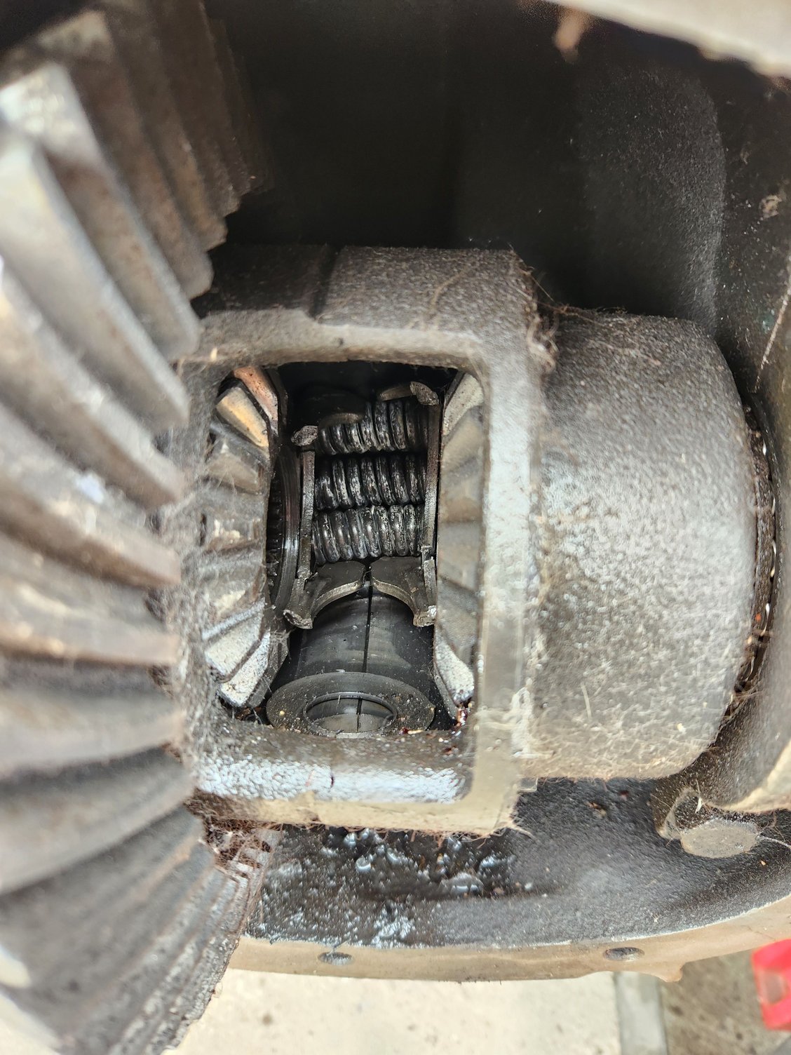

Well after 8 months I was finally able to get my spoiler back. The body shop felt bad for stringing me along for so long they didn't charge me. The color is off and it will have to get it redone.. but by someone else. I dropped off my axle finally to get rebuilt with some 3.73 gears and a new posi. I picked up some paint from the local autobody paint store and tried my hand at redoing my rear decklid. I still need to wet sand and buff it, but I am happy with how it turned out, the color is a little off but not terribly noticeable.

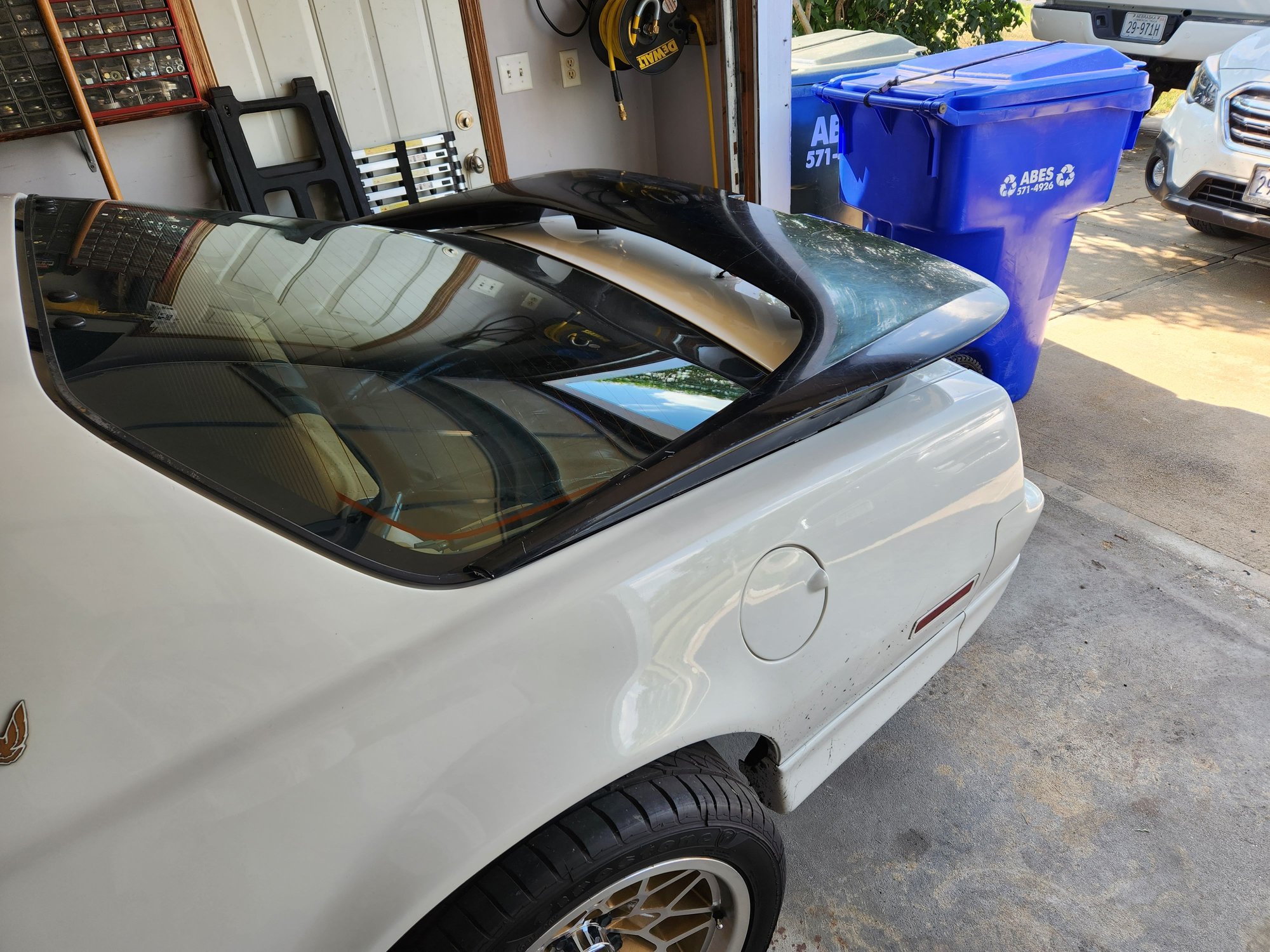

I set the spoiler on and backed the car out of the garage to see how it would look. Overall I am happy with how it looks.

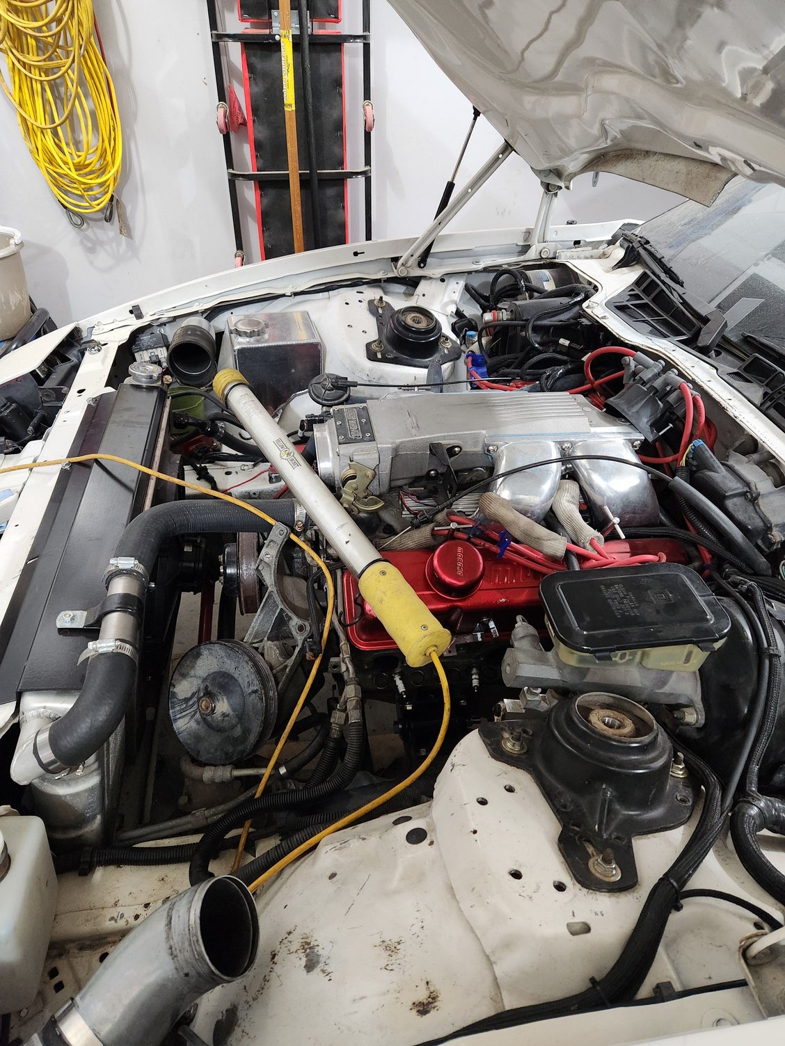

I have been working on the car some more, decided not to pull the engine yet due to time constraints and other life obligations. I was doing a lot of reading and found out dual sync distributors will cause the issues I am dealing with. While Holley had their IRS sale I ordered a new distributor, cap and rotor. I will try the cap and rotor first, and if that doesn't fix it, a whole new distributor hopefully will fix the vibration. It feels like a miss at higher rpms.
starting to tear down and inspect/clean up

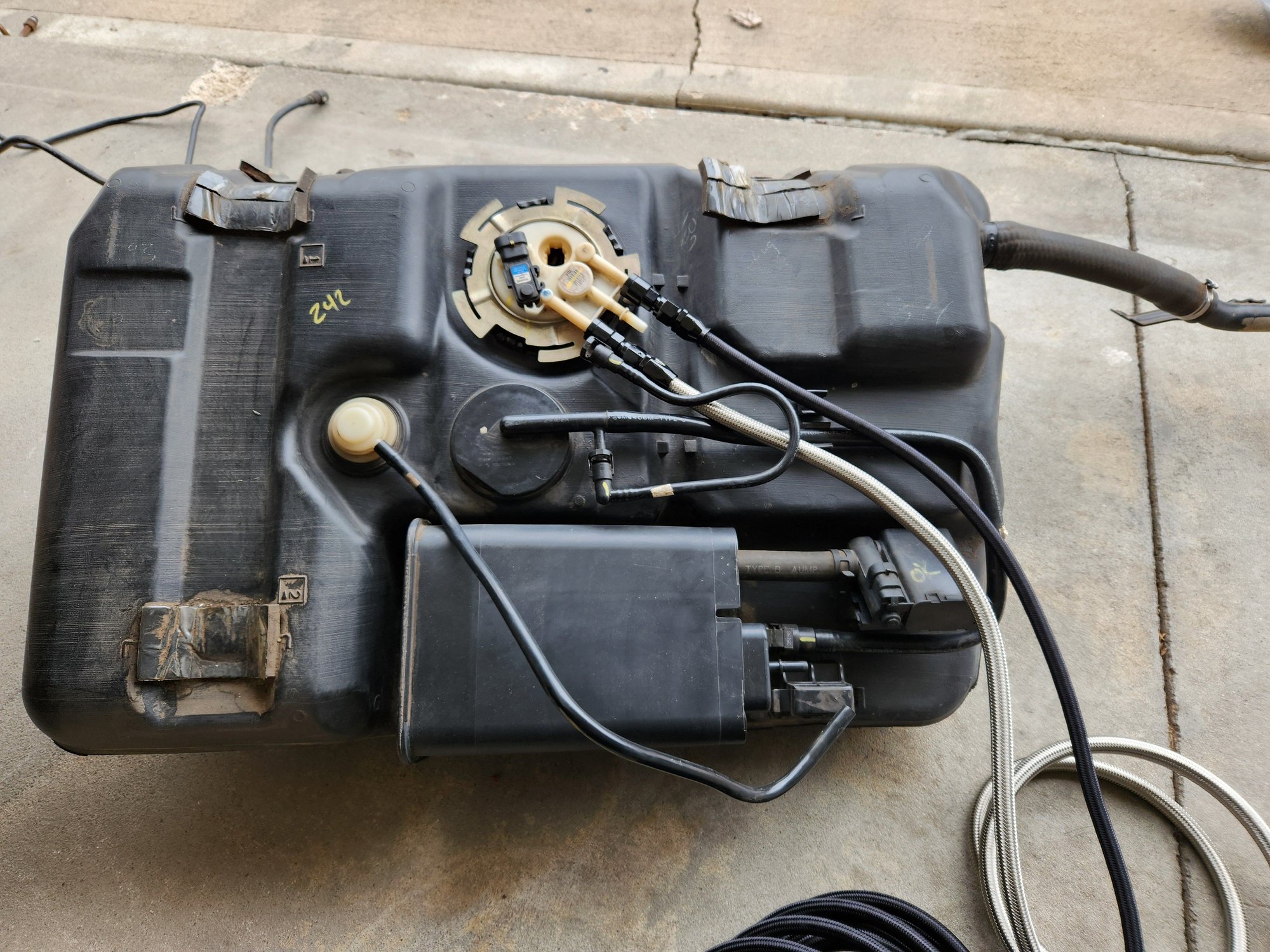

I also had been dealing with a gas smell in the garage coming from the car, knowing that the fuel lines needed to be replaced due to some changes. I opened the garage one day and noticed a spot on the floor, I watched the fuel drip out from the shield. Upon inspecting my fuel tank either rusted out or developed a pin hole, either way a new tank was needed. I opted for a 4th gen tank since maybe some day I might swap to a 6.0.
I ordered -6AN and PTFE lines along with several parts from Racetronix to get the pump wired up. I am running 10 gauge from the pump to the relay that I have mounted close to frame rail. I utilized the 2000 Trans AM fuel filter as well.

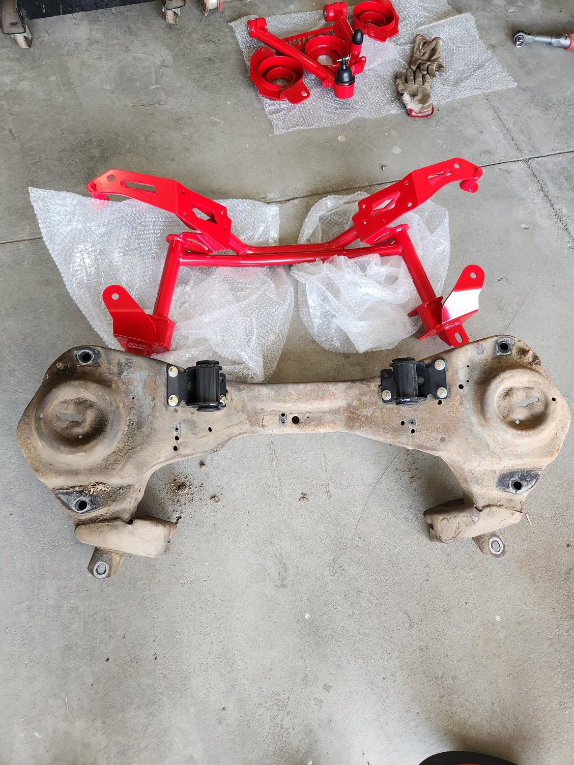

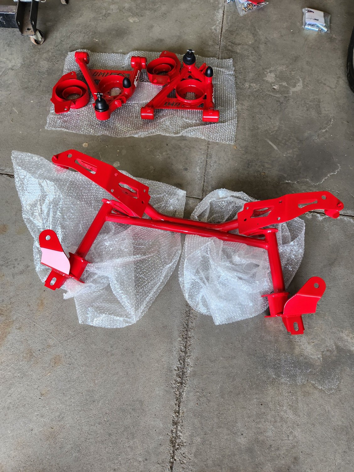

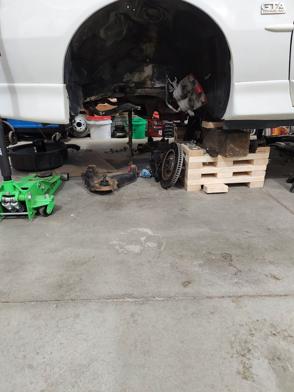

The car lived it's life in a rural community so it saw gravel roads often, I hated how much rust the front suspension had. Along with needing new ball joints and general cleaning I decided to pull the front suspension to clean things up.
After much debate I decided to waste some of my bonus on some shiny parts instead of spending hours cleaning and sanding. I know the factory k-member is stronger, but I opted for more room and I've always wanted to go to a tubular k-member.
I was surprised how quick it was to rebuild the front end. I need to order new brake lines, and get those installed then I will have the front finished up.
