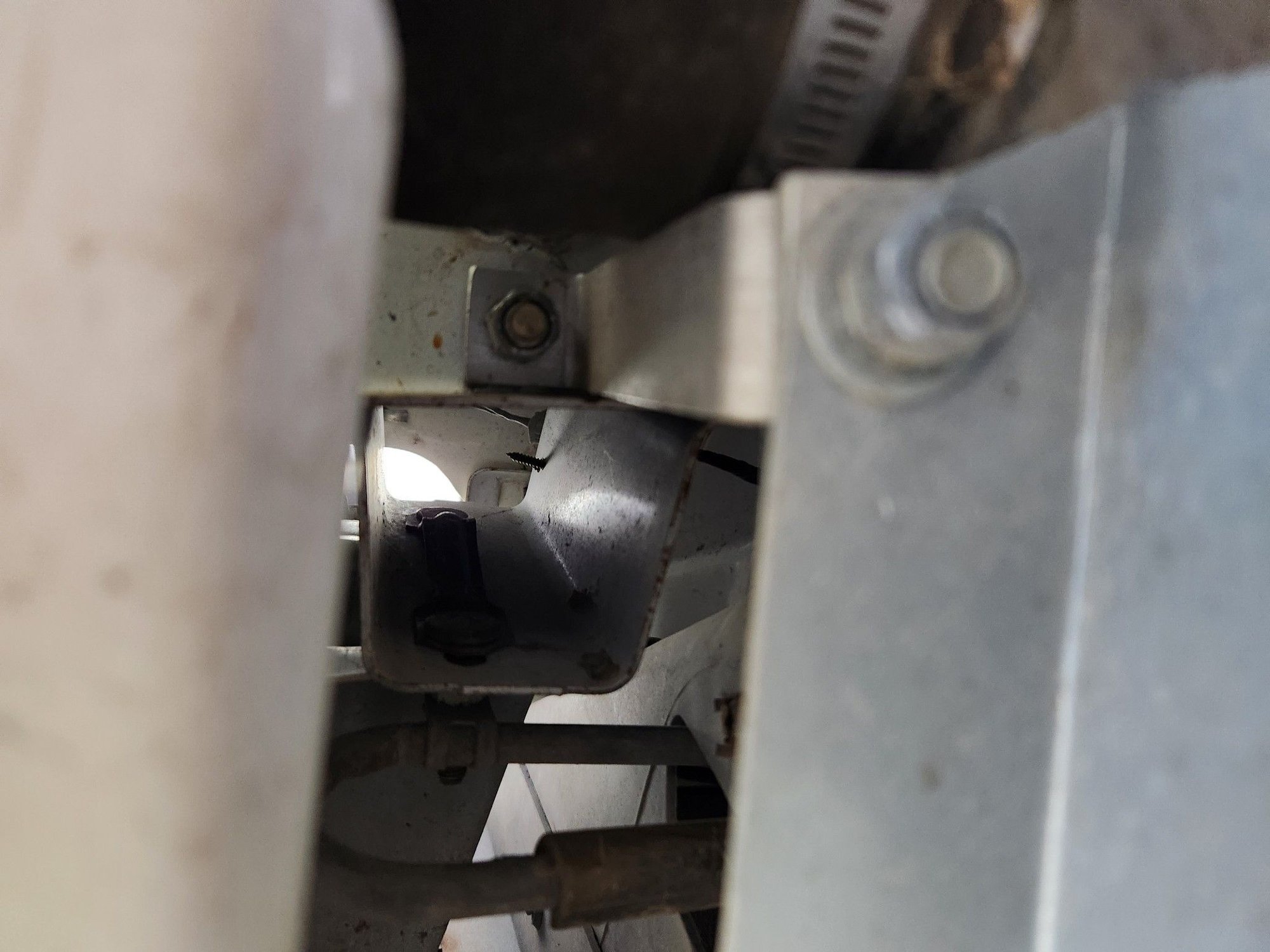

We had some nice weather, so I spent some time working on the car. Using info from this site, I stripped out the wiring I hopefully didn't need, and kept what I needed. we'll see.. I know I have a connector that i am not sure what it goes to. I have a fan relay from a vovlo that I am thinking of using, otherwise I will go back to the factory relays. I am also going to reuse the fuel pump relay from the procharger kit and use the Holley to turn it on.
I really need to figure out a radiator for this car, I found a 98 firebird radiator on Jegs, that I think will work.
I also pulled the tank (that was more difficult than I thought it needed to be.) I installed a 470lph wablro pump, and it was nice to see that everything was in pretty good shape, no rust in the tank.

I think the 4th gen radiator is a bit more narrow than a 3rd gen so you might have to fab something for the support to keep it in place.

The 4th gen radiator sits on an angle. I do not believe it will fit.

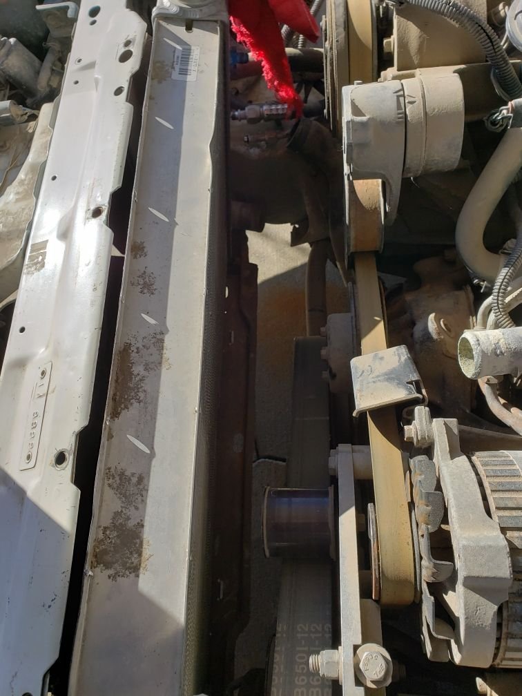

The 3rd gen radiator doesn't clear the 12 rib setup on the procharger. I need a radiator with the drivers side outlet lower, or change out the pulley setup to a 8 rib setup. I found a picture with someone using the 4th gen radiator just to clear the procharger.

Fourth gen radiators fit... but theres a little massaging it in and the whole mouinting thing.
What about a 2.8 V6 radiator? It is a bit shorter, the outlet is on the top passenger side and the lower outlet is on the driver side bottom i think. it will bolt right in with no mods.

I don't have clearance on the passenger side due to intercooler piping. I have pulled the condensor for now, to figure out the radiator issue. Once I know I can get a radiator to fit and keep the car cool, I'll work at installing the AC condensor.
Hmmmmmmmmmmm pics when you get it done! !
My thought is......... the condenser sits kinda ahead of the radiator....newer cars like i think the 09 Impala etc... have the rad sitting under the radiator supprt metal vs how it sits behind it in third gens.... maybe you can find a radiator out of a newer car that would fit under the support where the radiator top shroud bolts to.

What if you add a pusher fan in front on the driver side?
I added an 11 inch SPAL pusher fan (I don;t think a 12 would fit). Its my emergency back up fan... its actually strong enough to cool the car down by itself.. .granted Im running only stock stuff. but it would definetley help. and would probably take some load off that single fan.

Originally this radiator came from a camaro and had dual 12" pushers, but wanted to run a puller instead. If I run into issues than I will try to fit one of those in. I removed the condensor to run this radiator so I have a little room to spare.

Im running the 11 and fabed up some brackets. So they actually sit away from the condenser like half an inch or so....I know not the best placement but I didn't want it to touch.....but I have to say it works excellent...with the SPAL the stock fans wouldn;t come on at all so I had to reconfigure where / how the switch was located.

I finally got some pictures of the intercooler.
air scoop,
Drivers side
Passenger side
Old Feb 6, 2023 | 07:23 AM

Firechicken82's Avatar
Joined: Aug 2021
Posts: 1,230
Likes: 349
Car: 82 TA
Transmission: Magnum f
Axle/Gears: Ford 9 w 4.11
Re: 1989 GTA project
Thanks, those are great. That's exactly what I'm planning to do w mine. Curious to see that you dyno at when your done.
i have a 16 ram mega cab on 37s and looks just like the ones in your picks but all black.
