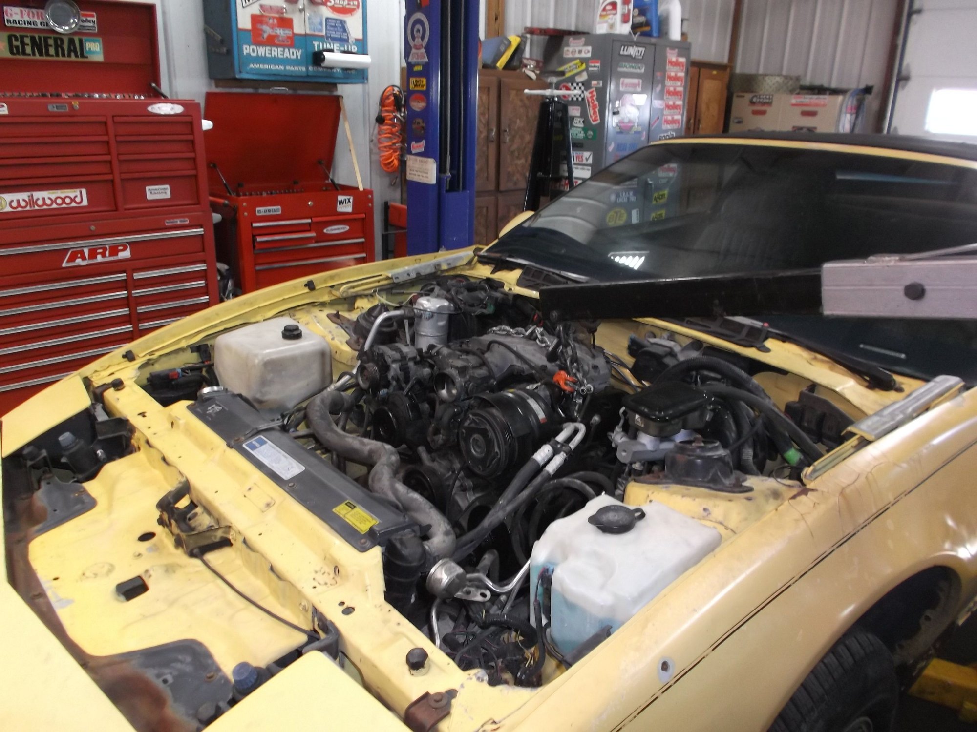

Turns out after a teardown, #6 cylinder in the original engine is pitted so bad from sitting open to the elements that it is now junk, the rest of the motor looks very clean and good which is a danged shame, but this type of engine is not worth installing a sleeve in the 6 hole to bring it back. (not yet anyway) Me and the boy are debating over what to slide back in place in the engine bay now. I'm still leaning towards the oh-so-cheap and complete 3.1 that's 6 miles away from me still in a 91 Firebird where I can bring it home and try to start it and maybe hear it run before I lift it out and reinstall, but my young protege wants something a lot bigger and powerful for us to play with.
Easy for him to say. But I have access to all the parts, the ability to cover expenses, and for right now, the know-how.
Today was pressure washer day, the engine bay needed a big time cleaning before anything goes back in there.

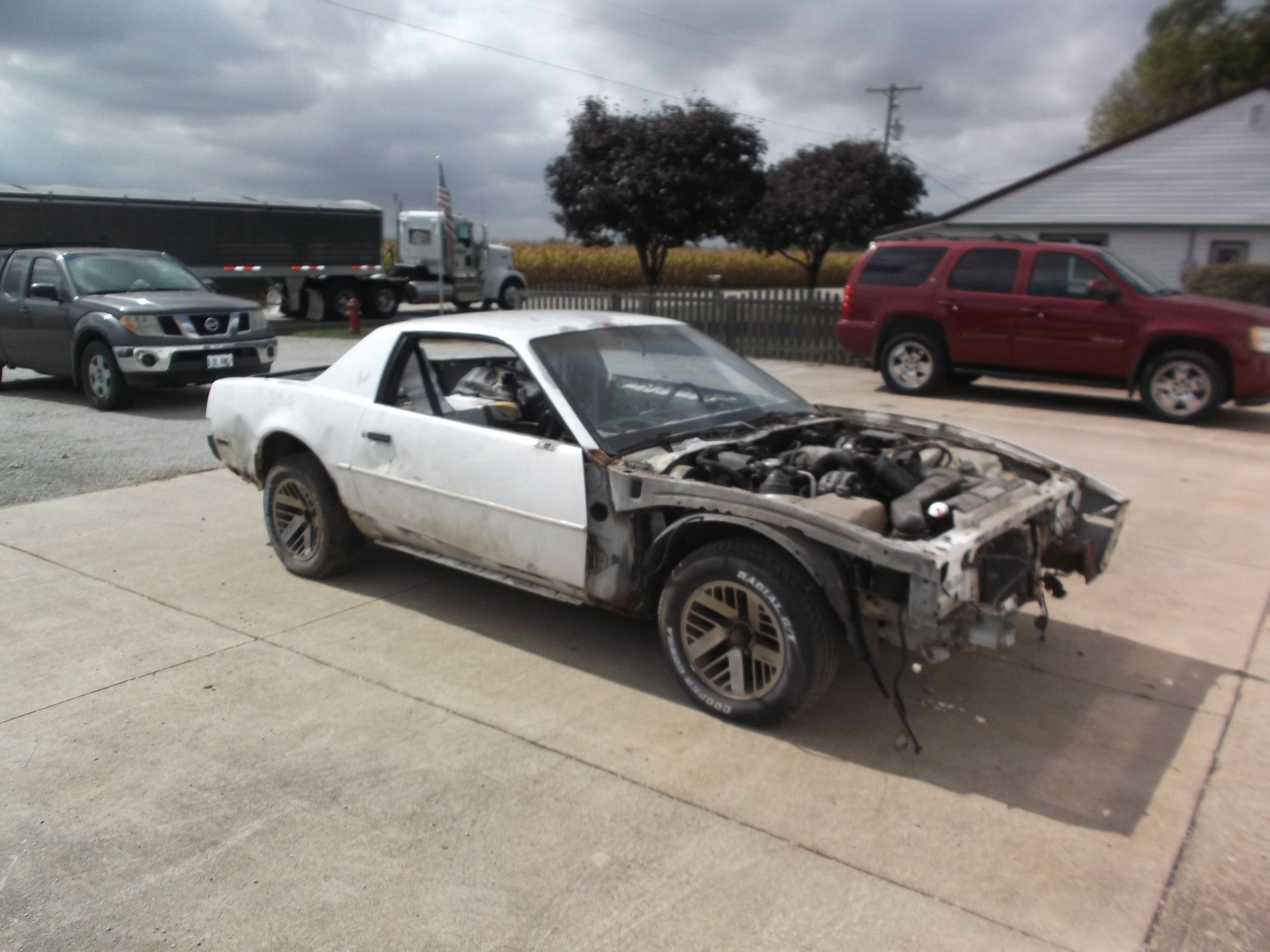

Here's the latest on the JY '92 project car: This extremely rusty white 91 has given it's all to let another survive, and I do mean ALL, it was a local junkyard car that was headed for the crusher soon, so I made to deal to take anything off it that I wanted and return the leavings for the princely sum of $200. After the external and interior partout, the engine was temporarily fired up (and on fire once!) and we didn't hear anything concerning for the 10 seconds we heard it running off the spray can, so the decision has been made to remove the engine and trans and transplant those into the convertible since it's a direct and fairly easy bolt-in. The engine has proved itself for now, and I'd rather take my chances with the white car's transmission that's sat still for 5 years with good red fluid in it instead of the one in the yellow car that's been sitting idle for 12 years and has brown fluid.
The wheels and tires you see on whitey are staying with me too, they're not all that bad, and then she goes back to the boneyard. There's almost nothing left on the shell now that is any good to anybody and I even took some stuff off that I'll have to do some repair work on to save, like the dash pad and the driver seat, but hey, you can't beat the price. I'd buy parts cars this way all day long.

The 91's front fascia looks decent in the wrecking yard picture above, but it's not. It's been through one crash already, and whoever "fixed" that damage was about as backwoods of a body shop as they come. They created a frame horn out of angle iron to mount the front crash bar to and didn't bother to straighten the radiator support a whole lot, they tack welded it back in, and the bent up A/C condenser might as well have been removed as to stay there and exhibit it's damage. There is no earthly way the A/C worked in this car after the wreck.
The white fascia has one major tear that has been riveted and back-reinforced with metal strips and it still has a gap of about 1/8 of an inch in the tear. It's an ugly hack. It also has two good sized rips in it way down low, other minor tears here and there too, and the passenger side front ground effect I already removed and used on yellow car #1 from a long time back. But I might try to do some repairs on this torn up thing just for the sport of it since I have almost next to nothing to lose, and get practiced up for doing a bumper repair on a 5" marker lamp tear occurring on my 97 Bird that needs fixed.

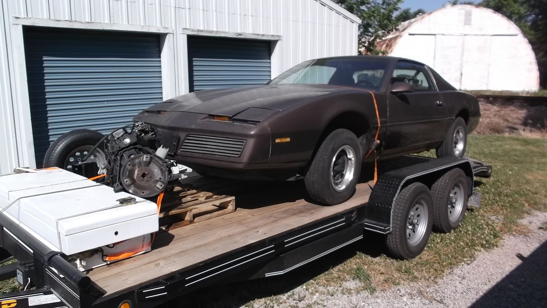

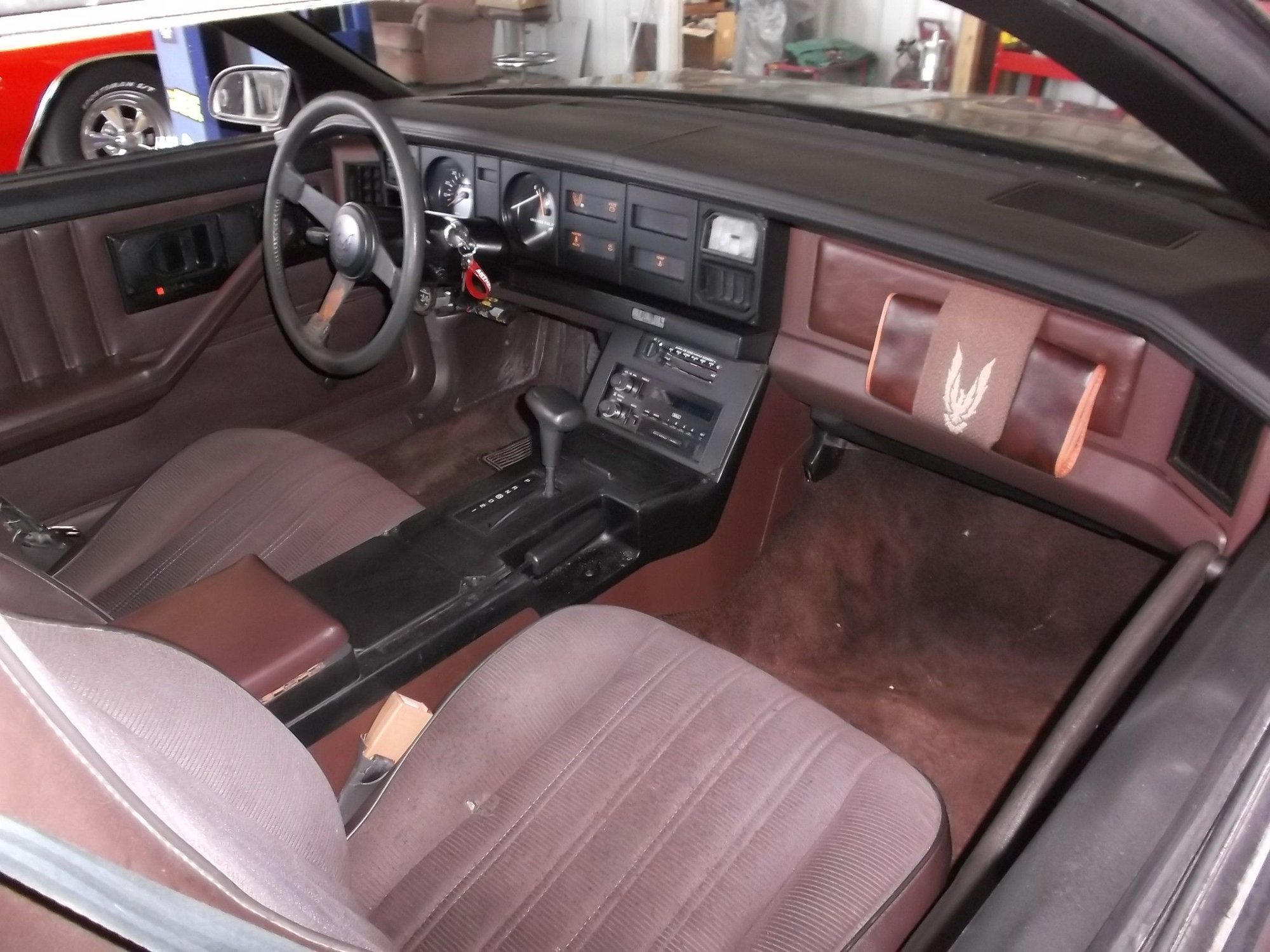

Thanks guys. I located a spoiler long ago for this brown car, the existing one the car had was either sold off or stolen while the car was camped in the trailer park. At least they didn't tear up anything getting it off.
These pictures I posted are a few years old, but since then a correct spoiler was located and repainted the proper color and put back on. Boy, those spoilers sure help the looks of these types of cars, and I'm saying -all- the gens look so much better with one! If they don't have one, it's like they're neutered.
This car has very little rust, you can see the one spot over the driver rear quarter, and there's a little starting on the edges of the wheel lips. The underneath is all rock solid. The driver side front fender and front fascia has been replaced and/or repainted before, but I couldn't find any other damage inside those pieces or anywhere else. Once I got the engine and a battery back into it, everything electrical worked, the headlights popped right up with no hesitation and shut right back down, and the other controls took right off too. The original AM radio works, but it was real scratchy sounding from old age, so I put in an AM/FM one I had out of an 84 Corvette.
The original owner was a Hamilton Ohio woman and she always garaged the car up until about 2015 I'm told when the motor started knocking and she sold it off to owner #2, who never re-titled it in the two years he had it, so I was handed a title showing it was bought new by her. The speedometer shows 88,000 on it now, and I have no reason to believe it isn't accurate. I'll rebuild the 4 cyl sometime and get the car right. My initial goal was to get it back together and moving under it's own power, and I accomplished that. I can gently drive it into town and go to the local cruise nights if I want to, so for now it's a win.
If anybody reading has parted a 4 cyl car out and has the A/C compressor mounting brackets, those are the only two engine compartment pieces I couldn't find inside the car. I made a hokey looking bracket set-up out of scrap metal to mount the compressor back on and get a drive belt to run around it again, but it doesn't look very good. Message me if you know of anything.
