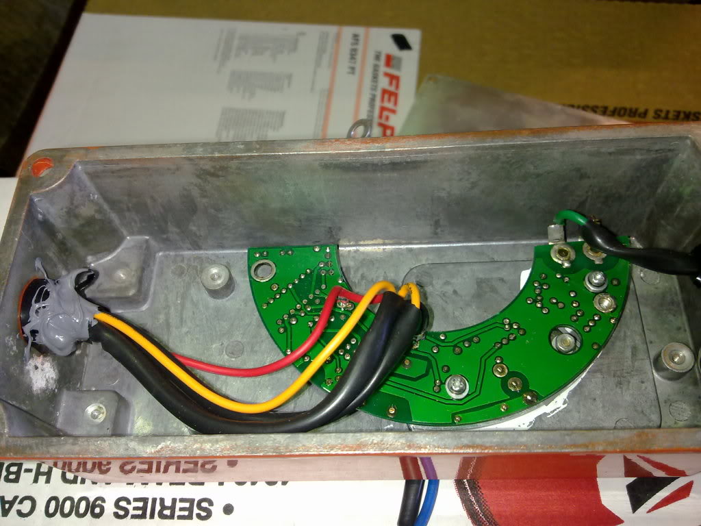

keep your eyes open for a good used mallory or msd 6AL. you can find those for very reasonable prices used.
long story short, I would use a front line lock for the burn out. it will make your life MUCH easier.
here's a picture of the inside of a procomp box

i know that picture, thats the inside of a counterfit msd 6al box , not one of the procomp boxes
they actually show apicture of the inside of the procomp box on the auctions
but yes i agree a used msd or mallory box is a much much much better choice then a new procomp box

Yea im looking for another box too, at least something because my ignition is probly getting to the end of its range as of now.
