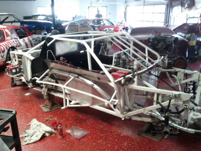

The body is off at the moment, I'll share some photos in a week or so.
It's being restored to a point in time 1989 when it raced Trans Am and IMSA GTO.
That will make it eligible for Vintage racing on the west coast.
http://www.historictransamimsa.com/member.html
It was a complete car when I got it.
Started and ran fine but would pop out of reverse.
I wanted to do the typical track prep service before I tested it.
Then we found it had the history needed for vintage racing.
It came with several body parts from the 88/89 season.
See the front end photo with the large O for IMSA GTO class.
So now we are halfway through returning to 1989 Trans Am/IMSA GTO spec.
Engine is a 358 that next week gets a valve job and springs minimum.
The transmission is a Weisman 5 speed. http://www.weismann.net/imsa.html
We rebuilt it and geared for the west coast tracks, 145mph top speed.
So it should be fine for Coronado, Monterey, Sonoma and my local track Chuckwalla.
While we were in the trans found someone had lost one of the mainshaft spacers...
In its place was a piston ring from a lawnmower engine. lol
This trans has the transfer gears on the back, like a quick change.
So changing the final drive ratio is not too difficult.
This trans requires no clutch on the up shifts, just on the down shifts.
Kind of like this...Road America is on my bucket list.
http://www.youtube.com/watch?v=ynxCq...zXfIbmssh46Q0w
Same time we installed a new 7 inch flywheel/3 disc clutch and kept the old one for a spare.
It had an aluminum driveshaft but I was advised to replace that with steel.
Too many aluminum driveshaft failure stories, one driver lost his elbow.
Another had all the rear suspension points rip out when his driveshaft failed at speed.
Then he way "just along for the ride".
4 link rear suspension.
Rear end is a Winters aluminum center section (non quick change) with 4.11 and Gleason diff.
Gleason link. http://members.rennlist.com/951_racerx/ps84gleason.html
Alcon brakes all around with front cooling ducts/water sprayers.
Dual brake master cylinders with balance bar.
It came with brake fans too, save those for the car show.
Cockpit adjustable blade type sway bars front and rear.
Fuel Cell is in the back with the dry sump tank.
It's right at 2750lbs without driver, 2700lbs was the min wieght back in the day.
Steel roof as per rules rest of body is Kevlar.
We replaced a dented door, cracked rear bumper and cracked hood.
http://derhaagmotorsports.com/servic...s/default.html
The Kevlar is lighter and will not rip or tear/rip/split at speed if damaged.
The car came with all the molds except the rear bumper, but those are still in storage in the mid west.

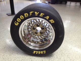

BBS wheels just restored with new hardware.
BBS sells the bolts cheap, what a surprise.
Fronts 16x13, rears 16x14.
Bad news is Goodyear has discontinued my size bias bly slicks.
I have a few new sets to get through the year.
Hoosier makes a similar size slick but they are a couple of seconds slower a lap.
Avon in England might make a 6 ply slick to replace the discontinued GY, fingers crossed.
Slicks front are 25x13-16 rears are 27x14-16 inch rim.
Photo of 911 slicks on left, Camaro slicks on right.

Pull molds off the body panels
this is my dream car... I would kill to graft that body on a stock street camaro and run some real tires

Moved the car into the clean room for final assembly.
It was accepted to the Sonoma Historic races this spring.
http://generalracing.com/
Engine is out for a valve job and to replace the dry sump hoses.
All bolts are being replaced with AN quality safety wired hardware.

on that note I have replaced every consumable.
Which created a good spare package.
our luck after a complete valve job before reassemble we found a crack in the engine block.
So a new a new block then a wheel dyno.
Did I mention the spacer we found in the 5 gear weisman that was actaually a piston ring for a lawn mower engine.
since fixed with some help.

Sweet ! Any more shots with the body off ? Very interested in old road race chassis design. Keep up the good work

Cool! how did your tire situation work out?
Joined: Dec 2012
Posts: 281
Likes: 67
From: San Diego.
Car: Trans Am/IMSA GTO Camaro.
Engine: V8
Transmission: Weisman 5 speed.
Axle/Gears: Winters w/ Torsen Gleason 4.11
Joined: Sep 2009
Posts: 301
Likes: 8
From: whitby ontario
Car: 89 Iroc street car
Engine: Fitech vortec 400sbc/T5
Transmission: Also 69 Chevelle, Nascar chassis
Axle/Gears: 700hp roadrace track day car
Re: Camaro road race car.
2K a set? HOLY S HIT!
Do you get any appearance money for going to those races??
