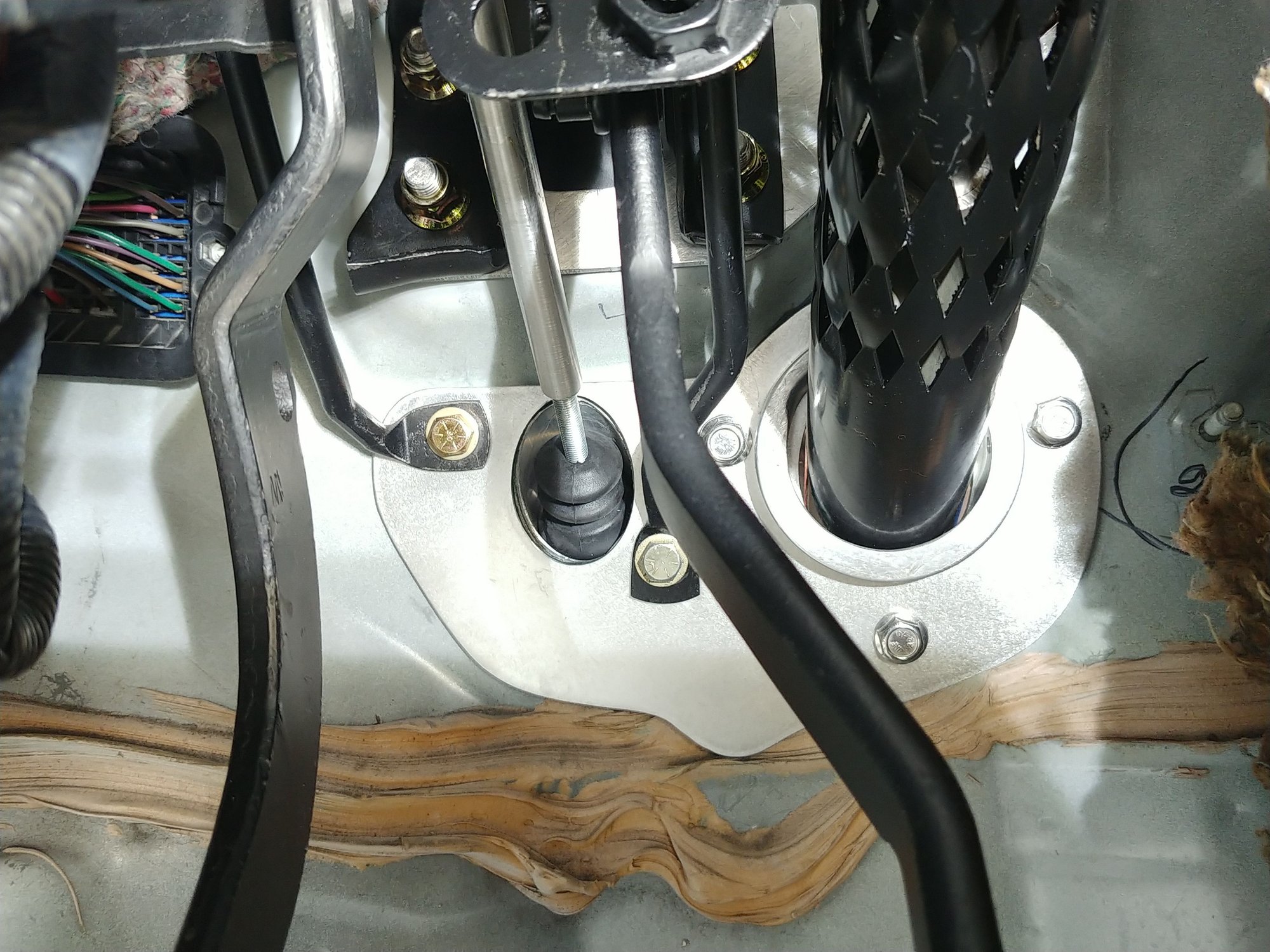

Prototype clutch master cylinder firewall braces.
The larger brace I made myself on my race car. Only difference is the plate is wider to block off the Cruise control grommet hole on my 92 RS

Awesome!!! keep up the good work your contributions to the community are inspiring. Any news on the clutch pin for 3rd gen pedals?
I will pick up a clutch brace if you go to production with them

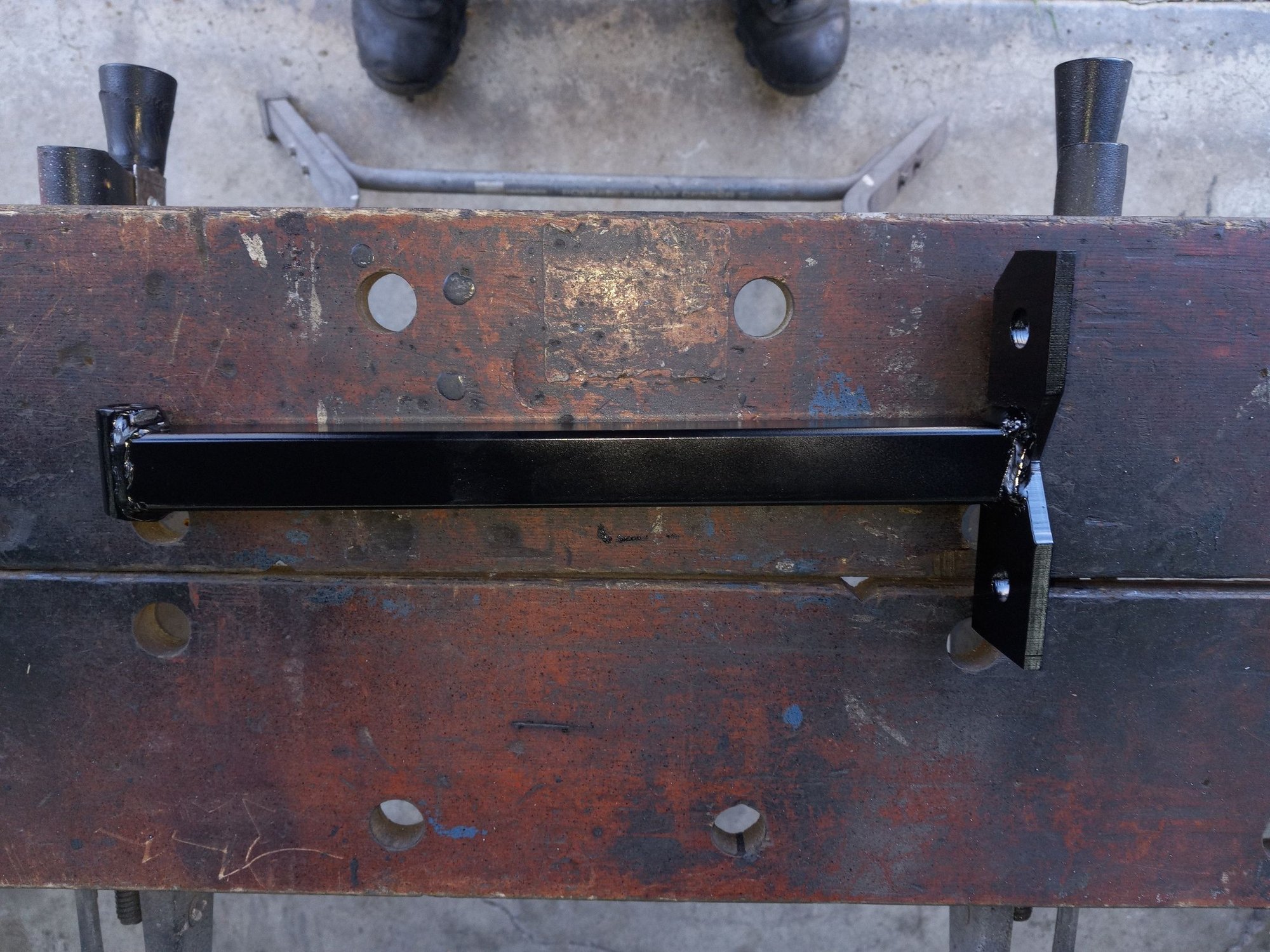

Here's what I made to hold the MC/firewall from flex.

How does it feel under foot Beeman?
Old Apr 19, 2024 | 12:23 PM
Beeman's Avatar
Joined: Nov 2009
Posts: 410
Likes: 50
Re: Master cylinder brace
I haven't driven it yet but I can stand and pump the brakes and watch the MC and it doesn't move at all, before I could see flex. My car has been run for decades without it with no real problem just never liked the flex. I'm sure it will give a little better pedal feel.
Sorry I never followed up. Brake pedal is solid as a rock now, no firewall flex or fear of the firewall cracking. Car is faster now and it feels good to have a very solid pedal.
