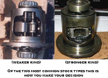

i seriously think most my problem is a need a posi in my car the open 3.42's are killen me pass. side tire always busts loose

well theres your problem right there...you need a posi...
i dont know of any single tire thatll hold a 388in motor
get a posi then launch again...

I have seen other cars with this nitrous problem one even went slower on the nitrous, higher MPH just like you too. get a posi you need to find out if you have a 28 spline axle (you might not) here is a link to SLP's $99 posi unit for a 26 spline axle they sell about the same price on ebay every day, get the "eaton" style with springs, instead of the racheting/paddle style. here is a search link that shows a bunch on ebay

after reading my post above use this as a visual guide to finding the kind of posi you want. both of these shown in the picture are available in 28 and 26 spline. this guide is for stock units only.
