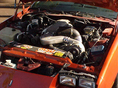

Is it possible to add a supercharger and keep my A/C?
Why wouldn't you be able to keep it?
My friend tells me its impossible on the 3rd gens....
Your friend doesn't know much.... If he doesn't know a simple thing as this, don't trust him on any other third gen issues. Come here and ask instead. We'll give you the straight scoop.
Attached Thumbnails can you supercharge a tpi-front-07-01-01

Actually, it has to be a serpentine setup because of Vortech's and ATI's design. You're lucky in this regard as you already have it. I wasn't so lucky. My '87 had v-belts and I had to convert before adding the D1SC kit.
Willie
