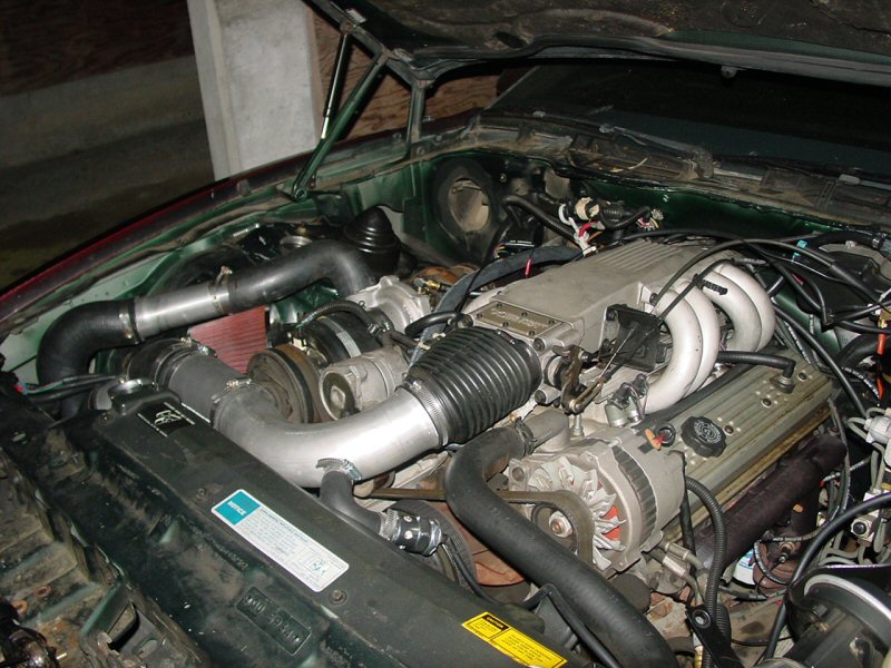

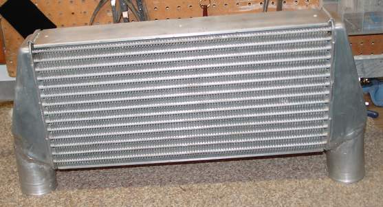

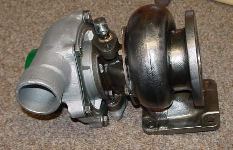

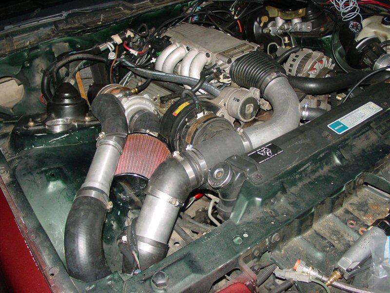

Of mine? Yeah, I do have some.
The T04B, freshly rebuilt
The intercooler
Driver side completed
Passenger side completed

Amorget, what kind of boost numbers are you getting with that t04b? Im getting a turbo with very similar flow charachteristics to a t04b, and am pretty curious. Unfortunatley at the moment, I dont have the A/R... will wednsday or thursday though!

I had the wastegate set for 5 psi because I never got a chance to really tune the motor. However, it made 5 psi at like 2500 RPMs. I have no doubt it could make 15. That was also with some pretty serious exhaust leaks.

Is the intercooler mounted in front of the radiator. Why both pipes to the intercooler on the same side. Any more pictures?
The reason I mounted the intercooler where I did was because I deemed it the best place to mount it. I found it to be rather effectice as it never seemed to heat up. I don't want it right next to the rad because then it would just transfer heat, and there really isn't much space to put it anywhere else.
Reason for both pipes on the same side was that I did not want to relocate my battery as if I take it to the track NHRA rules require a cut off switch, which is kinda a PITA on most street cars. I just had to relocate the charcol canister and the coolant overflow tank.
