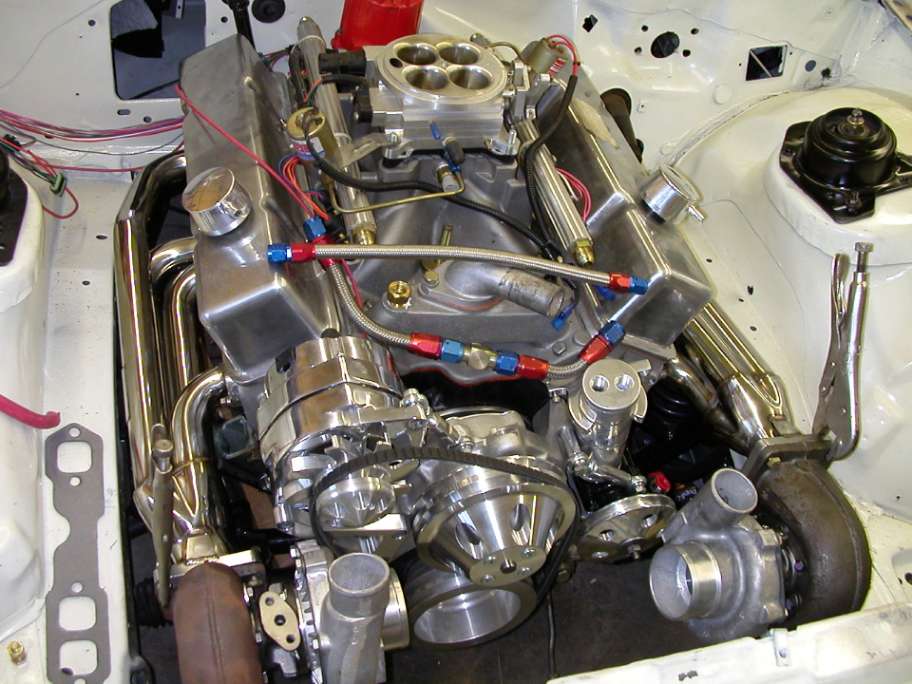

Chris, if I were buying either the B&G or SSAC headers, one of my main concerns would be routing for the downpipe(s), particularly on the LH side where the DP would need to fit down between the steering shaft and exhaust manifold primary tubes. It looks to me like B&G made a bend in the #7 primary at just the right spot to sneak in a 2.5" DP (which would be fine), but I'm a little confused by the turbine outlet they fabbed up in this pic:
Where were they going with that pipe? It looks to me like they would need to do a sharp bend right out of the turbo and go down under the #7 primary. I really like those headers best of all, but I wouldn't mind seeing some installed pics to see what they have planned for the rest of the hot plumbing.
I don't even know what the SSAC headers would use for a DP- I'm assuming the DP would route back under the headers, just over the crossmember? Even that would require some creative plumbing judging from the pics.
I know in my car, the LH DP fit very tight, even with the compact stock manifolds. It required a hard downward bend right out of the turbine to clear the brake booster, then I had to 'massage' it (read hammer flat) to fit between the manifold and steering shaft (I used 2.25" DPs). Here is a photo: (notice easy access to all the plugs without pulling the DP off)
http://www.cecoatings.com/images/oth...ystem%2052.jpg
The brake lines and combo valve had to be repositioned to clear my exhaust plumbing. Not a real big deal, but an issue none-the-less.
I'm not trying to be negative here, I just wanted to express my concern so that you guys can address it once you break out the band saw and the welder. Maybe there is more room there than the pics are showing. I would love to see some of these headers bolted up in person, just to get a feel for how clearances would be with all the accessories.

i said twins because of the downpipe size 2 3 inch pipes are alot easier to run than a single 4 in the engine bay of these cars. I've already figured out how i want to mount my intercoolers. I've already routed everything but the downpipes because i have to figure out how these headers fit the turbo's. And what's it matter if i want twins instead of a single? I'm keeping the air conditioning in my car. I don't have a ****load of space for this monster single turbo. Plus I'm only planning on running 10 - 12lbs of boost . Which can easily be done just for top end. My engine is a torque monster on the lower end. The only thing i dont have figured out on the car is the EFI that I'm going to use.
Also what relevance does it have if i want twins? He asked about several different headers if anyone was interested. But you had to run your mouth like a little kid. Geez your probably older than me and more immature
|end of rant|
i dont mean to be an ******* but i said nothing to be attacked for wanting twins.
Also I'm sorry TPI383 just its stupid to be attacked because I'd rather have 2 small turbo's instead of one huge one.
also to answer your question TPI383 i think the B&G setup might be easier to run but i'm up for it, or the ones similiar to ssautochrome or whatever.
who's car is that with the B&G setup? that's pretty much the same EFI I'm doing I'd love to see more pictures.
Start measuring, you’ll find that 2 3” pipes isn’t really easier. It can be done but not without compromising some or totally relocating some of the brake assembly, and even then there really isn’t a good way to run it under the car without loosing quite a bit of ground clearance (as if these cars have loads to spare). If you wanted to go all out, you could do it nicely with a relocated brake assembly (or go manual), sending the #7 primary tube in a big loop outwards towards the brakes and tucking the 3” DP between that primary and the head, then modifying the crossmember and/or oil pan to fit a 3” in the stock location… From there you have the same problems as with a 4” single.
The 4” single isn’t _that_ hard to do if you’re willing make some slight modifications to the front passenger side subframe where the exhaust passes through/around at the back/bottom of the firewall, or if you run solid bushings in the LCA’s so that you can run the down pipe right against it without fear of melting it. Or you can do a little cutting up a little higher and run the 4” like JoBy ran around his big block.
This was part of the reason that I originally asked about the DP size on Preston’s setup, looking at the pics for about the millionth time in this thread I could swear that he’s running a single 3” down pipe. And I know of at least 2 f-bodies cars running low 11’s with a single 2.75” down pipes. I think one of the early LT1 kits actually used a 2.5” down pipe. None of these are optimal, but it’s interesting “what you can get away with…”

from what I'm reading in the book "Turbochargers" who everyone says is a great starting point int turbos because the guy apparently knows what the hell he's talking about.
"Another decision to be made is whether to use one or two turbochargers. If the engine is a small in-line four, it is easy to decide on one turbocharger. Evan an in-line six looks good with one turbocharger unless the desired output is very high. When it comes to a V or oppsed engine, other factors must be considered. If one turbo is to be used, you have to pipe the exhaust gases from one side to the other, or at least join the two exhaust manifolds. Because the exhaust pipes get considerably hotter than the rest of the engine they expand more. Unless some sort of flexibility is built in, they will eventually crack and leak exhaust pressure. This is discussed in Chapter 15, page 108. Using two smaller units eliminates this exhaust-system problem because the turbocharger system needs to be connected only on the compressor side. It is often easier to fit two small turbochargers under the hood than one large one."
now i used 3 inch as an example because i havent decided on the turbos i am going to use. So i don't know what the discharge size is. Be it 2 - 3 inches.
Now can we stop the and try to get on with the group purchase. I myself am interested in all 3 kits. whichever gets the most i'm up for. I don't really care since i havent decided on my turbos anyway. And i can't fabricate my intercoolers until i figure out if im running twin or single.

i'll probably end up running a single as my budget is dwindling. So I'm with ya z28***** sorry for all that, I just figured 2 smaller turbos would be easier to find room to mount than a single large one. But if I relocate the battery I've got all kinds of room. I was thinking you could run the downpipes sorta like the stock exhaust routing, maybe i was wrong. Either way a large turbo that can deliver 10 - 15 lbs is good for me. I dont care about spool time as my engine is built for low end anyway and it's already all forged internals.
One question though on the pictures in your first post how does the passenger side header hook up with the crossover before the inlet? i'm guessing it runs behind the motor mount? How does that clear the k-member?

Originally posted by Steven89Iroc
On that note, how hard would it actually be to make a crossover adapter for a single with those?
Similar to this....
What got me around to doing this is I was sopost to get my kit from B&G back in Feb. and havent got it yet. So I asked my buddy and he said NO PROBLEM. then he got to asking about others interest in em.
So I showed him Prestons,SSAUTOCHROME and B&G's
So the SSAUTO/B&G setup like this could be ran as single or twin.
Cross over pic's
http://www.cecoatings.com/images/oth...TurboCars/B&G/
