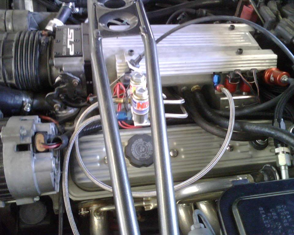

The threads in and out of the solenoid should be 1/8 NPT. As for the fuel rail the easiest way is to take the valve core out of the fitting for checking fuel pressure and use a -04AN to hook up to that.

CBR is right, normal solenoids (Nitrous and Fuel) have 1/8th NPT (national pipe threads). Both in and out. The schrader (sp?) valve on the TPI fuel rail is -4AN. So decore the valve and hook up a -4AN line from the valve to the solenoid (you'll need -4AN male to 1/8th NPT male fitting) on the "in". Most foggers have -3AN fittings. So you'll need a 1/8th NPT male to -3AN male and a -3AN line to the fogger....
