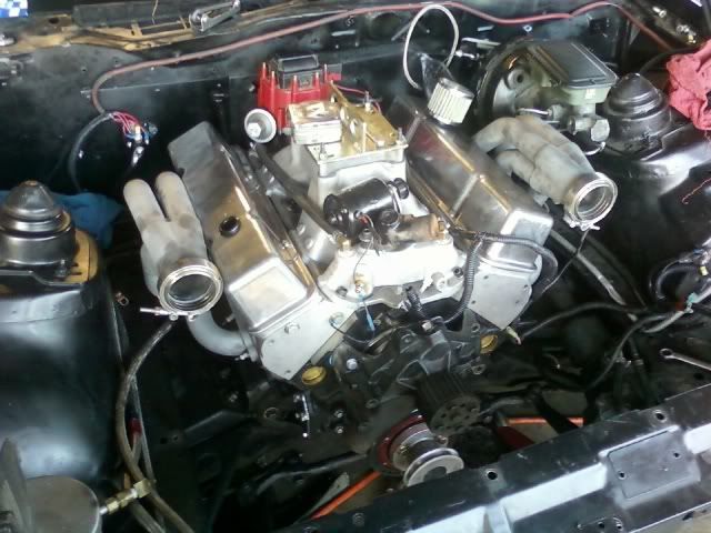

Headers you may want to consider are 10secondgoal's headers over at theturboforums... 600 bucks or so, forward facing, and clear a TGO
https://www.thirdgen.org/forums/powe...r-headers.html
posted a pic in there
Or you could buy my setup so I can get his headers and keep my turbos under the hood
I got a treadstone intercooler. Medium price range..not ebay cheap but not top of the line either. Seems to do well but I have no actual data to back that up. My motor handled 18psi in summer heat and heatsoaked motor on straight pump gas...so its got to be doin ok.

http://i161.photobucket.com/albums/t240/wild84/Turbo%20Motor%202010/IMG_9924.jpg $700
From looks of it, i suppose i need to cut my radiator support and relocate the radiator? Possibly down and toward the front bumper while still keeping room for the intercooler.

Well seeing the northeast got nailed by a nor'eastern in October!!! it pushed things back a few. Car was suppose to goto NY this weekend but was unable to.
Good update though :
Friday am ordering the Powermaster t76
Once my buddy gives me money for my headers, Y pipe, and the bird i will order these from 10secondgoal's http://i161.photobucket.com/albums/t240/wild84/Turbo%20Motor%202010/IMG_9924.jpg
According to the builder they will fit under the hood. Am worried about The alternator hitting the header, i have some issues with my serp setup as it sits ( being un-allighned ). Ill figure it out once i get to that point
Hopeing things will start taking shape soon. Worst case, if compression is too high ill sell heads and get a pair of AFR 76cc's and just take the few hundred hit rather then change pistons. Ill update once parts start arriving

Tomorrows d-day on ordering turbo. A turbo friend suggested I go with a precision 67mm turbo. Said 76 would lag for only wanting to make 650hp. Suggestions please before I order something
Posts: 25,896
Likes: 430
From: Pittsburgh PA
Car: 89 Iroc-z
Engine: 555 BBC Turbo
Transmission: TH400
Axle/Gears: MWC 9” 3.00
Re: Finally My 383 N/A buld turned turbo Part 2
It wouldnt lag with that compression... the precision may make 650hp but I still think a 70mm is minimum size for this motor. master power T76 likely a good option. .96 a/r Qtrim would work, but for 5-6psi, a .96 a/r T4 P trim could work just fine too.
Master power's dont flow like new tech compressor wheels that you can get from precision/garrett/etc...so need a slightly larger MP turbo compared to a precision/garrett.
67 probably could make 650hp but the MP is a bit more budgetary

Powermaster brand new never installed, t-76 .96ar shipped $640. This is looking to be the one

Engine compression, cam specs, stall speed, rear gears and turbo exhaust housing will dictate if you have any lag or not, not the actual size of compression side of the turbo, which is what your friend seems to be basing it on...
A 383 with that compression will light up a T76 easily, especially a P-trim T4 hotside. I'd run the Q trim tho for a single. I run the P trims on my car for twins for 350hp each side and will be shooting for 500hp each bank next year. P-trim is good for that size and power. Q-trim be much better for single in the 600hp range.
A t6 would be alittle more delayed on spool but still be workable on a hot 383. Alot of guys run S400 turbos which are 75mm with T6 hotsides. Works well on 383's.

Either way i ordered the turbo last night. It was on sale for $640 shipped. Couldnt pass up saving over $200.
Master Power T-76 P trim T4 .96a/r.
Delivered my firebird to my buddy today, waiting on payment for the car and my header Y pipe setup, then i will order headers from 10secgoal ( only 2 week wait ) rather then 2 months from dyno don. Slowly but surely its coming together
Never know, maybe i will TT my next motor build seeing the headers are made to do so :P

Found a bbs turbo kit for sale for $700. Kit includes
Turbo header
Crossover Pipe
Driver's side header
Boost gauge
Alcohol Injection kit
Downpipe
Pipe to connect downpipe to catback
All oil lines
Tubing to run from turbo to the intake
Intake duct for the turbo and filter
2-BAR MAP sensor
Turbonetics WasteGate
Anyone know or think if my Tall valve covers will be in the way of a bbs header? No biggy to change them but am curious. This is not setup for a intercooler but i am still planning on buying a kit. Waiting for the turbo to be delivered

BBS designs headers are nice for smaller hp builds but could be improved. I dont like wastegate location on those setups. Thats the first thing I'd do is modify that.
It may be enough header tho for 600-700 hp. Backpressure may be higher but it could work.
Mr. Jones got back to me today. Said cam is fine, spec's out with no advance when my cam card I believe said it had some advance ground in...so maybe thats why i didnt see it open and close when it should have. He's sending it back with new cam card.
