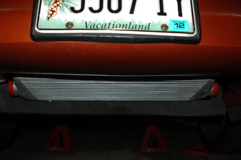

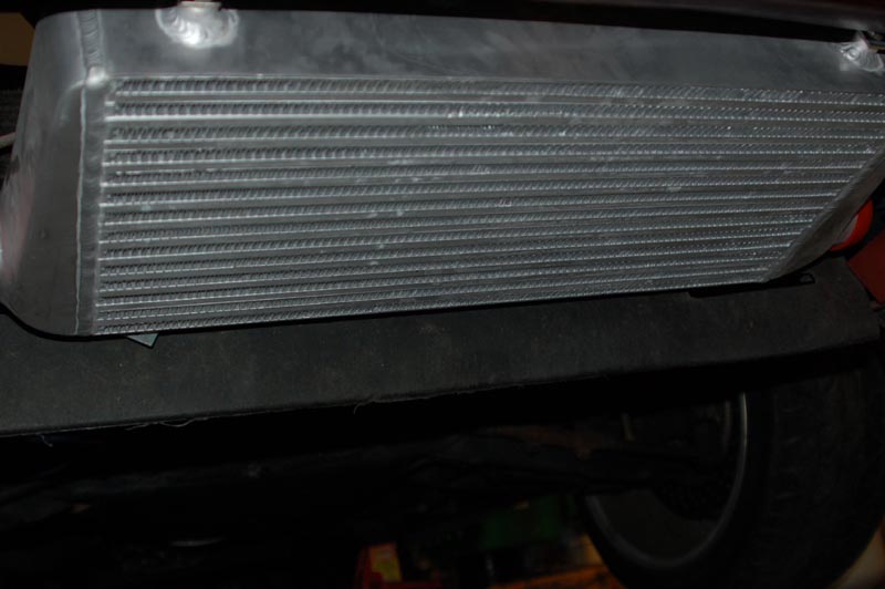

I have a '92 bird and I wanted to keep A/C and all the amenities, so I had to get a little creative with my IC mounting and plumbing. One downside was that I was a little limited in intercooler sizing. I mounted my intercooler horizontally between the core support and the front bumper bar. It is in front of the factory air dam so air will flow through the intercooler and then through the condenser and radiator in the same fashion that the factory intended.
The turbo sits in the right side battery tray area in this setup (single turbo setup vs your twins). The charge piping runs right down to the IC and then from the IC up inside the left front fender, over the battery (relocated to the left side and scooted closer to the radiator than the factory tray places it).
So far it has worked well for me. I may install some small fans on the intercooler at some point so that I can draw air across it when I'm in the staging lanes at the track, but I don't run it at the track very often hahaha!

Interesting mounting Quad. I wonder how much air gets directed through th radiator and not pushed under the car?? Maybe hook up a NOS spray bar infrint of the cooler and spray it just before you leave.

Roughly the same amount of air that is diverted to the radiator in a totally stock setup I expect. Running down the road the car runs as cool (or cooler) than it did before the turbo setup. It will get a little warmer in traffic with the A/C on than it did before (220 is the highest I've seen iirc). I've got dual fans from an LT-1 f-body mounted up with a Be Cool aluminum radiator. I'm sure the intercooler blocks a little airflow, but it doesn't seem to do much harm. The 'birds are completely "bottom feeders" in that they get virtually all their cooling air from underneath the vehicle since there isn't much for airflow through the front bumper. This can make cooling system engineering/upgrades challenging lol!
