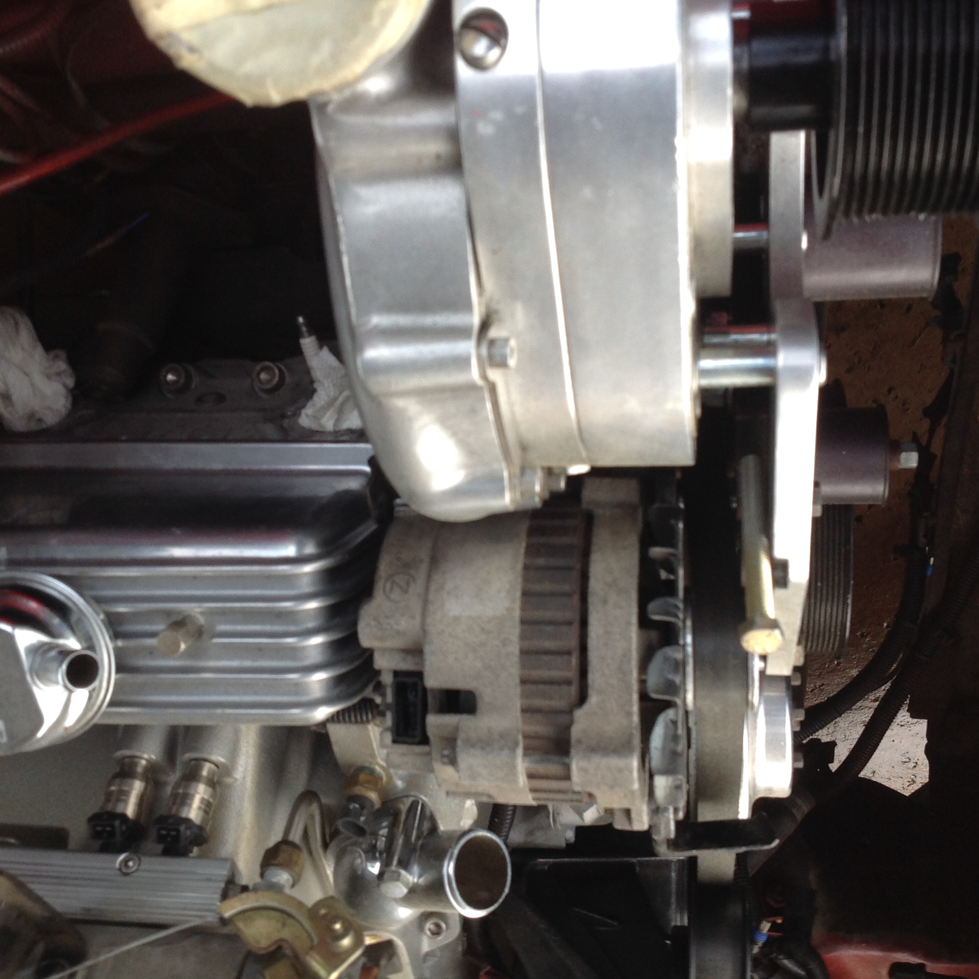

Re: D1SC 8 to 12 rib worth it?
I noticed that most of y'all have bracket that runs from the top of the supercharger bracket to define the alternator. Mine doesn't have this feature. Do you know if this will be a problem with out the extra support?

It does help to have it on there, anything to firm up the main blower plate the better. I did run without it for a few years but I also had a custom bracket holding it on the bottom. You should still be able to buy the bracket separate.
My plate does have the holes for the bracket. I will probably just drill it to fit the bracket.

I'm considering making the move for 8rib to 12 rib. Reason for making the switch is with my current 8 rib set up I can run 13 to 14 pounds of boost without the belt slipping. If I push it harder, say 17 to 18 pounds of boost then I start getting a ton a belt dust (3.70 blower pulley). I'm currently working on getting pricing on the pulleys. I currently have a dayco spring tensioner on my setup, similar to Tony's set up. The pulley that came on the tensioner is currently 1 3/4" wide which wont work for a 12 rib belt that is 2 1/4" wide. Tony do you know what pulley would be needed to support 2 1/4" wide belt? My other issue is space, I've already notched out a section of my aftermarket fan to get everything to fit. Who else has made the 8rib to 12rib switch?
Attached Thumbnails D1SC 8 to 12 rib worth it?-20160503_100753.jpg   D1SC 8 to 12 rib worth it?-20160503_100825.jpg   D1SC 8 to 12 rib worth it?-20160503_100956.jpg

I used this one for my tensioner setup, Dayco 89102 46mm wide pulley.
Thanks Tony.
