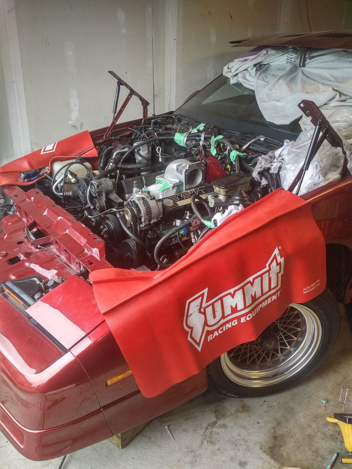

Hi everyone,
I have had a good time reading the threads and stories about the boosted builds here, learning a lot, and getting the itch.... it has been a good while since I have done anything major to the car, and I'm getting bored, so I think I'm going to boost the sbc and have some fun, and I am looking for some advice during the planning and building stage. This will be going forward in the next few weeks if all goes well!
Some may remember the build a few years ago. Here is the link to the thread if anyone is interested in the progression of the actual build.
https://www.thirdgen.org/forums/engi...195-383-a.html
To sum it up, its nothing major and is just a typical forged stroker build, a bit on the mild side, and I do think back wishing I had gone a slightly different route, but It is what it is now and the engine is holding up very well to a few years of street and strip fun, and I think it still has some life left in it, so its time to boost.
The car dyno'd on a mustang unit at 320rwhp through the automatic, haven't had it on the dyno since. Has run a best of 12.7 at 110mph(auto) and 12.7 110 (stick) . Launching with the t56 on Et Streets is no easy feat, and I couldn't get any better than 2.0 60ft, while the auto got me there in 1.75 every time. I have since added SW long tubes which I feel free-d up a few ponies and I will confirm it with a few pulls on the dyno this week.
Getting on to the nitty gritty , and some issues that concern me. First, a few specs:
383
comp 10.17:1
195 afr 195 75cc milled .0300 (prob about 70cc now)
228/228@.50" LC 112
FIRST long tube intake
EBL ecm
42lbs injectors
stock distributor
t56
SW long tubes
3.73 diff ratio
forged bottom
Concerns
1.
Higher than ideal compression ratio. Should I consider removing the heads and installing a boost ready, and thicker gasket? Also good time to inspect the piston tops after years of novice tuning and fun. I can drop the comp ratio to about 9.73:1 with a .060 gasket.
My cranking compression is also on the high side @ 195psi, dynamic compression seems high as well at 9.21:1.
I have considered retarding the cam a couple degrees to try and bleed of some the pressure, would this be a wise move?
2:
Timing issues. Ever since installing the engine in my car, I haven't been able to get the engine to take anymore than 26-27 degrees of advance. Stranger thing is... on the engine stand/dyno at build time , with a victor junior/carb set up, the engine took a full 32 degrees, drop the FIRST on it and efi, and it wont take more than 27. Perhaps I'm dumb and cant install the dizzy in the proper location? I have had it out and in on 5 separate occasions with the same results. I am more inclined to blame the intake for some odd reason...... Thoughts? Could be another good reason to retard the cam or go for a completely new grind? idk.
I have considered this single plane intake with an elbow and LS style TB.
http://www.promracing.com/parts-acce...-manifold.html
Not sure if its worth the work considering I am boosting anyway, but I do have to figure something out to control this timing/compression issue. Not sure the best approach for that, and what I should look for to be causing the problem?
As far as the supercharger goes , I have one lined up already, just a matter of pulling the trigger, just based on reviews and what I have seen and read, the Procharger is going to be the best one for me, Its the only brand with brackets and braces readily available, and I don't have time or machinery to fab one up, I need it to be install ready. going with a D1SC and just the 8 rib (due to clearance issues) system for now and see how it goes.
I am trying for 6-8 psi of boost, can I do it??
Anything advice that would benefit this build would be appreciated.
Thanks

Throw the thicker gasket on and it will handle 6-8 psi. Just pull timing, back it off alot at first and creep up on it
Verify with a light ur chip tune matches what you see at the balancer. Run a 7 heat range plug
Afr are sensitive on timing. I'd start with 12 deg out on 6 psi to be safe
A single plane with an elbow, a miniram, etc would be a fine choice for a blown application. You'll pick up 50+hp just by losing that intake. I picked up 10mph in the 1/4 in back to back testing.
As far as running a blower, you need to get that compression down to around 9:1.
If someone tells you that you will be fine, make sure they are willing to buy you a new motor when you detonate.
-- Joe

Your cam is way too small for that static compression ratio, which is why you can't run too much advance.
-- Joe
-- Joe
I was afraid that my cam was too small since day one. I can drop compression down to 9.7 with a head gasket change, my heads are milled 75 cc, so I'm stuck, and cant bring it down any further without a piston swap. Do you not think closing the intake valve later by retarding the cam would be enough to bleed off some compression to make it safer? I am also considering meth/water inj, as well as a intercooler. I was really hoping to get something working here without puling the engine apart.
As for the intake, definitely agree that a single plane would work great on this combo, and would free up some space, but was planning that swap for stage 2 of my boosting project, but i could do it now since I'm gathering parts......... hmmmm. This may be more work than i anticipated, as always!
I am also not counting out a cam swap, but that still doesn't fix my compression issue.
This is the intake I am considering , along with the othe most common single plain.

Hey,
All done, finally!
I pretty much just got it done this past weekend, it was a long , slow build due to the typical issues , and of course this thing called running a business..
Anyways, to summarize the build, her are some more details.
I did decide to switch out the FIRST intake. Yes I know the FIRST lovers are crying right now, especially considering this started off as a FIRST build and SC project, unfortunately, I had enough of the intake, and its tb, I just felt like it was time for a drastic change since I was tearing into the engine.
I ended up going with the Edelbrock set up. Here were my changes:
-Victor junior E
-3848 edelbrock elbow
-3869 edelbrock LS2 Throttle body
-224/230 114ls cam
-62lbs injectors
-compression drop to 9:1
-D1SC/ intercooler
-self rebuilt/upgrade t56....
I ended up going with a thicker head gasket that allowed me to drop my comp down to 9:1. Yes, i removed my quench zone completely, actually, i killed it, which seems to make a big difference in battling detonation issues and quench zones being borderline or just out of the optimal zone, by running a huge gap, it looks like i am safe .....so far. I did run the engine for 2-3 weeks naturally aspirated just to work out the bugs and get things in line before boosting, I went up to 34 degrees timing with zero knocks, and today for the first time ran 6-7 psi of boost with zero detonation, things seems to be going good , so far, so good! I ran into wideband issues, so stopped the tuning early today which sucked bad with cool, clean air........tomorrow.
Regarding the intake swap. The verdict is still out on the single plane over the FIRST. Like I said, running NA for the last couple weeks skews the results, but as it is right now, i do definitely miss the low and mid range pull of the FIRST, it was an absolute blast to drive on the streets, but the lack of rpm was starting to bore me .
Running the single plane with no comp isnt a fair trial, but as i added the boost into the engine today, i feel like this set up is really starting to work, nothing like the sound and feel of a screaming sbc under boost!
Onto the fitment issues. I ended up with a 1" spacer under the elbow to give me a spot to port some vacuum lines into , as well as to clear the fuel rail. This intake/elbow combo is definitely not Firebird/trans am friendly, I maxed out the under hood clearance, and i mean maxed out, to the point that i am considering a cowl style hood if i keep this combo around for long, I really want to turn the elbow around, but there is no way with the factory hood, idk what to do, will see after this season, might be time for a miniram......
I look forward to continuing to improve this combo, but i will admit it was a lot of work (as are most), but it is finally starting to come along nicely. My efforts were multiplied by tranny issues and clutch problems when i reinstalled my newly rebuilt by CENTERFORCE DFX, which has been a royal PITA since day one, after 3 "in and outs" im done with it and just reinstalled my df centerforce which has been flawless. I do have a Mcleod twin disk/ aluminum flywheel combo to drop in if i burn this clutch up this summer, if not, i will do it over the winter, i just want to drive the car for now.
Look forward to dialing this combo in, going to be fun!
My one issue coming up soon might be fuel delivery issues, i am only running the Walbro 255lph. I will have to wait and see how it goes while i dial it in some, i think im ok for 6-8 lbs, might be an issue for 10-12lbs.
Here is a pic of my tight engine bay.. Plumbing is still half fast, but i will clean it up as i go along , i want to weld most of it together once i know it works.
