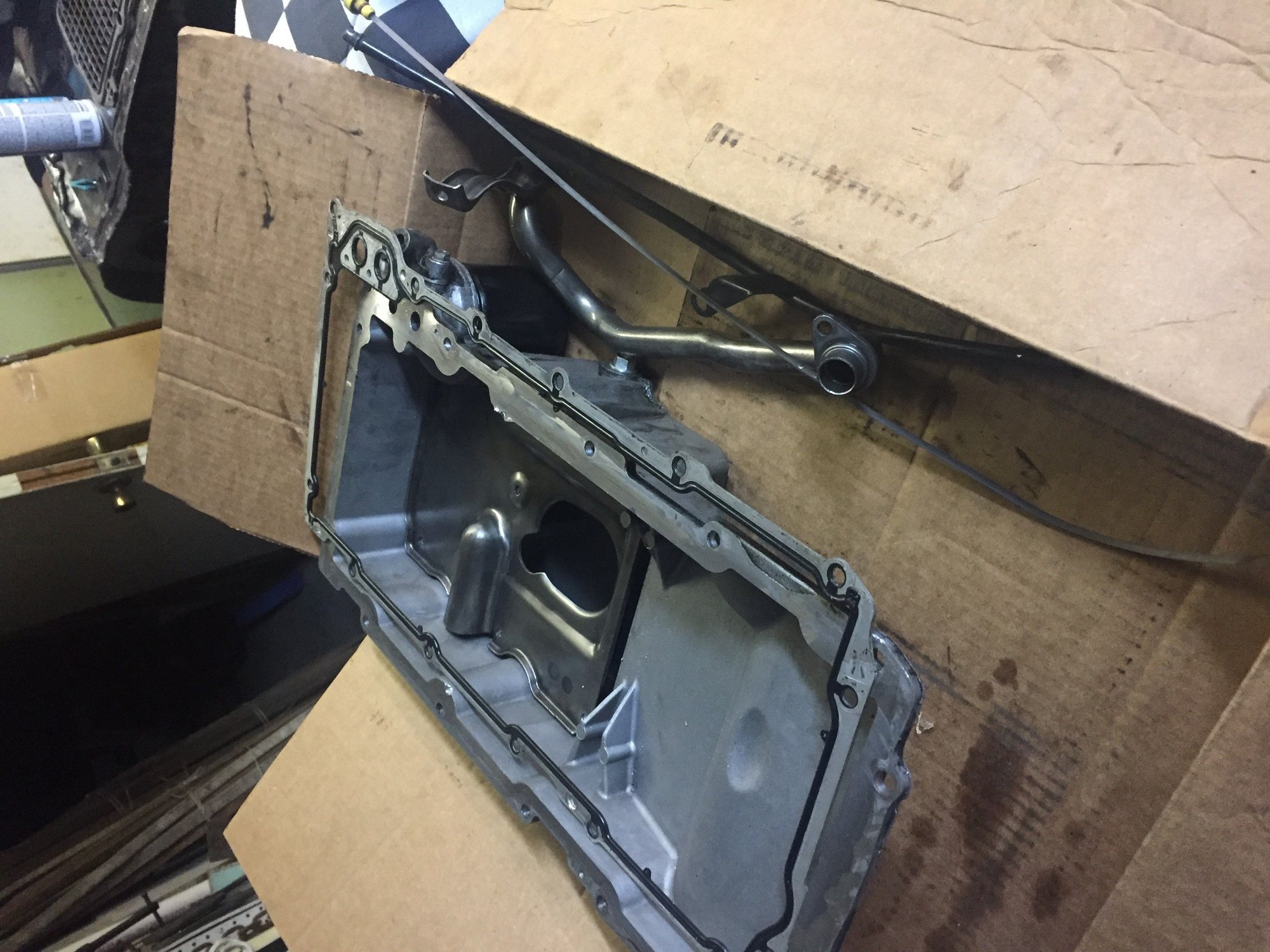

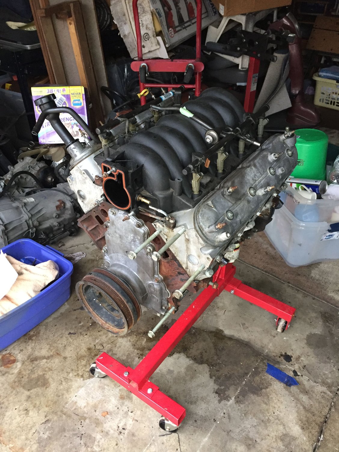

Well here is the pan, pick up tube, dipstick, and dipstick tube I picked up last night. Also came with a basically brand new gasket. Came out of a LS1 swapped FD RX7... haha.
Everything needs a good cleaning. He ended up starving the engine of oil by accident and it led to catastrophic destruction...
Not a bad score for $50! All that is left to buy is the windage tray which is $20. His was... destroyed lol.

Great find man. I planned on running my 4.8 til I found a 6.0(staying naturally aspirated) to throw in but I'm gonna be watching this to see how it goes. Might just rebuild and turbo if the cost isn't too big.

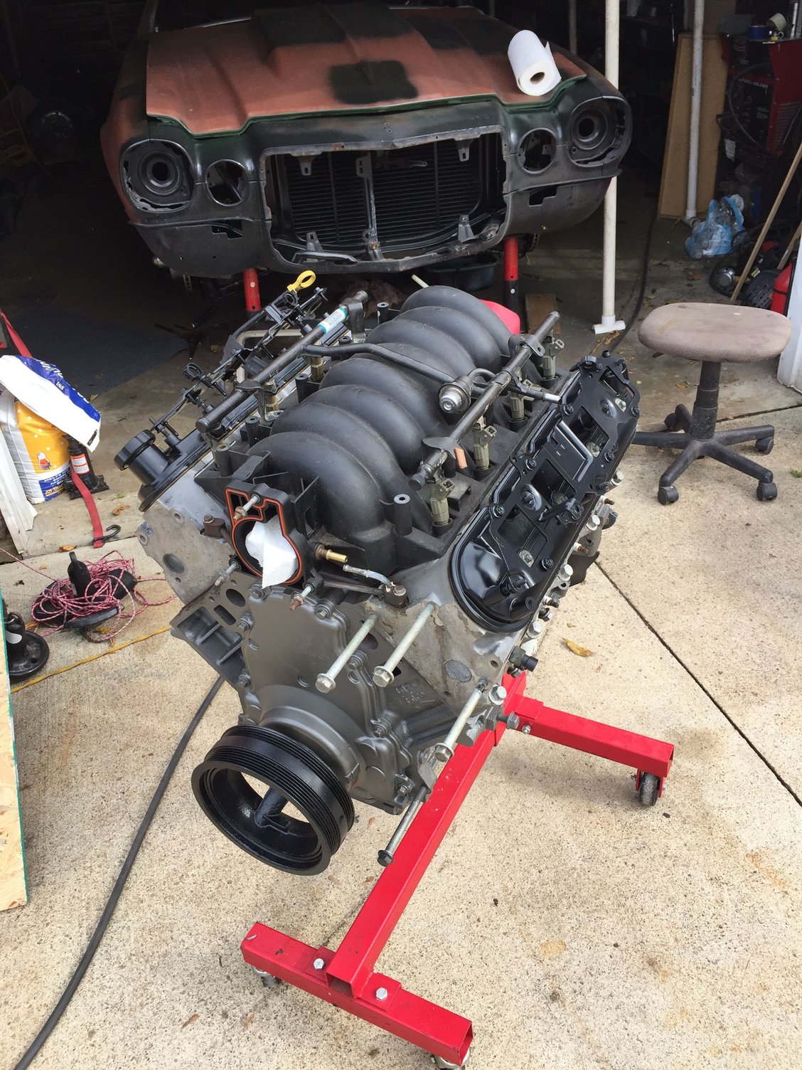

Sourced a LS1 Intake with LS6 rail and injectors for $100 from a friend, and then an FBody water pump for free from another friend! Can't beat that... haha
Hopefully cleaning up the engine this week and mocking stuff up in order to drop it in after I pull the V6. I want everything ready to go from the motor mounts to the bellhousing bolts. After the engine is in I can worry about wiring and mocking up / building the turbo kit.

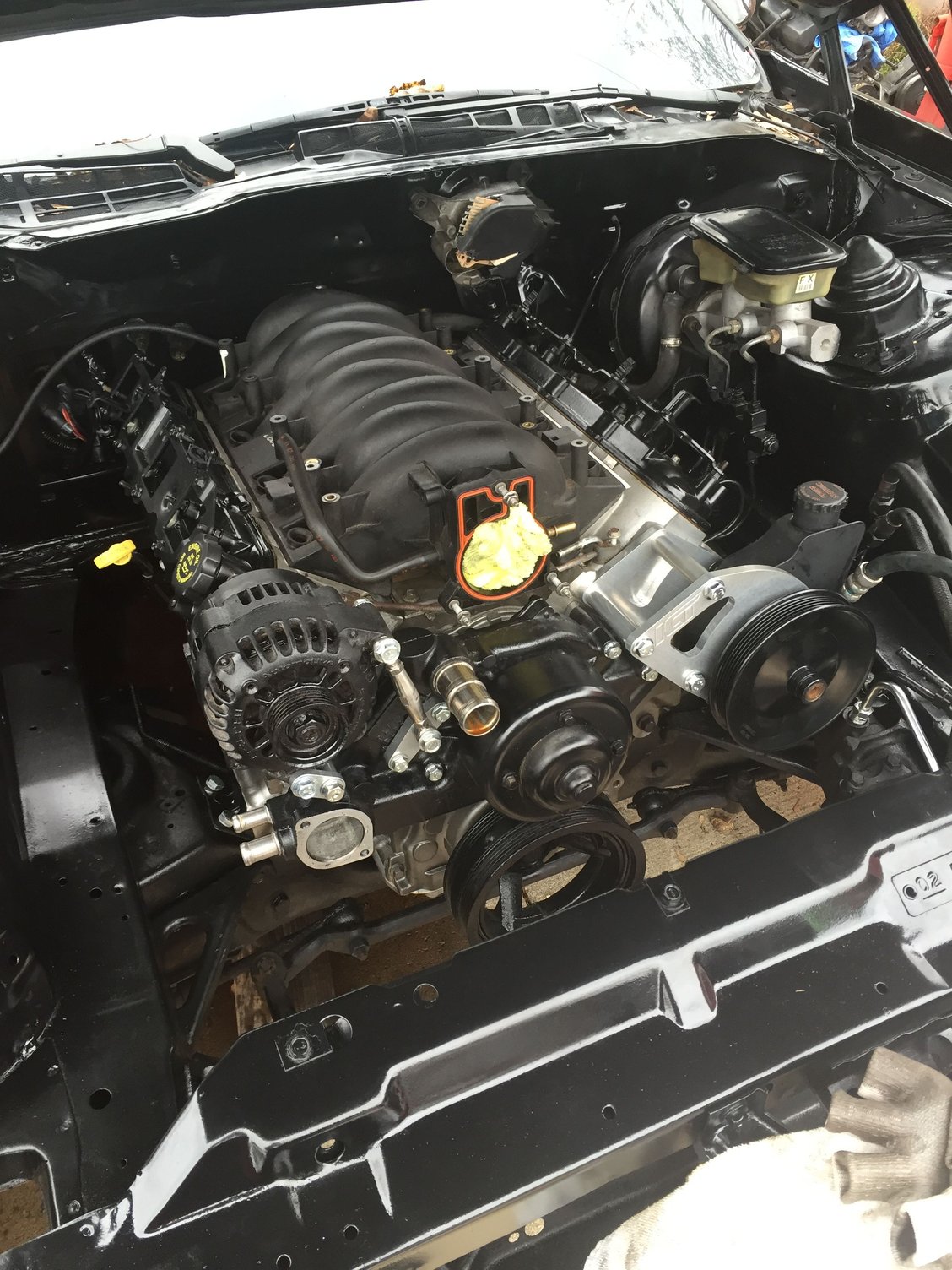

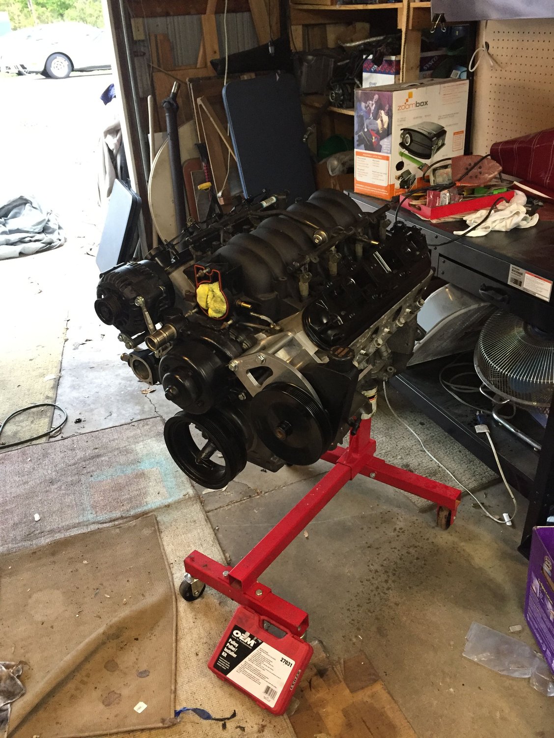

Just a little update picture! Ordering bolts and gaskets this week to start assembly. Not going to bother taking off the heads at all. I popped off the valve covers and everything looked good. I'll have some ls6 injectors for sale here soon as they are way to small for what I'm doing.

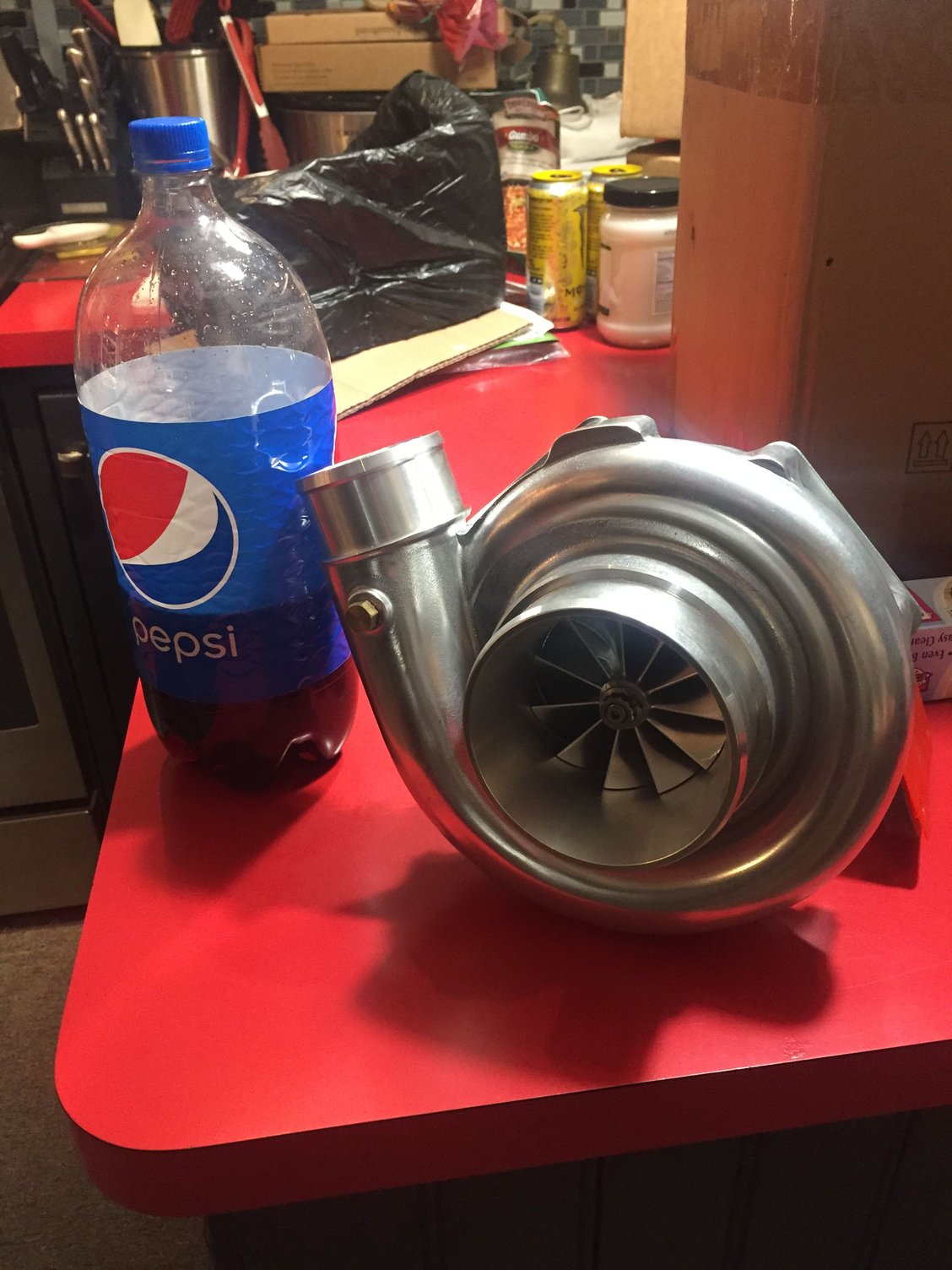

Alright, I have a few questions.
Should I skip the GT45 and look at something smaller in that price range? Would a T70 be to small? Honestly, I'm uneducated on what would be the perfect fit. As a street car I'm looking for a quick spool on the street and an easy 450-500 wheel horsepower.

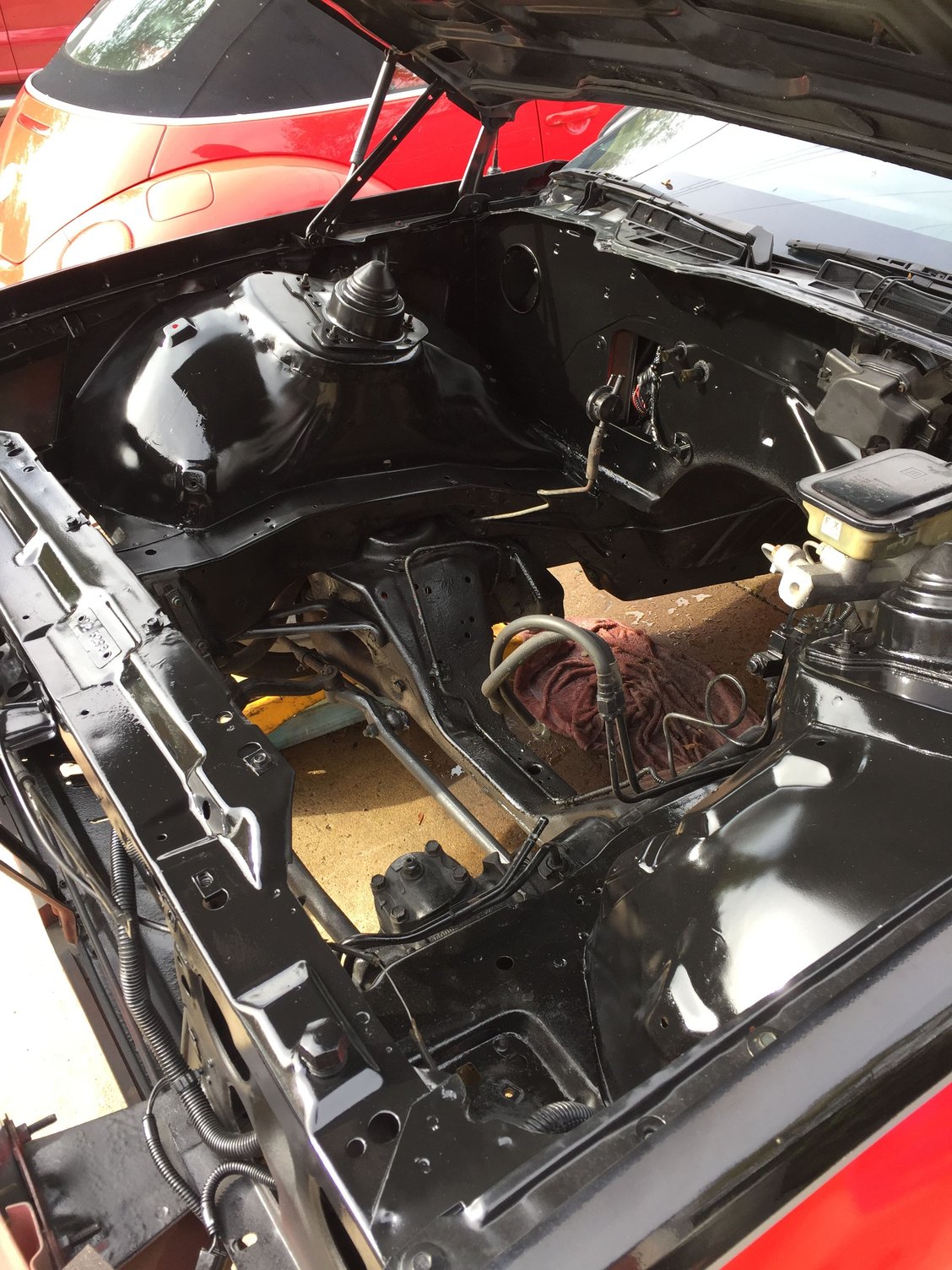

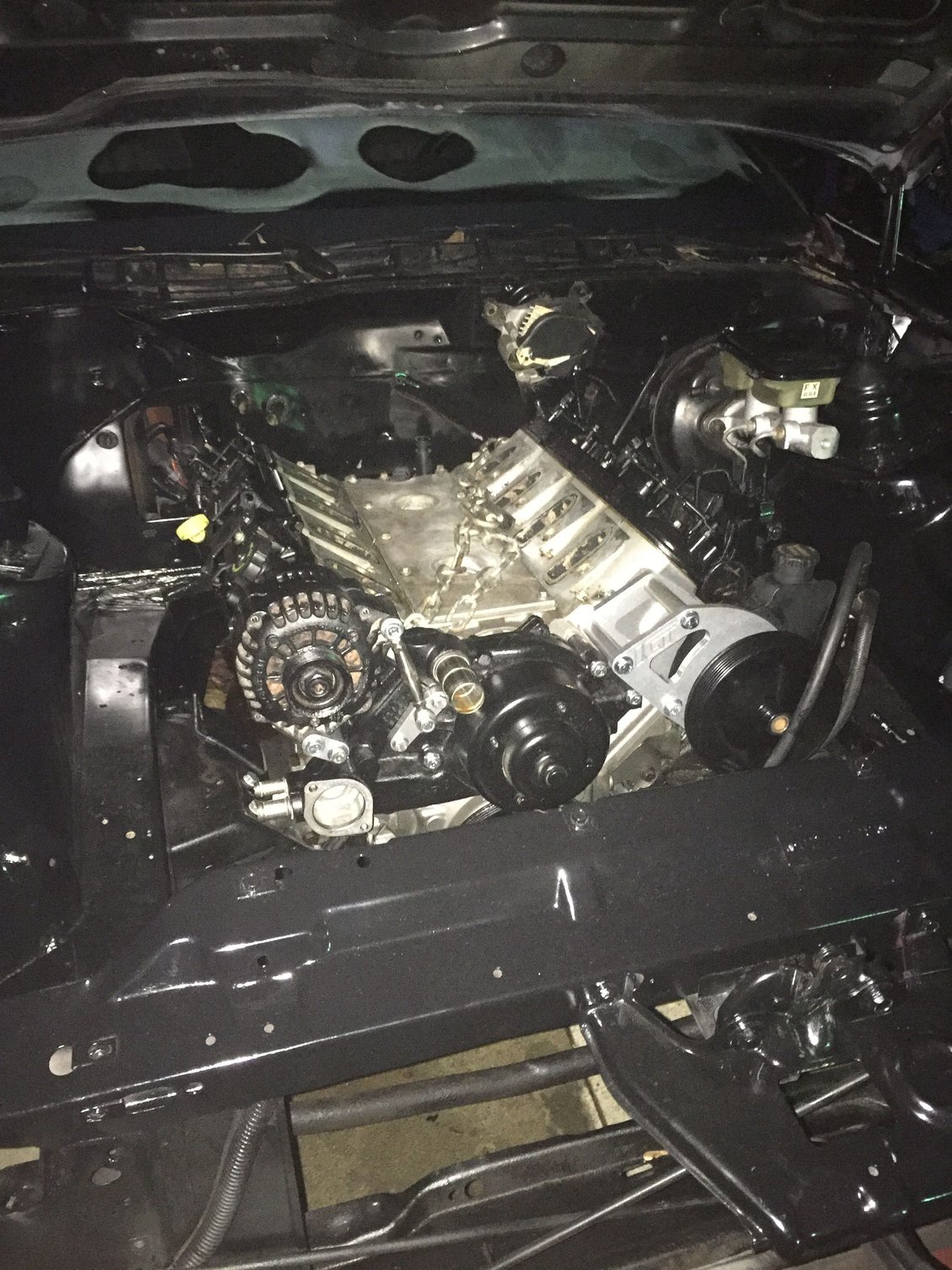

Well here are some update pictures! Ordering the stuff to drop the engine in next weekend. Hopefully all goes as planned. If anyone has a 4l60e cross member I'm entertaining buying one.
Picked up the VS Racing billet 7875! So pretty. Painted the engine bay, removed v6 mounts, and removed a broken exhaust bolt as well.

Items Bought:
VS Racing 7875 Turbo $280

Got the engine all finished up. Not to shabby if I say so myself. The power steering and alternator brackets were extremely well done. Very happy with the outcome, should leave me with a lot of room under for building the crossover. Plan is to modify the truck manifolds, but need to decide if I want to do the drivers or passenger side.

Looks great. I might have to go with that alt/power steering set up. Cheaper than buying f body accessories.
1 perrdy motor there. Looking nice john!

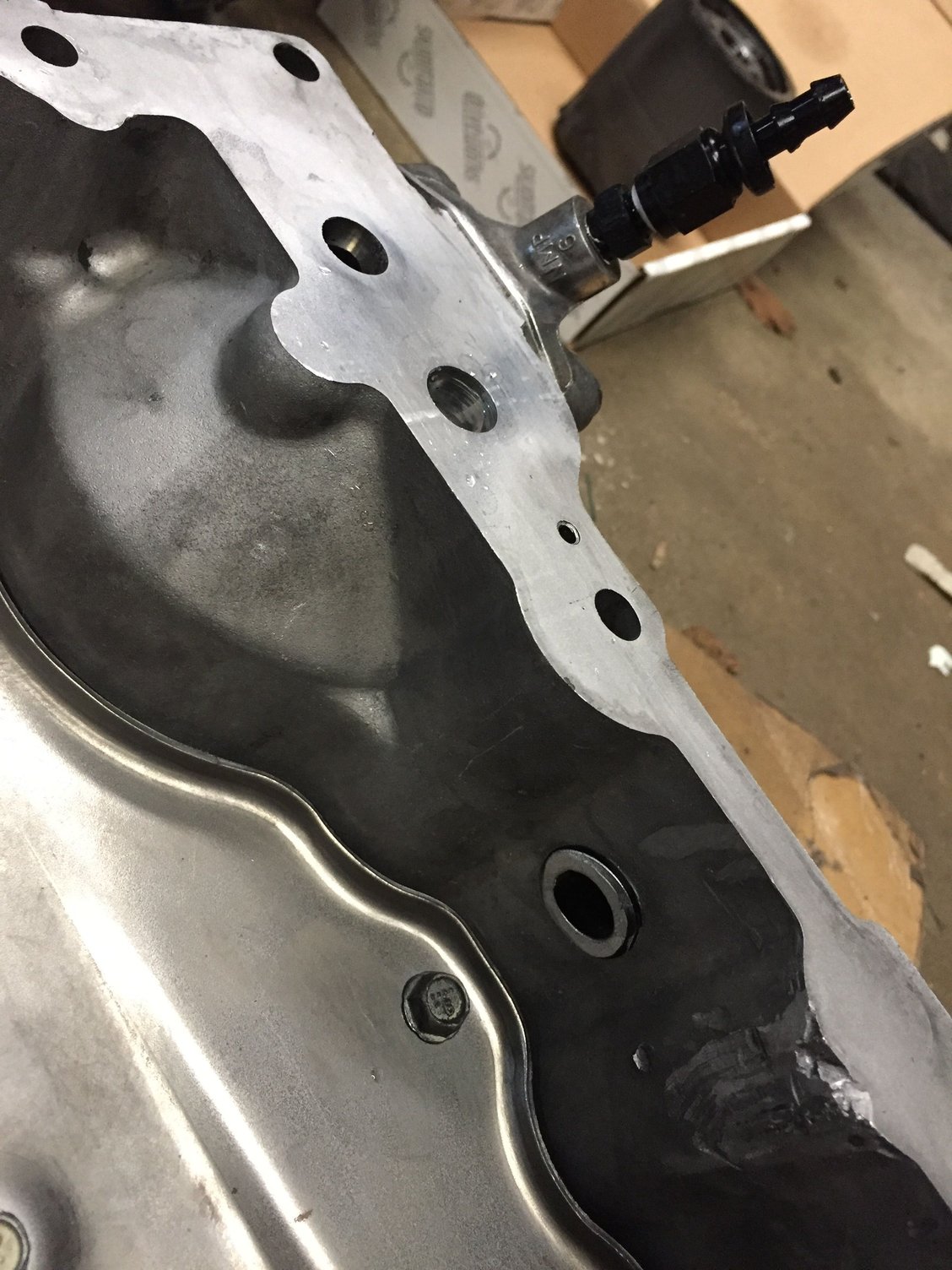

Thanks guys! I modified the oil pan today for the drain and feed. Here are some pictures:
- 10 AN Drain and a - 4 AN Feed

Learned the ICT Billet GT42 Flange will not work with the VSR 7875. Also, even though it is the right spacing for the oil pan feed, it draws oil from the middle. Hence, it will not work there either.
Hey man I am jealous lol. That engine looks fantastic. Good job!

Well, engine and trans are in! Did it together to save a few steps. Took a total of 3 hours to combine and drop it all in. Not to shabby for my first LS swap! Ran into a few issues but nothing that couldn't be handled.
Gotta modify the crossmember for the 4L60e, then put the car in the garage. Time to to start fabricating the turbo headers!

Nice! Looks right at home in there.
