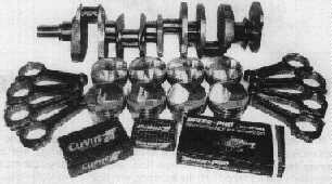

Sup guys my project is moving a little slower than expected but its moving. My question is I have a chevy 400 block and I want to order the bill mitchell stroker kit from summit to make it a 427. the question I have is I have a holley 144 blower and I want to put a 150 shot of juice with it. What compression should I run I was thinkin 8.5-9:1 would that be good or too high? another question is what heads should I go with. I was lookin at the dart heads wih a 230 cc intake runner 64 or 72 cc combustion chamber not sure yet would these heads be good? I was thinkin that since I am supercharging I wanna flow as much air as possible what do oyu guys think???
