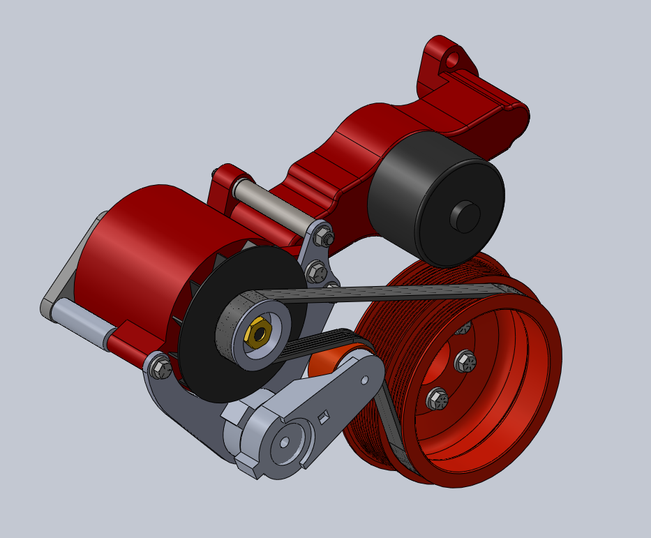

Designed a new pulley for my BBC F-1R setup
I designed a new pulley for my BBC Procharger F-1R setup. It has a 6 bolt pattern instead of 3, a thicker hub to spread the load and use the unthreaded portion of bolts instead of riding on the threads, and a 6 rib pulley on the front for accessories instead of a v belt. I got the largest pulley I could find for the alternator and went for about a 2.6:1 ratio to spin the alternator faster at idle while still keeping it <= 18000 at redline. The alternator pulley is 62mm, Delco 10477425. The Procharger single v-belt setup had a decently sized alternator pulley, but the ratio was around 1.9:1 and the v-belt understandably couldn't handle the CS-140 alternator. More pictures to follow when I get it bolted on and find the right belt length!

Bad ***! Nice work. Looking forward to some more pics

Sweet! You do this for work everyday? I need a crank pulley made for my setup....

that looks fantastic. i wish i could do the cad type stuffs....

Pics of the blower?
