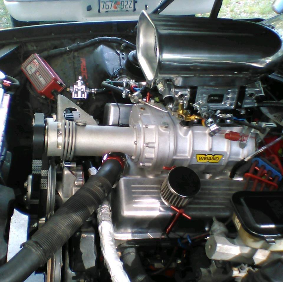

I ran a 142 on an 11.4:1 small block. Was a lot of fun.
Make sure to order it through summit, etc, because holley/weiand will jerk you off for months and months. Always behind and waiting on one more part.
