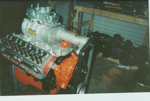

im running a 350 blower motor here are the specs just wondering how much hp it will make.
350 bored .030 over
wiend 142 supercharger with 8-9lbs of boost
trick flow 23 degree heads 72cc chambers
cam: duration at .050 int:234 exh:244, lift int:488 exh:510, 114 seperation
pistons 21cc d-cup
speed deamon 750
msd distributer box and coil
hooker super comp headers with 4 inch mufflex
