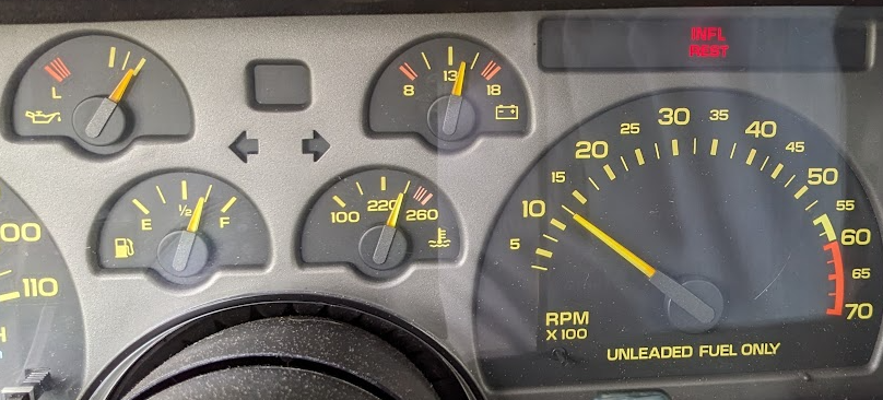

I have a 92 RS with a V6 engine and 5 speed transmission. I noticed that when the car is stationary or I am stuck in traffic, the engine temperature will just climb but the fan will not engage. I did some tests in my driveway and yes, the fan will not turn on when the car is stationary. The moment, I put the car in gear and start moving (even slowly) the fan kicks in. Is this normal? Looking at the temperature gauge, I don't think so and the temperature reading worries me. I have already changed both coolant temperature sensors but that didn't do anything.
Here is what the gauges look like when the car was idling in my driveway for about 10-15 mins. I know my idling RPMs are a bit high but so far, I haven't found why is it like that.

That fan situation is odd and wrong...I do not know anything about late v6 fan control. Check the RPM with another tach- the ,90 up tachs often read high when they get old- a resistor or other part degrades and can be replaced to correct the wrong reading.

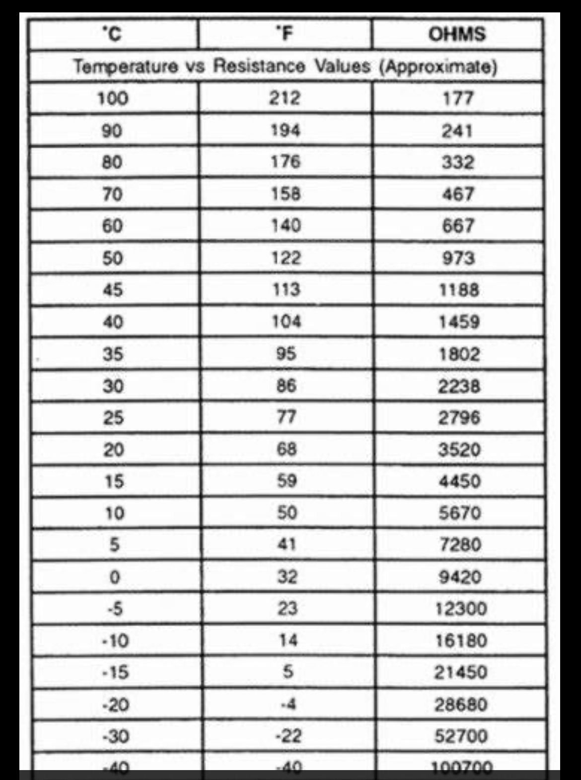

I would assume the cts is giving a reading i didn’t see a mention of code 15.
you can ohm the cts and refer to this chart to see coolant temperature if you don’t have a scanner. Primary fan will kick on at 226.4 based on the computers calibration chips setting BAWX chip code.
