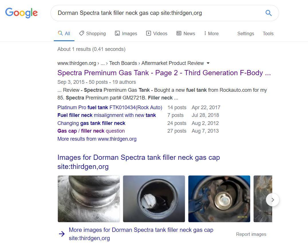

Jump on google, type in some combination of "Dorman Spectra tank filler neck gas cap site:thirdgen,org" and hit the enter key... Start reading until you see someone talking about contacting Dorman (iirc) and being told the part number of the cap they needed.
I just used that exact search string, and it's the first result on the page.
https://www.thirdgen.org/forums/afte...ml#post5567313
Or start carving the threads on your gas cap til it fits.

Thank you. I tried to get the cap with number #6819 that was listed in the link you provided but it was no stock at Auto Zone. The were able to order the one with part number 10819. Hopefully this works. Also, could someone answer my question about whether fuel filler necks typically come with a new tank or whether they would have put my old one back in with the new tank. Thank you. I will be asking the person who replaced my tank also but any additional info would be appreciated. Thanks again for your time.
