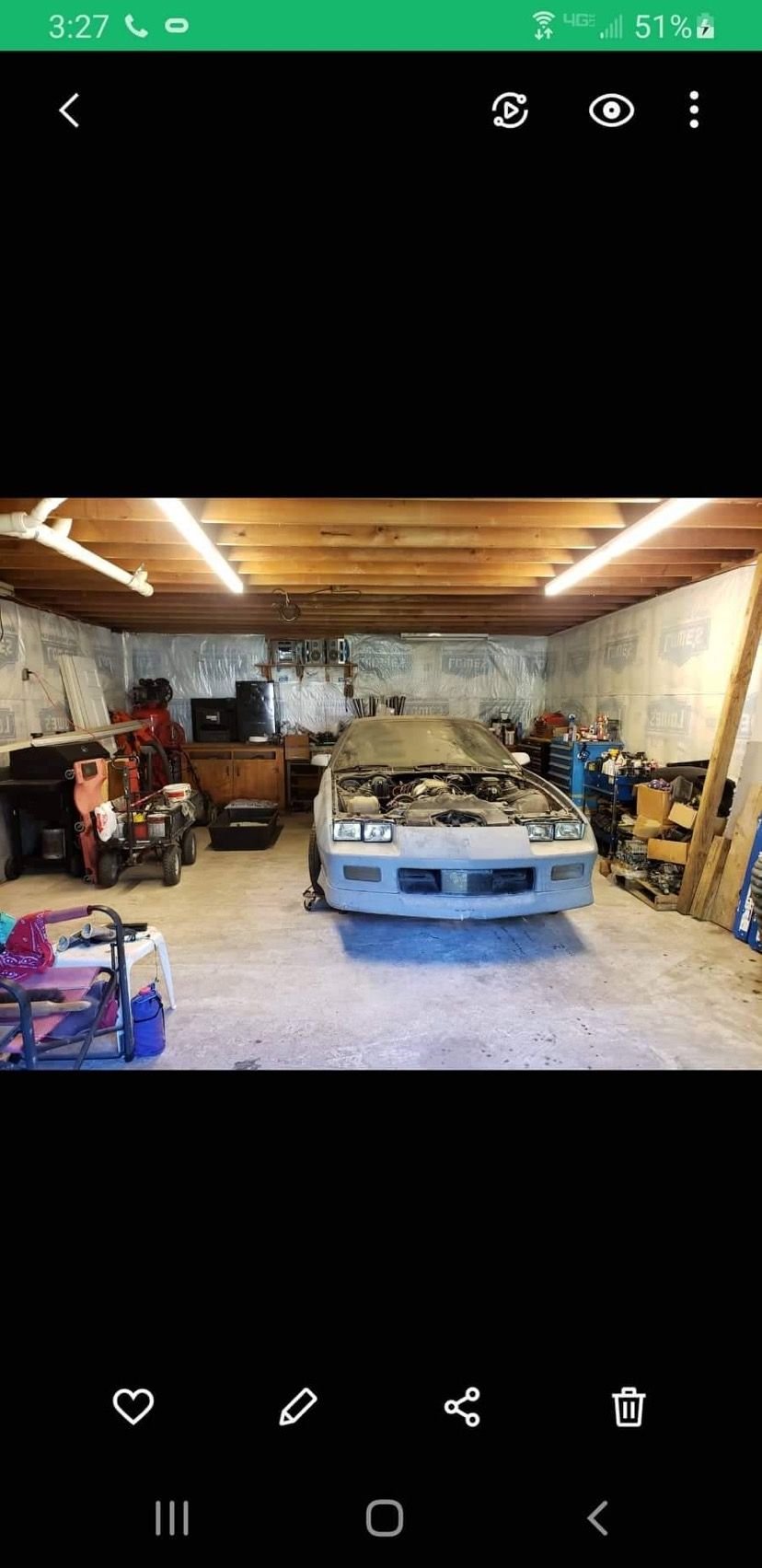

Sooo,
I bought this 1985 Camaro Iroc z with a swapped 350 LT1 corvette which was new when installed and only has 20k in it if that. I got it from my brother in VA. Ran before it was parked over 5 years ago and is in good shape… Problem is I live in MA, been trying to find a shop I can tow it to to get it running so I can drive it up I’ve called every single one in the Norfolk area, none have time or flat out don’t even want to do it.
pretty certain it’s just a fuel issue and some TLC. But I can not find ANYONE who can look at it before summer.
I need recommendations or a mechanic willing to do it in the Norfolk, VA area.

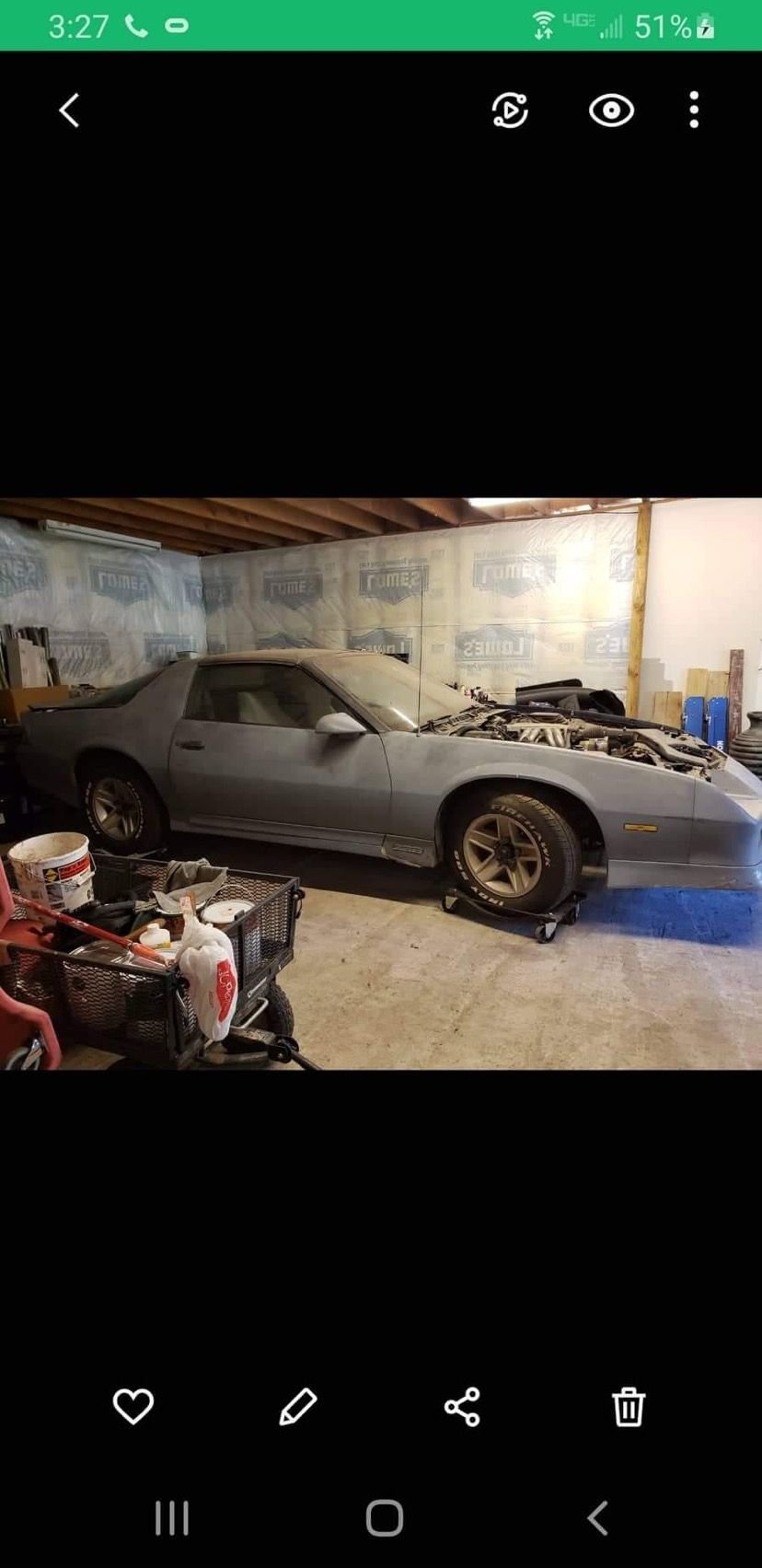

well based on the pictures posted, that is not an LT1 motor
Looks like the stock style TPI motor, so that might help get you in somewhere. Don't mention the motor swap, most shops will avoid that like the plaque

That is a Gen 1 SBC TPI intake manifold in the picture, not an Gen 2 SBC LT1. Another way to tell: LT1 spark plug wires come from front of engine, not the back like other small block V8
There was a Gen 1 350 SBC carbureted engine called LT1 around 1970-ish.

QwkTrip is right. It's most definitely a TPI. The LT1 motors have the spark plugs coming from the opti-spark up front, mounted over the timing cover and behind the water pump. It's like a big, flat retarded looking distributor.

Tune Port Intake
1995 LT1 Engine

At this point any talk is fruitless. Best to just wait to see things when you get the car. Can't go wrong for $1K, wouldn't sweat about anything yet.
I interpret the answer from the shop as, "We don't know how to tune OBD I cars". It's definitely able to be tuned, just not a common skill set with the older computers.

Thanks for the help, talked to my brother again and he did confirm it’s a Corvette tuned port. He told me me he said a tuned port and the engine says tuned port all over it apparently, then I said no you said LT1 and he thought they were the same thing lol.
Goes in Monday, hopefully this makes it cheaper to fix and work on. We will see.
Thank you for clearing this up for me.
