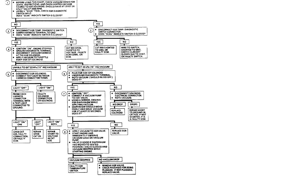

Russ, I will post the flow chart for code 32 later on tonight.

as promised
