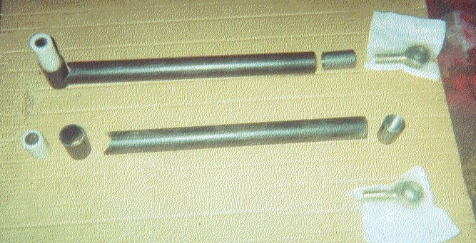

I had to push the inner fenderwell back about 1 1/2", and I made a set of offest tubular LCA's. (I notched the factory LCA's before I made the tubular ones) but it wasn't really too a of big deal. I heated up the inner fenderwell with a torch, and tapped it back. It actually moves pretty easy. Its looks awesome, and the car handles great. The rims are 17 X 12's on the back, and 17 X 9.5's on the front. I have attached a few pics of the car, and how I built the LCA's.

Here's the LCA's.
