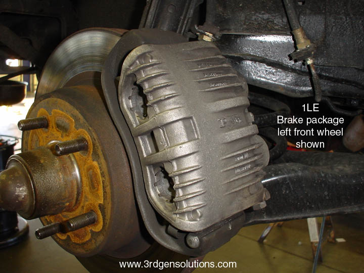

Perhaps this image of my 1LE brake package will help.
This is an example of the images that will be on our sonn to be released "CD" of 1LE and other F-body info.

Does the above hold true with a 92 GTA?
My fronts are single piston and the backs are both located at the rear of the disc.
According to the above then I would have non 1LE up front but have 1LE in the rear..

Yes it does. But in '90-'92 al rear disc brake equipped cars came with the PBR type rear disc brakes. GM finally realised that the earlier Delco-Morain cast iron rear disc brakes sucked. So a permanant change was made. Thank goodness!
