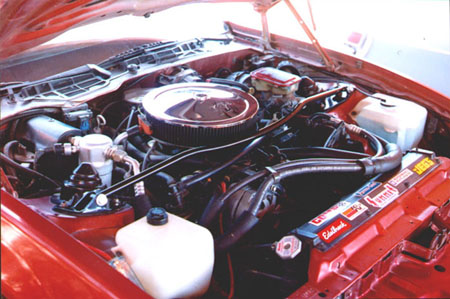

Old Sep 5, 2002 | 11:26 PM
PonchoTA's Avatar
Joined: Apr 2001
Posts: 377
From: Everett, WA, USA
Steve,
I think I have a pic of my engine bay, A/C on drivers side. More than welcome to use if you want.
I'll send it email to you, and I'll send it to DemonZ28 to upload on this site too if need be.
Paul

Originally posted by PonchoTA
Steve,
Paul

Old Sep 6, 2002 | 12:12 AM
Demon Z28's Avatar
Posts: 1,607
From: Houston, TX
Car: 2001 Camaro SS
Engine: Almighty LS1
pic one from paully... I hadda shrink it a little...

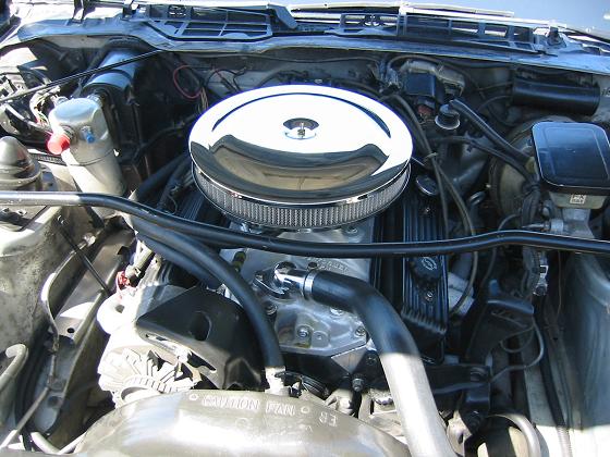

Old Sep 6, 2002 | 12:15 AM
Demon Z28's Avatar
Posts: 1,607
From: Houston, TX
Car: 2001 Camaro SS
Pic 2 from paully....
Attached Thumbnails Is there any new info on Spohn's new SFC's? Is he doing a STB soon??-transam_engine2.jpg

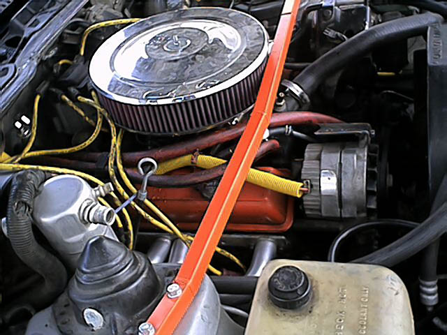

Old Sep 6, 2002 | 09:34 AM
99Hawk120's Avatar
Posts: 1,411
From: Rock Hill, SC
Car: 1999 Pontiac T/A Firehawk
Engine: ***'s Engine
These are kind of dark, hope they help. I have since switched the car over to serpentine and the brace fits fine. I can get some pictures that way too if you'd like.
Is that the GL STB? Its a nice one, though I only have the 2 pt. And for the craftsmanship, it was an excellent price.
Nope, it was made by a guy on the boards a while back who goes by MRZ28HO.
