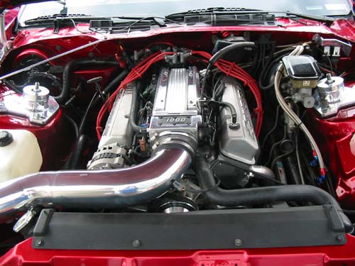

I have driven my car 4 times so far with the HMS strut mounts in place. Twice before it was aligned just to check everything was bolted together well. Twice since it was professionally aligned.
My all new set-up consists of the following:
FRONT
HMS custom strut mounts
KYB AGX adjustable struts
Intrax springs
Energy Suspension control arm bushings
Moog ball joints
McQuay-Norris steering linkage
Baer Tracker bump steer tie-rods
Spohn wonder bar
Guldstrand 36mm poly bushings
TDS greasable brackets
Energy Suspension sway bar end links
REAR
KYB AGX adjustable shocks
Slot Car Racing adjustable, heim-joint end lca's and phb
Intrax springs
Plus front and rear swaybars, of course. Now, the struts and shocks are all set on #1, the softest setting. And the Intrax springs are progressive wound, as opposed to the Jamex I just removed.
So, the HMS mounts I got are the medium height, allowing for lowered cars to still have full strut travel and normally ride in the middle area. Well, I'm here to say the car as it is sets right now rides like a dream! Now I'm not normally going for the cush ride. My car has traditionally been pretty stiffly sprung and a fairly harsh ride. No complaints. But right now I think the combo of the soft settings on the struts, the progressive winding of the springs, and more importantly the extended struts position has made a very noticeable improvement in ride quality. I can see leaving it as is for normal around town cruising. It's quite pleasant and I'm sure my wife will even take notice. And with the new AGX struts/shocks it will be a simple matter of redialing them for a firmer ride when it's time for some mountain road action. That will be something I am going to have fun experimenting with and setting up.
So, a big thank you to Karl Hunter for making these available to us. Not only do the strut mounts look trick as ****, but they perform great and make a huge improvement in ride quality on a lowered car.
BTW, for those concerned that the HMS mounts had camber adjustment "only" I found that after removing the factory lower strut mount plate inside the fender well that the bolt holes are slotted in the fender. So this allows not only camber, but caster adjustment. And since the HMS uses singular bolts instead of a "bolt plate" the adjustment is limitless. Not only can they be moved for and aft, but also in a circle. These things are totally trick! :hail:

Sweet man, wonder if they'll make another run....
When are you gonna have some pics of your car as it sits now? I'd really like to see the stance of that setup...

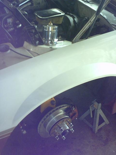

Yes, the footprint is the same as the originals. I have a set waiting to be polished in my bedroom.
Note mine are sitting , still in the box, waiting to be pollished, and re-anodized blue, then installed.
